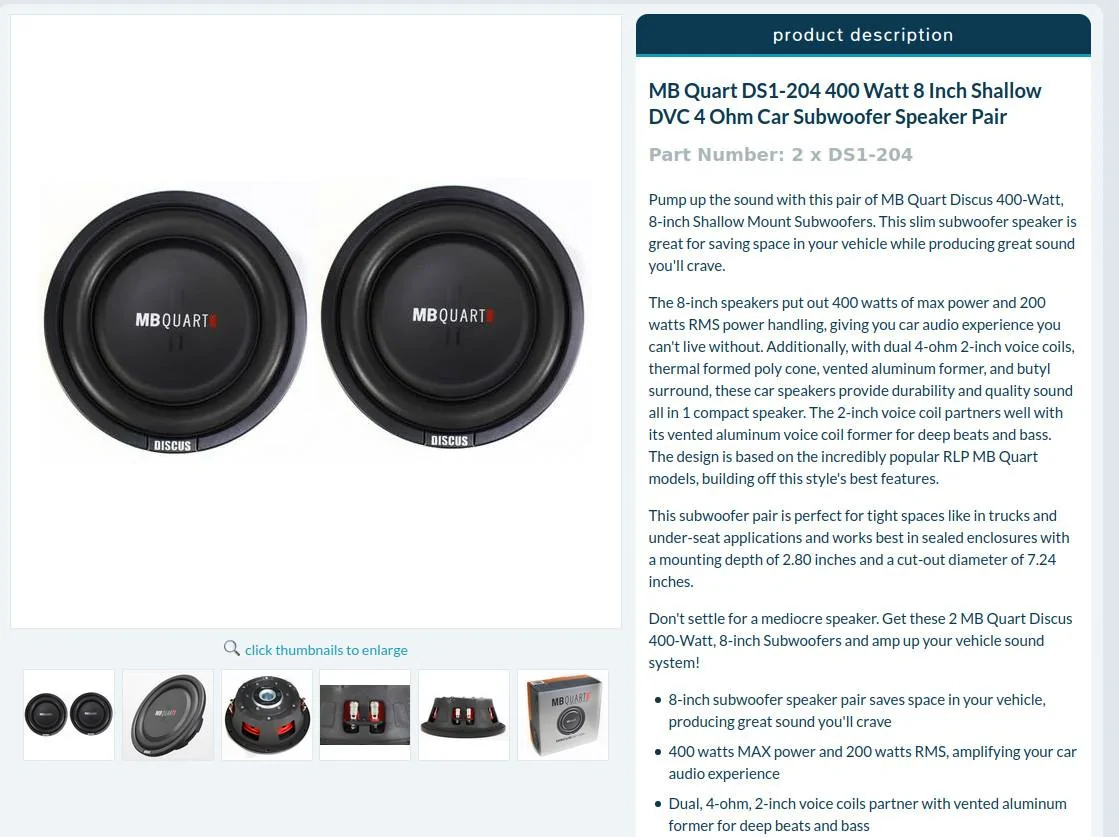

I'm considering replacing the stock subs with these:
http://vi.raptor.ebaydesc.com/ws/eBayISAPI.dll?ViewItemDescV4&item=392294737167
But they need about 3" clearance below. I was also thinking that if not enough clearance, perhaps I could top-mount them on a circular wooden pedestal high enough to clear whatever is under the stock speakers?
I know a lot of owners hate the stock subs - I sure do.
A sound expert I consulted with recommended those as very good 8" replacements.. I also purchased a lot of materials recommended here for sound deadening, vibration fixes, fibre box lining, etc..
Gotta fix this- it's so BAD!

watch my video tearing the back interior out. I dont think there is 3 inches. If you mounted the subs up where the speaker grill you might have enough space but the volume of air would be at most .25 cube foot.

Must be less 2.5" depth to fit in OE enclosure....

You can mount them inverted and wire backwards (positive to negative etc.) Seen it done in vehicles with boxes challenged for airspace. Creates some interesting conversation as well. Get a good seal on the inverted mount and they will sound good.
