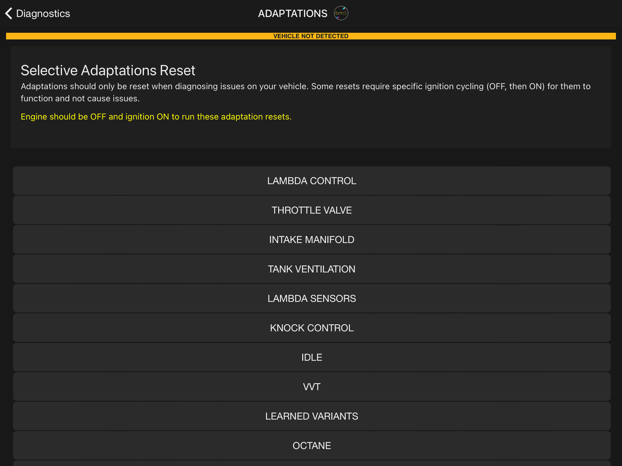

If you know someone near you with BM3, it does give you the option to reset adaptation of throttle body. Not sure if it can be done with bimmerlink but wouldn’t be surprised if it could. But also look at your wiring and make sure there aren’t any leaks like mentioned above
