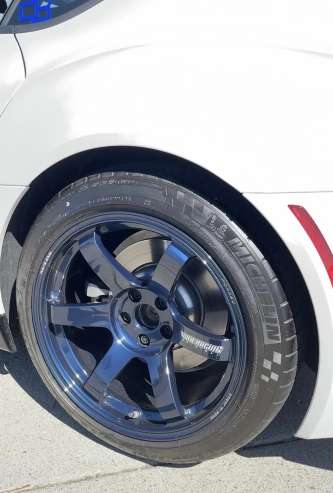

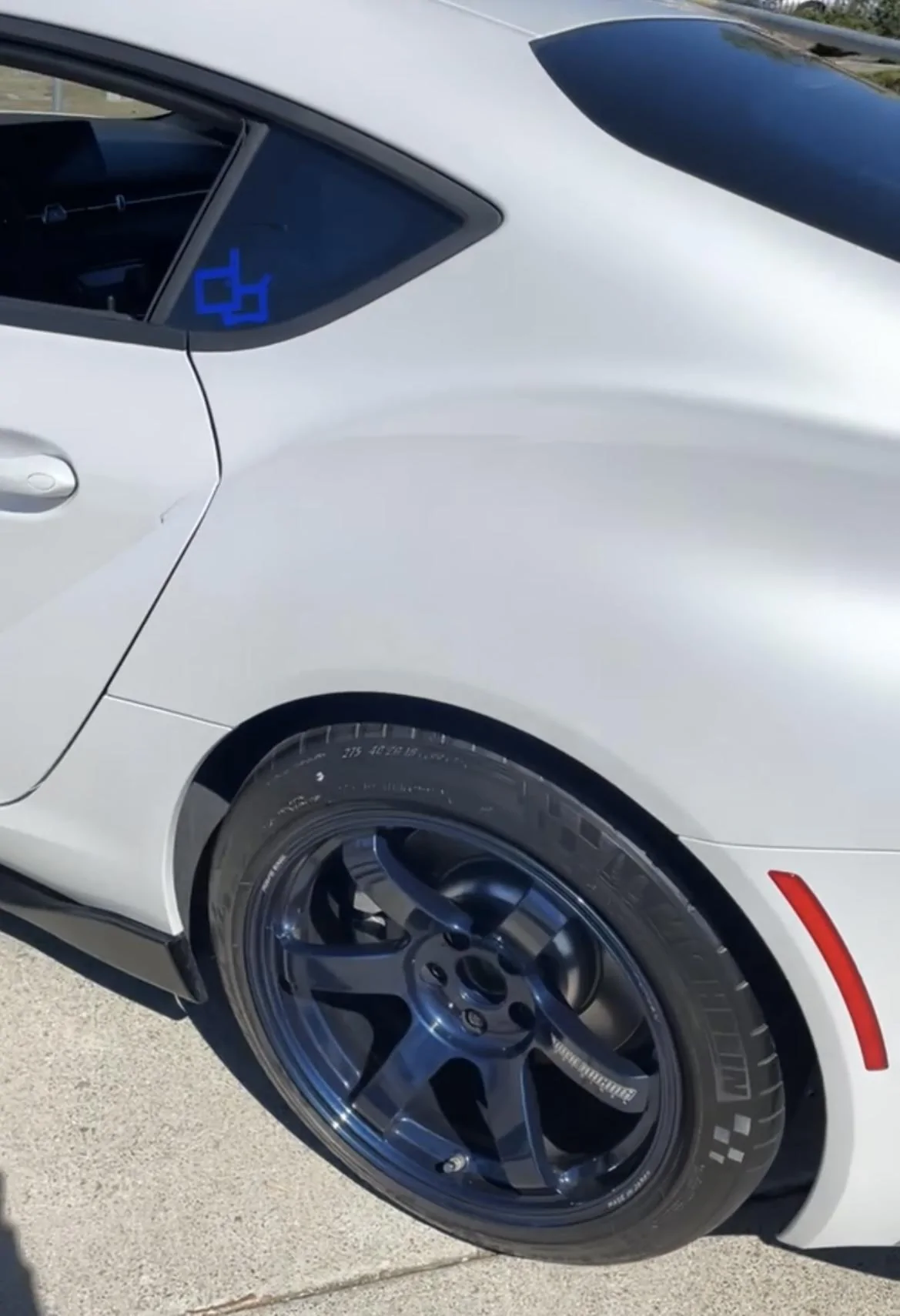

Clean car, what are the actual specs on your rims? and tire size?
PearlSup
PearlSup
Dec 17, 2021
210
230
SoCal
21' Premium Phantom
Fronts: 18x10 +25 5x112 (Face 4)
Rears: 18x11 +34 5x112 (Face 5)
Currently wrapped in Supra 2.0 OEM rubber… I will most likely bump up a centimeter wider on each corner on the next set.

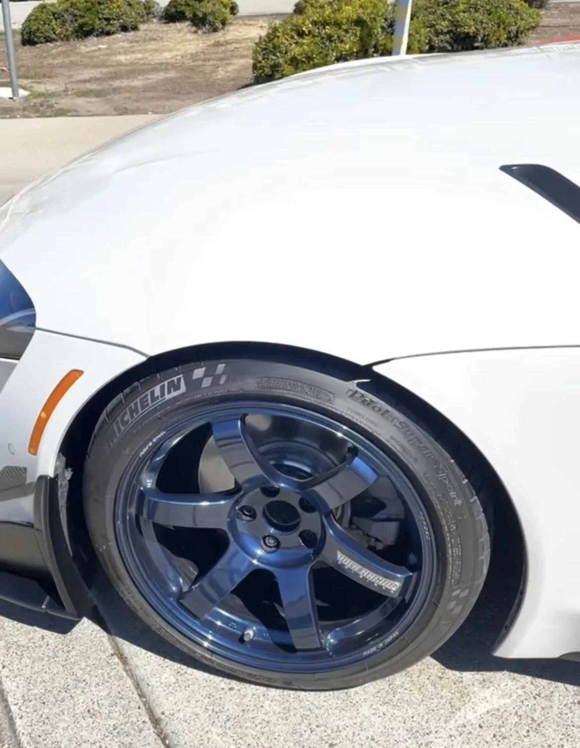

Looking forward to see what you do to the car! I was wondering what your thoughts are on the H&R springs. How is the ride compared to stock? Do you scrape at all when it comes to daily driving? Do you wish you went lower? Sorry for all of the questions, I'm just trying to gather as much info as I can to help make my decision on springs.
Also if you can post any side profile photos of the wheel gap would be greatly appreciated!
TIA
PearlSup
PearlSup
Dec 17, 2021
210
230
SoCal
21' Premium Phantom
They’re quite a bit stiffer than stock 2.0 springs & overall significantly more confidence-inspiring. Comfortable to me, but I’ve only owned “rough-riding” vehicles thus far.
Sometimes I scrape backing out of my steep driveway, but I have a lip.
Once the lowering springs eat up my OEM dampers, I will be moving to coilovers. I may go a tiny bit lower, but also planning on going a squared wheel setup (which is mostly incompatible with OEM front struts).

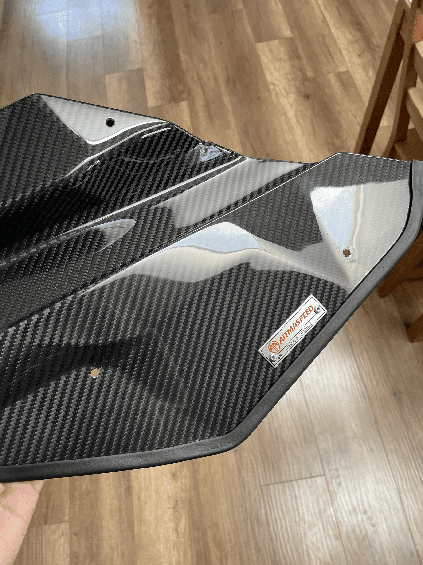

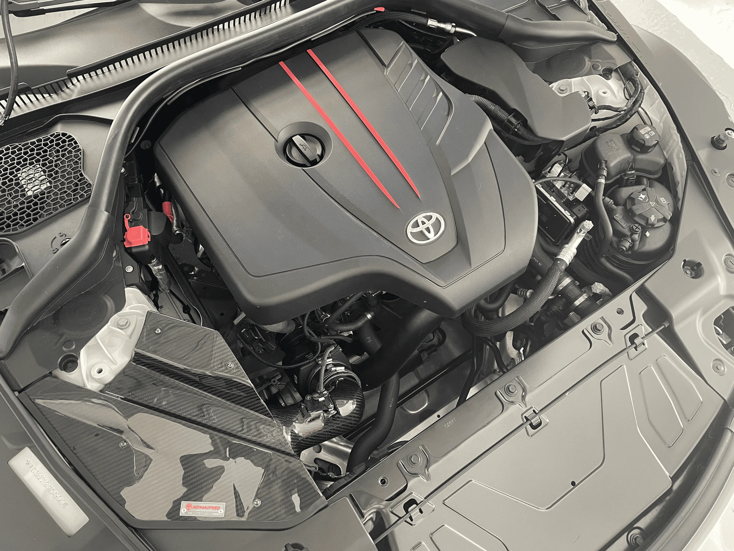

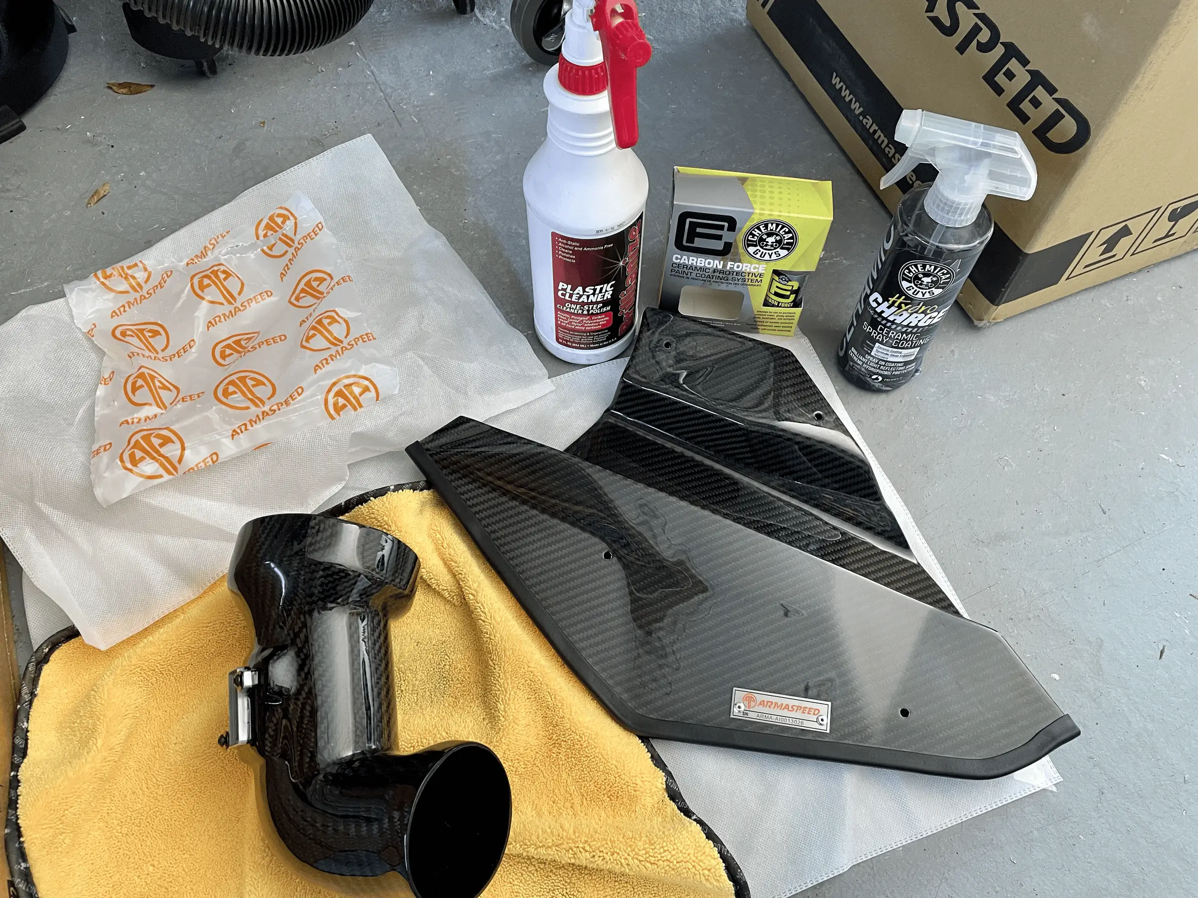

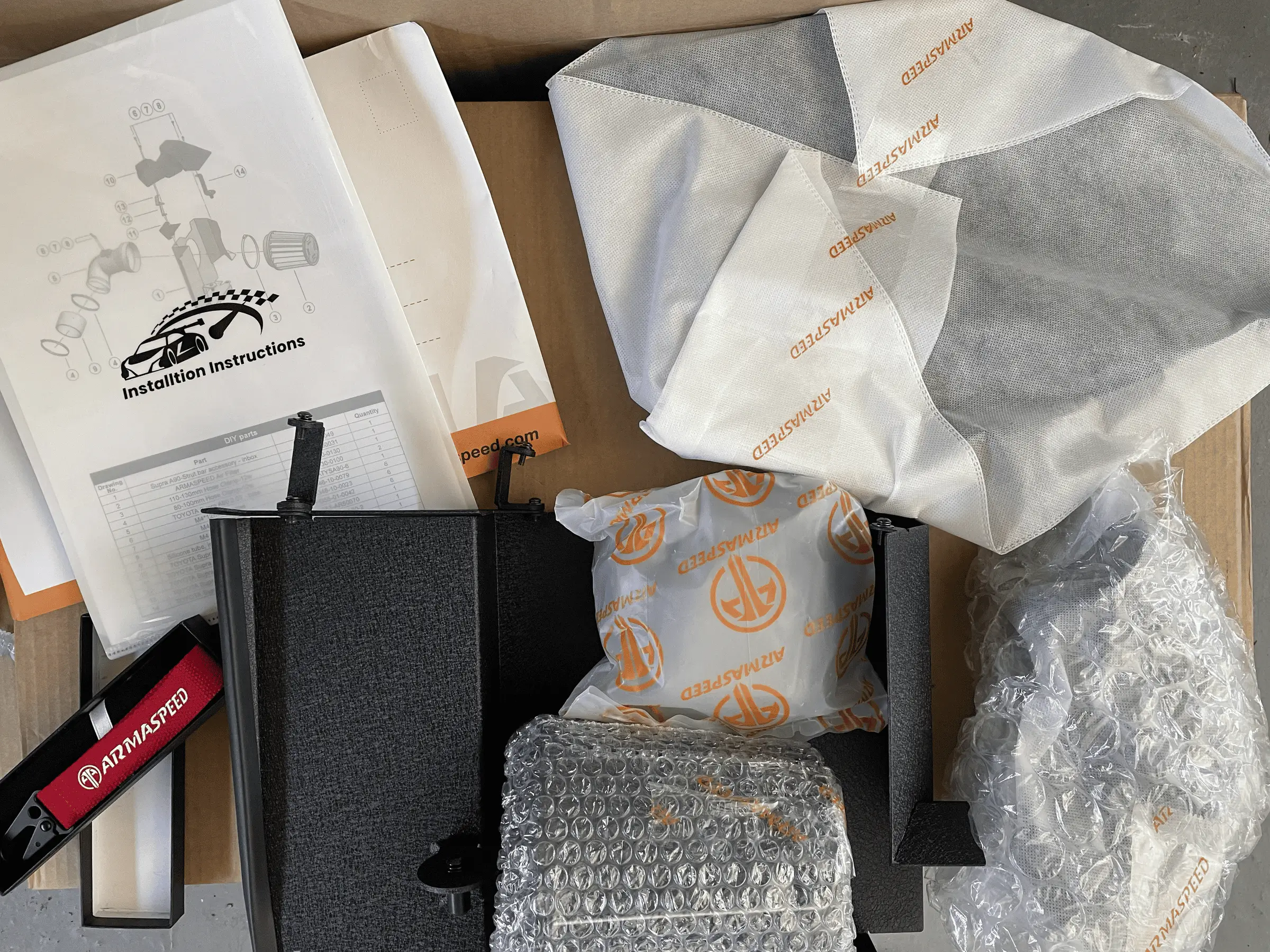

Armaspeed intake (woven carbon fiber option)
1. Initial impression
- fast shipping
- came with a couple goodies including a carabiner & vinyl decal
- packaging, something I'm a sucker for, was top notch!
- quality of the carbon fiber appears to be very nice, with weaves being consistent & not wavy
- pictured is the intake box lid after Brillianize ---> Ceramic coat x2 ---> Hydrocharge ~24 hrs. later

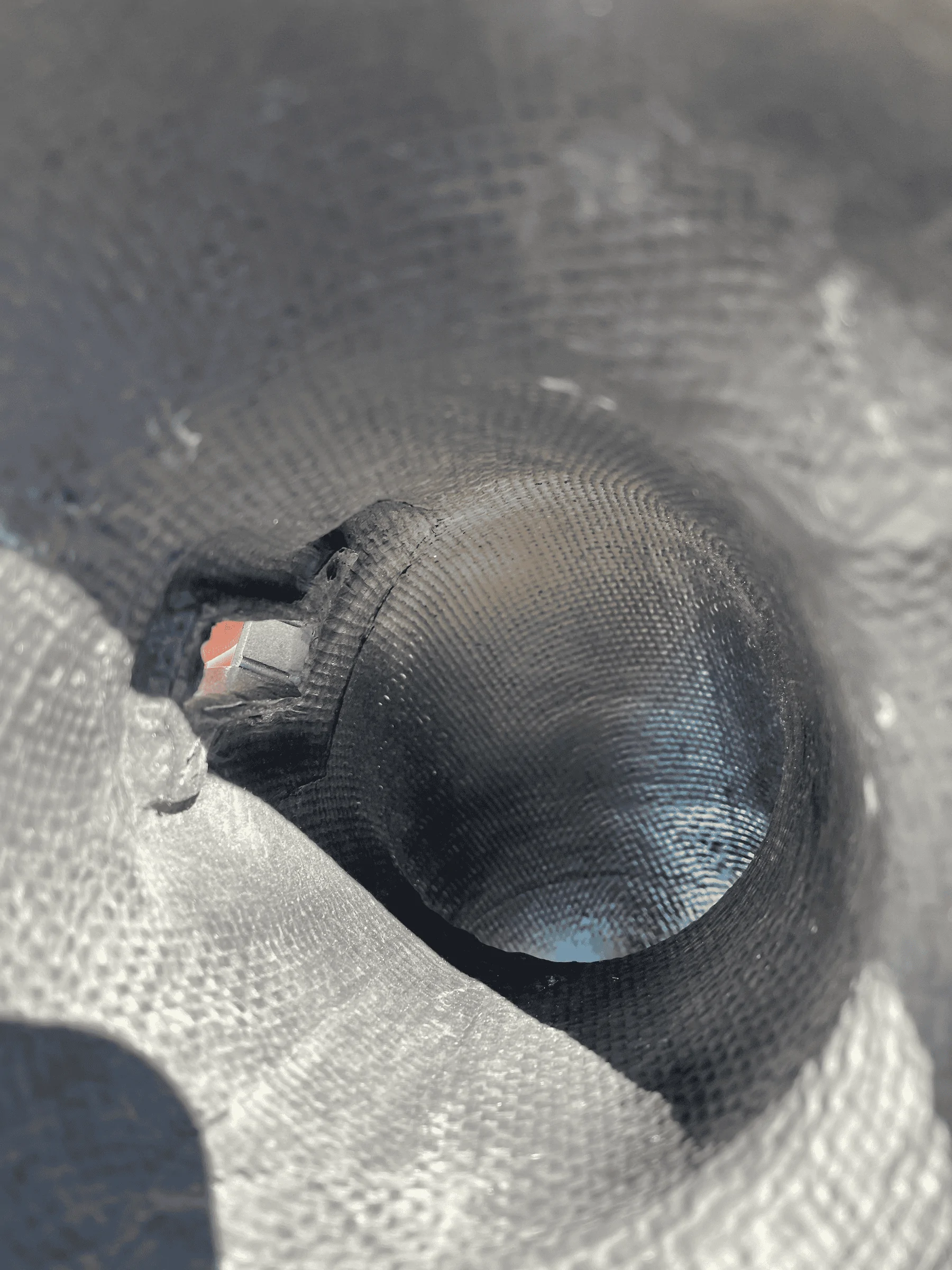

- I was pleased to find that the carbon fiber intake tube did not have any fiber glass residue from the manufacturing process, something I've seen even in the higher-end 3.0 intakes...
2. Concluding impression
- Sounds absolutely ridiculous!
this intake will let you hear every single turbo noise your heart can possibly desire
- relatively easy to control & pussy-foot when the boys in blue are lurking (Californian problems)
- butt-dyno was, unsurprisingly, unimpressive, though I feel the car carries slightly better during highway pulls

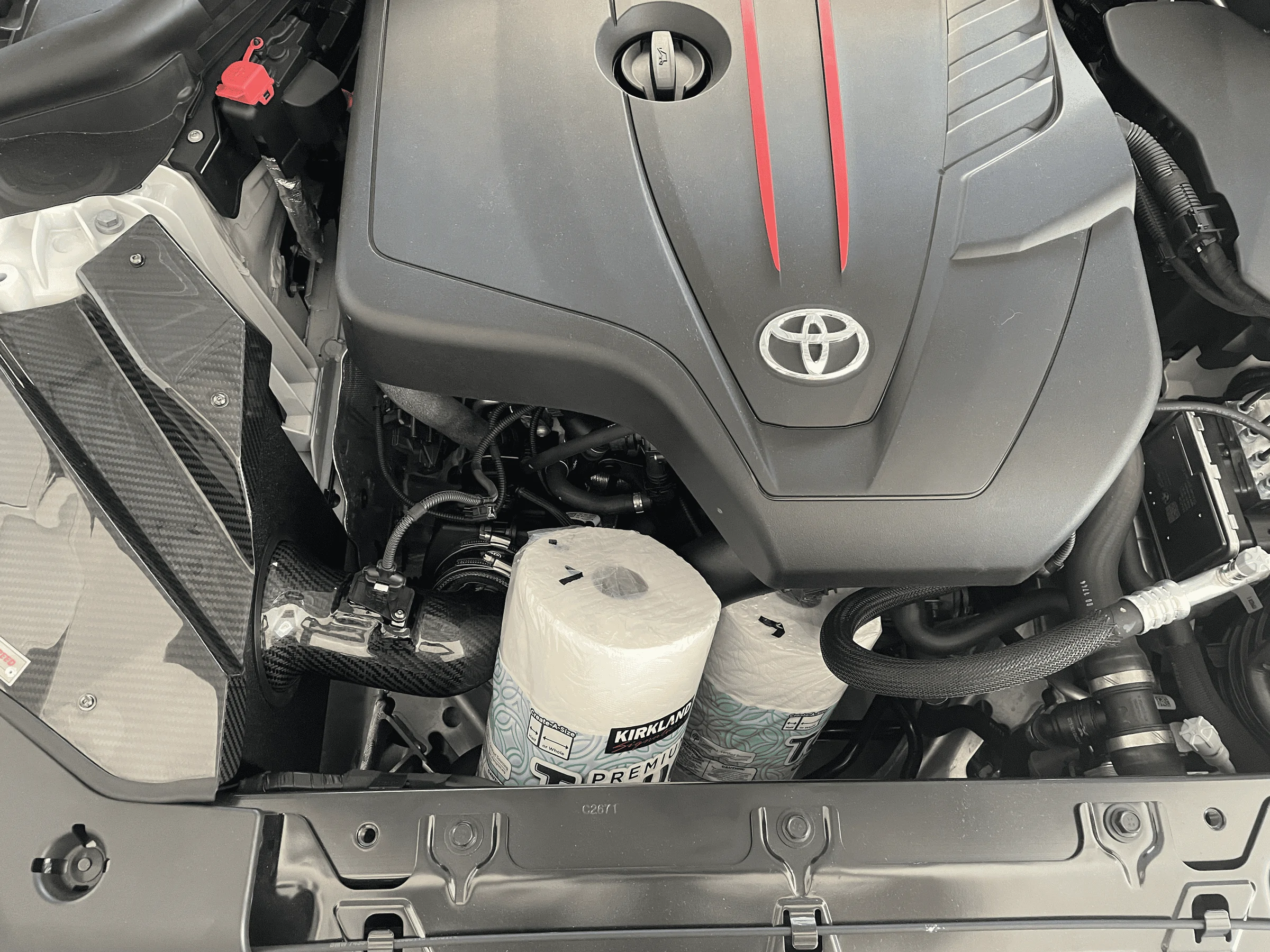

- best part is I got a frunk now! ?
3. Installation tips

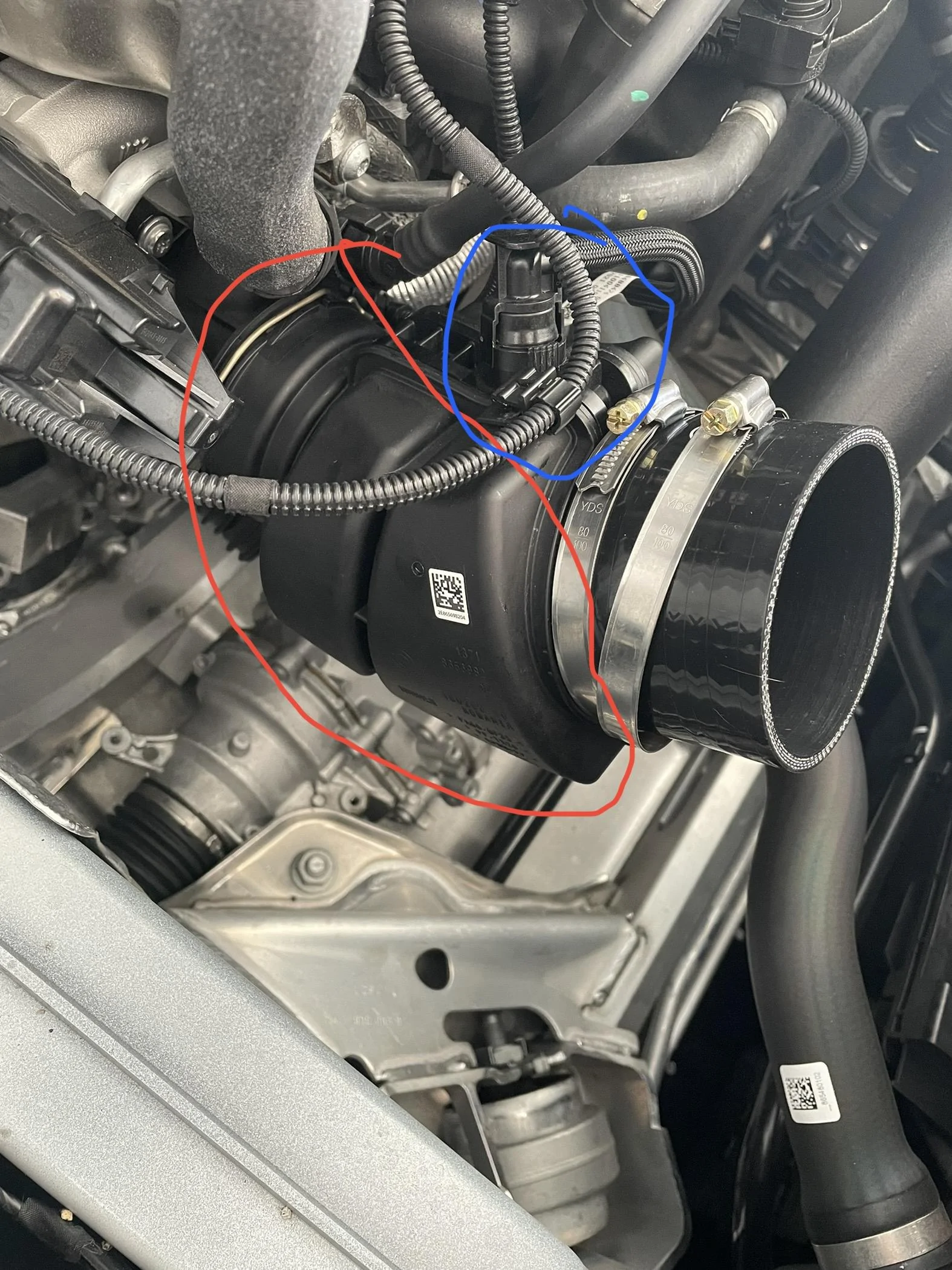

- rather than unplugging the temp sensor probe & removing the housing, I removed the unit as a whole, then reinstalled to the Armaspeed intake tube
- 7mm nut driver is a must for the provided hose clamps
- to the three other people who own a 2022 GR Supra 2.0 & plan on modifying it ---> I used instructions from aFe's Takeda intake for the removal process (not explained in Armaspeed's instructions)
- I don't know if the 2022 2.0 model is different, but I ended up having to reuse the OEM intake tube (SEE BELOW)
- in order to get to this point, you must first separate the intake tube (circled in red) from the intake resonator box/accordion; this requires breaking & removing the Oetiker clamp holding the two together -- MUST BE DONE WHILE ENTIRE STOCK INTAKE SYSTEM IS REMOVED FROM VEHICLE
- I reused the OEM C-clamp to fix the intake tube to the turbo inlet
If you have 2.0 and have any questions regarding the installation or anything at all, do not hesitate to direct message me on here :thumbsup:
