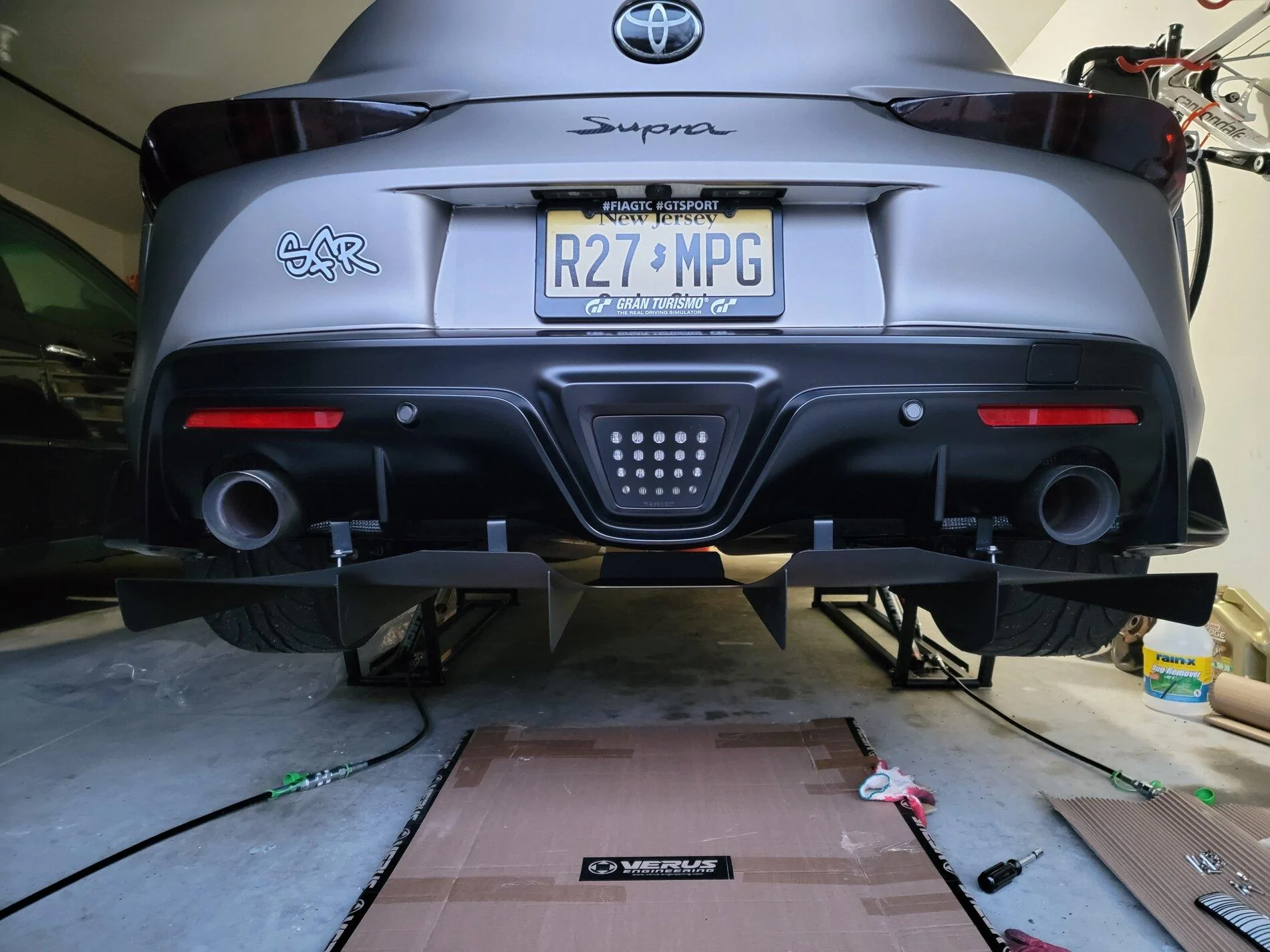

This was yesterday when I was adding weight to my supra. No space issue at all. Perhaps if I had 2 story garage, 4 post lift would be better but for garage I have, I think it's best for the money.

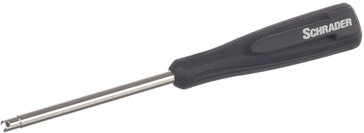

that's correct. but if you don't have Schrader valve tool, I recommend getting one as valves were not tight from factory. rubber blocks comes in 2 sizes, large and small. its foot prints are same so if you want, you can stack them. these blocks are universal so it will not be fitting inside the lift point. you can get bmw specific lift point "hocky puck" from amazon. something like this.

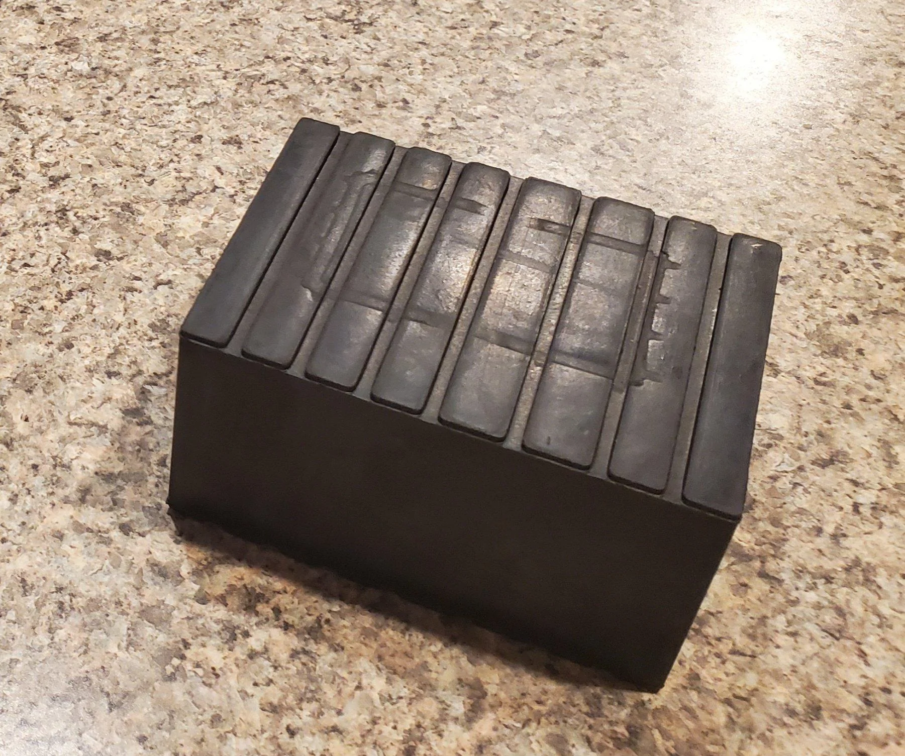

The QJ blocks are all you need. No damage done as you can see the impression of the lifting points here. :thumbsup:

Awesome! Thank you. Can you give me a link to the Schrader valve tool you use for your setup? thank you again.
