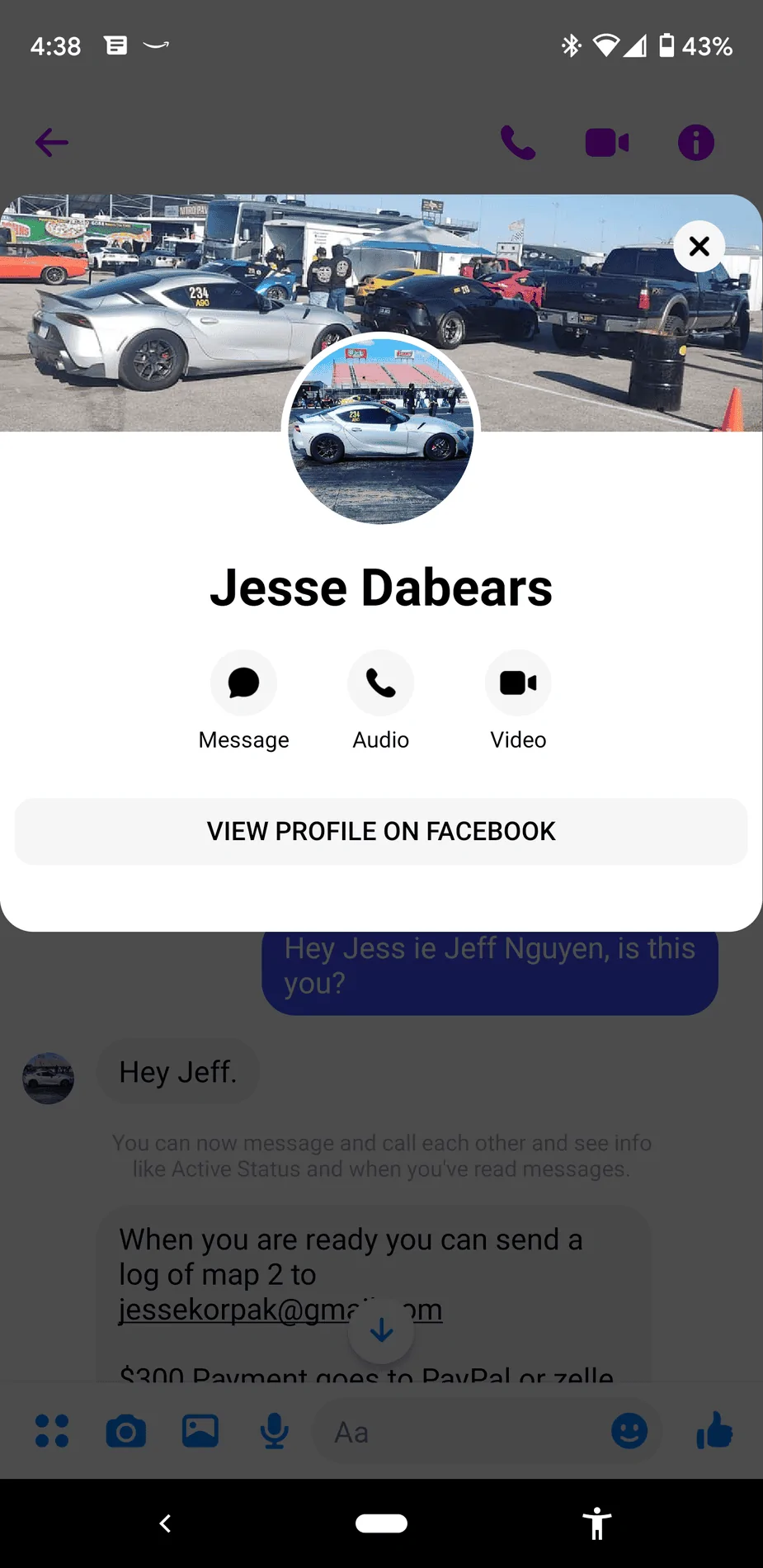

Bro thanks for sharing your experience,why don't you reach out to @DaBears on Facebook and messenger him and see what he can do for you..I am include a screenshot of his profile on Facebook so you can see ... He is fast answer through messenger and very resealable price

Hey, you left Jesse's email in there, might want to blur that out/crop it.
No he cool he want his email so you can contact him.
