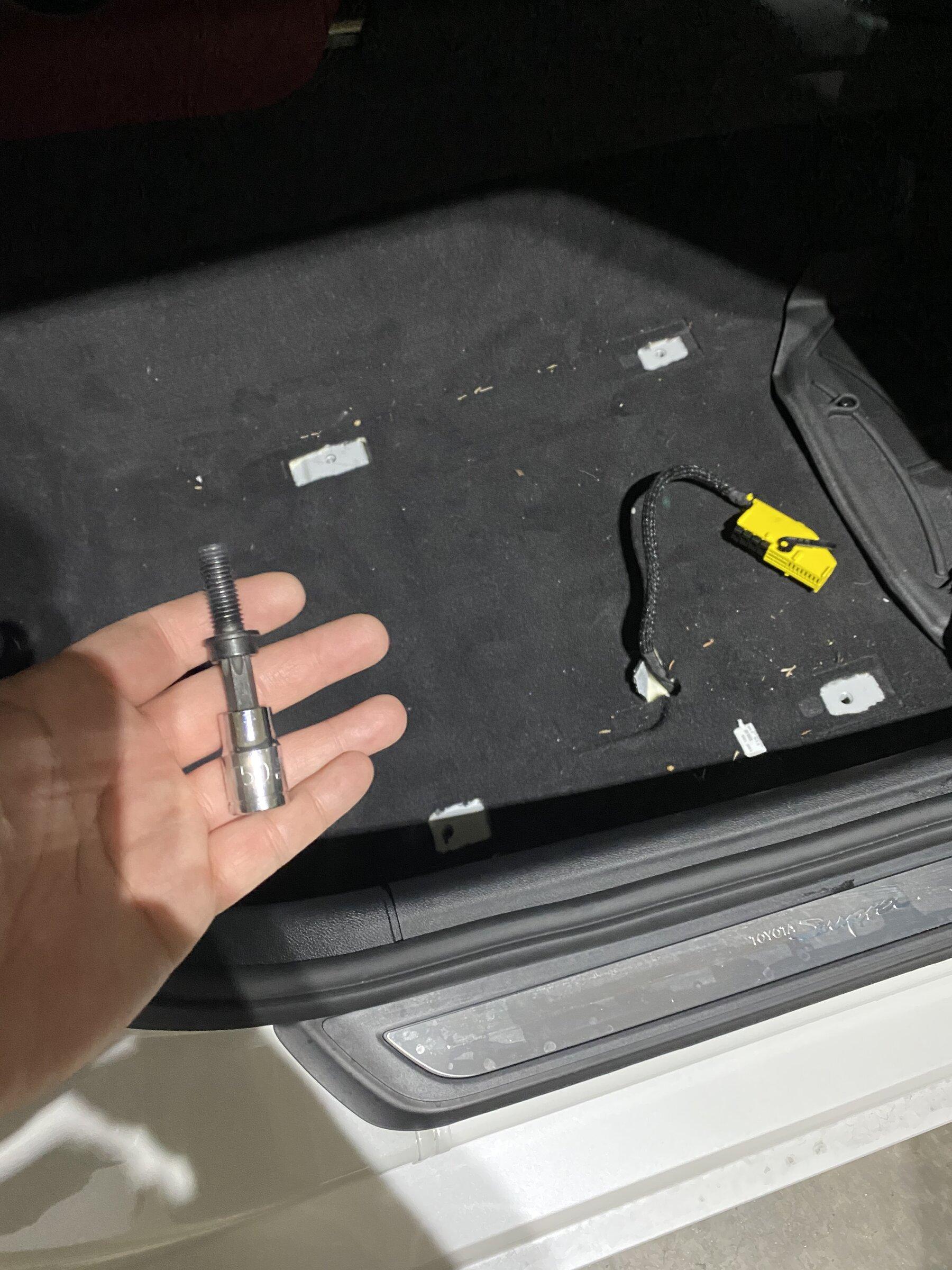

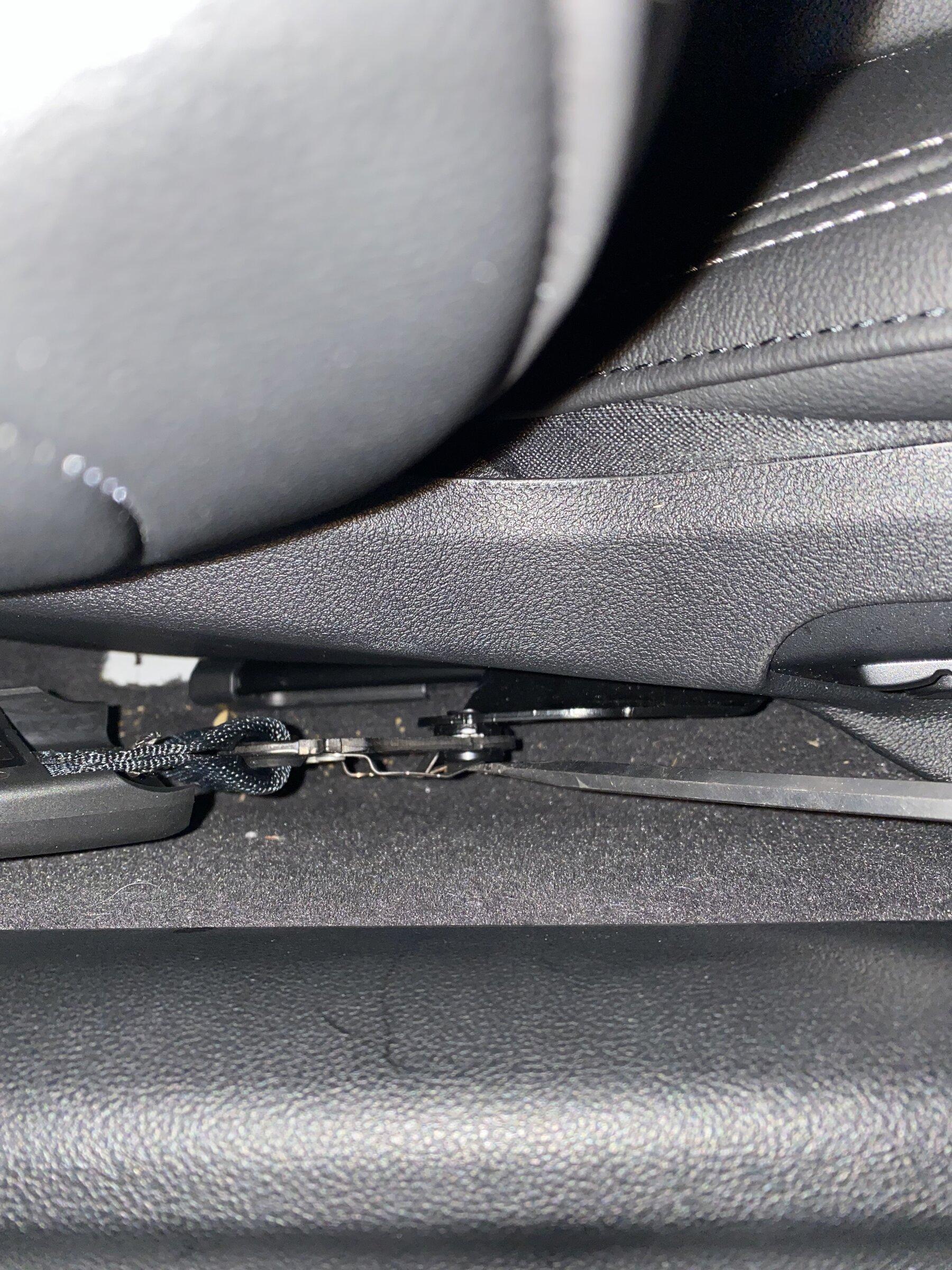

How to Swap Seats:
  • 4x T50 bolts holding the seats
    -you will need to move the seats forwards and backwards as well as raise the seats fully up to get them out
  • with a flathead open the clip holding the seatbelt after pulling back the plastic to slide out the seat retainer on the side of the seat
  • Underneath in the front there will be an easily accessible yellow connector. Press the tab in and open the connector clip and it’ll just come out (forgot to take pic closeup but can see the connector in pic below)

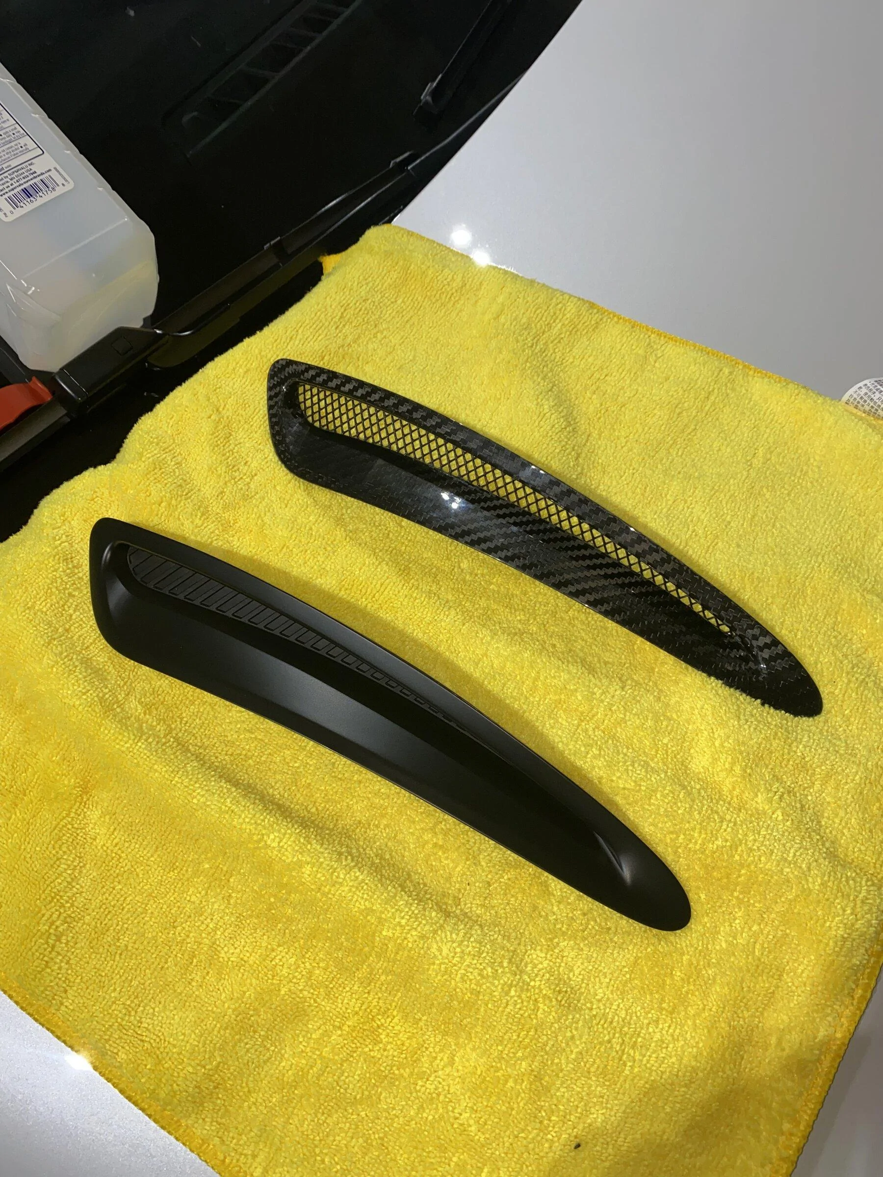

03/20/2022

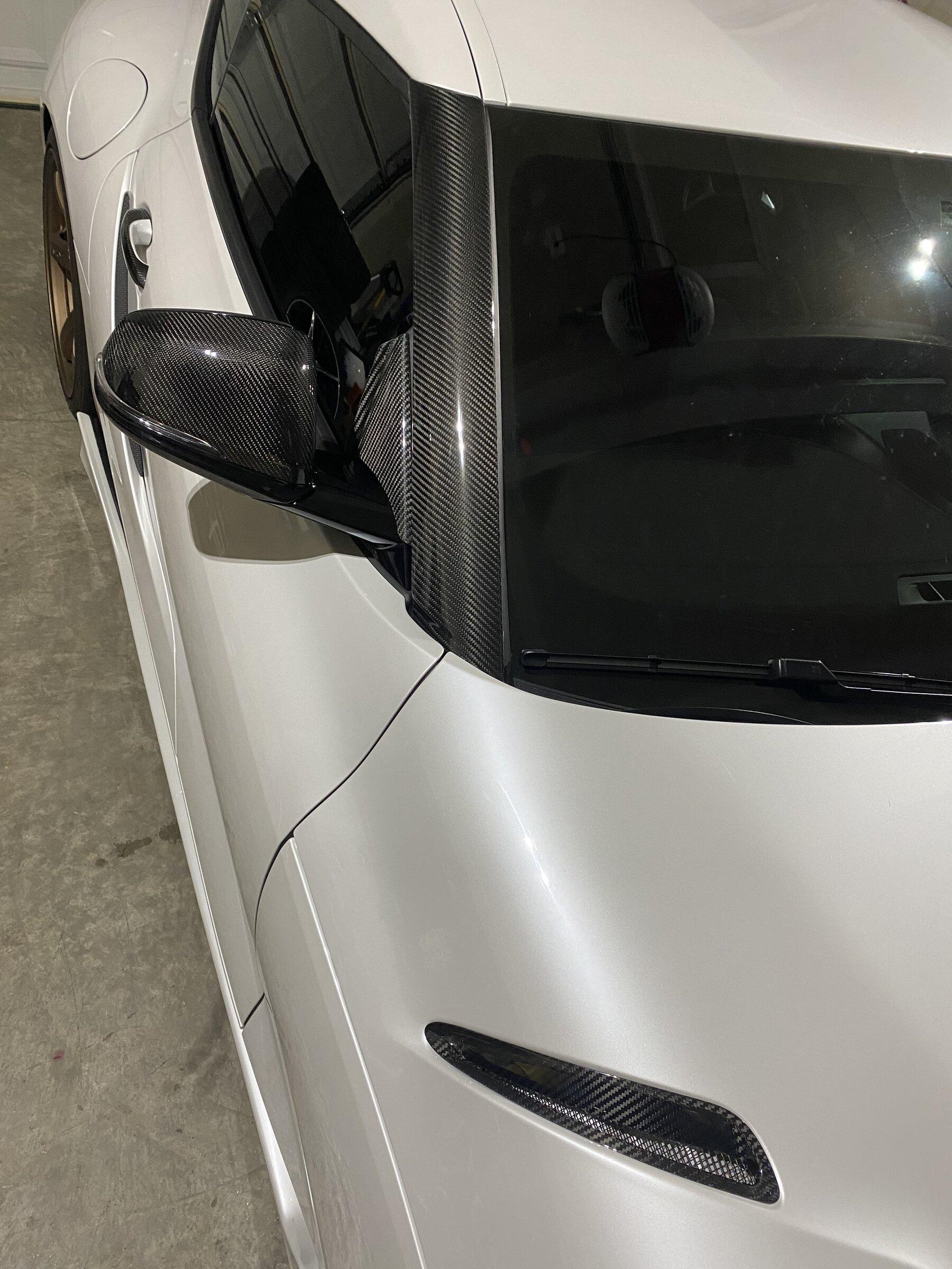

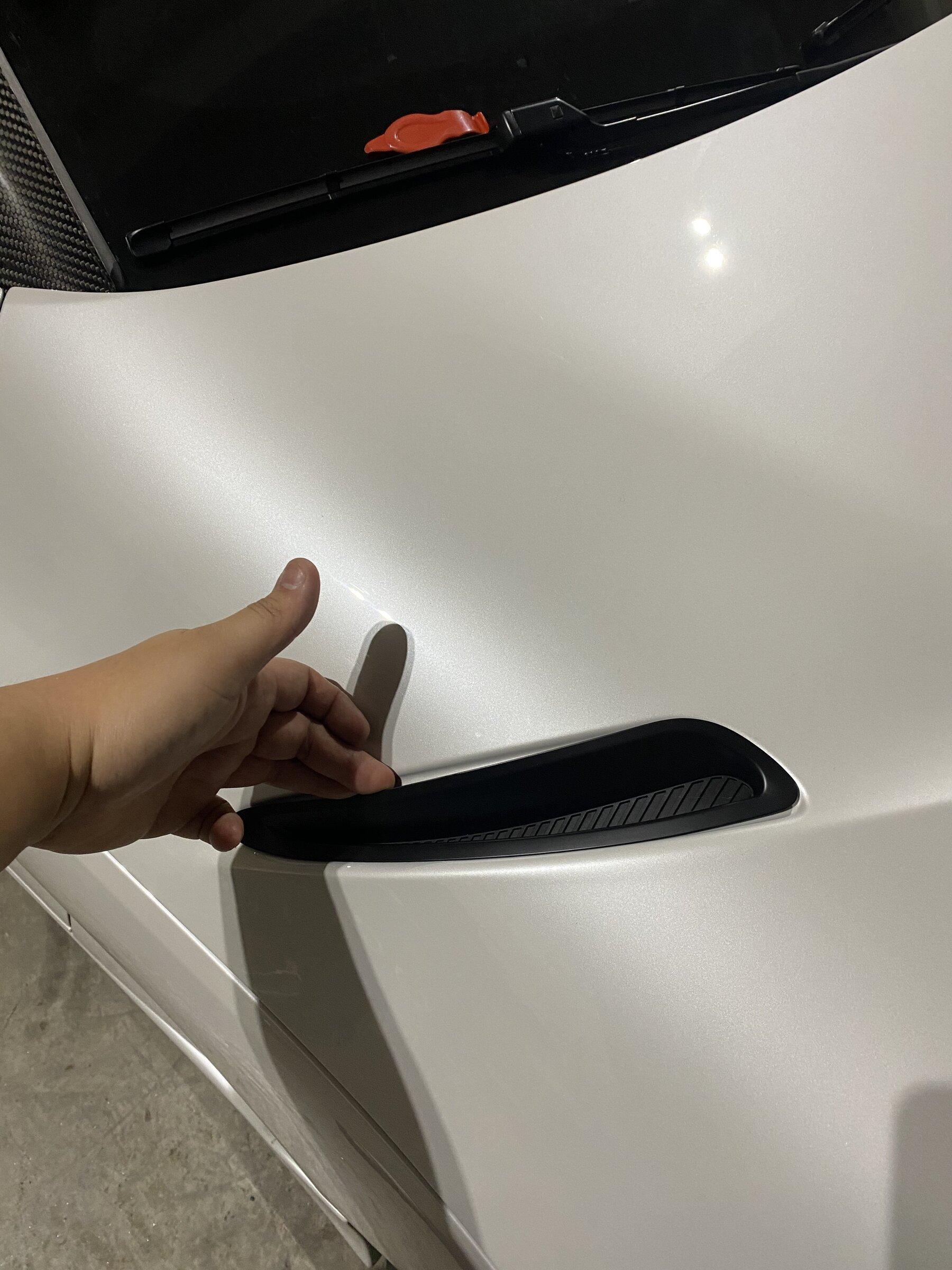

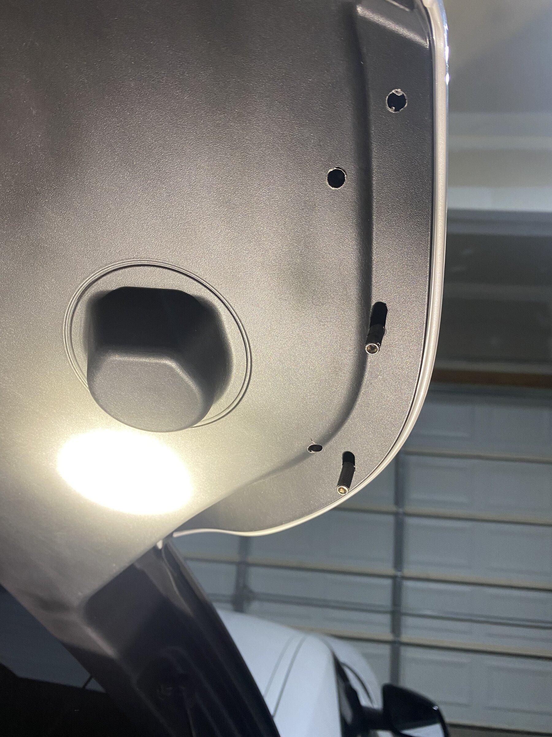

added the cf vent
removal is just prying the top part with anything soft really. Then it is double sided tape on
I also used 3M primer for extra adhesion

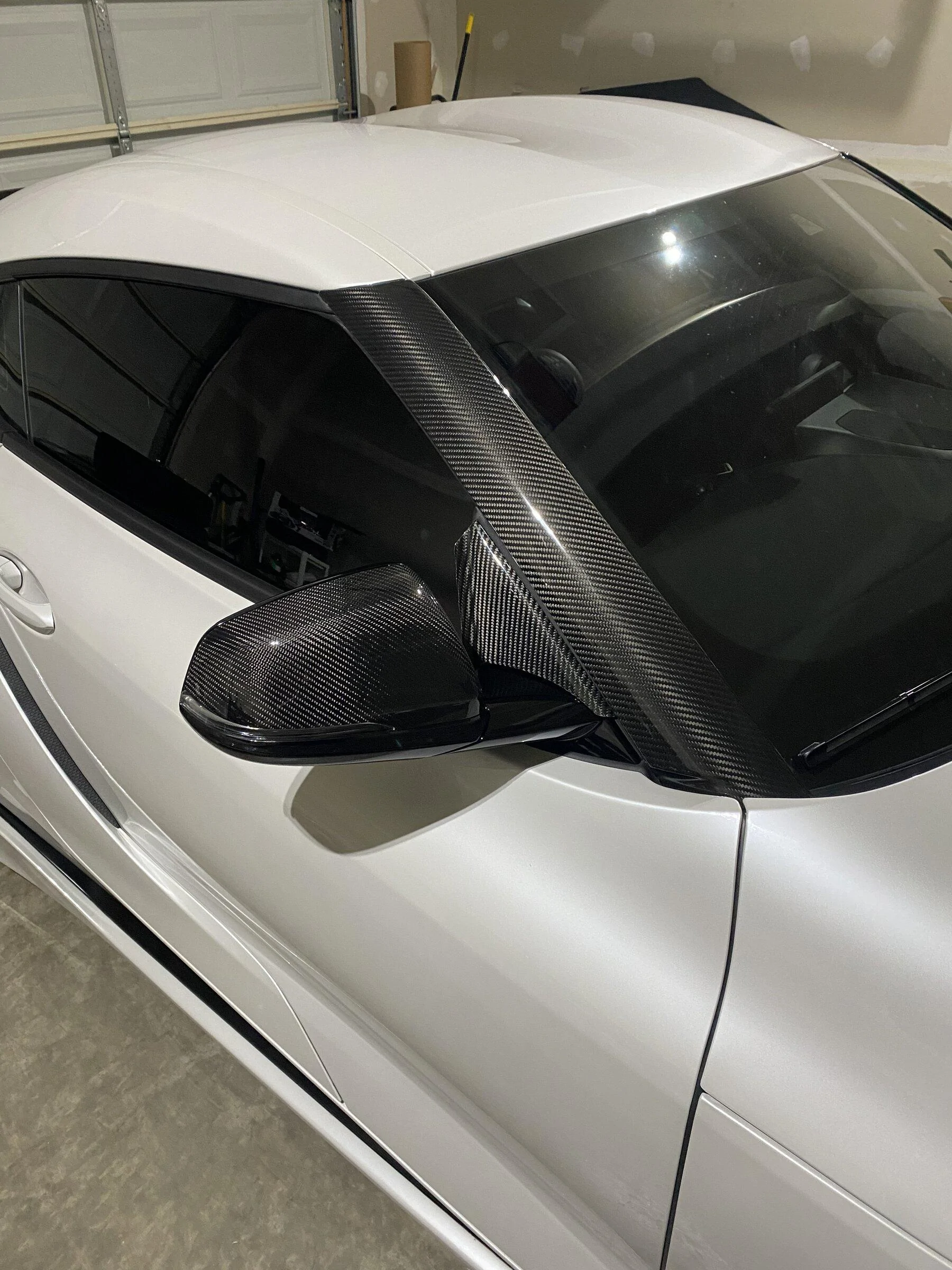

  • Swapped out my gloss black Verus style wind buffet for the cf AMS ones
  • Added cf pillar covers (I ppf’d them
  • All parts I also ceramic coat

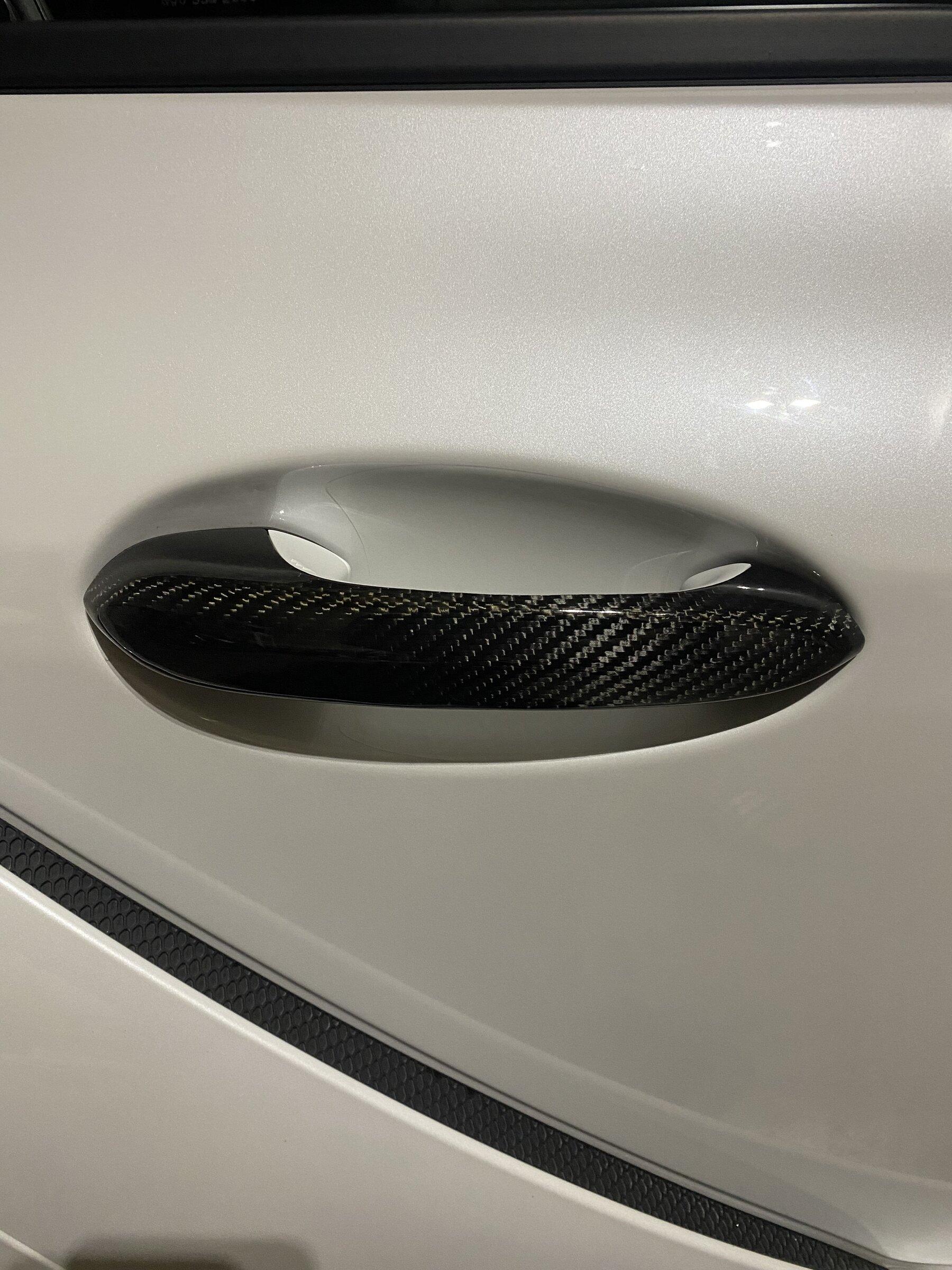

added cf door handle covers

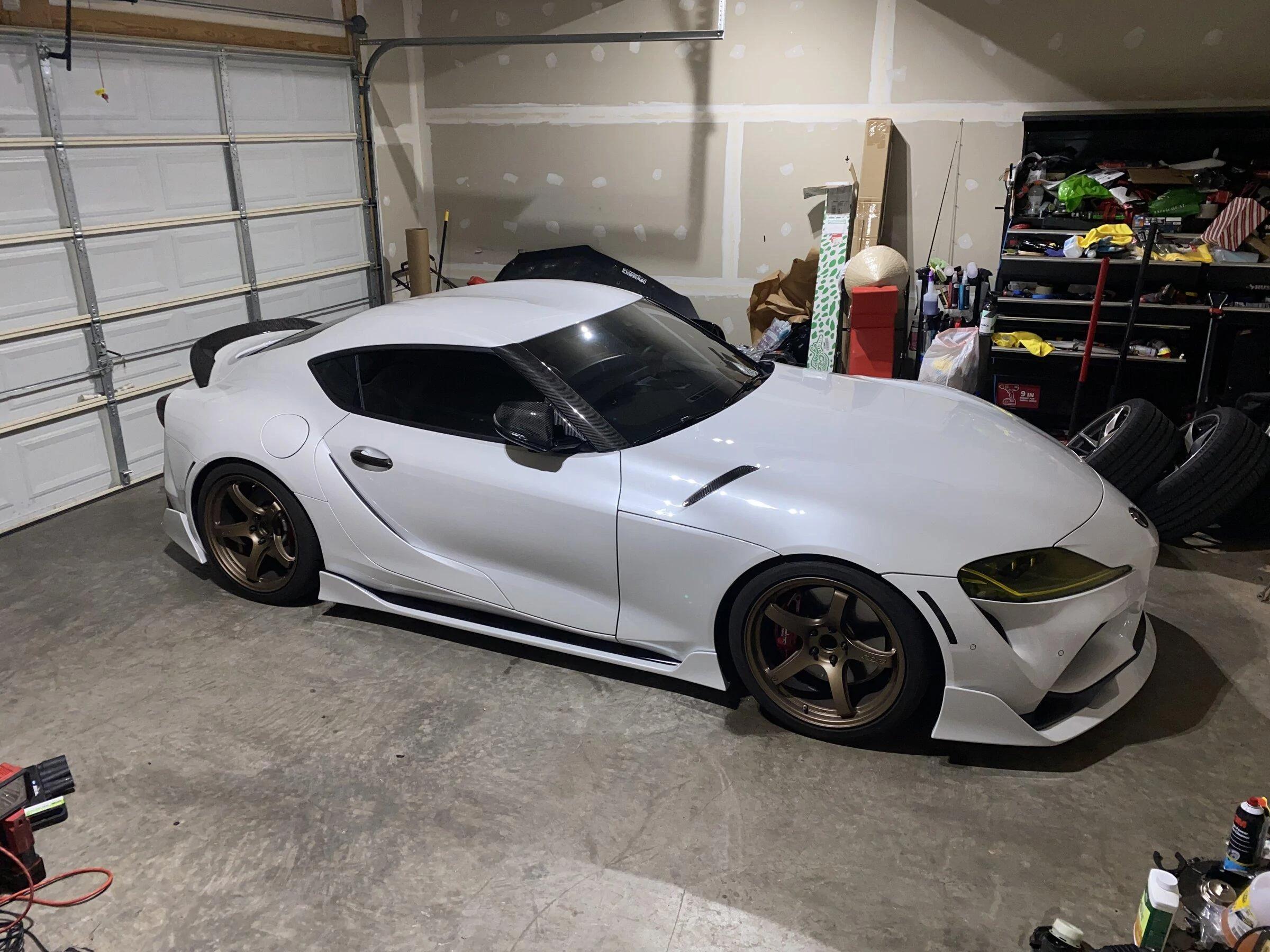

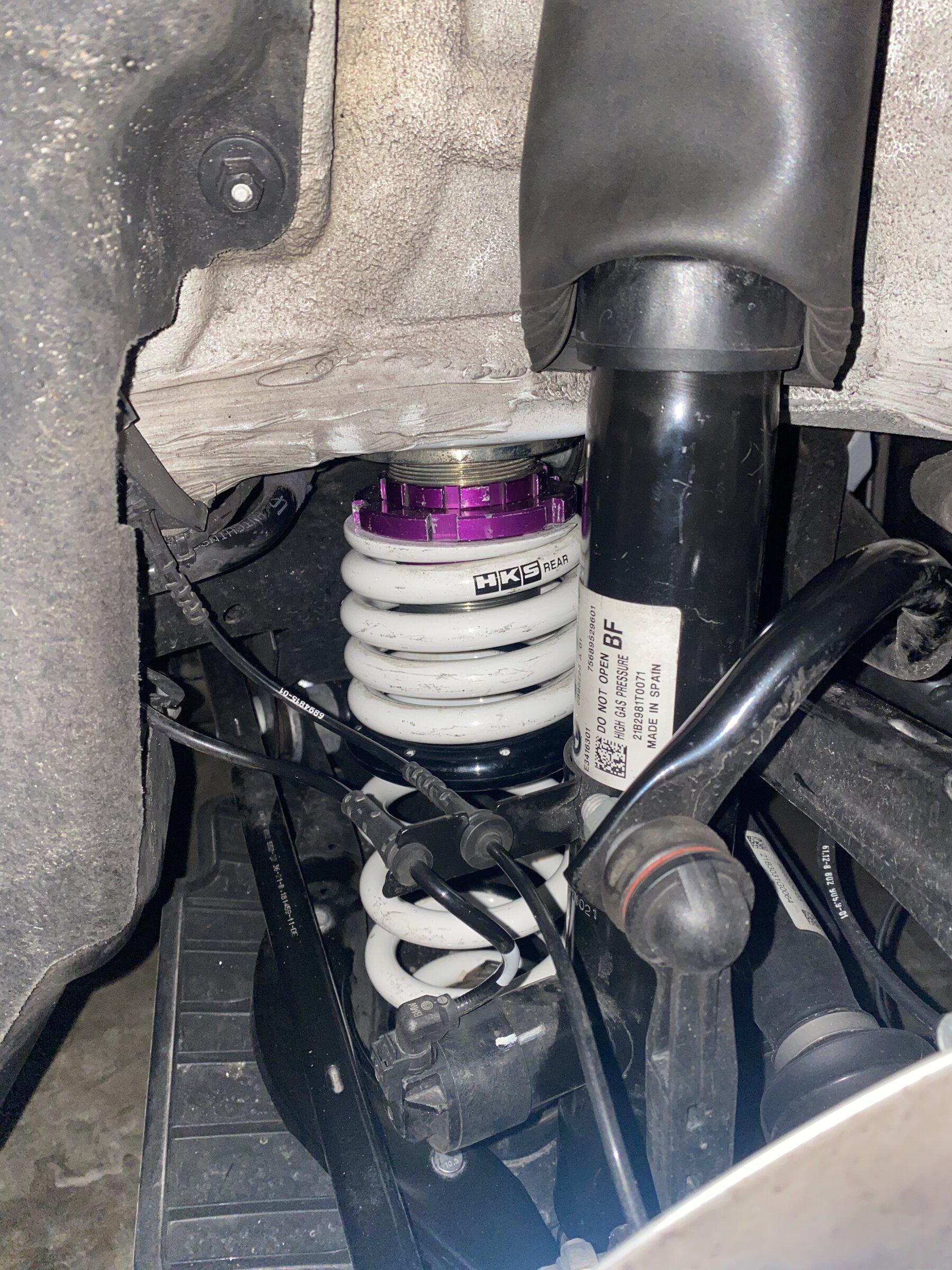

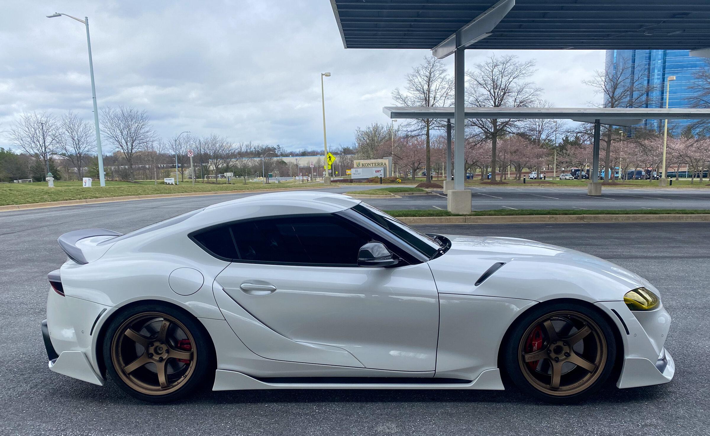

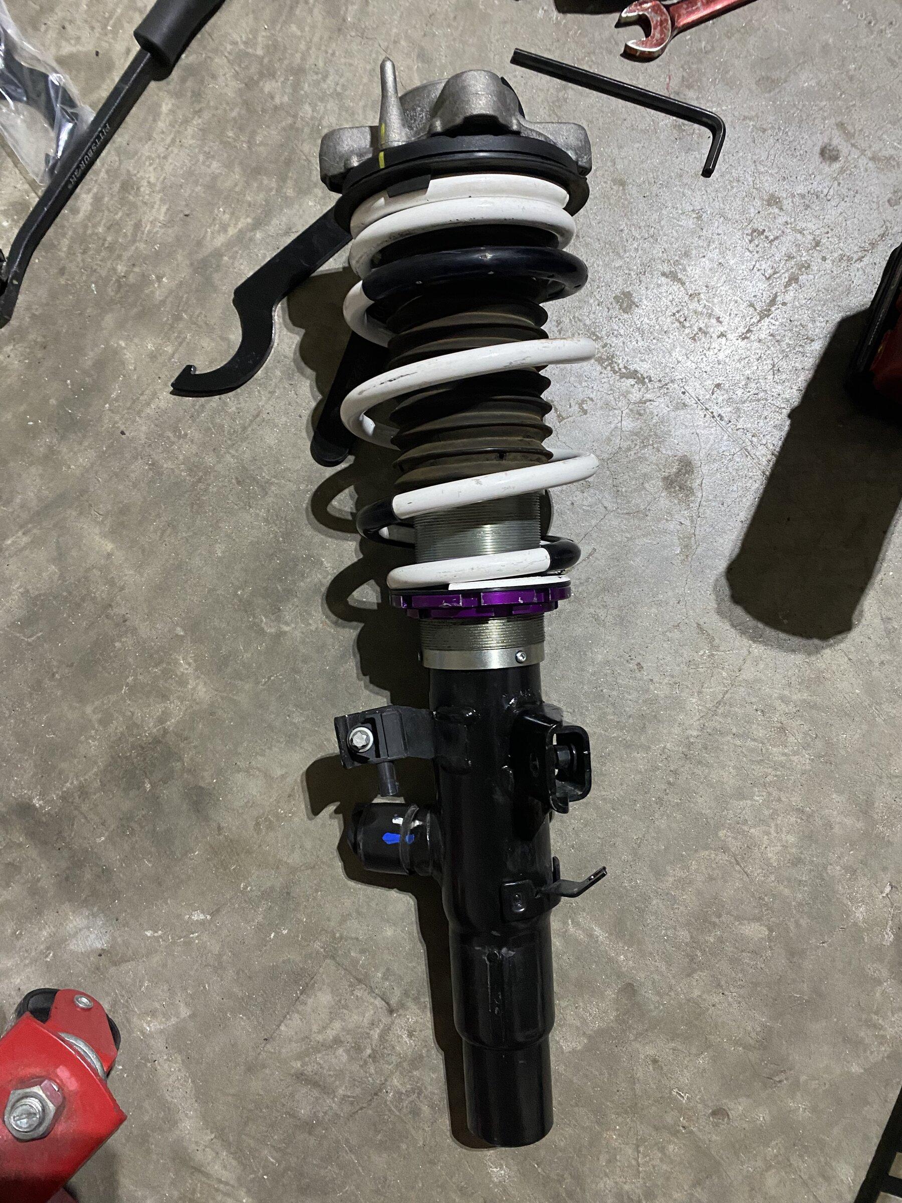

Back on March15 I got these Rays 57CR 19x10.5+35 for a steal square setup I’m going to use for track when I get new tires for them
also on March 18 I put on my HKS adjustable springs finally. I’m only able to run the square setup for this spec in the front because HKS replaces the oem spring perch
—fronts: set to 11threads
—rears: set to 7threads
Overall about a one finger gap all around. May change height after I get new tires
Took some cool pics too!!

Hard af. Good information too. What do you mean by only able to run a square setup? Aren’t you able to run the HKS touring springs on a staggered stock wheel set up?
JSmoothBui
JSmoothBui
Jimmy
Nov 25, 2021
40
259
146
Maryland
2022 Toyota Supra 3.0 Premium
Thank you! From research, running wide spec wheels in the FRONT WITHOUT a spacer can be easily done with the HKS Springs since the oem spring perch is removed and the HKS spring perch is flush around the strut instead of a wide piece like OEM.
I've researched that if I had put the 57CR square setup with oem springs/strut/spring perch, etc that the wheel would hit the spring perch (unless running a spacer, not sure what size exactly)
I have my oem wheels on the HKS springs right now actually no issues haha, but I do run them with spacers for aesthetics

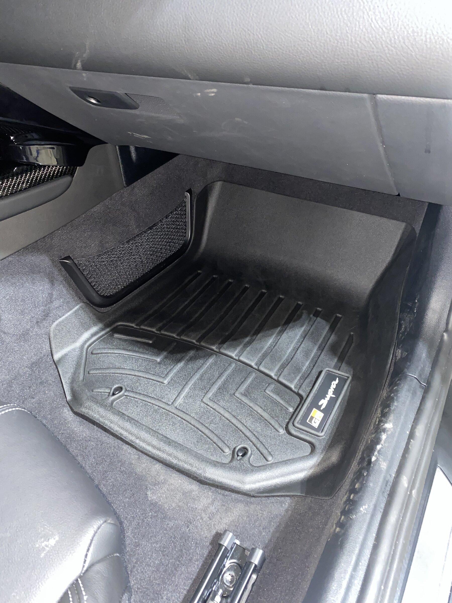

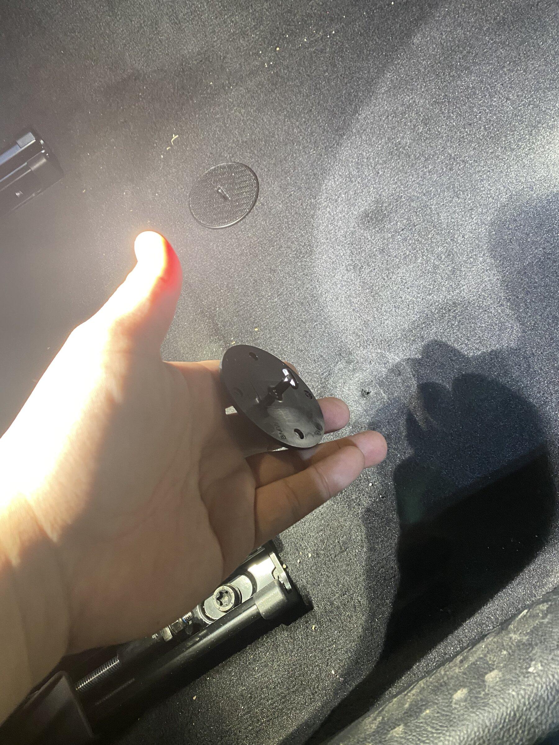

01/13/22

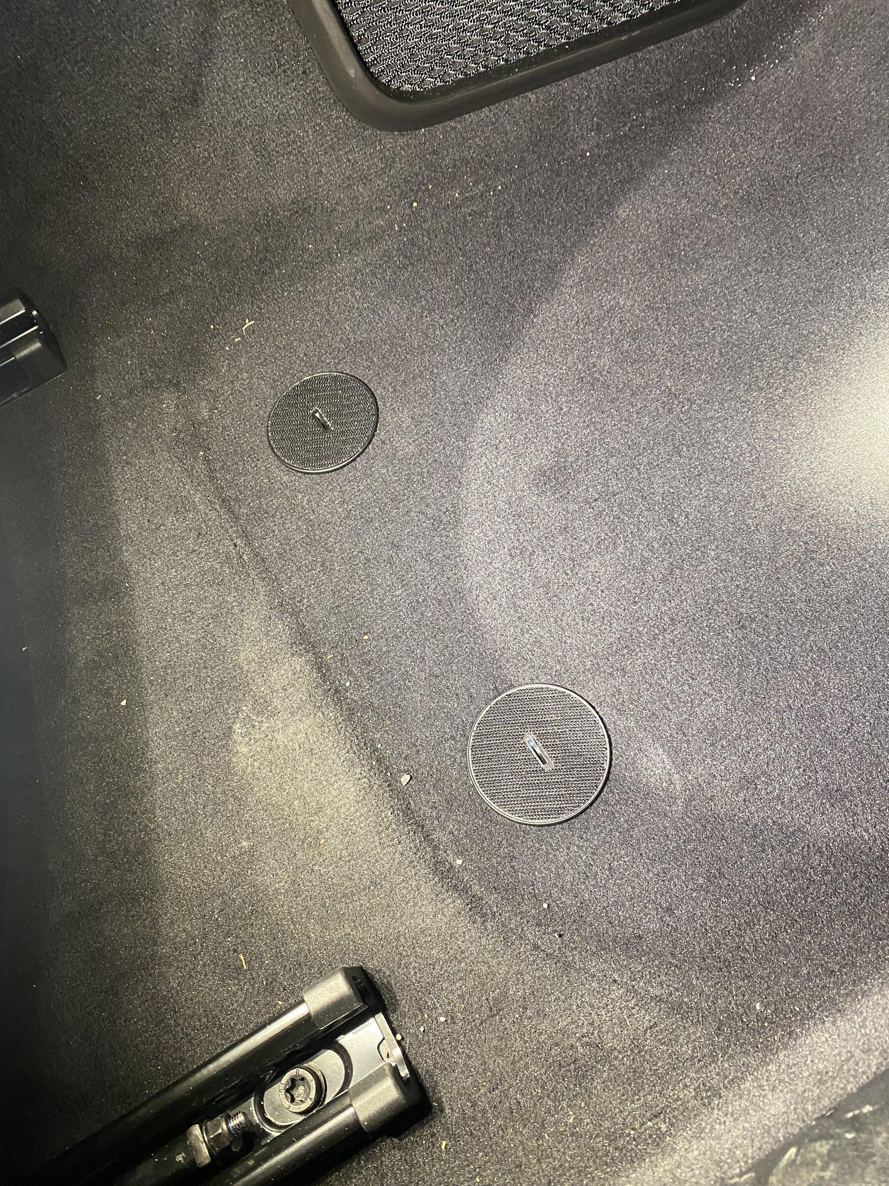

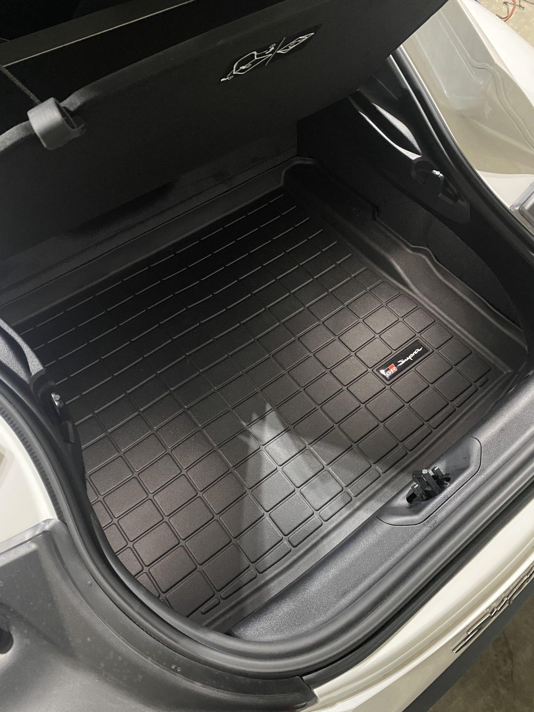

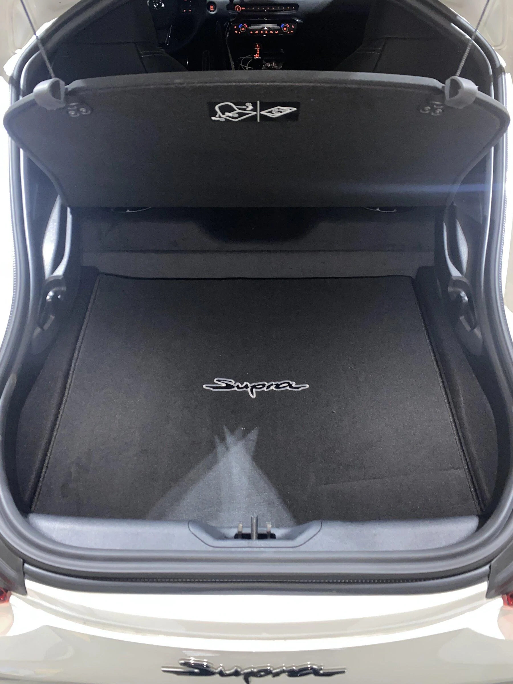

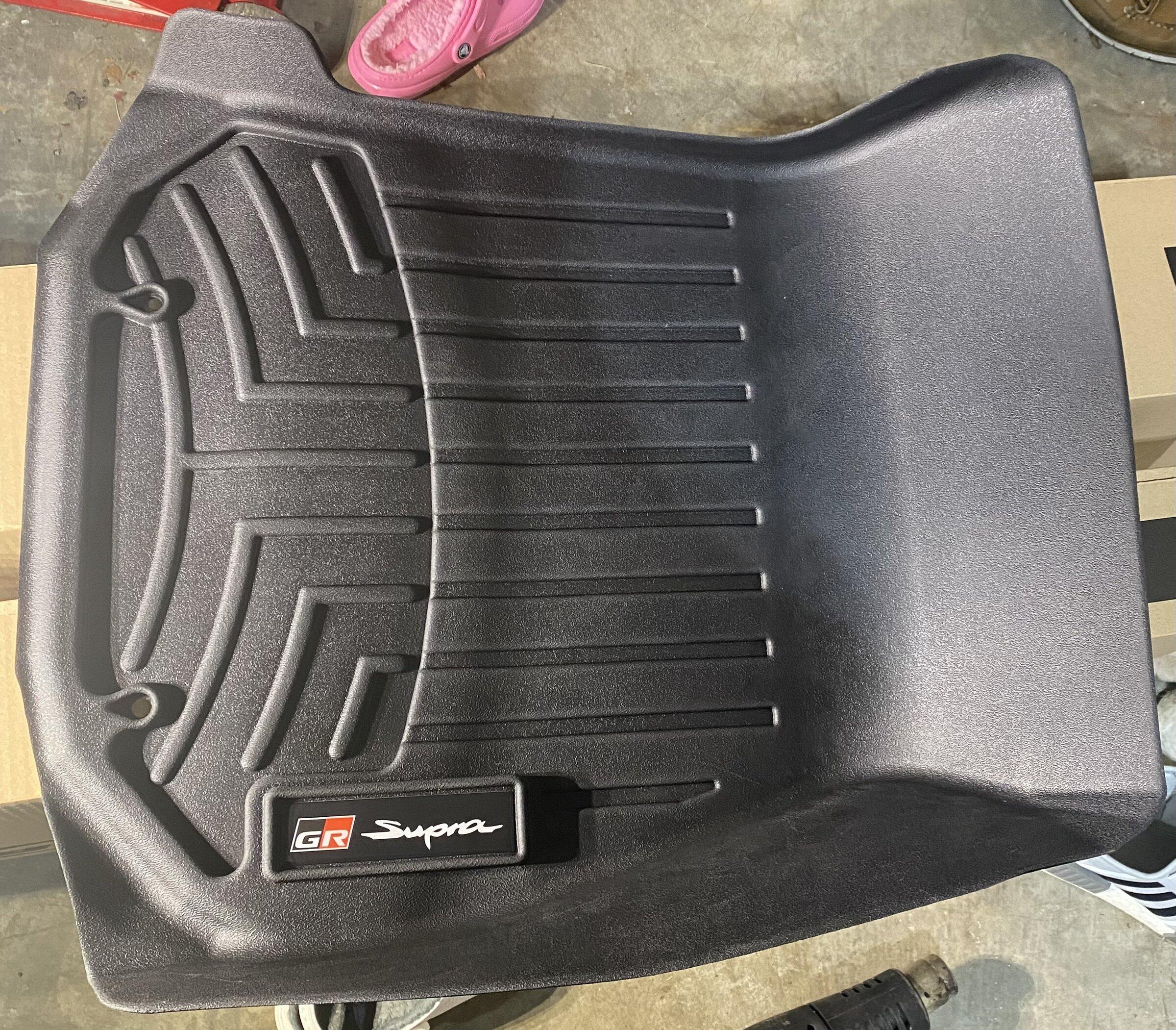

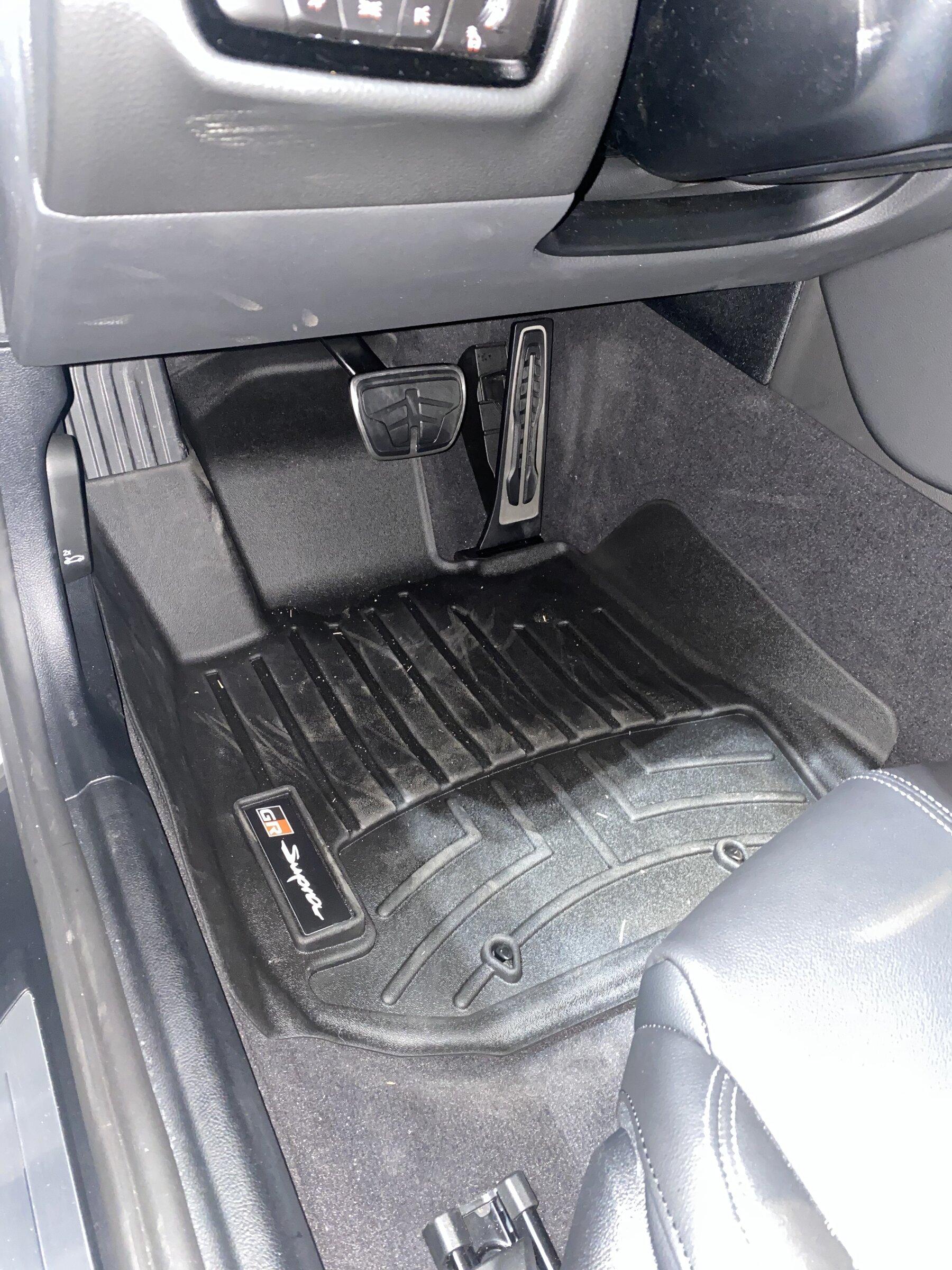

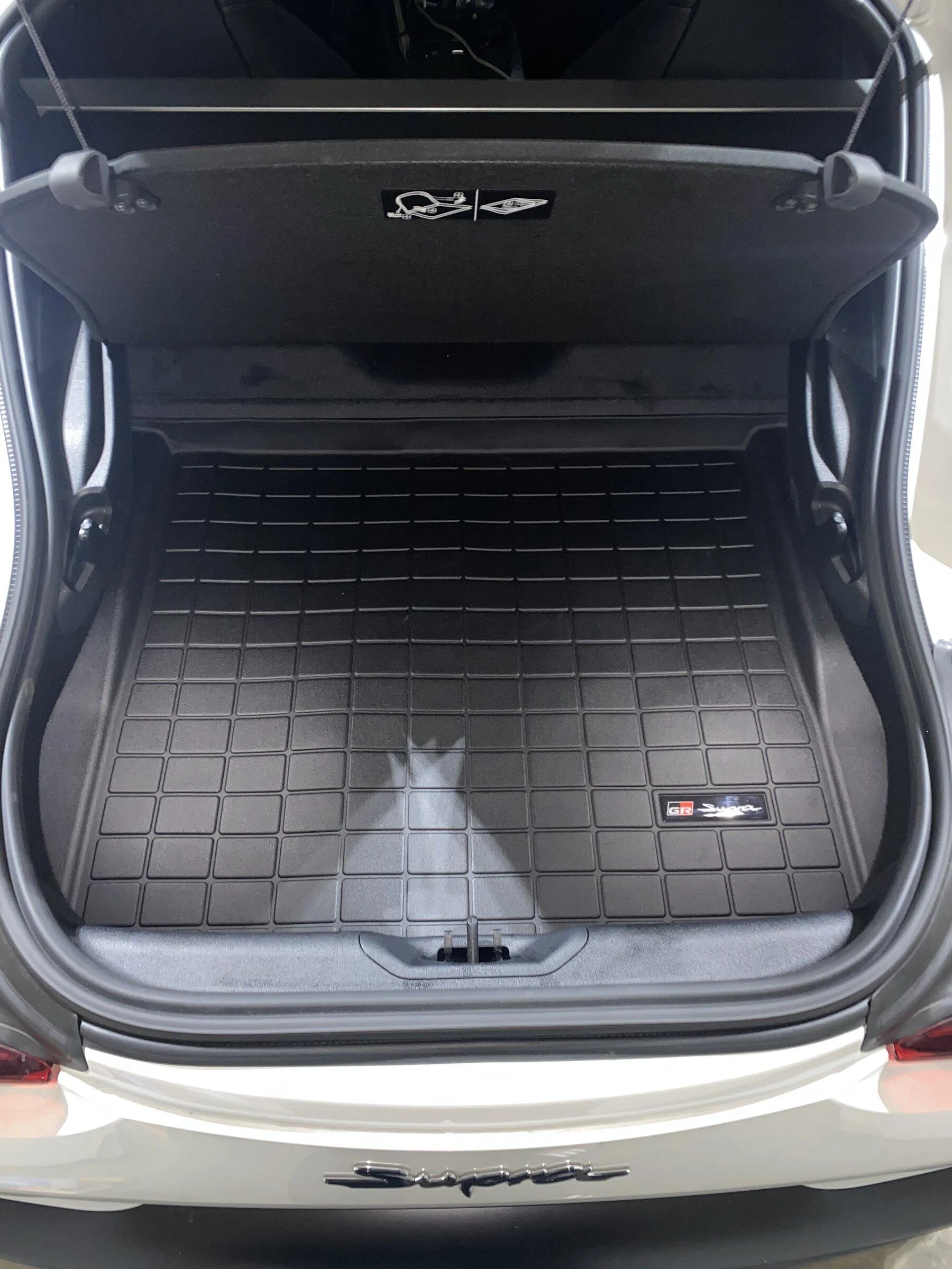

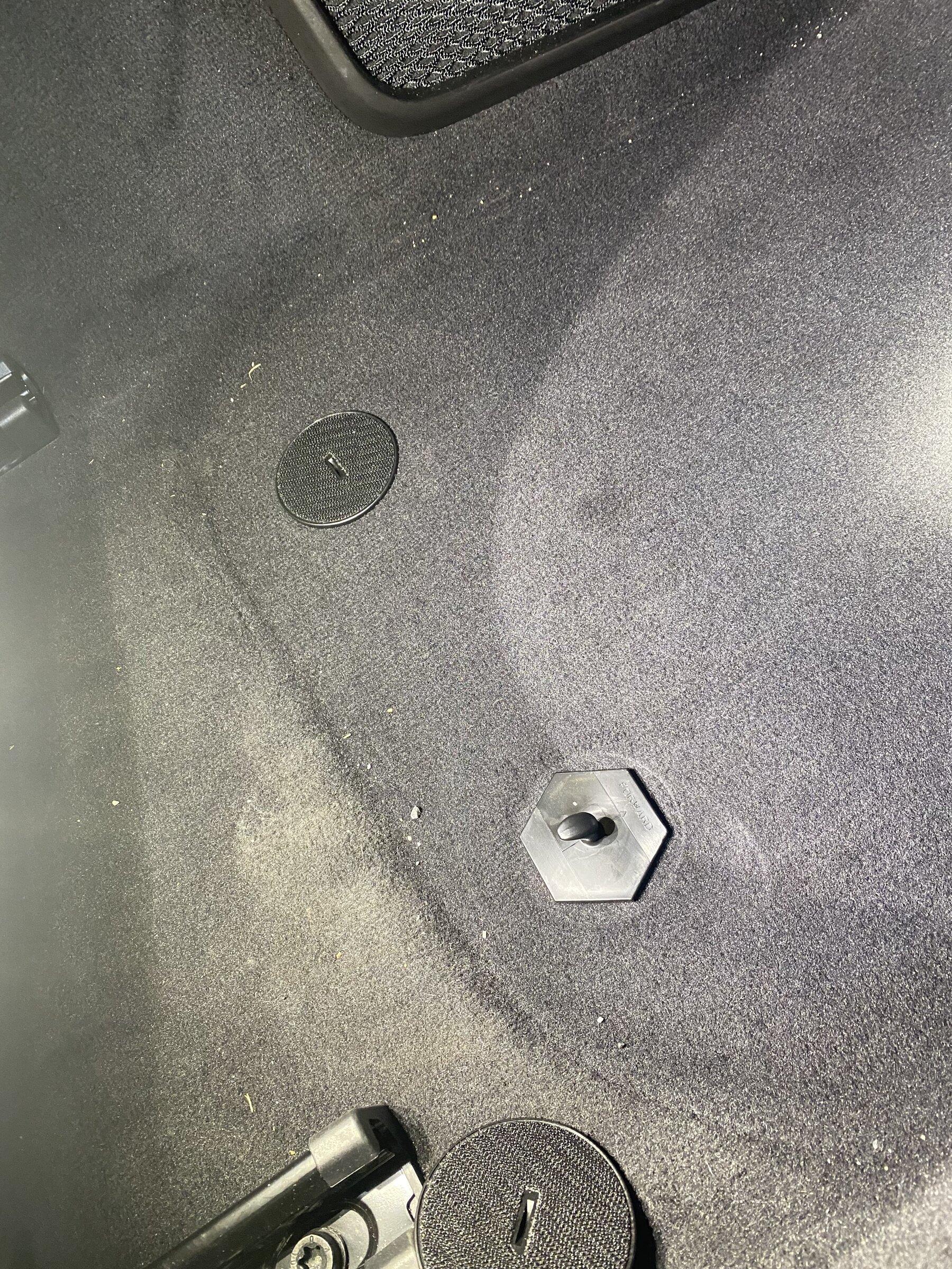

Weathertech Floormats & Rear mat with FTSpeed Supra replacement badges
-Link to badges: FT Speed Supra Badges
  • Tips for the floormats, lift the oem velcro holder up and twist counter clockwise and pull out. Can see in the pics below

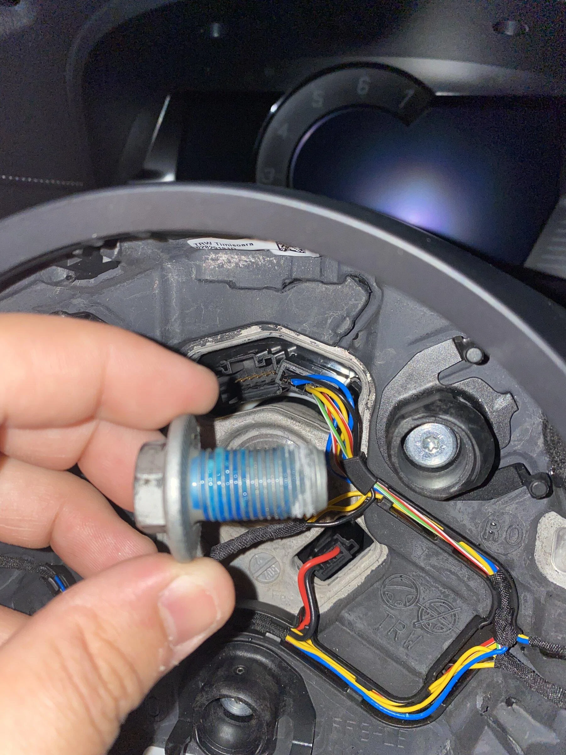

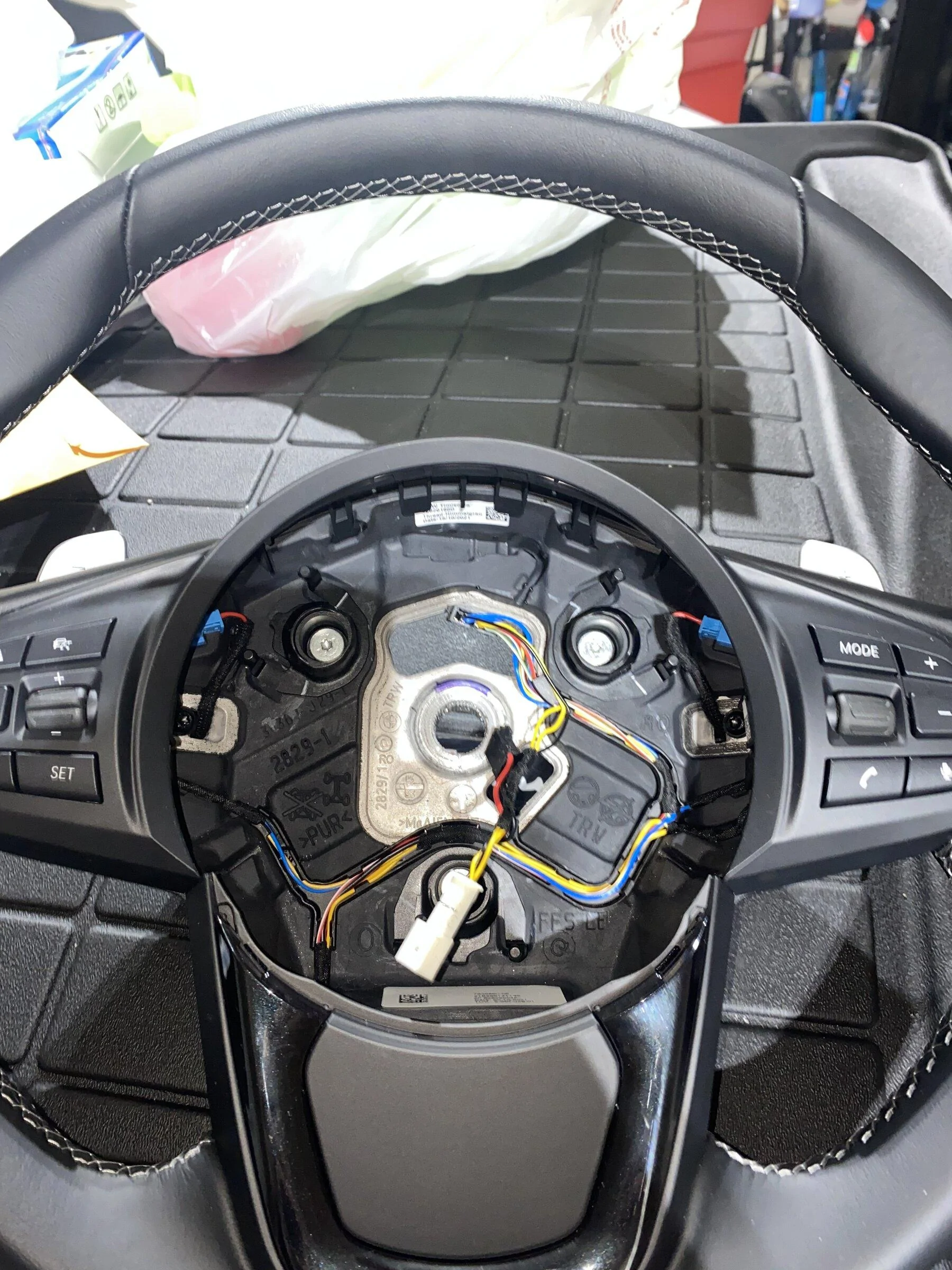

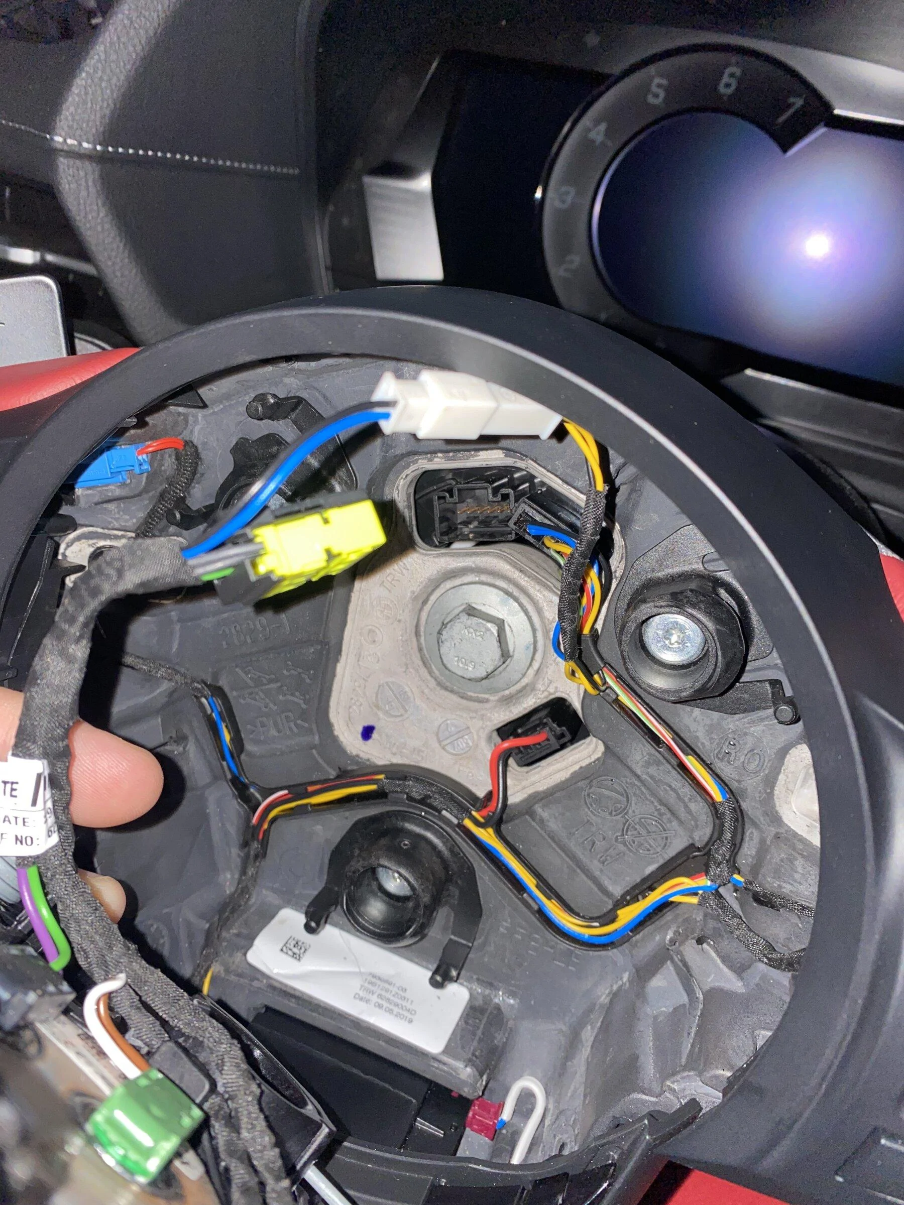

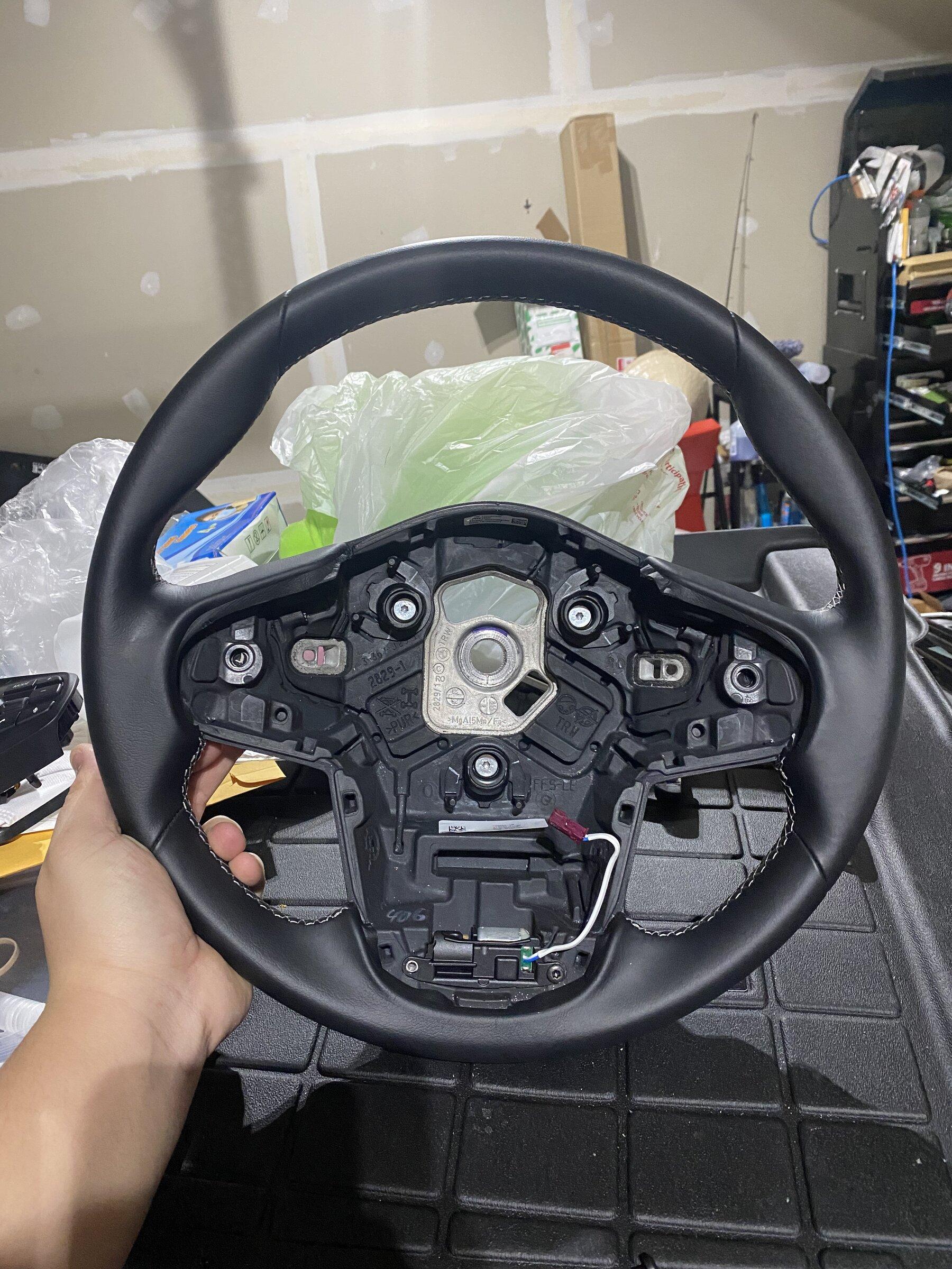

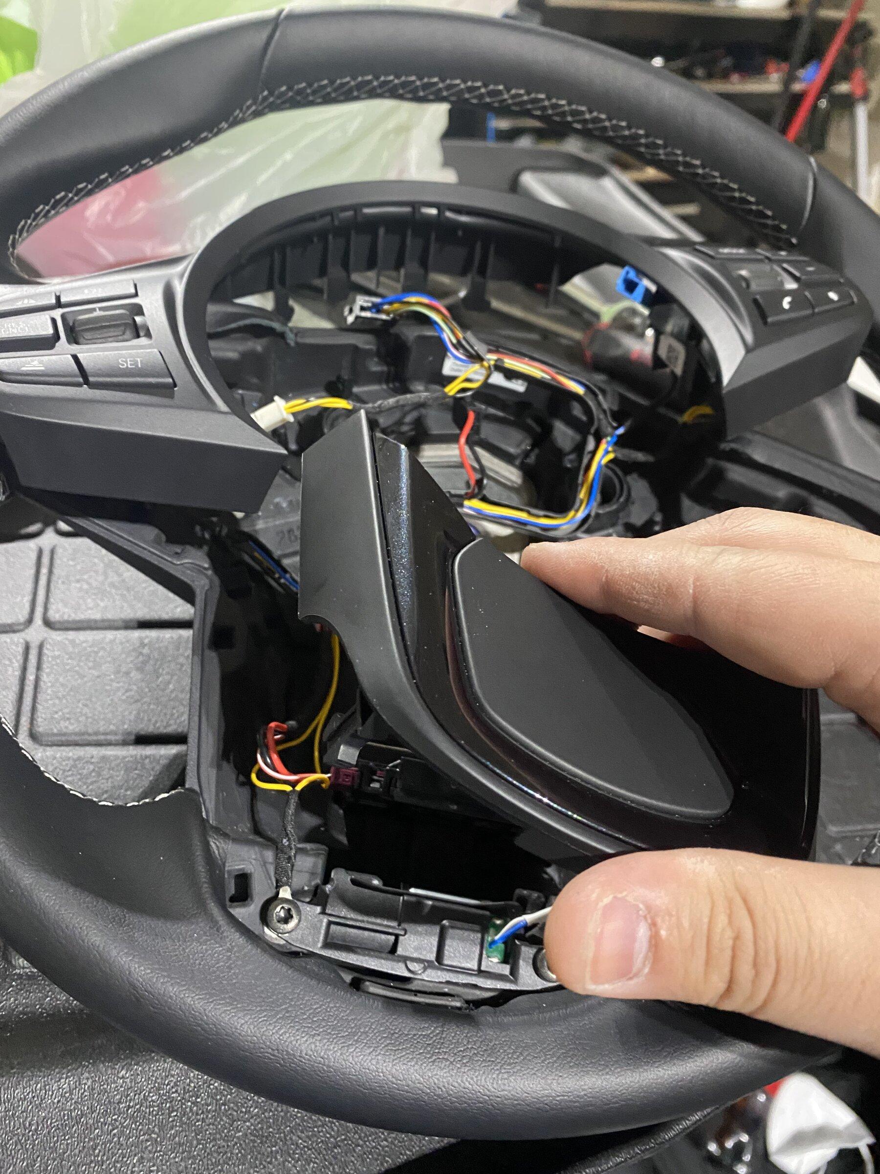

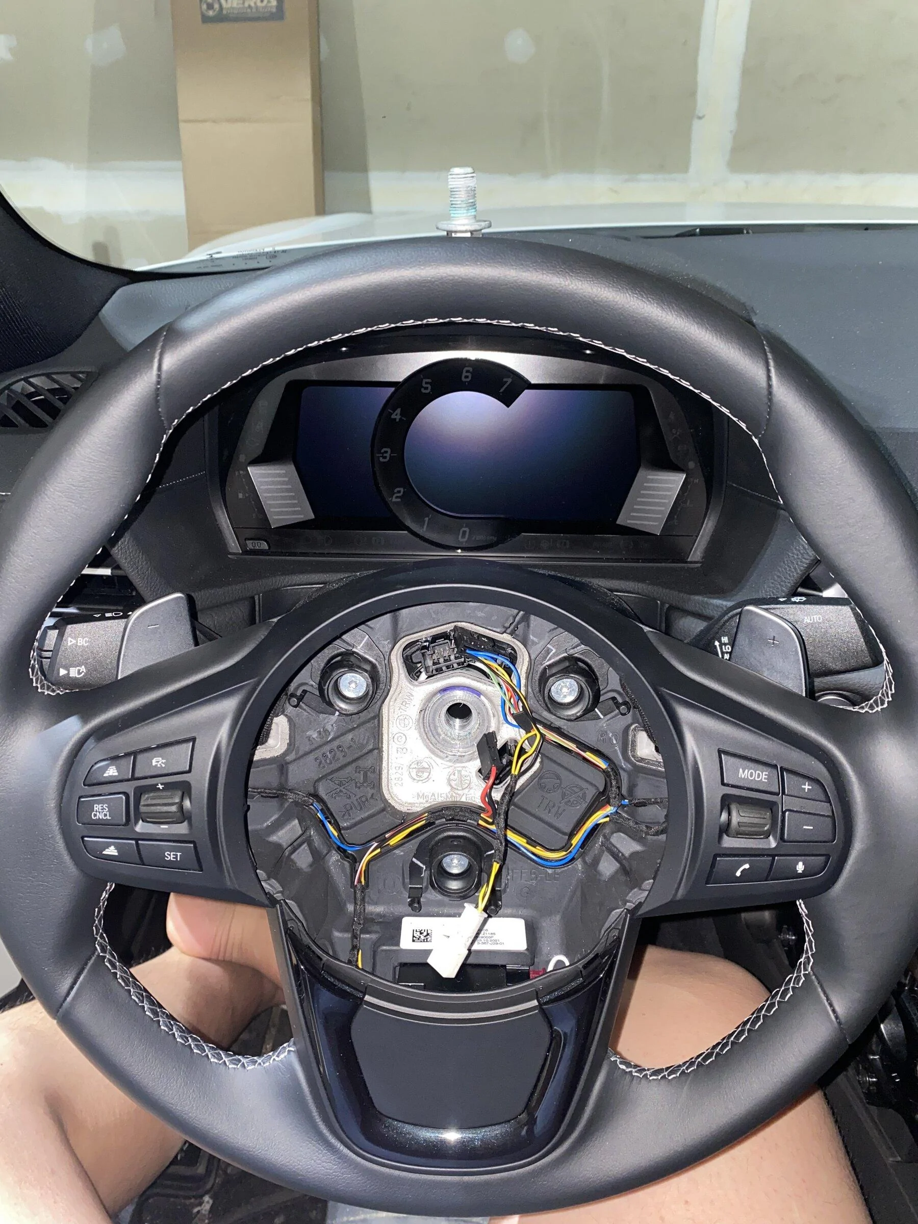

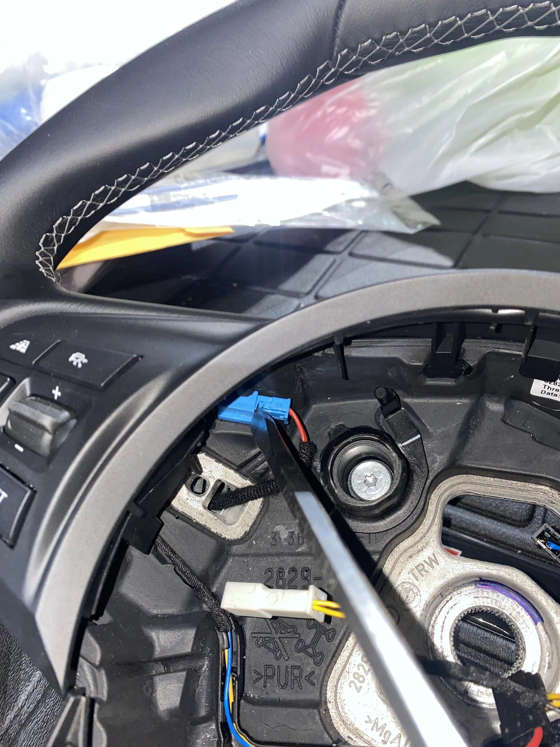

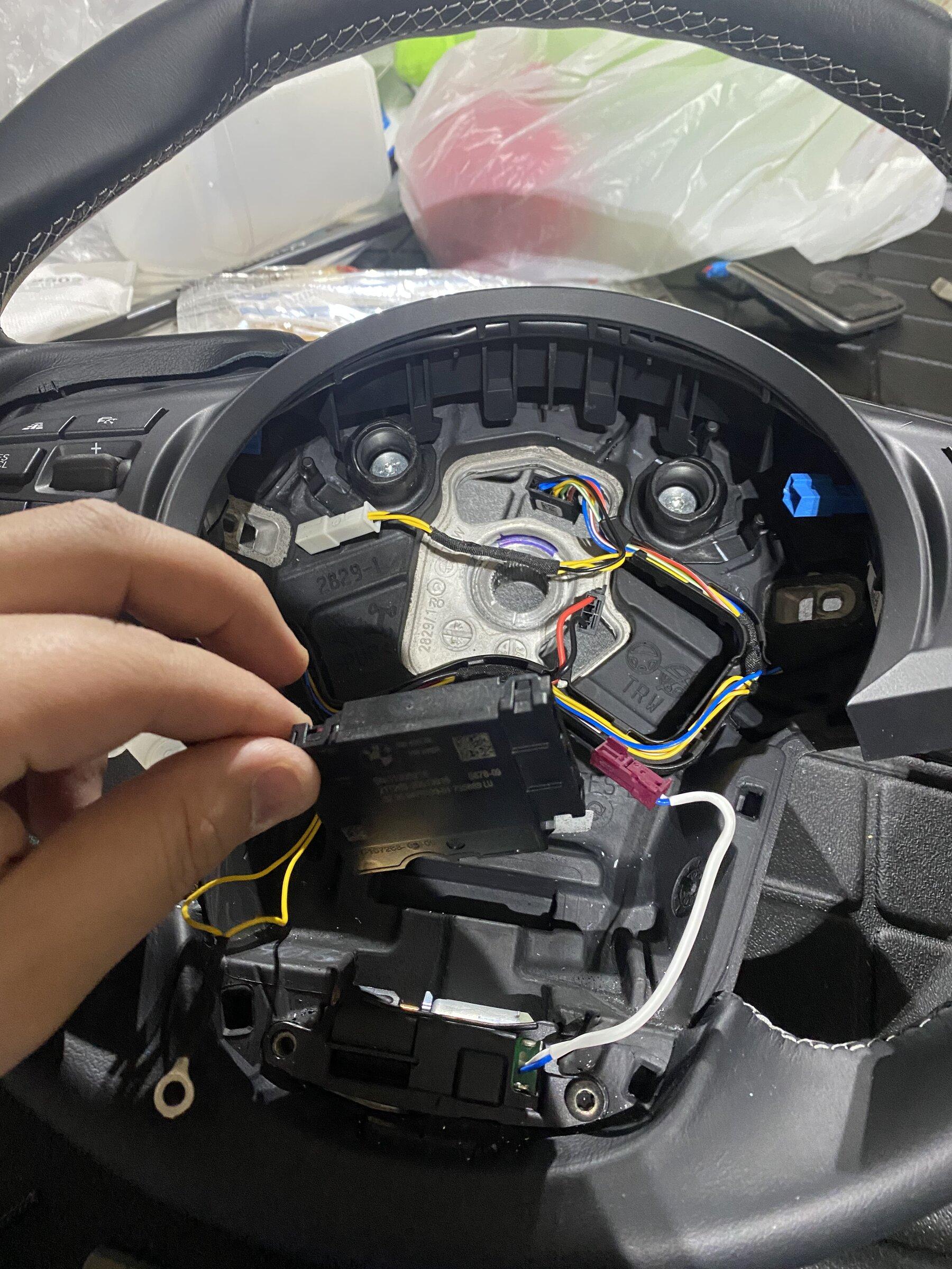

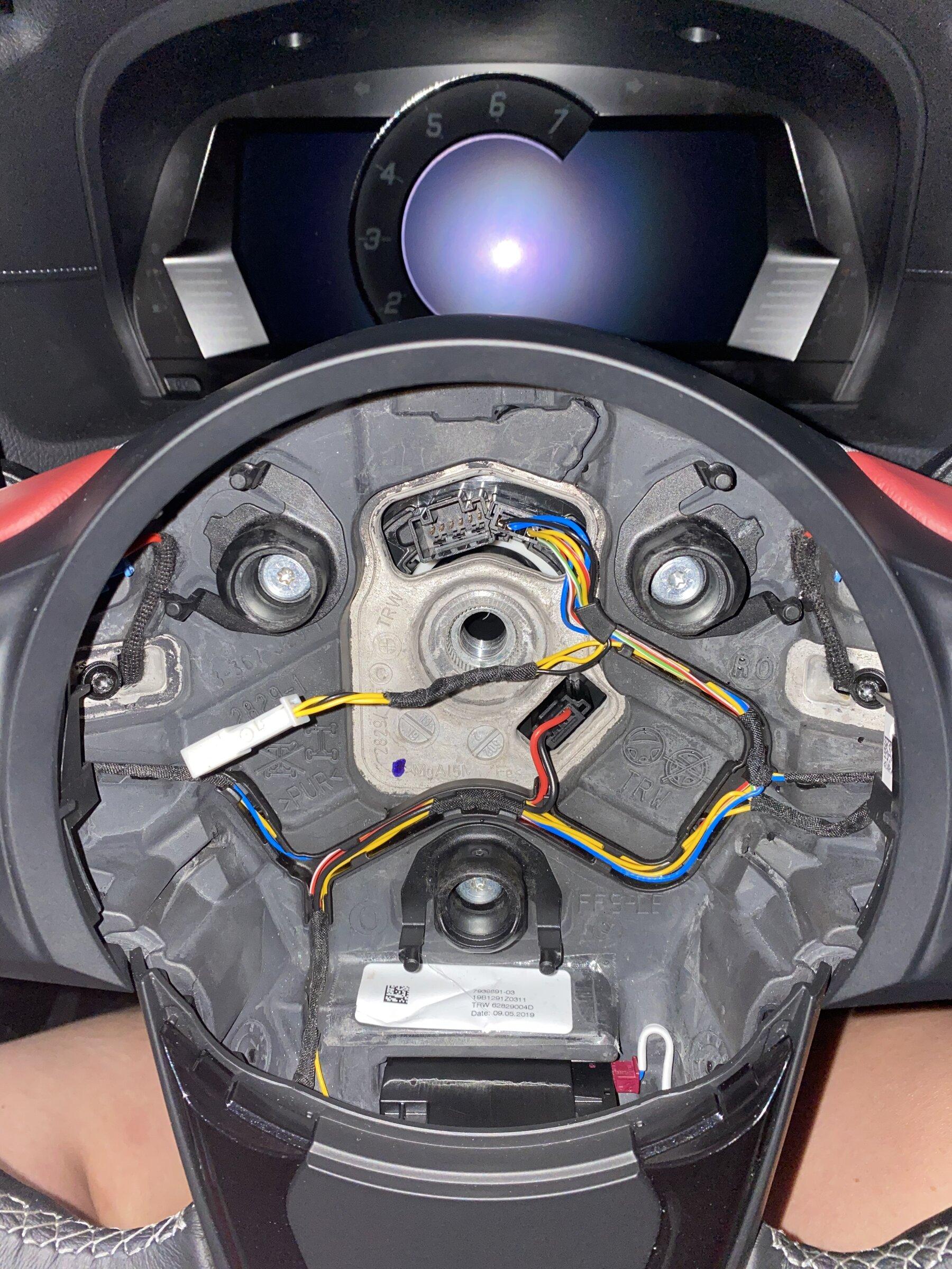

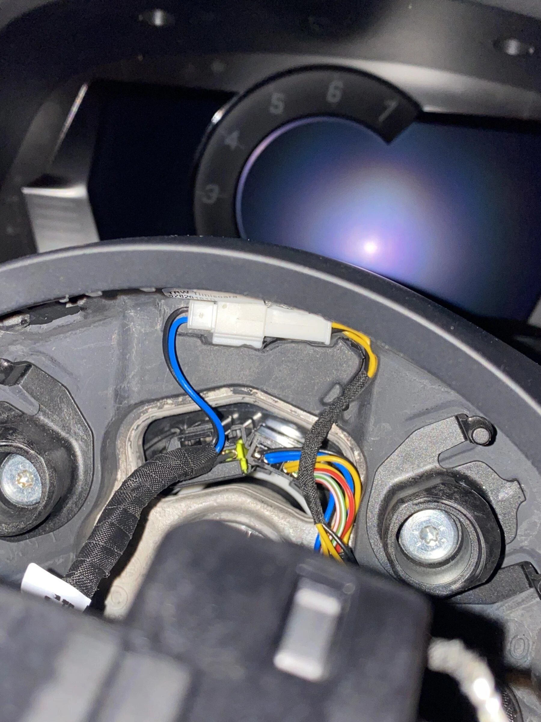

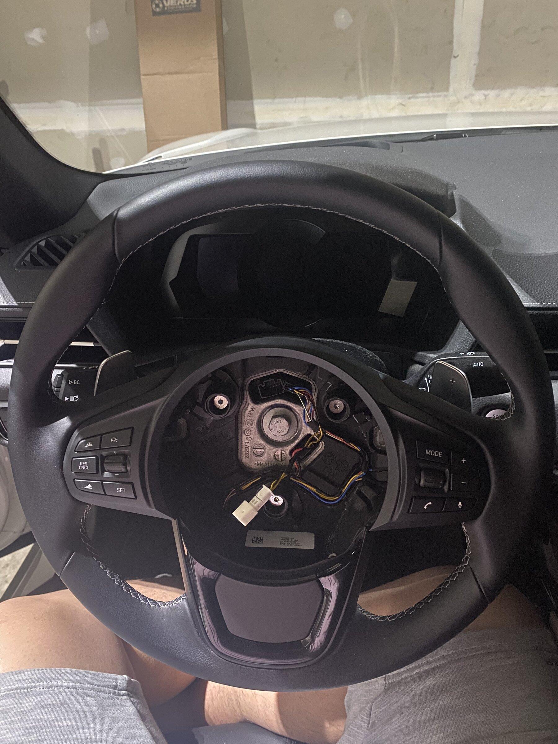

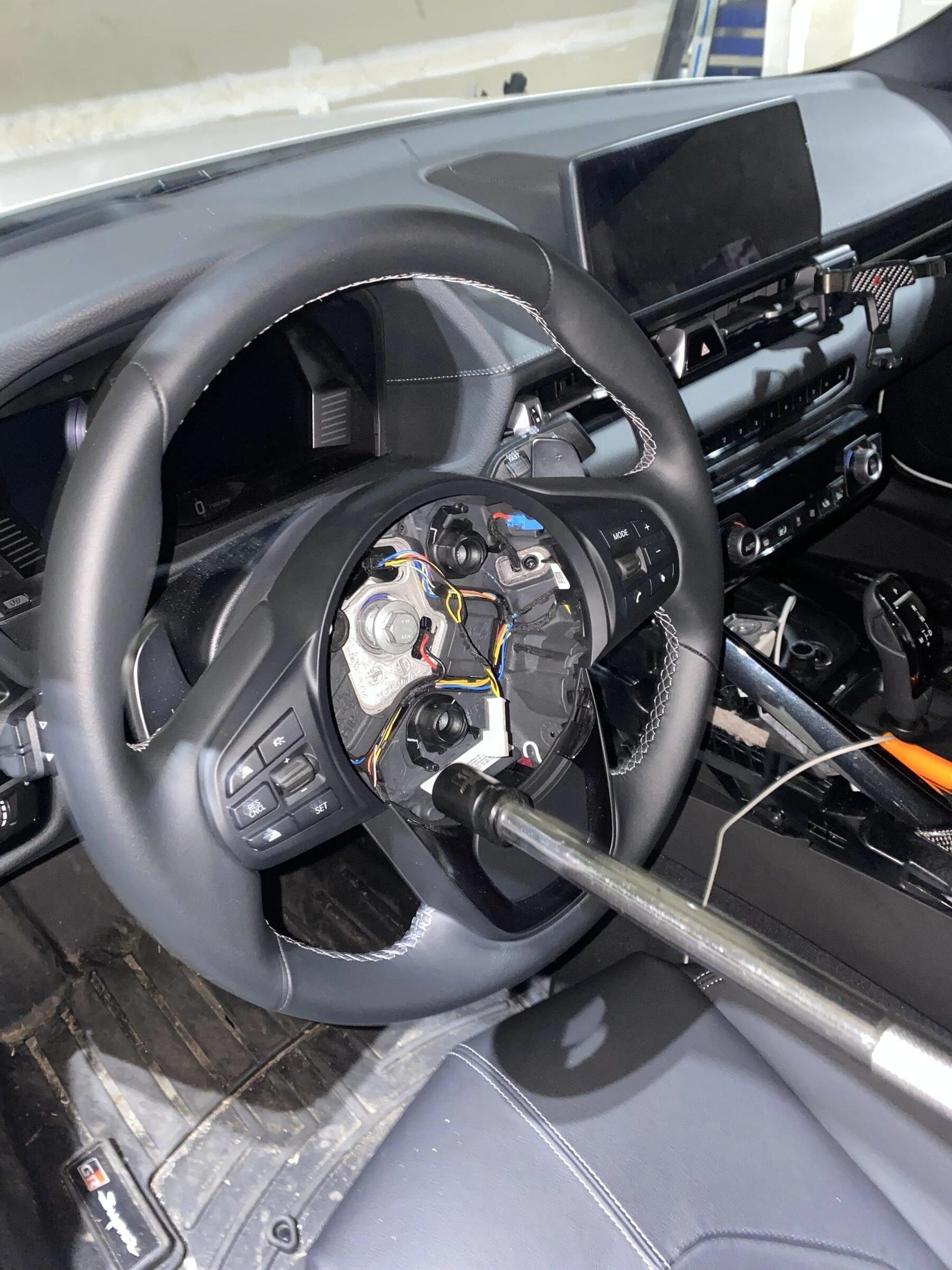

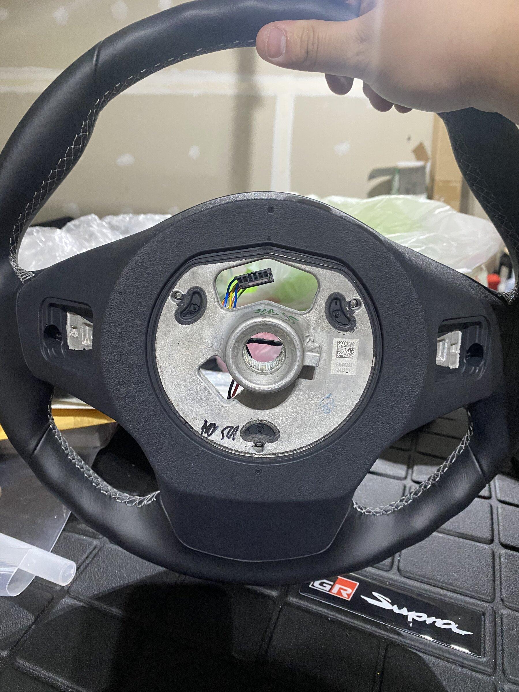

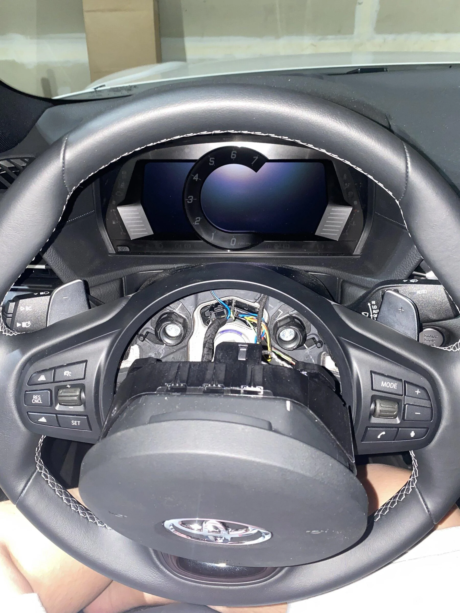

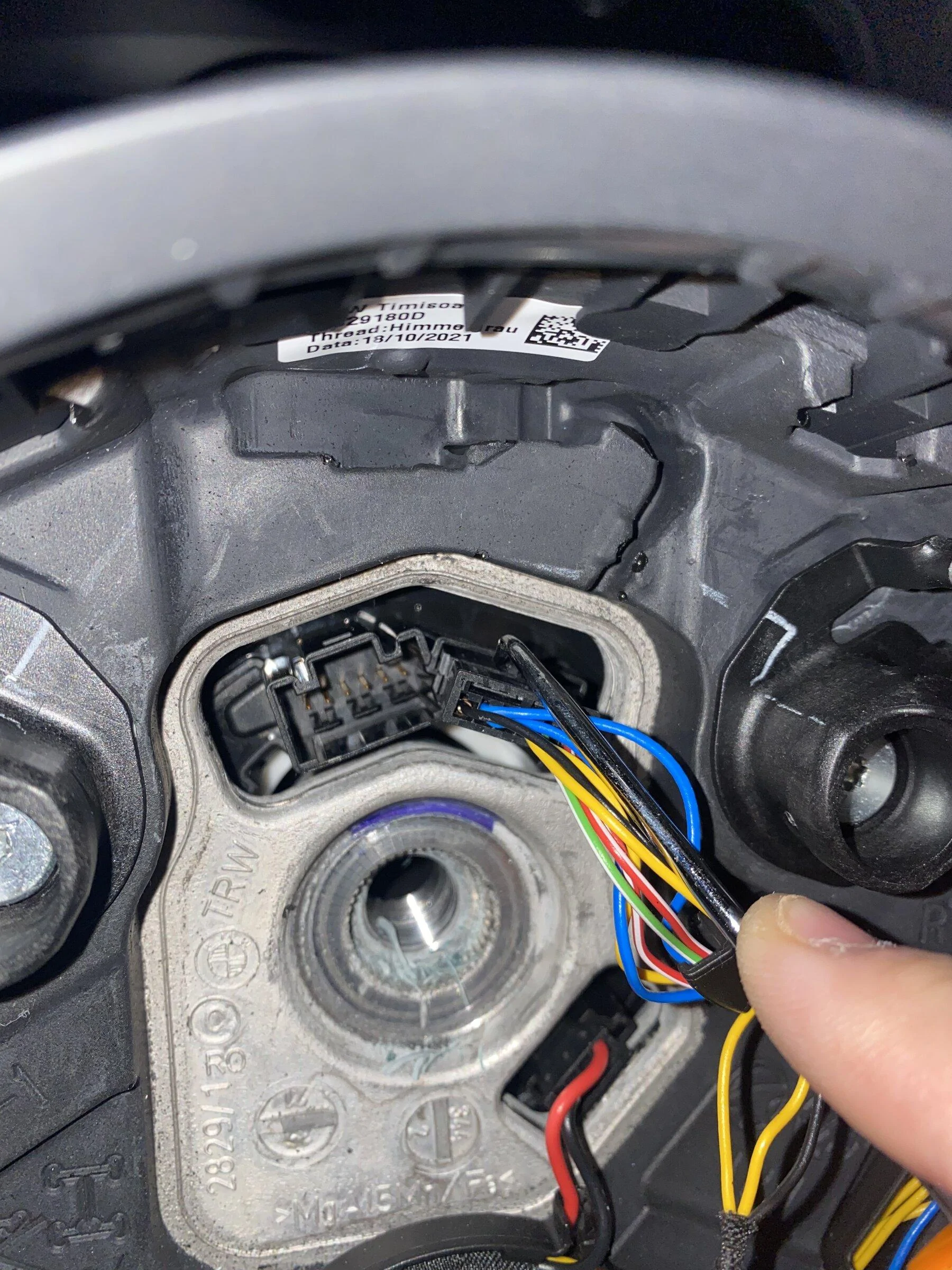

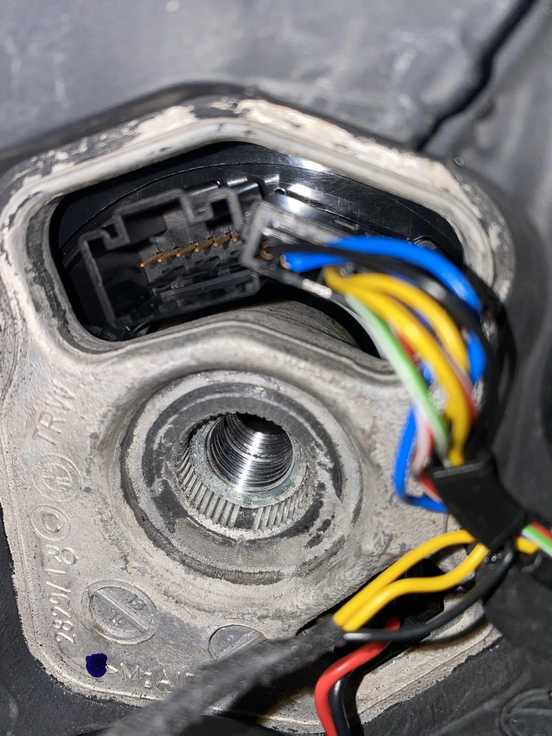

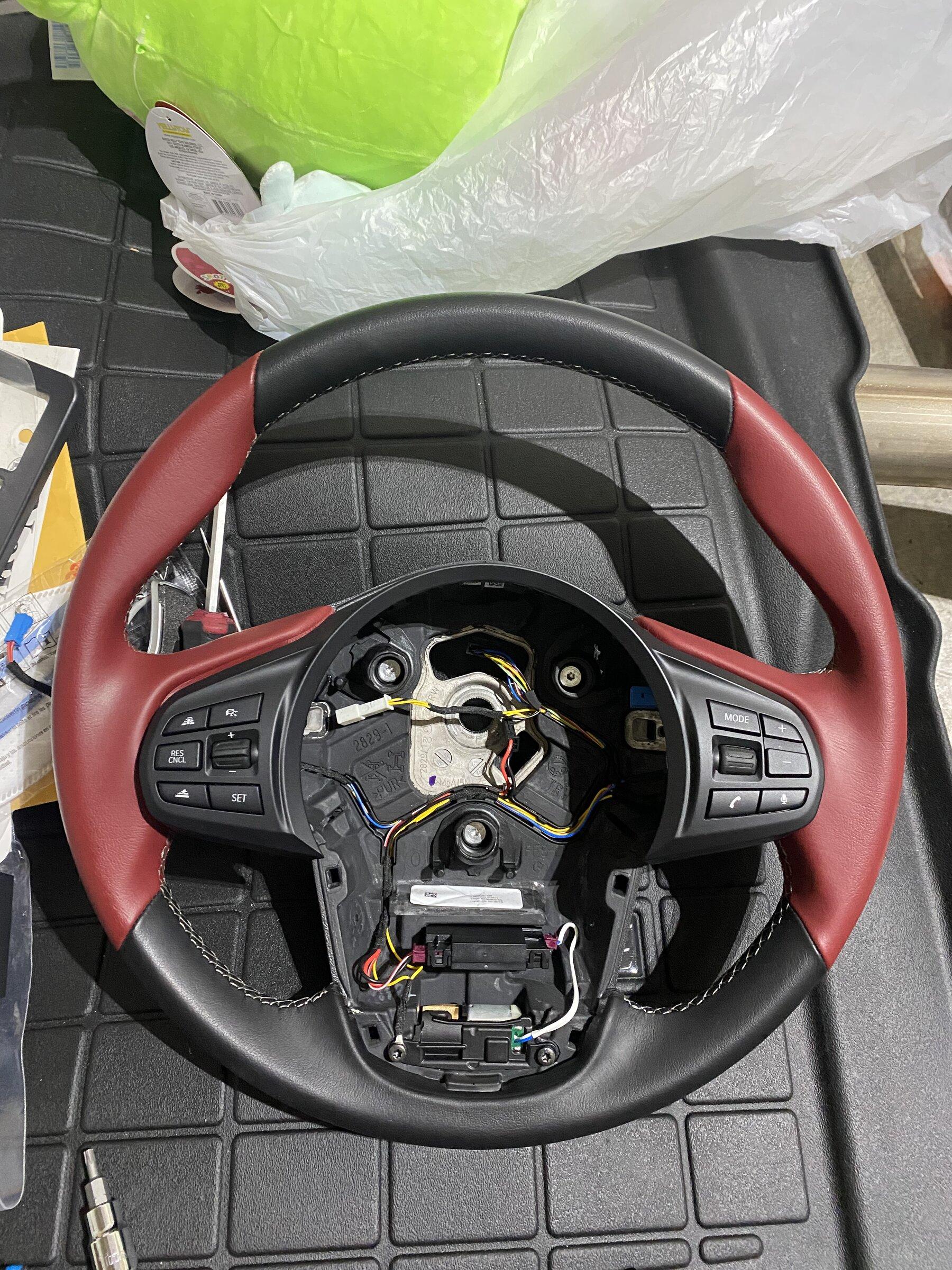

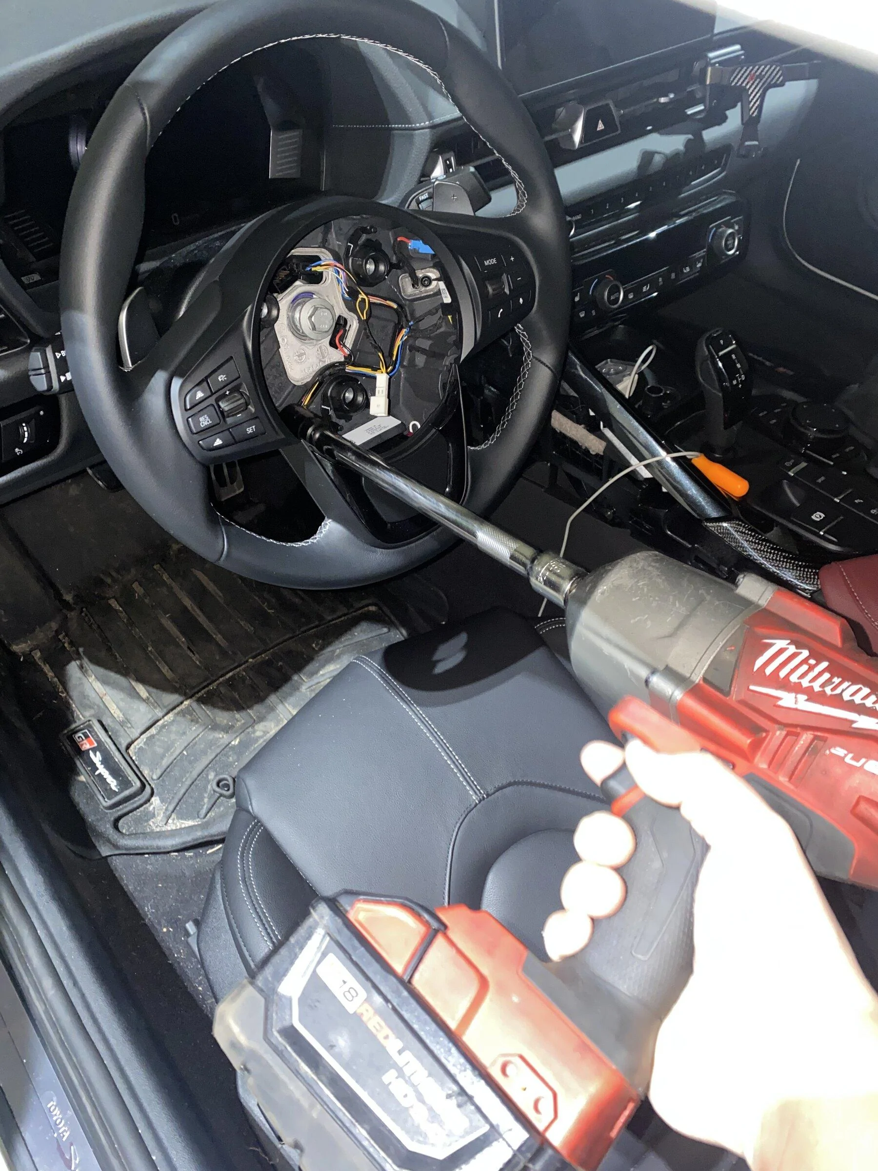

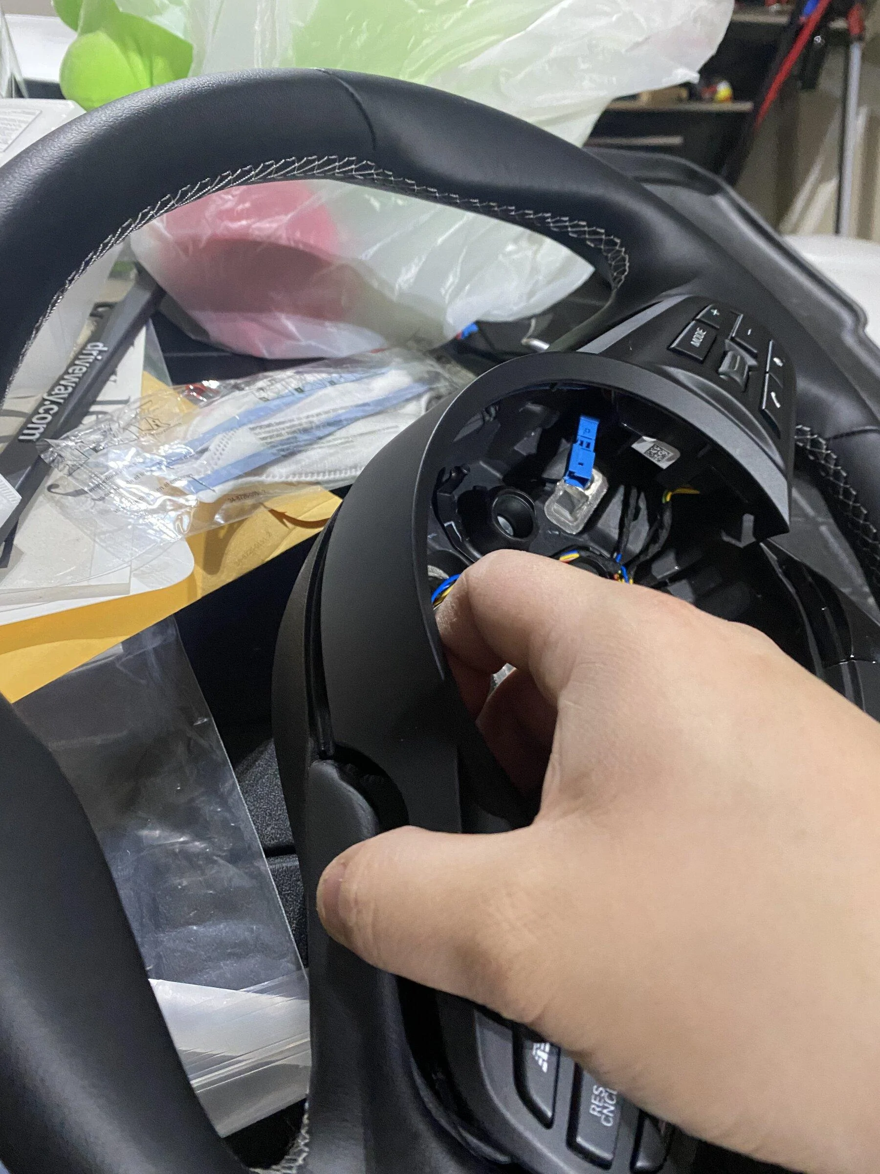

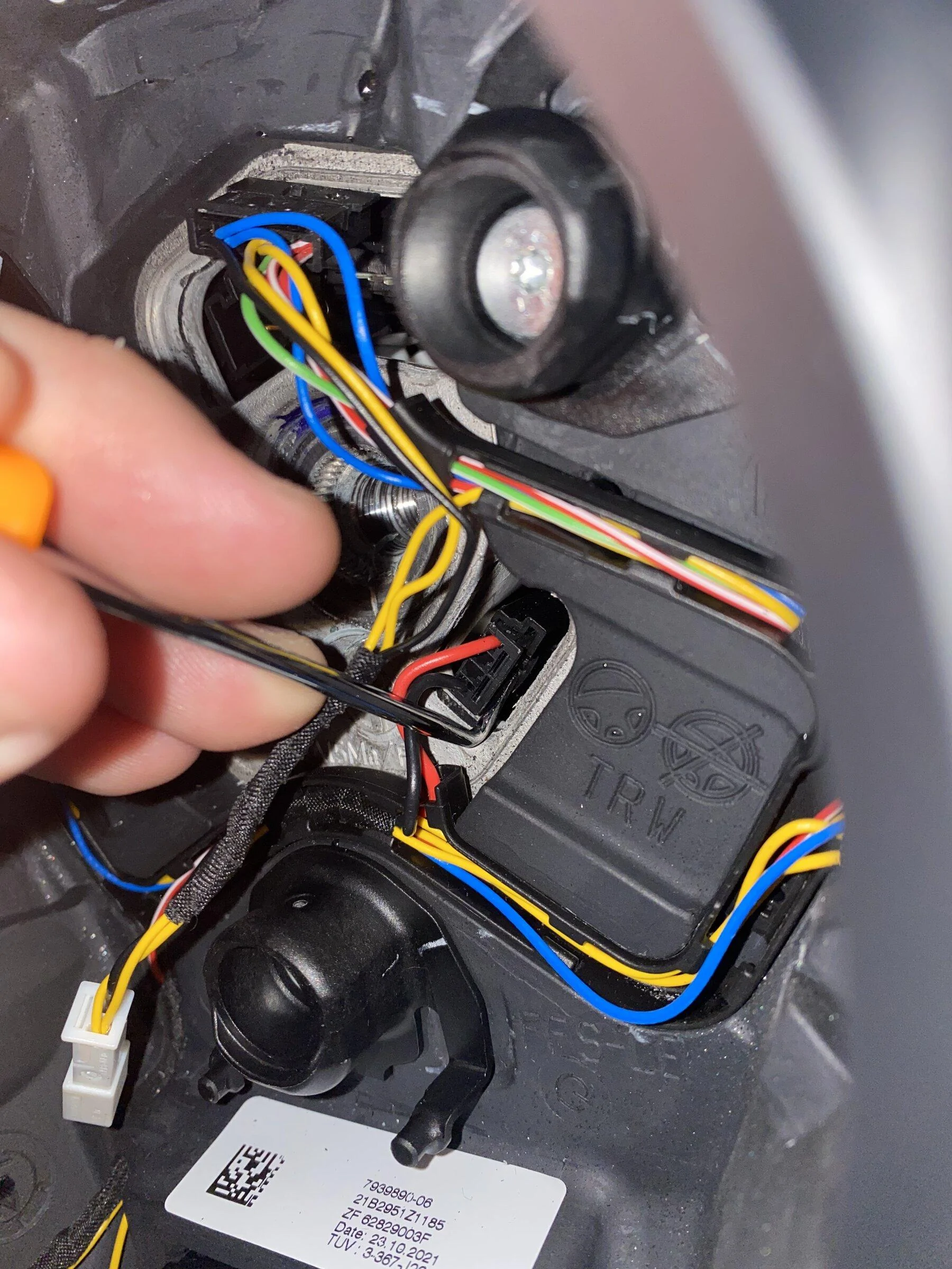

Photo dump of the steering wheel removed and my new to me Launch Edition steering wheel when I did it back on March 8
-T20 bit holding the paddle
-16mm center steering wheel bolt at 46ft lbs torque spec with blue loctite
-pick tools, flat head, philips screw drivers help
popping out the airbag was probz the most annoying lol. Tip for me was to do the right side first to get the right side and bottom clip to go out first since those pop same time on right side. The left side easier since just the solo left clip goes out

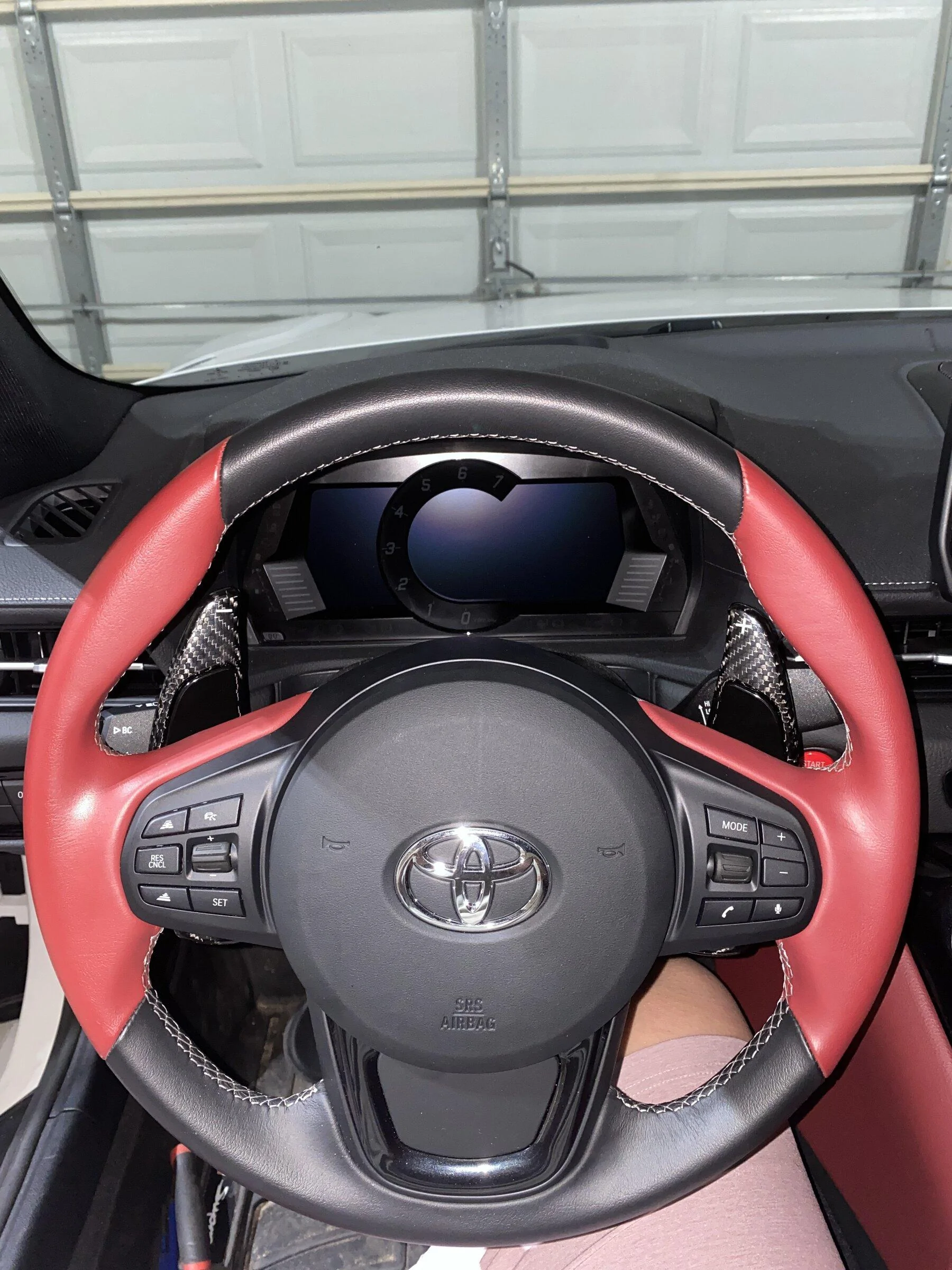

04/04/2022

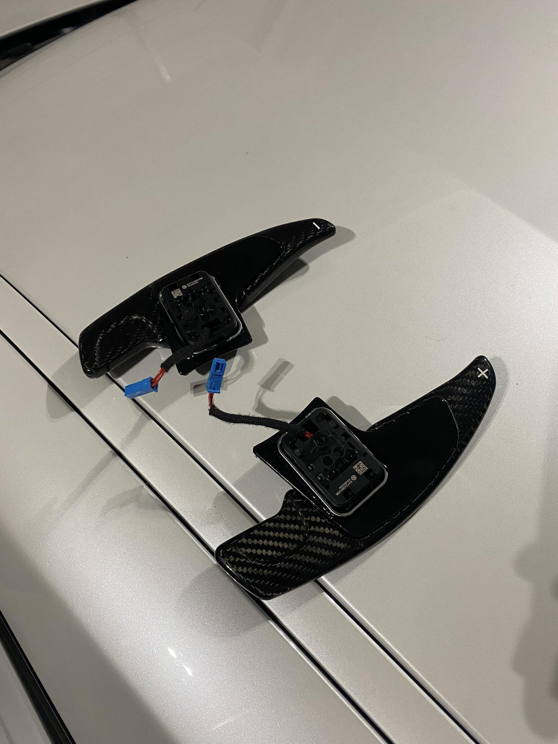

got these rexspeed cf paddle shifter addon pieces awhile ago used
I endedup wrapping the oem silver paddle shifters and added the cf paddle add ons over it. Looks pretty good and feels great when shifting!

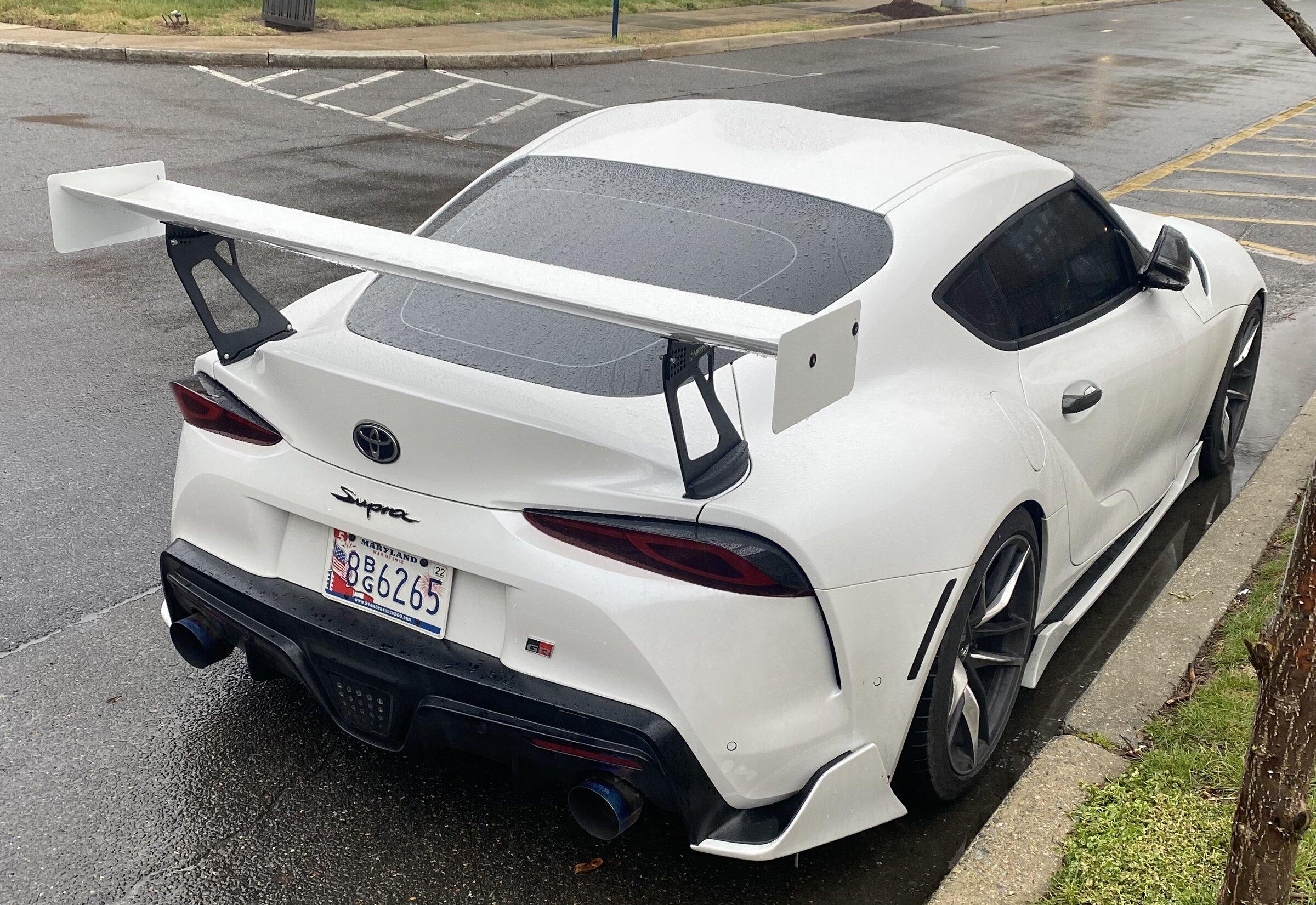

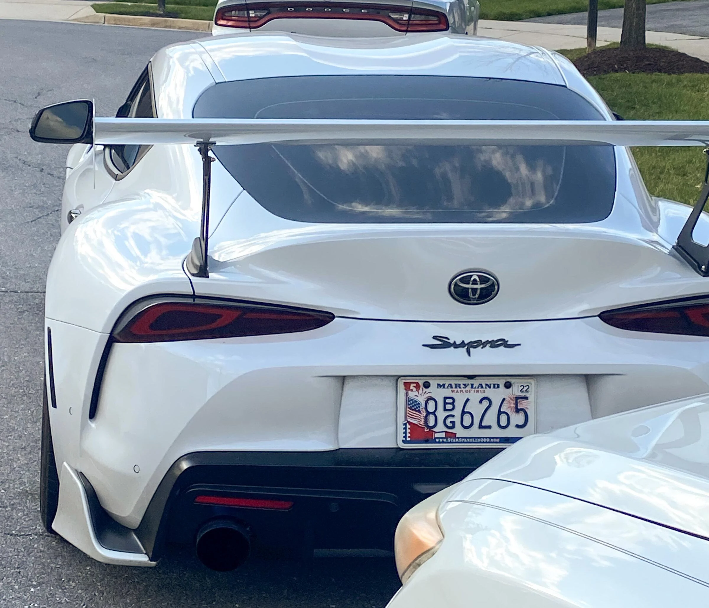

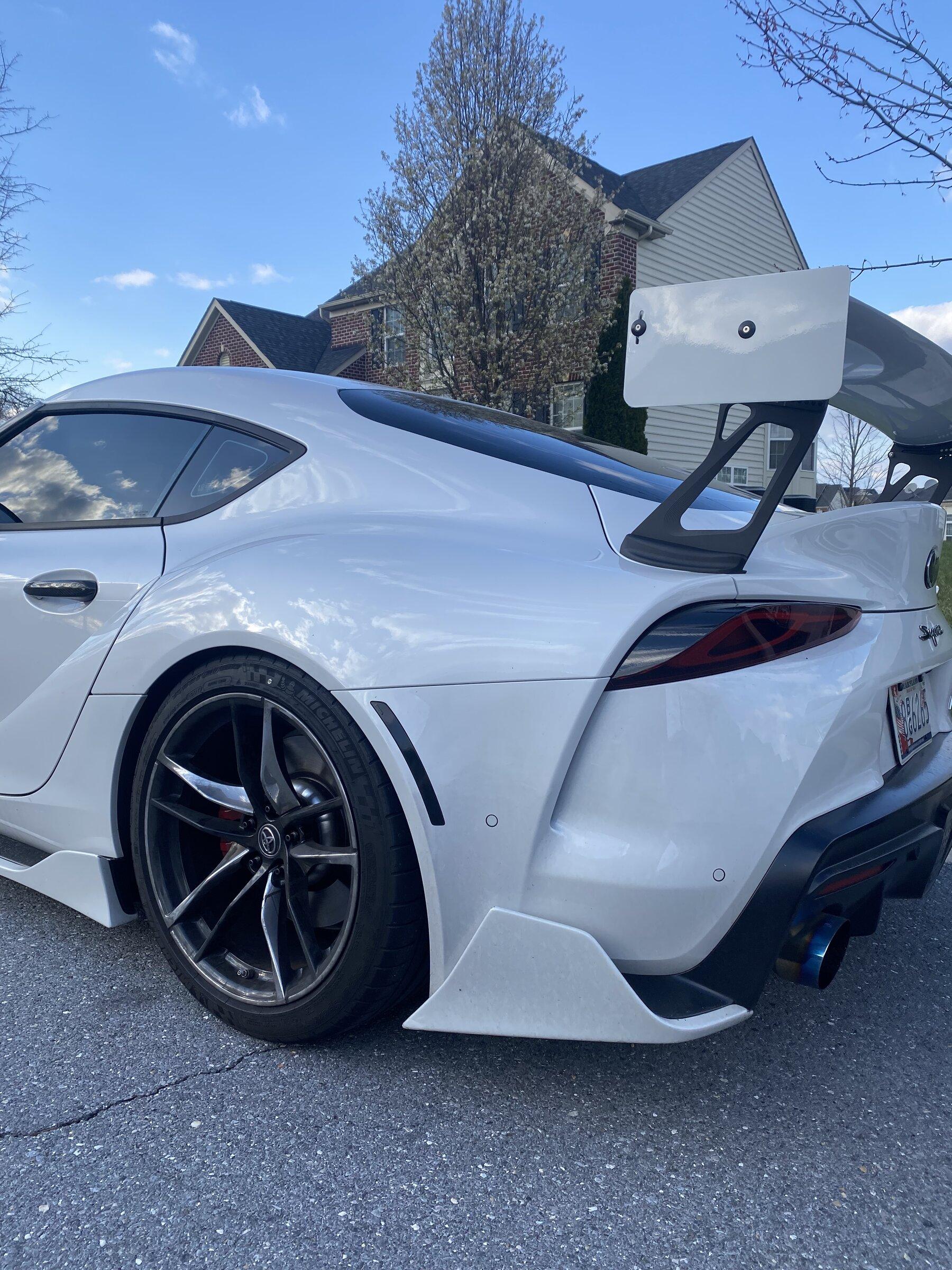

04/03/2022

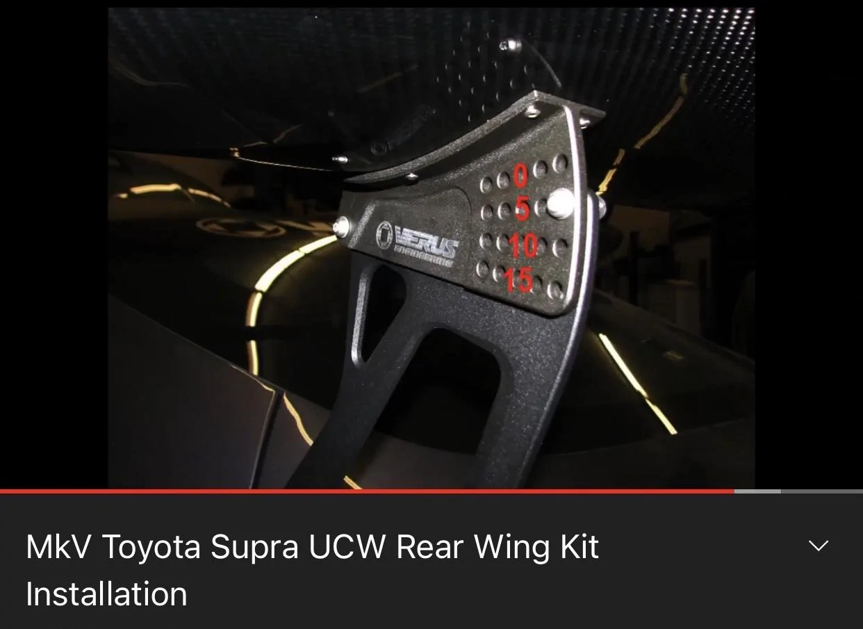

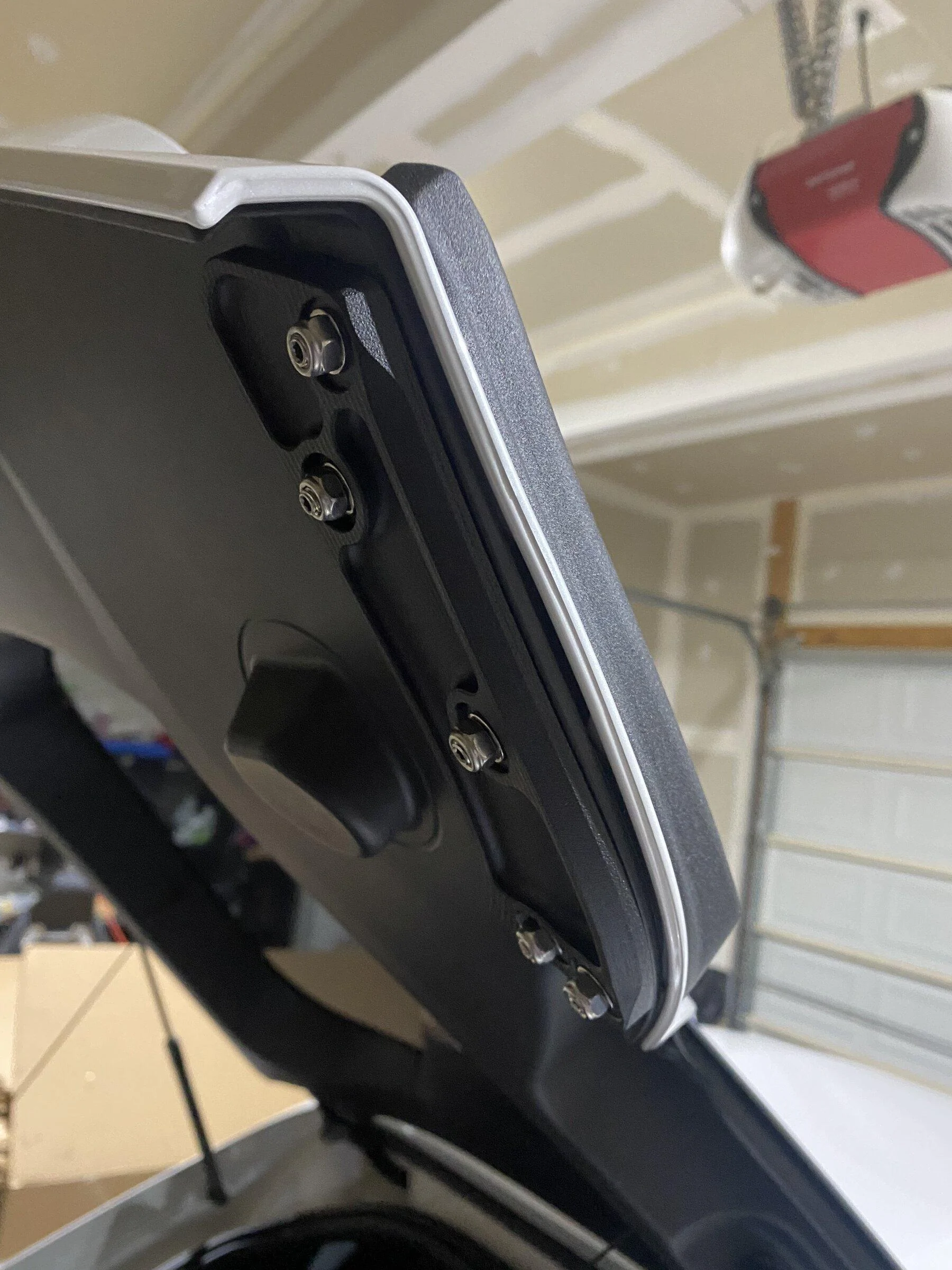

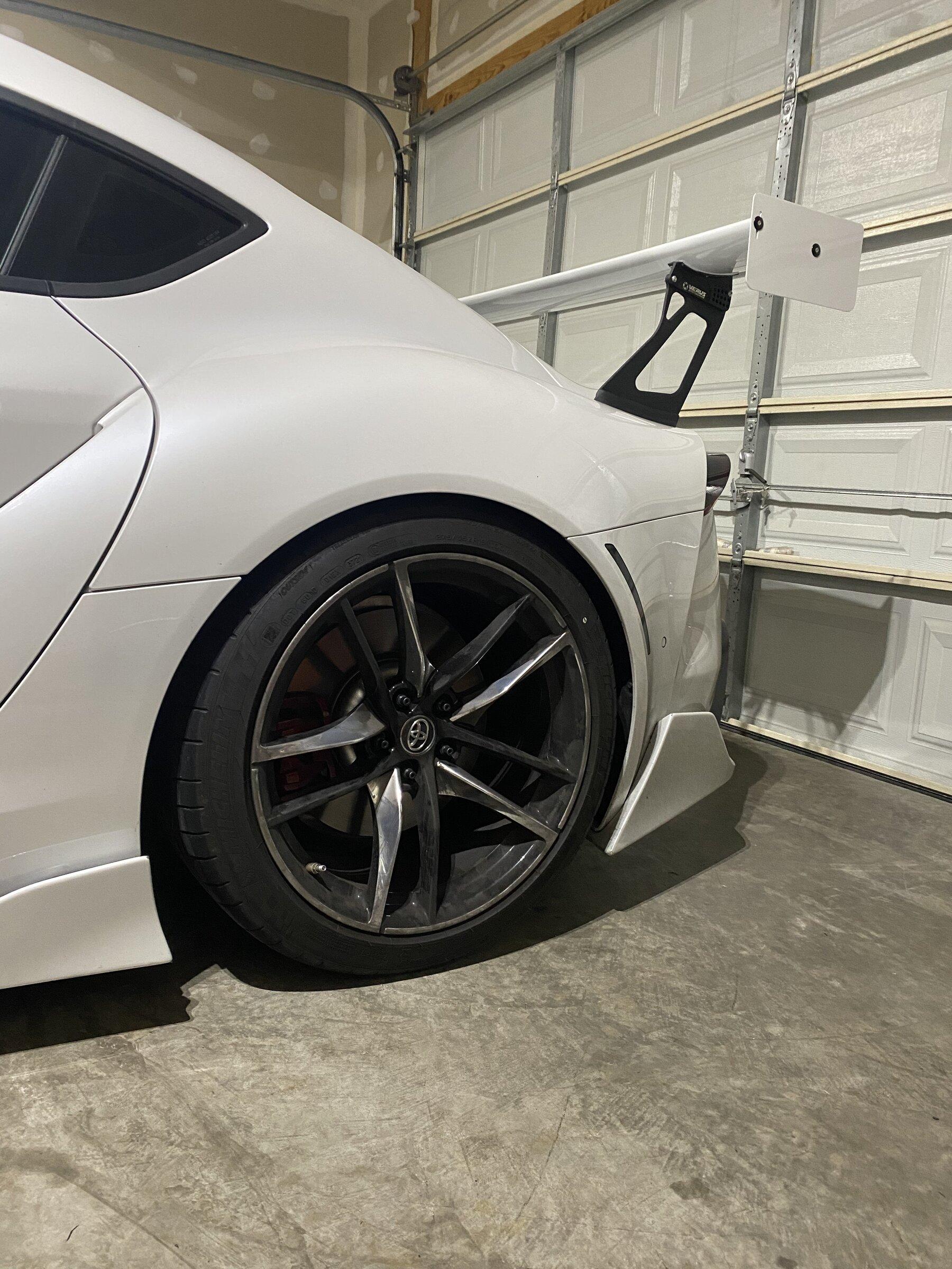

installed my paint matched Verus engineering wing! Super easy install with the templates along with the Verus instructions
[https://www.verus-engineering.com/w...94786b1c1c4b8f2f2bed52ecef0e50e&download=true]
one tip is that I did need to lightly open like two of the holes in a certain direction like 1mm or so, so it’ll take some trial and error
i recommend when putting the studs on the mounting brackets to put two of five on and lay it down first and look through the holes to see if any slight adjustments needed
