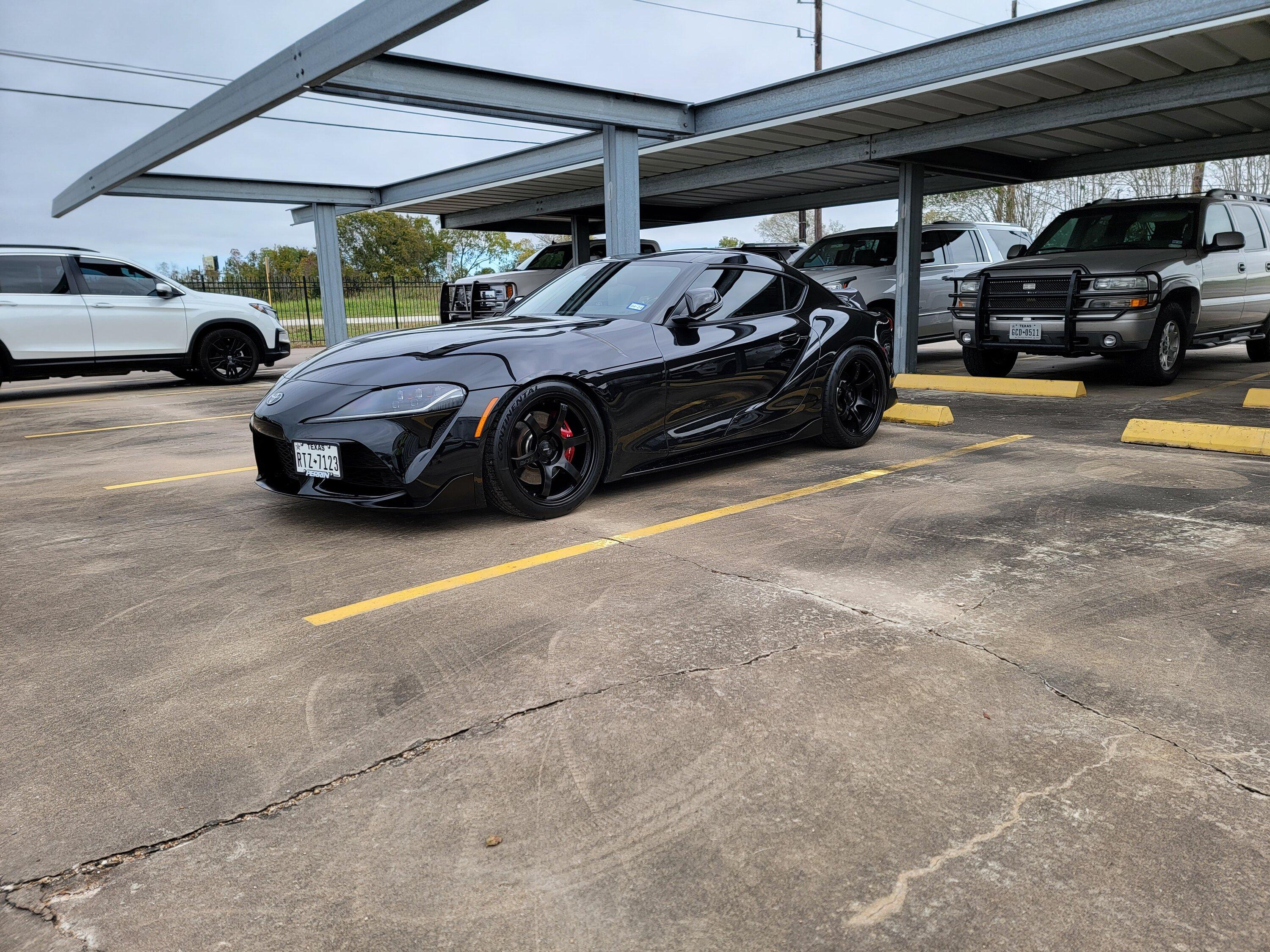

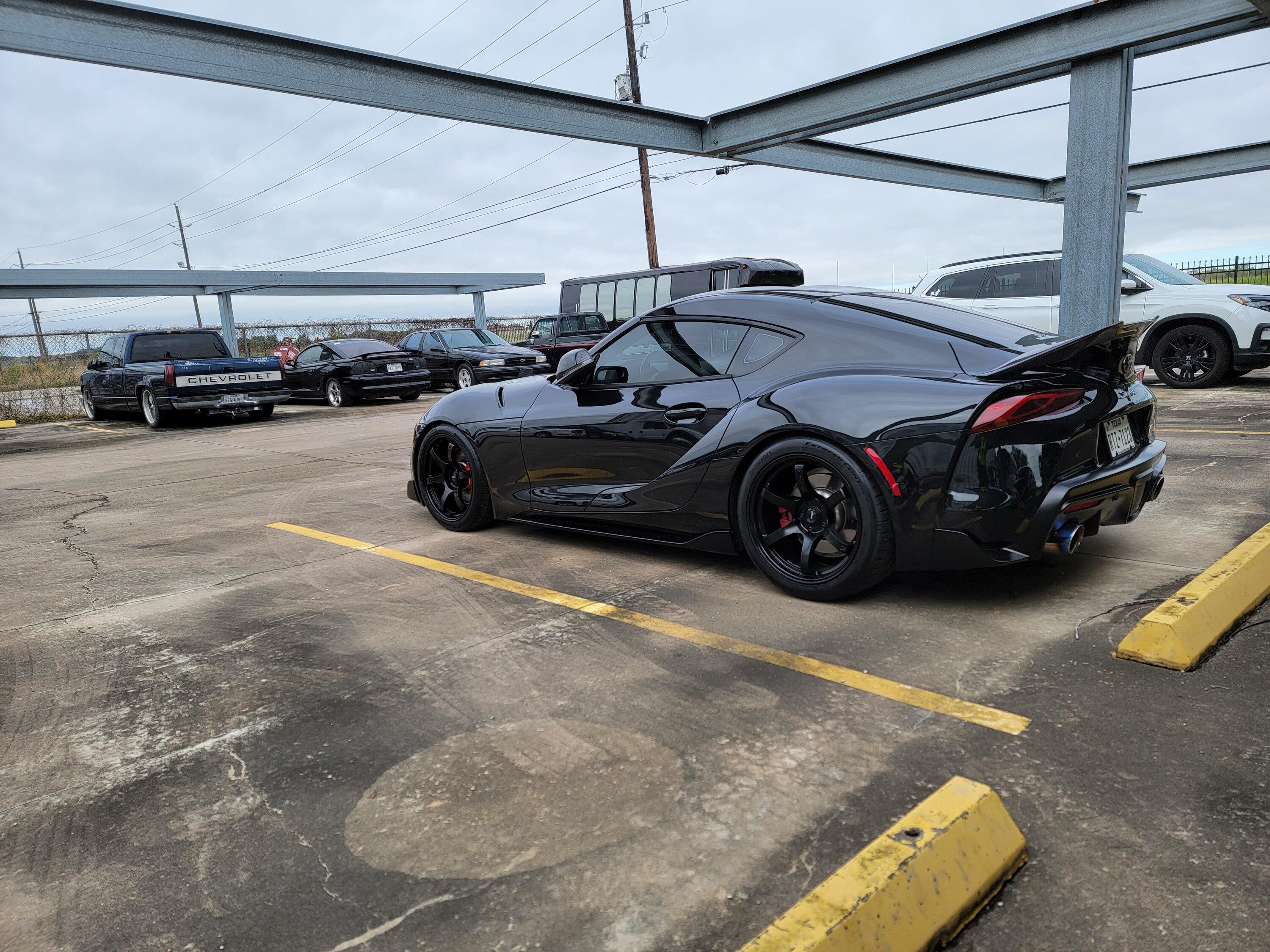

3.0 brake swap is super simple and bolts right up to factory 2.0 caliper holes. Must use 3.0 rotors as they are larger both in width and diameter. These rotors are also directional - Arrow on the hub faces towards the front of the car and the veins inside the rotors should be swooped back towards the rear of the car.
3.0 Exhausts all fit on a 2.0 in terms of hangar location. The problem is the connection to the downpipe. See picture # 3... 3.0 cars use a slip on style connection... 2.0 use a horrid ball and socket design. There are currently two ways to handle this 1. Is to cut off your factory style connection and the 3.0 exhaust shorted to accept the 2.0 connection welded on. (this is what i did) 2. Have a exhaust shop / fab guy modify your downpipe to turn it into a slip on style. Also beware that you need some space to change the downpipe fitting... the remark exhaust splitter location made it a bit rough. Though other exhausts like ARK / tomei give you plenty of space.
MSS springs fit the 2.0 perfectly though it seems that the HKS adjustable springs do not fit with our shocks. Word on the street is that the MSS rears are easy to adjust but that was not the case for me lol.

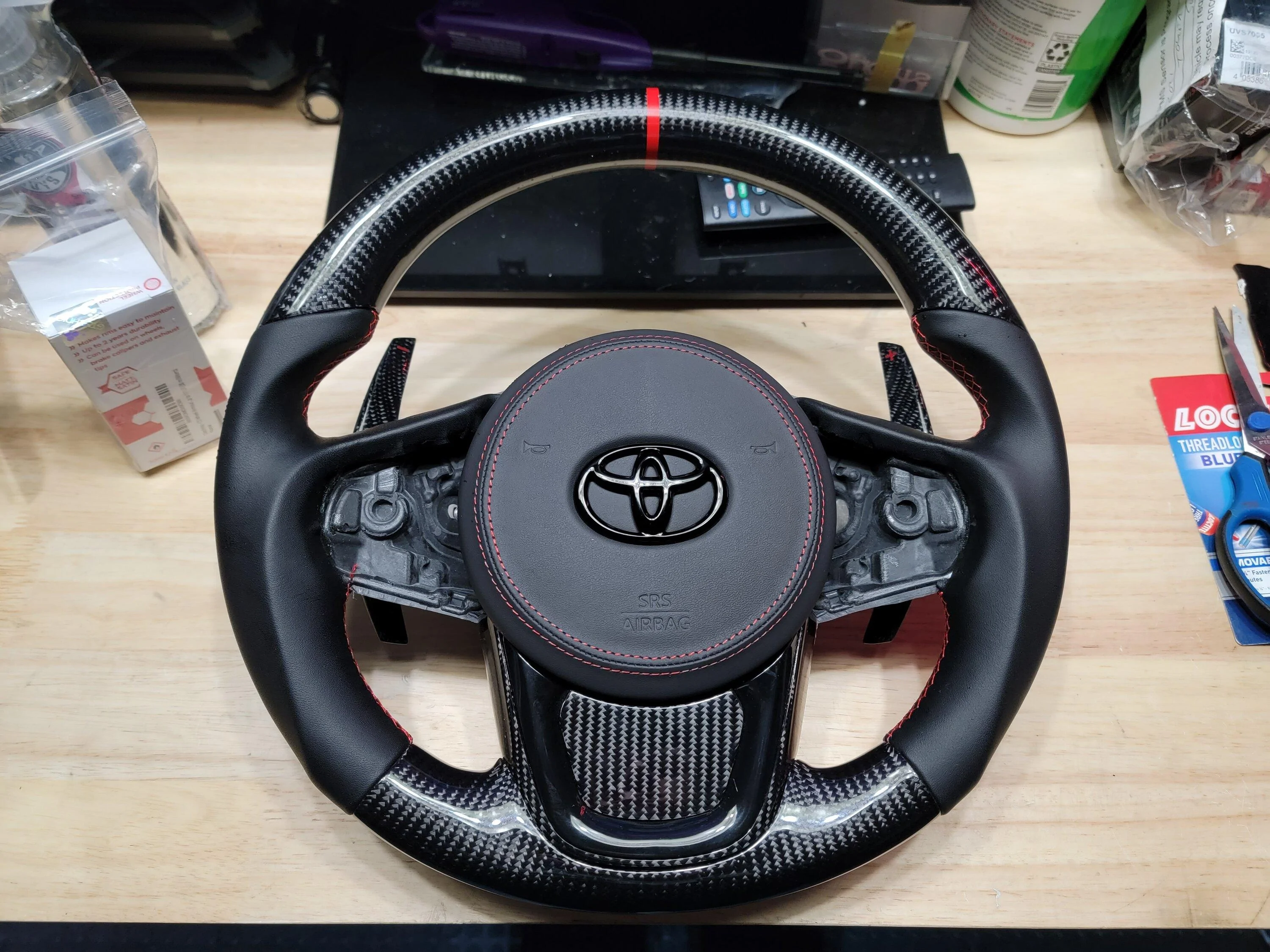

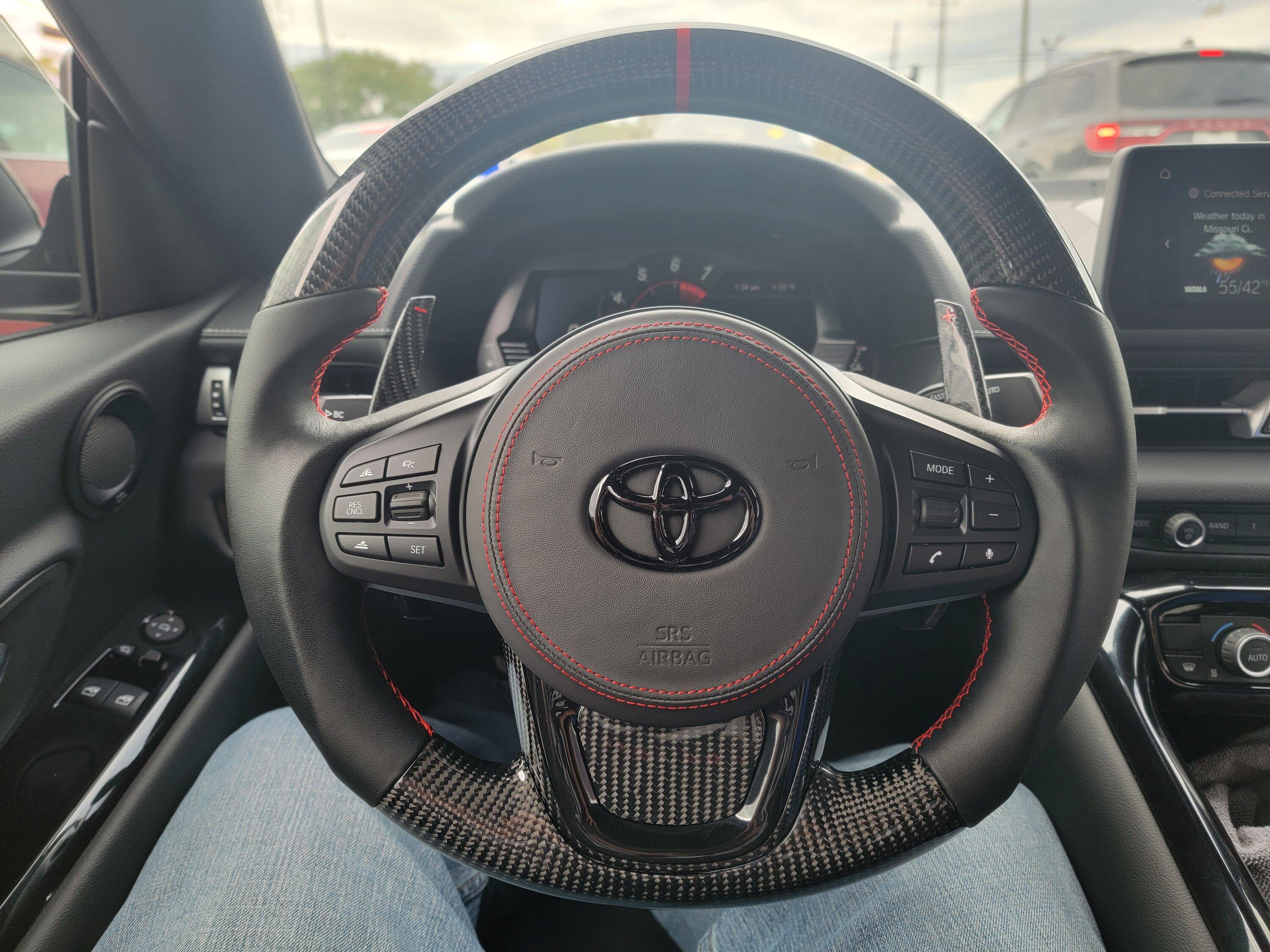

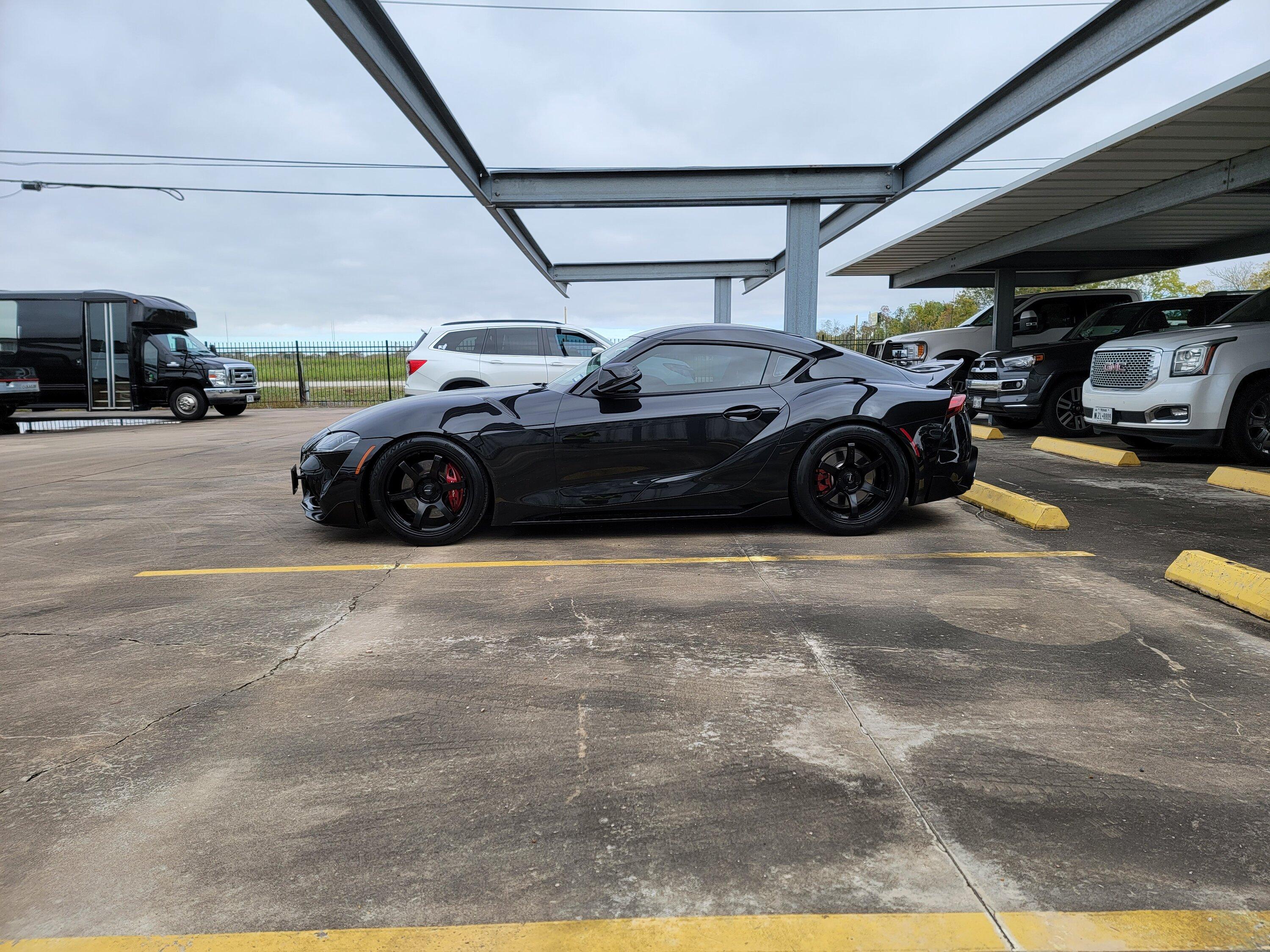

Finally some new parts!
@NitroYellowMKV hooked me up with this beautiful steering wheel. So happy to find a option that was not the flat bottom design yet still mix smooth leather and carbon fiber. Hit him up if you wanna make a custom steering wheel guys, the options are plenty!
And then finally after 8.5 months my Gramlights have finally arrived!

Hell ya brother looks awesome! totally one off wheel to match a killer build!
