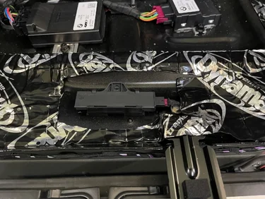

Ended up finding out from the tech notes that the issue wasnt the door handle. It was the "Smart Key Oscillator", was left hanging in the battery compartment in the trunk. The tech had to place the oscillator back in it's proper mounting position and that ended up fixing it, for anyone having this problem. Dealer did it for free since it was under warranty.
Thank You! I went to check mine and saw I covered it when I did the porting of the sub box. I just cut a hole in the dynamat and now it works fine again! I would not have guessed that thing would be a part of the door sensor system. haha
