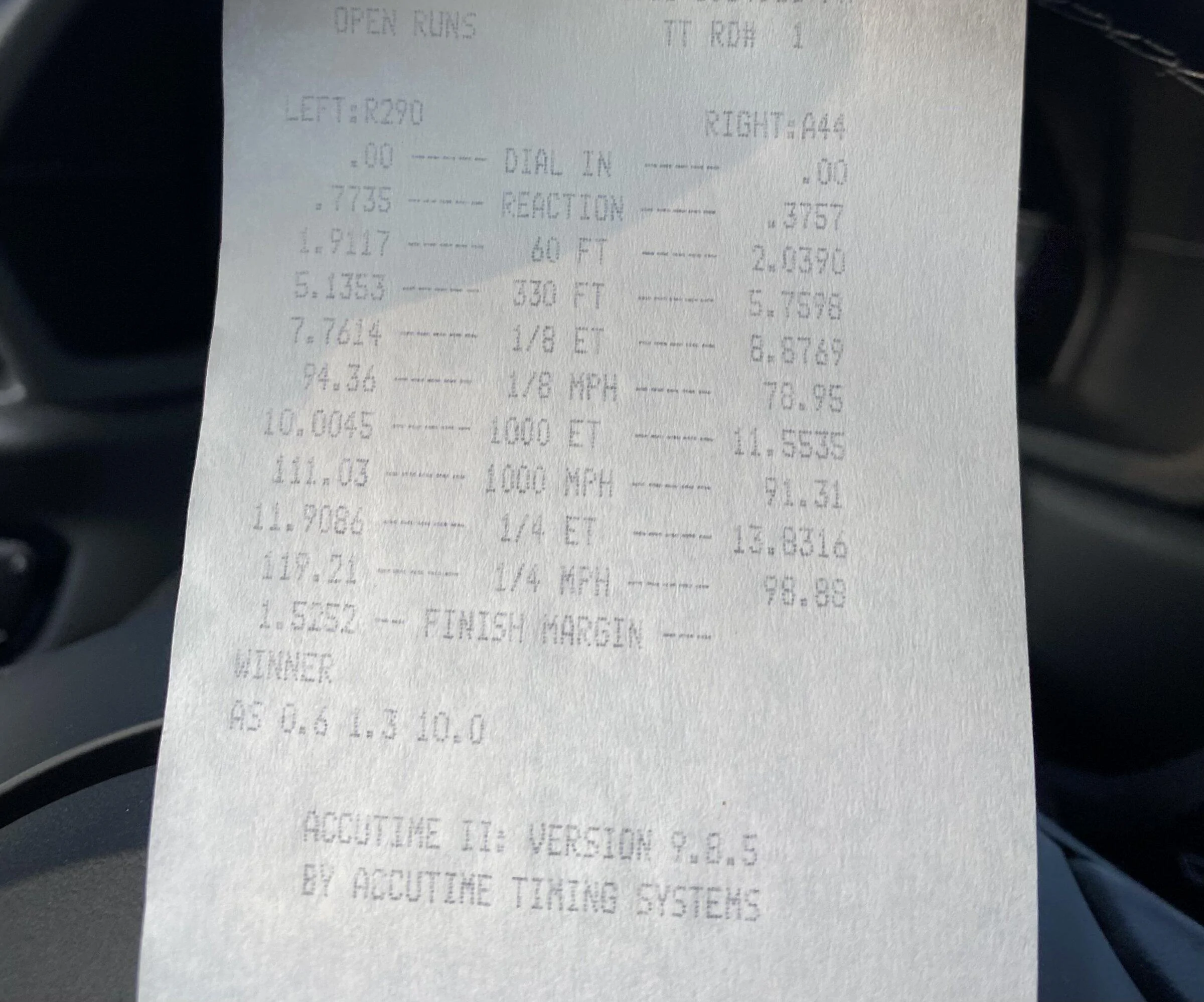

79
8,333
13,538
1.9 60’ and 11.90
catless downpipe and JB4
1. Press sport
2. Press and hold DSC
3. Warm up tires with a small burnout, watch the tire status screen and try to burn out to around 90+ degrees — usually 2-3 seconds
4. Press DSC once to engage some of the TC again
5. Switch back into automatic mode
6. Press and hold the brake, climb to 1,600 rpms as close to the staging lights as possible
7. Let go of the brake, full throttle
Auto mode is going to kill you on the stock turbo.
