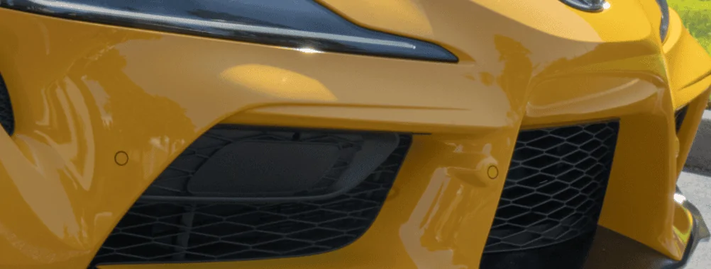

The plate is now located on the lhs vent area but if you look in there you'll see very little intake is used at the top, it's all down the bottom half.
Also that would only impact engine coolant there and not the rest. In the middle it is blocking nearly everything important, which is why that FT1 body kit is laughable, as it would give zero flow to three major components.

oh awesome, thank you. was thinking this solid black plastic part was a sensor or something, why else would it be there lol
e: :doh::doh: I won't even waste a reply, thank you for pointing out my mirrored directions
wtf
Dec 24, 2018
56
75
500hp 97 TT 6sp Aero, 800hp 98 GTX3584 6sp hardtop, 1000hp 92 R32GTR, 1300hp VR41 GT86, 600hp RB26 180SX, 1000hp R35GTR, 400hp SR20 AE86...
That's the right vent, don't cover that it's the radar sensor.
Left side only has the tow hook attachment.
