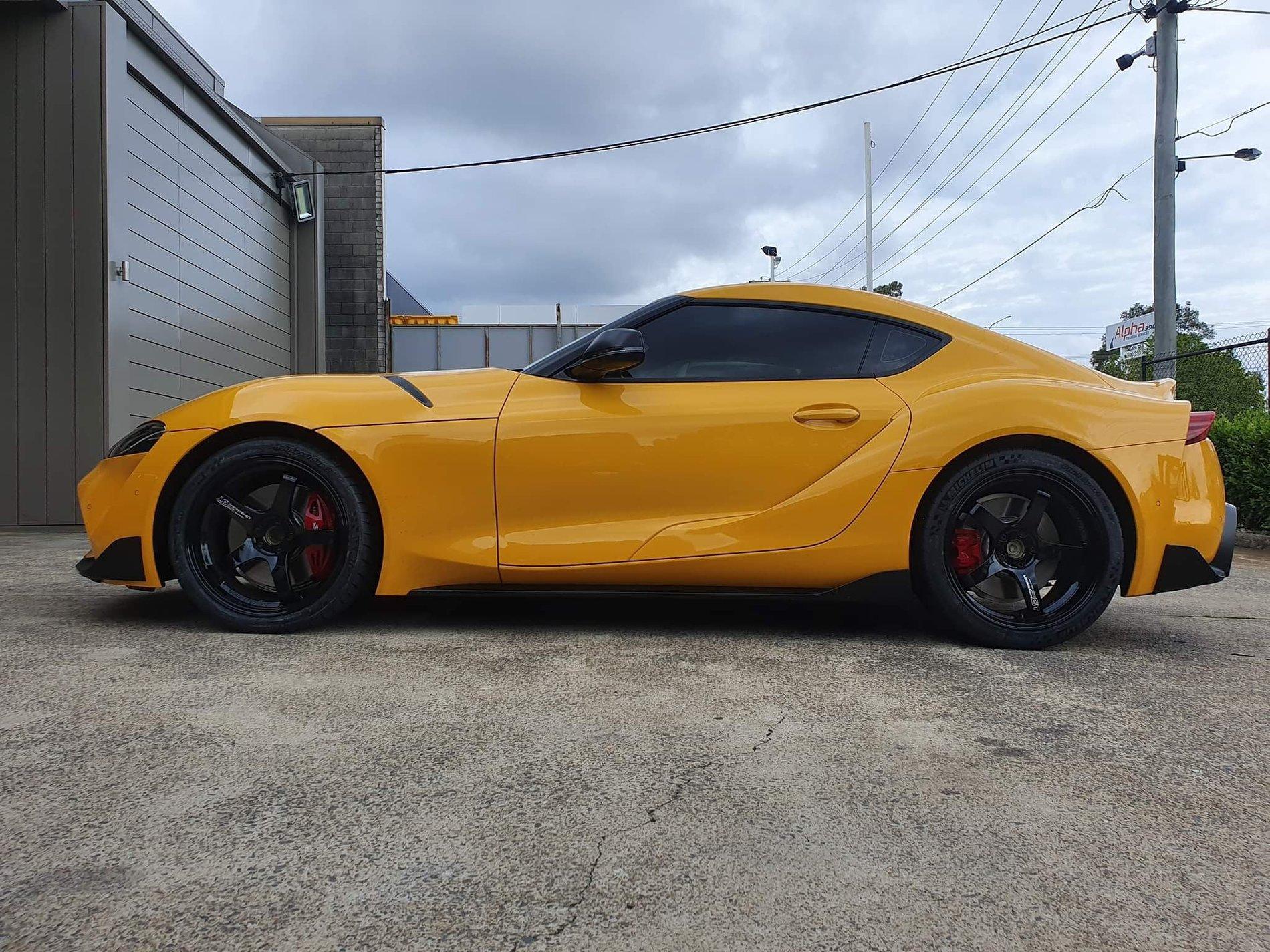

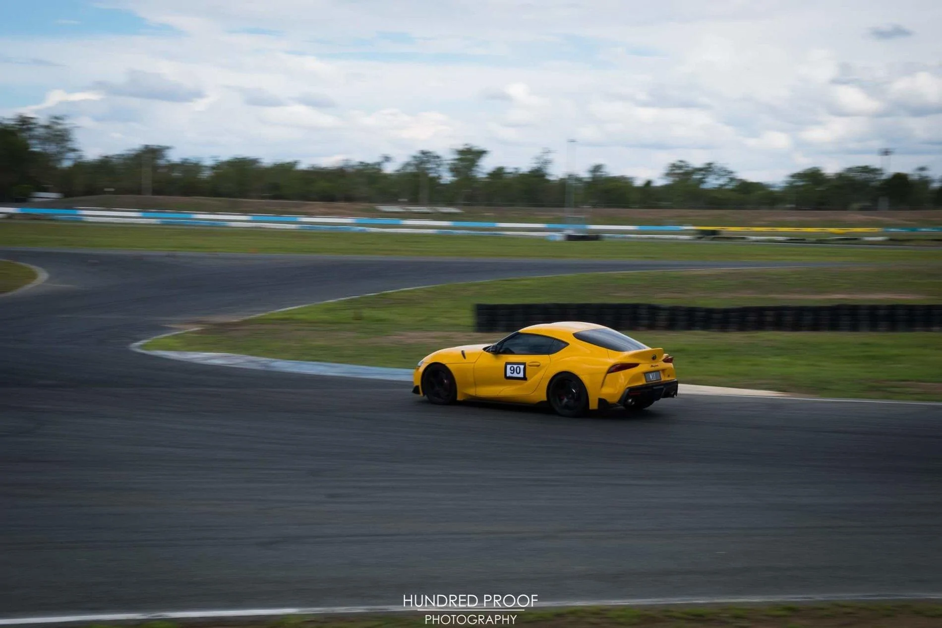

First event was King of QR, came third in "Track tuned forced induction class" completely stock.
Second event was with the new wheels and tyres, at a regular sprint day.
Does very well for a stock car, but it's atrocious ESC/TRC tries to put you into the wall even when it's disabled..
Not impressed with some of the track handling at or on the limit in the car.
