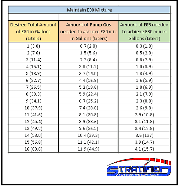

How many litres of e85 do you add to a full tank to get e30?
I use this table:
MDAwMDAvYXR0YWNobWVudC5vdXRsb29rLmxpdmUubmV0QDg0ZGY5ZTdmLWU5ZjYtNDBhZi1iNDM1LWFhYWFhYWFhYWFhYSJ9.png
There are calculators online as well. Before doing this I bought this tester:
To my surprise, the Shell E85 pumps exactly 85% Ethanol, I was impressed with the accuracy. Still I'll keep an eye every once in a while to see if they maintain this, by rule they need to provide at least E70. But this is California, we never have really cold weather, so I guess that's why we have good E85.

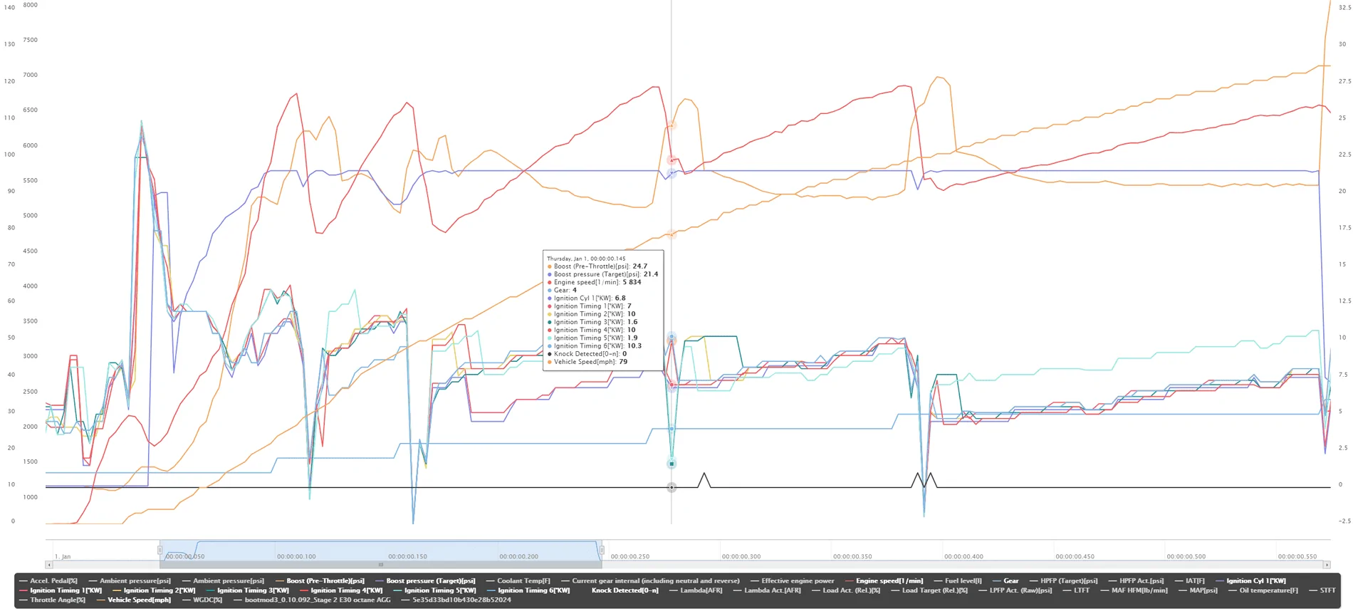

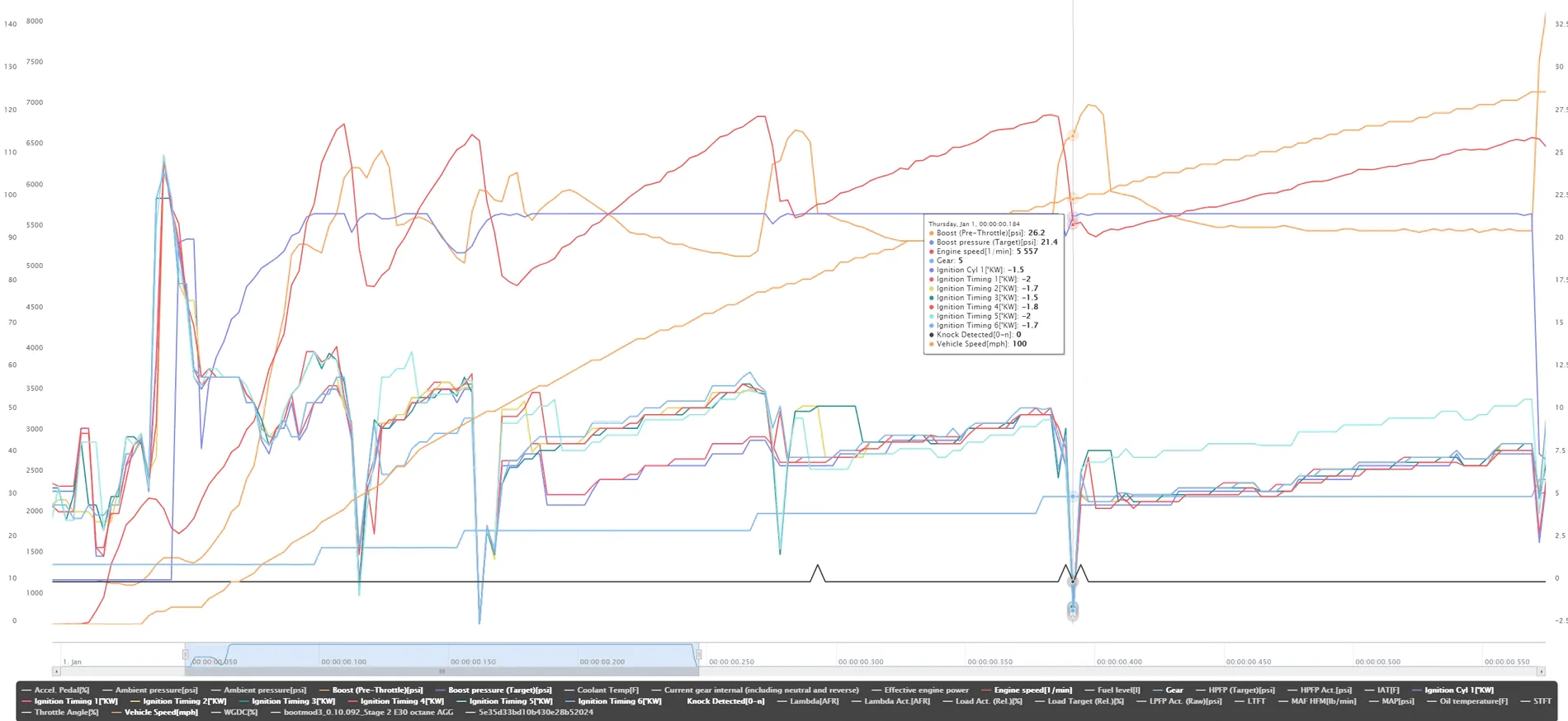

How can I assess if the knock was real or not? for instance I was logging on my run in the drag strip and I had 3 knocks and from what I can see in the log it was between shifts, first when changing from third to fourth and then from fourth to fifth gear, in this last shift I see some overboost as well:
Here is the log: http://www.bootmod3.net/log?id=5e361570d10b430e28b520f7
And the first shift (3rd to 4th) looks like that:
Second shift (4th to 5th)
The black like in the bottom with three spikes is the knock count, I see the over boost when changing gears, so I guess the excess of compressed air/fuel is pre igniting, this is my rookie analysis, but would you help me understand the severity of this. I am using the OTS E30 tune from BM3, not sure if I should revert to stock map to avoid this, or if this is expected.
