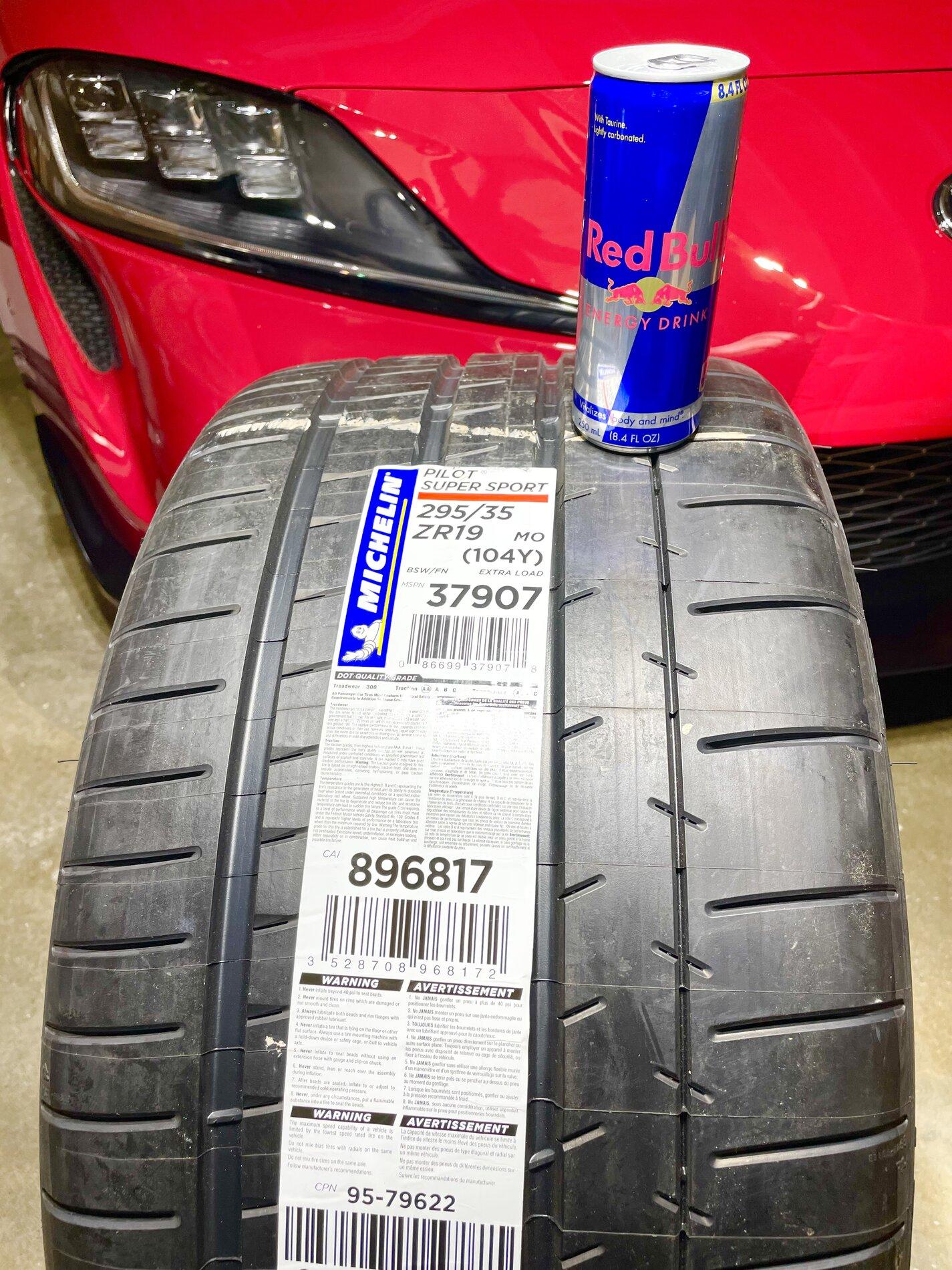

This was my exact process too. Iā€™m very pleased with the results. Now I need to mount these so I have some traction again. ?
-RJM
