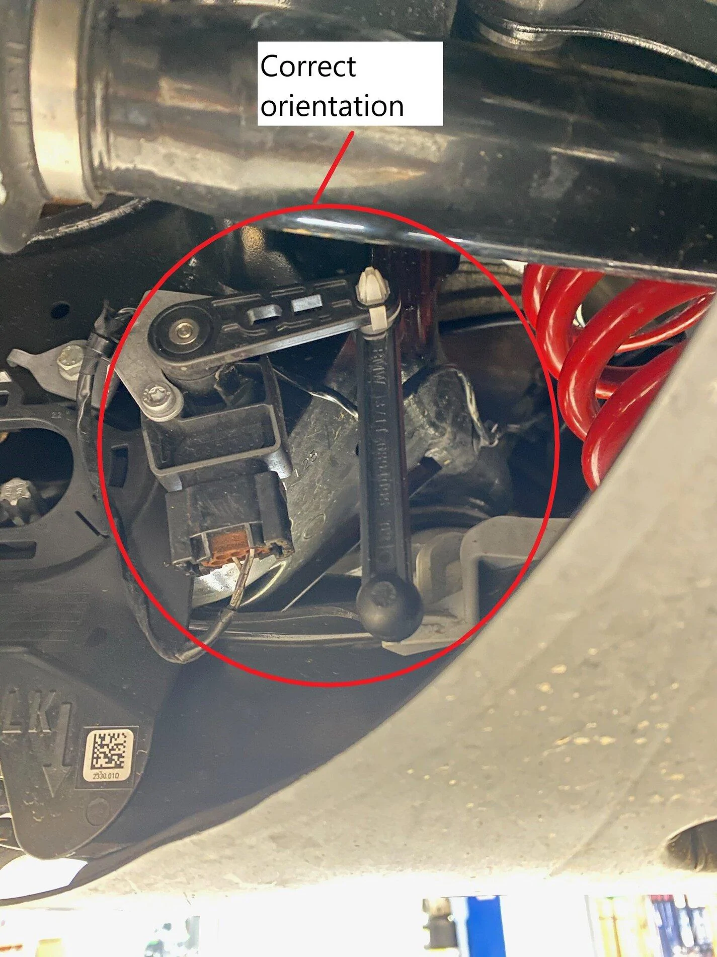

I just installed HKS lowering springs and replaced the front struts on my 2.0 Supra with the 3.0 struts. Everything fit well and drives well but I now have two errors “Chassis Stabilization” and “Drivetrain” and now my safety system won’t turn in because of the two errors what do I do?

You might want to see if the ride height sensor is in the correct orientation or if the ride height sensor bracket is broken.
You can also see the plastic bracket in this picture. If it's broken, Visconti makes an aluminum version.
