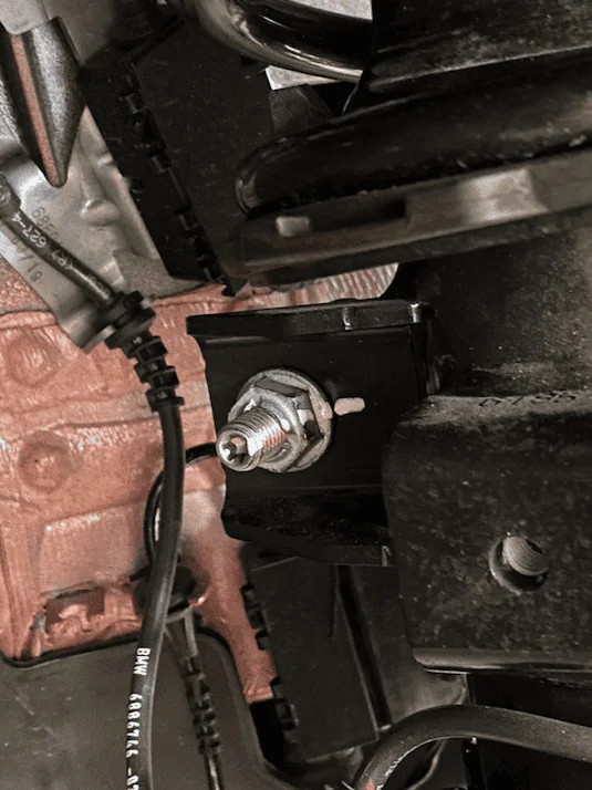

    I only have about 10 miles on the Eibachs in that video. On my F36, the aftermarket end links got extremely worse over time. I got replacements from airlift, they were quiet for about 500 miles. It was always the tightening of the aftermarket link to the strut, I think it's a size mismatch issue. I've had no issues with removing and reinstalling the stock links on BMW suspensions.
    Double checked the torque of your endlinks on the strut. I marked mine and will check to see if anything shifted tomorrow.

    I did the short cut method on 3 cars, they were all done the same way with HKS Hypermax Springs. One of them (Mine) make binding noises when turning near full clock. I was going to take them out and see if I noticed anything with the top bearings. They didn't come apart when taking them out. I also did have a loose end link but tightening them fixed that.

    How did you tighten the end links? I initially put them on with the impact gun. After checking them back with a torque wrench, they were at the 64Nm. Maybe I'm just missing something with this step ...?

    I tightened them to 56Nm thats factory specs.

    Yep, same here. I did not see them move based on the marks I made.
