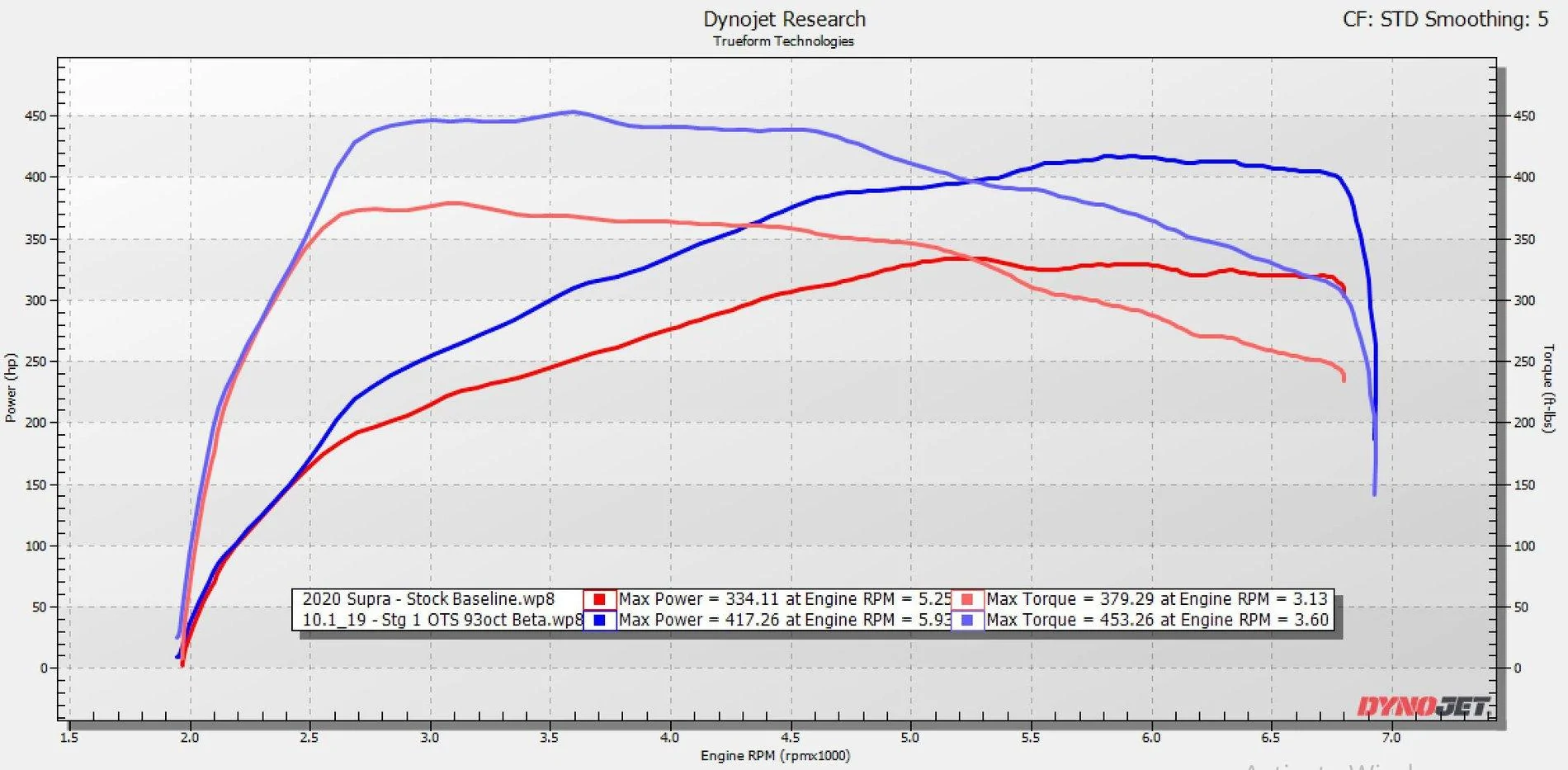

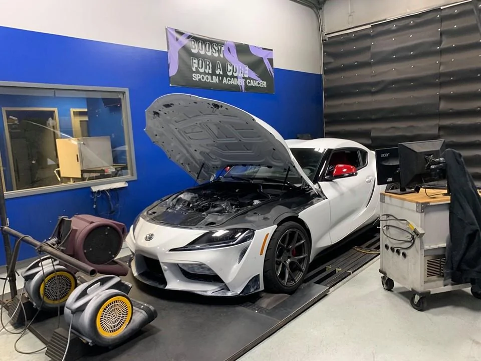

    The past few months with our A90 have been flying by, and it has been great to watch the aftermarket take such a love to this car. Although not active on the pages daily, we have been hard at work,
    with the car spending most of its days either on the dyno, or torn apart digging into anything and everything we can.

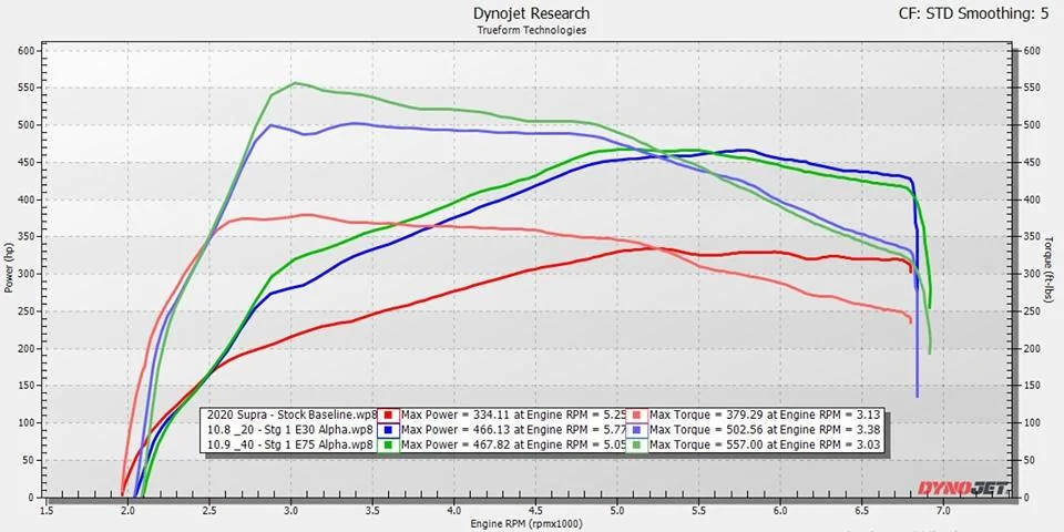

    We are excited to show some updates on our current "Stage 1" Beta tunes, along with some of the fun we have been having with ethanol blends on the car, so far it has taken everything we have thrown at it and asking for more. These dyno numbers are with a 100% bone stock car, stock intake, stock downpipe, stock exhaust, etc. With only our Stage 1 tune, utilizing Bootmod3. Hats off to those guys for such a great product to work with! .
    Let us know any questions you may have, or input from what you see. Excited to get this out on the market for further validations soon. I am on the hunt for a few bone stock cars, that have access to some time on a dynojet chassis dyno, if anyone is interested please reach out!
