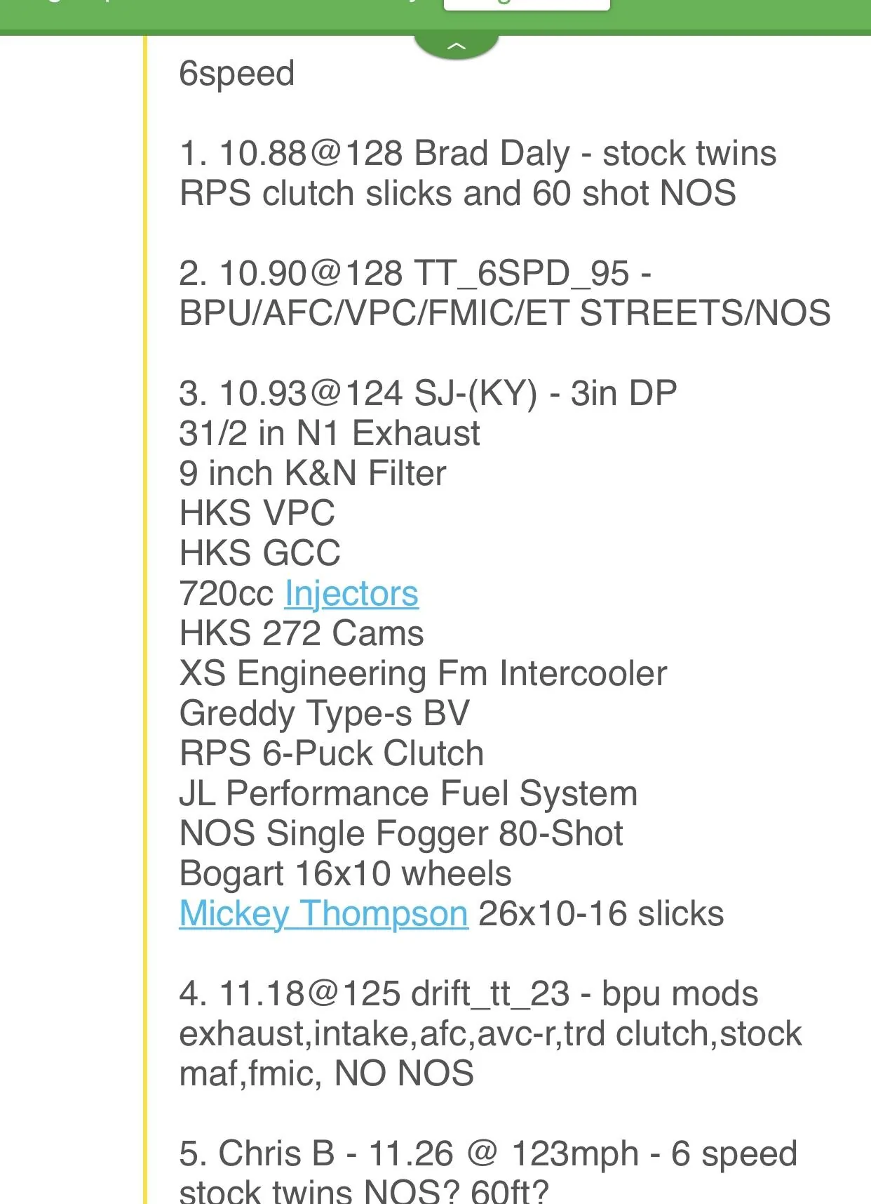

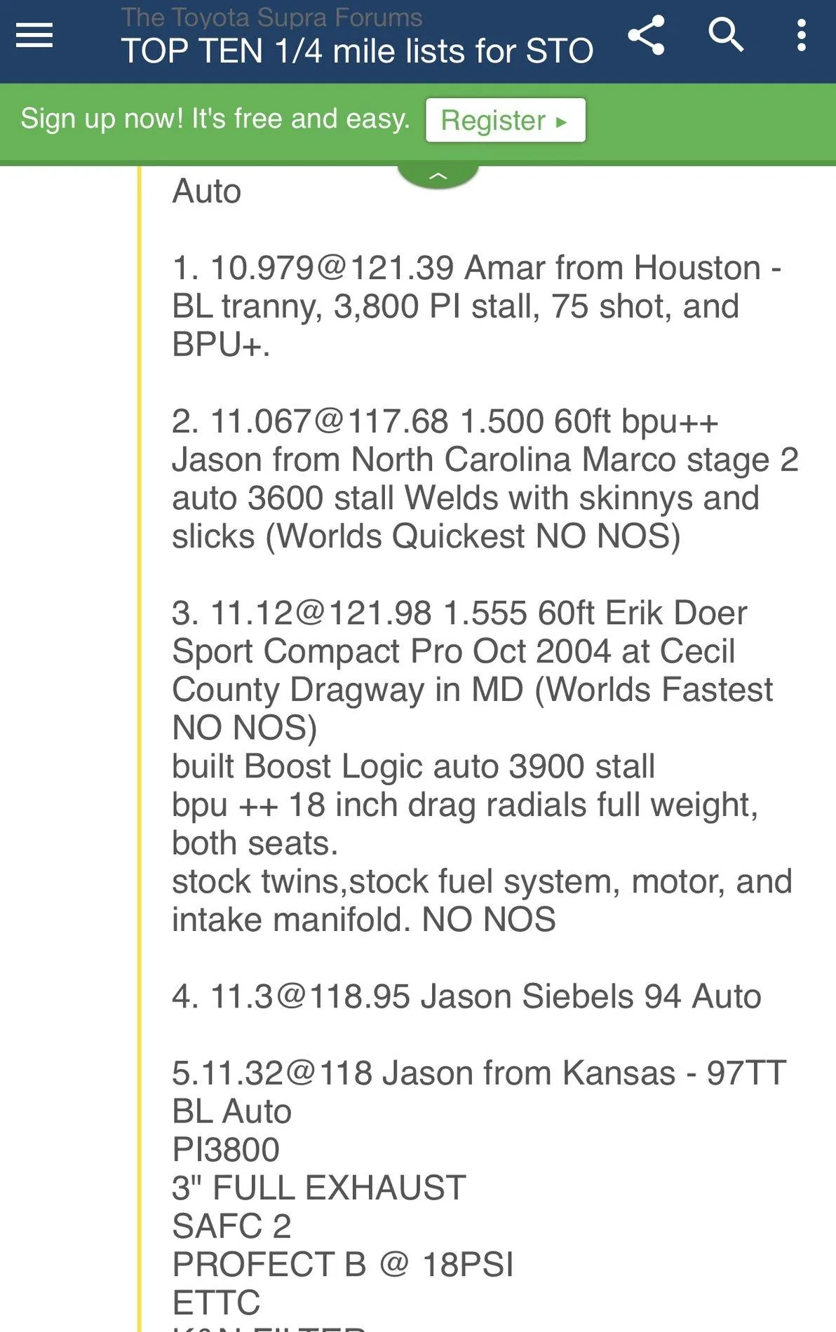

But look at the numbers for the stock turbo MKIV Supra vs the less then a year old MKV Supra. I’d say the B58 is pretty robust. 9’s. Stock turbo, tranny and rear end vs 10.8/10.9 2JZ Auto/Manual stock turbo various mods.

Not sure about max power
Apples to Moon Pies...
The 3? MKV's in the 9's are all on upgraded turbos and spraying nitrous out of the hole and all of the way down the track. The ability to the load the drivetrain ,spray down a 1.3 60' and just hold the wheel straight does wonders -- isn't technological progression cool?
FWIW that stock turbo list on supraforums hasn't been updated in years and those times were set 10-20+ years ago...!

Ok then, what is the fastest Stock turbo MKIV time then? I love the MKIV too, but there is no denying this is capable to be faster out of the box.
I don't know and I don't particularly care whom, 3 decades on, now owns stake to the claim of "fastest stock turbo MKIV". I know what I and friends/acquaintances have personally run, but it's all completely irrelevant to OP's question. Rest easy, though -- I can assure you the ET never has and never will start with a 9.
OP asks a question and instead of providing a tangible answer someone chimes in with "I don't know, but but but.. look how fast the MKV is with nitrous and turbo upgrades compared to a stock turbo MKIV" and even went to the trouble of screen-shotting a 14 y/o thread on SF... :dunno: Huh..? Inferiority complex..? Odd leaps of logic, at least...
And who is denying the MKV is more capable out of the box? Hence "technological progression".
