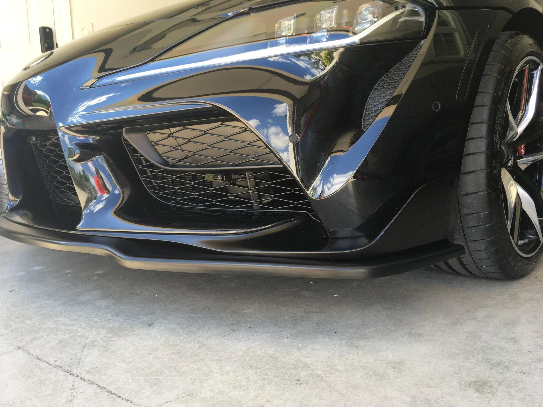

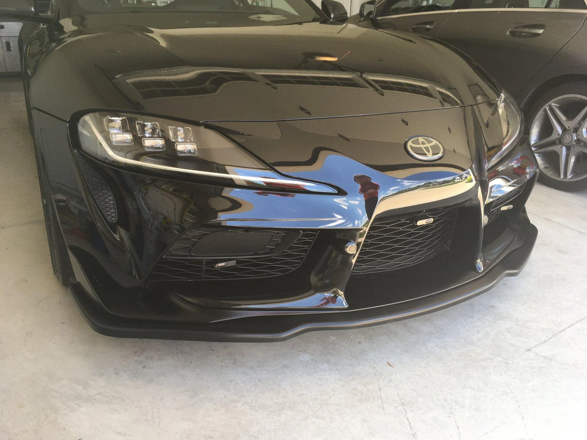

Installed a Maxton V2 front lip spoiler. Great fitment and pretty simple install (search online for install). It comes super glossy. Had to repaint it with Wurth satin trim to get it to look like the OEM trim. Grey scuff pad, clean, adhesion promoter, primer, light sand, Wurth satin black. By the way, tried the SEM trim black first, and it was too flat. Probably could have used some SEM satin clear. Anyways, install pretty straight forward. The 10 mm nuts above the spoiler, inside the existing trim are a little tough to get in there with your hands. Used 3M tape, a lot, around different areas in addition to the bolts. Rock solid, in my opinion. Photos attached. I like the V2. It's not too much, not too little.

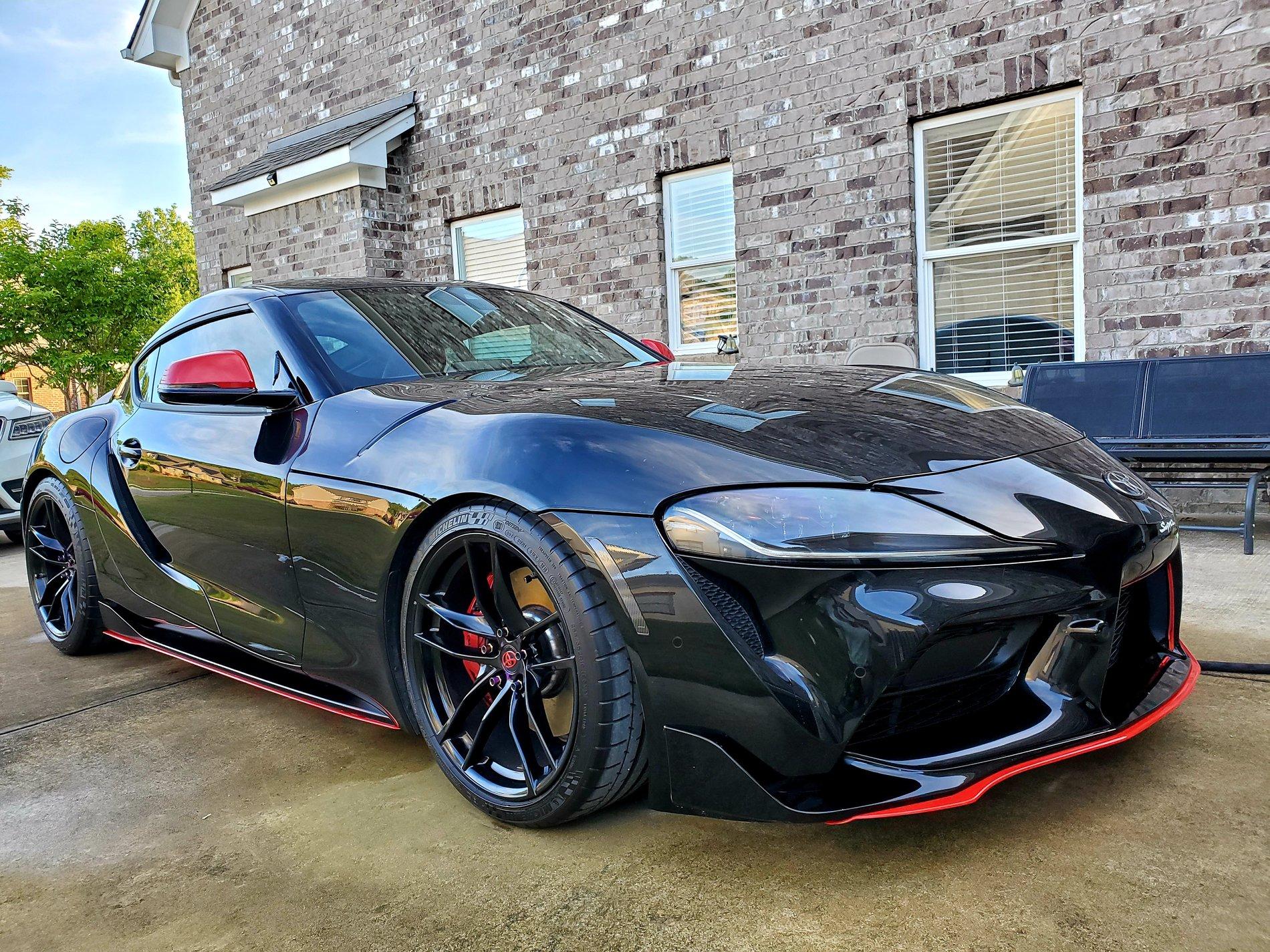

The red skirts, lip (V3???) look great with the red mirrors! Congrats! Did you paint your center caps or buy them somewhere?

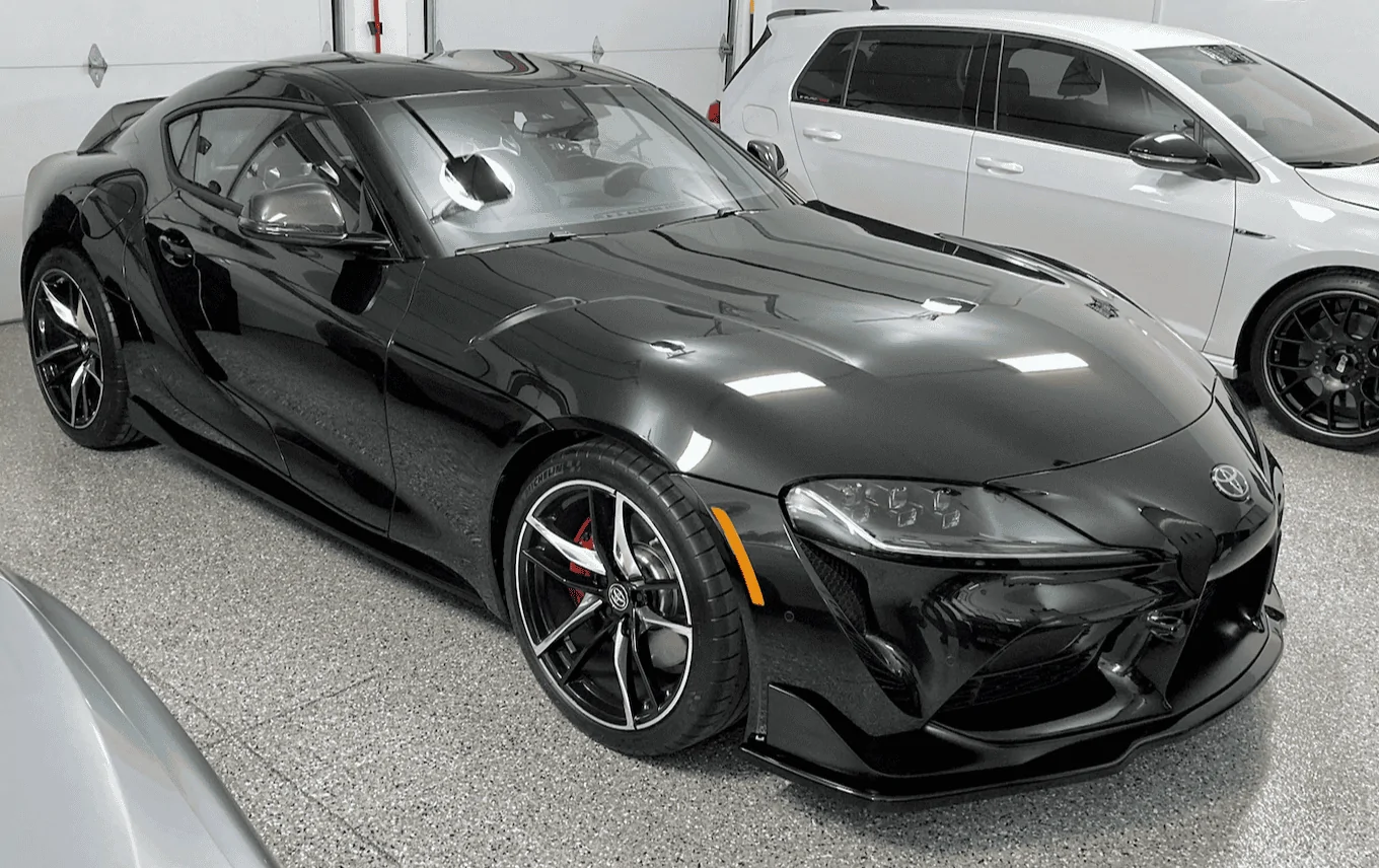

I had to think quite a bit before doing mine as the red accent V3 looks so good on black. I decided to do the V2 as OP, but left it gloss finish. I really like how it turned out.

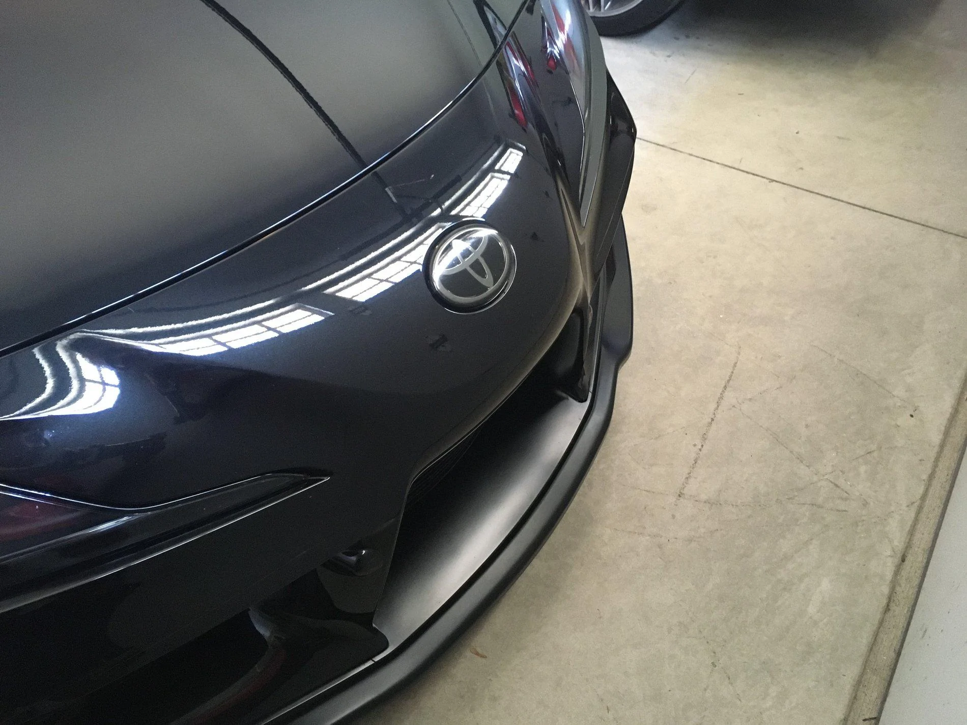

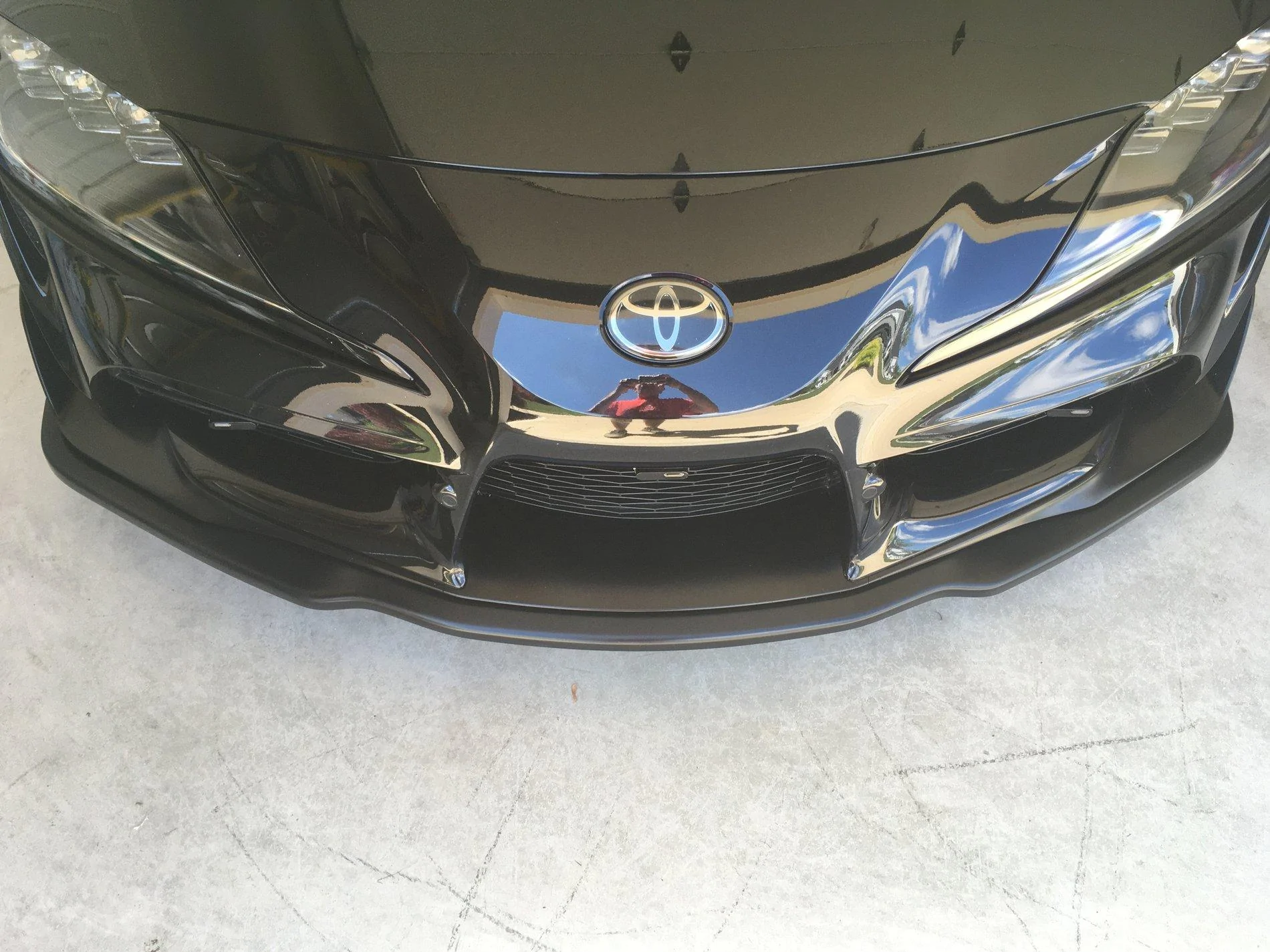

I think this is best option for the look/price spoiler lip. I took the deal at @FTSPEED for free shipping. ;)
it is also wrapped in CF vinyl, same material as door garnish & roof.
Wow, that looks great! I had to zoom in the photo to see the CF texture. Love it.
Yeah, looks like FTSpeed is out of stock on them too. I just wrote to MD in the UK to confirm actual availability as most US vendors are out of stock.
I plan on making it blend with the OEM lip in a satin black like @sbodnar did. I'm going to try plasti-dip first as I'm not that experienced in vinyl wrapping. :dunno:
