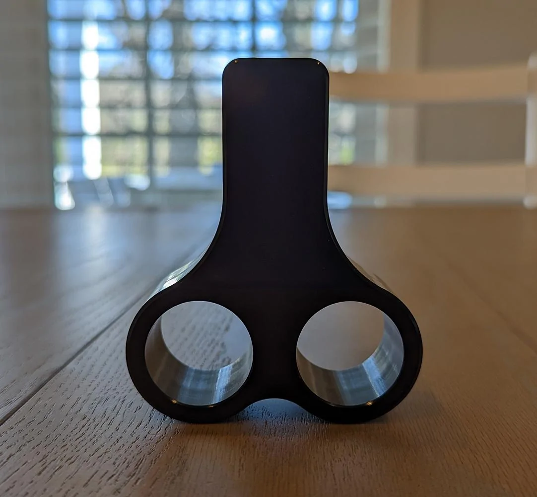

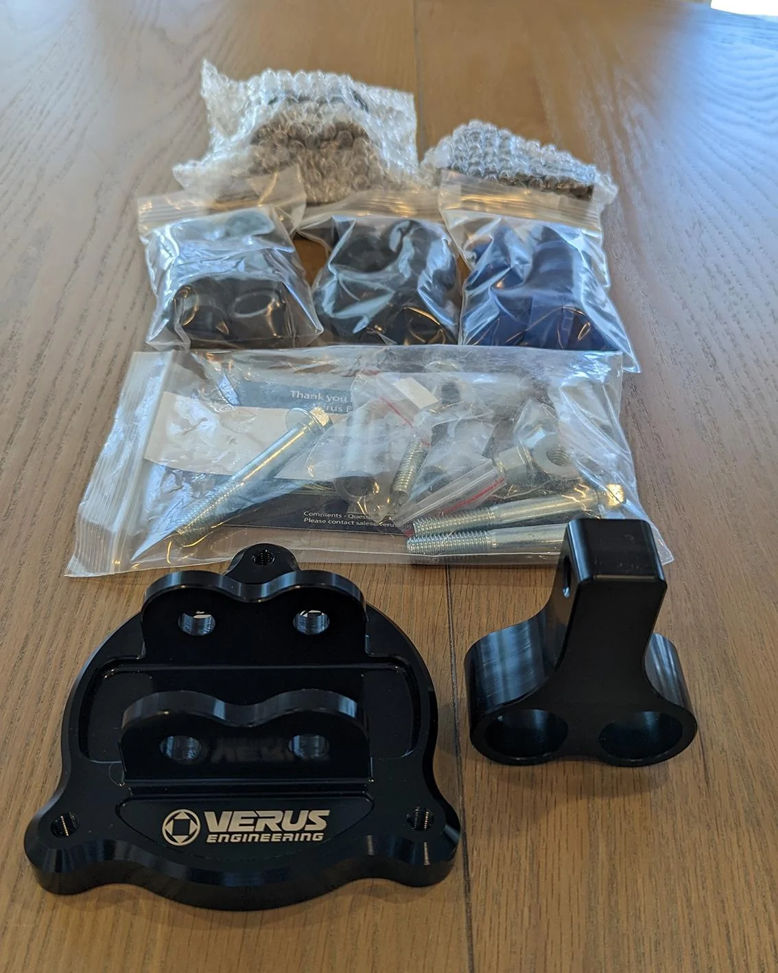

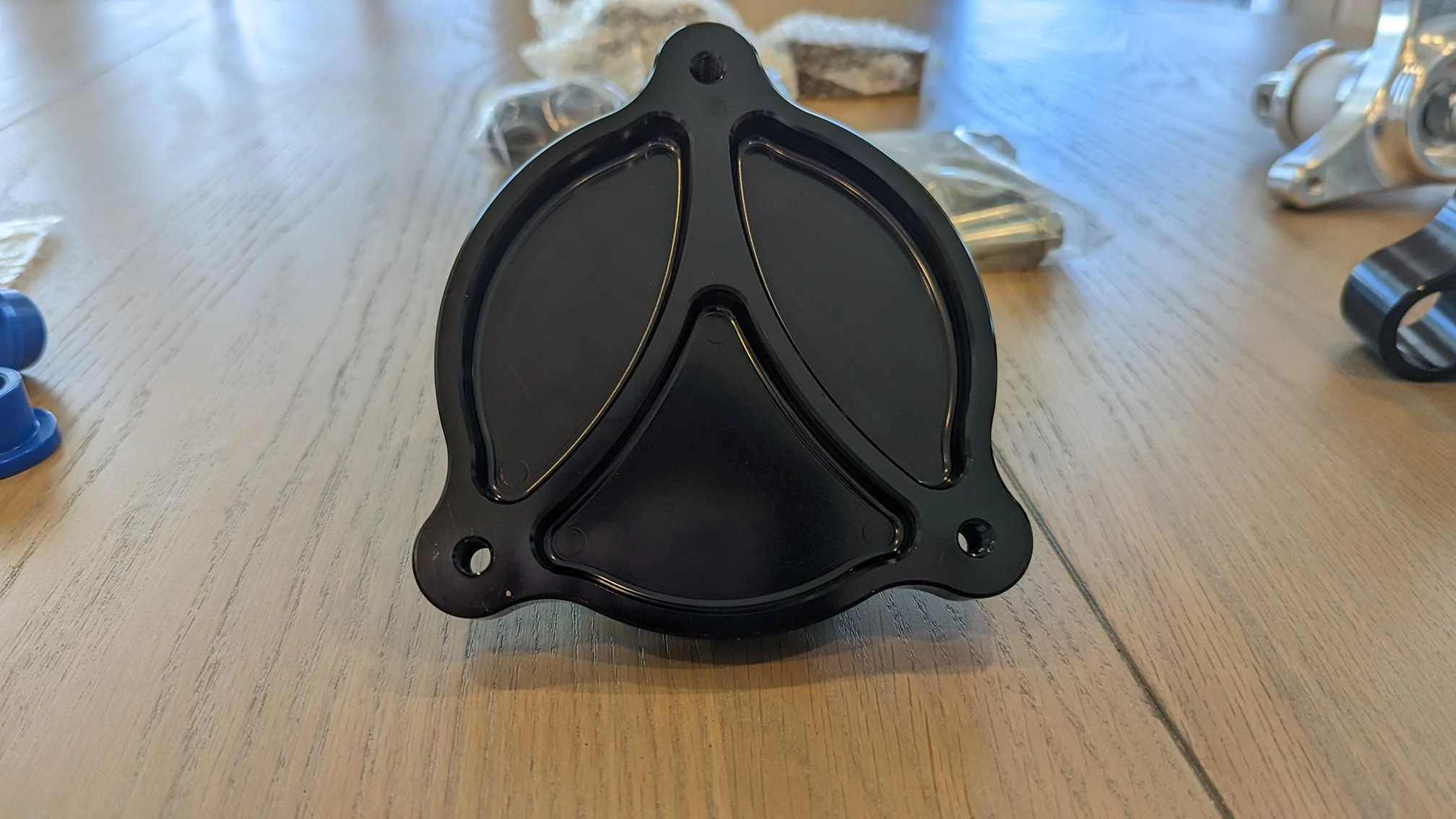

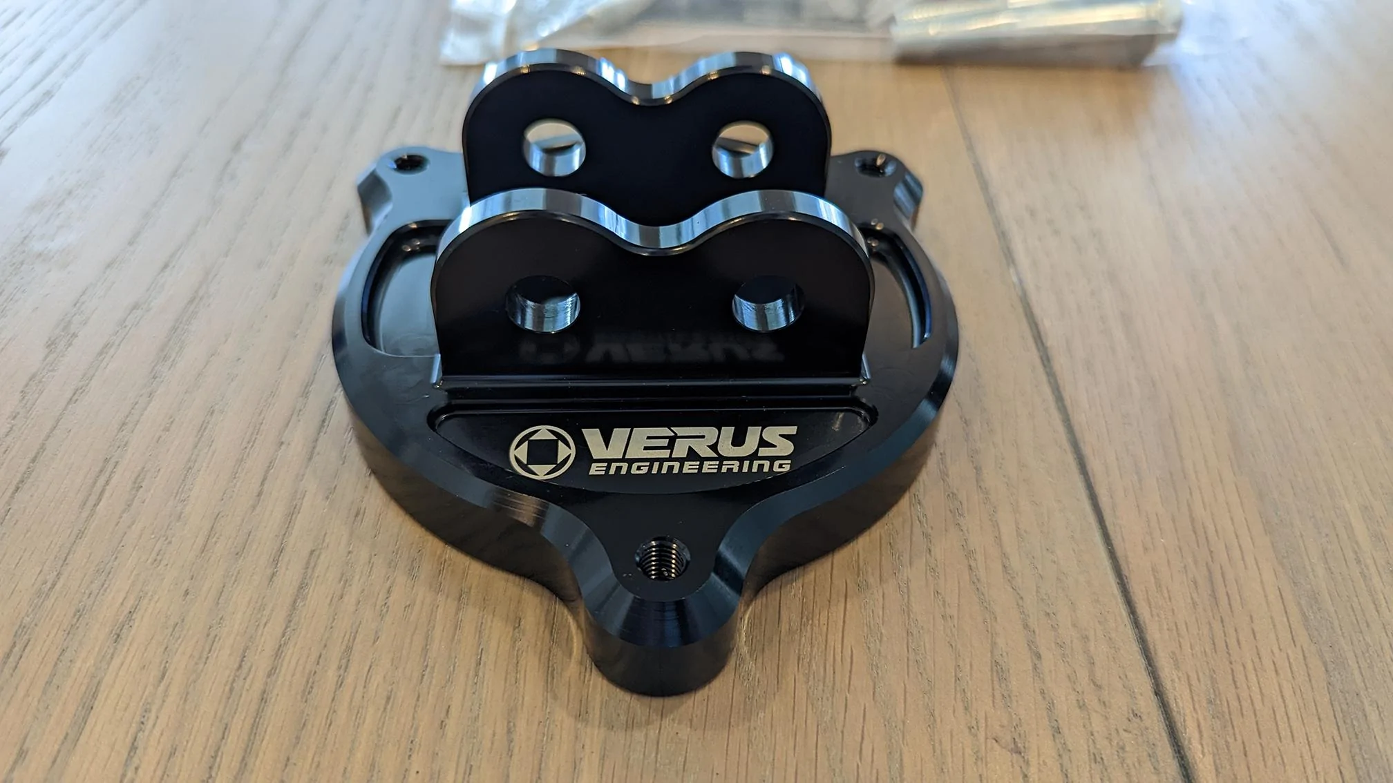

Verus Engineering Motor Mount Assembly
Product Link
: https://www.verus-engineering.com/shop/a0273a-motor-mount-assy-toyota-mk5-supra-2609#attr=
Install Video:
Here are some pictures of the product I received:

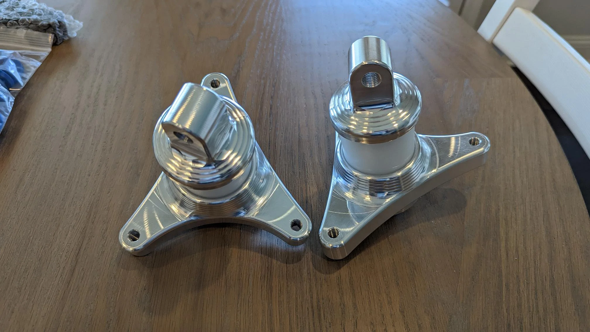

Doteki Auto Solutions Motor Mounts
Product Link
: https://dotekiautosolutions.com/?page_id=41 (note all the sub-links are broken)
Install Video: None
I ran across this product when watching the following video:

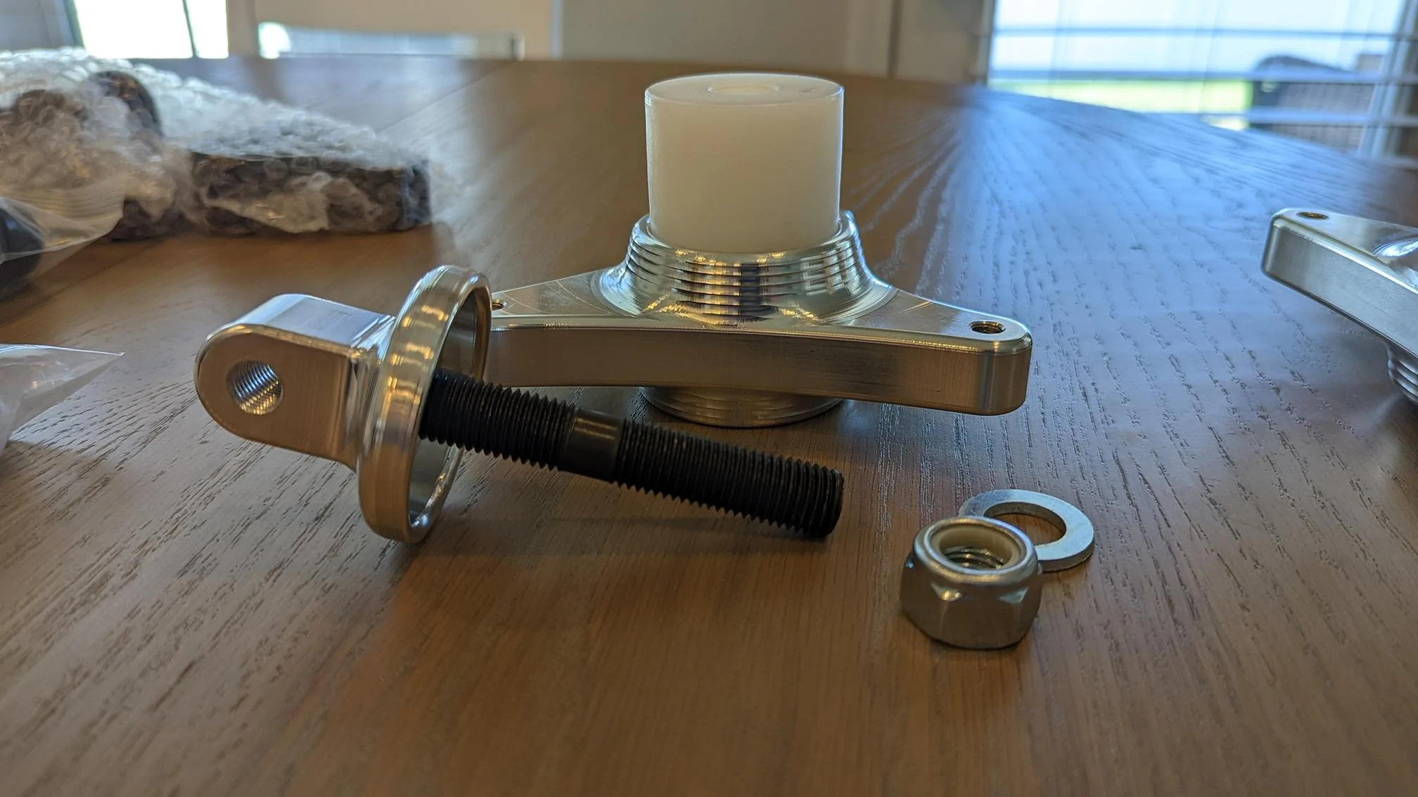

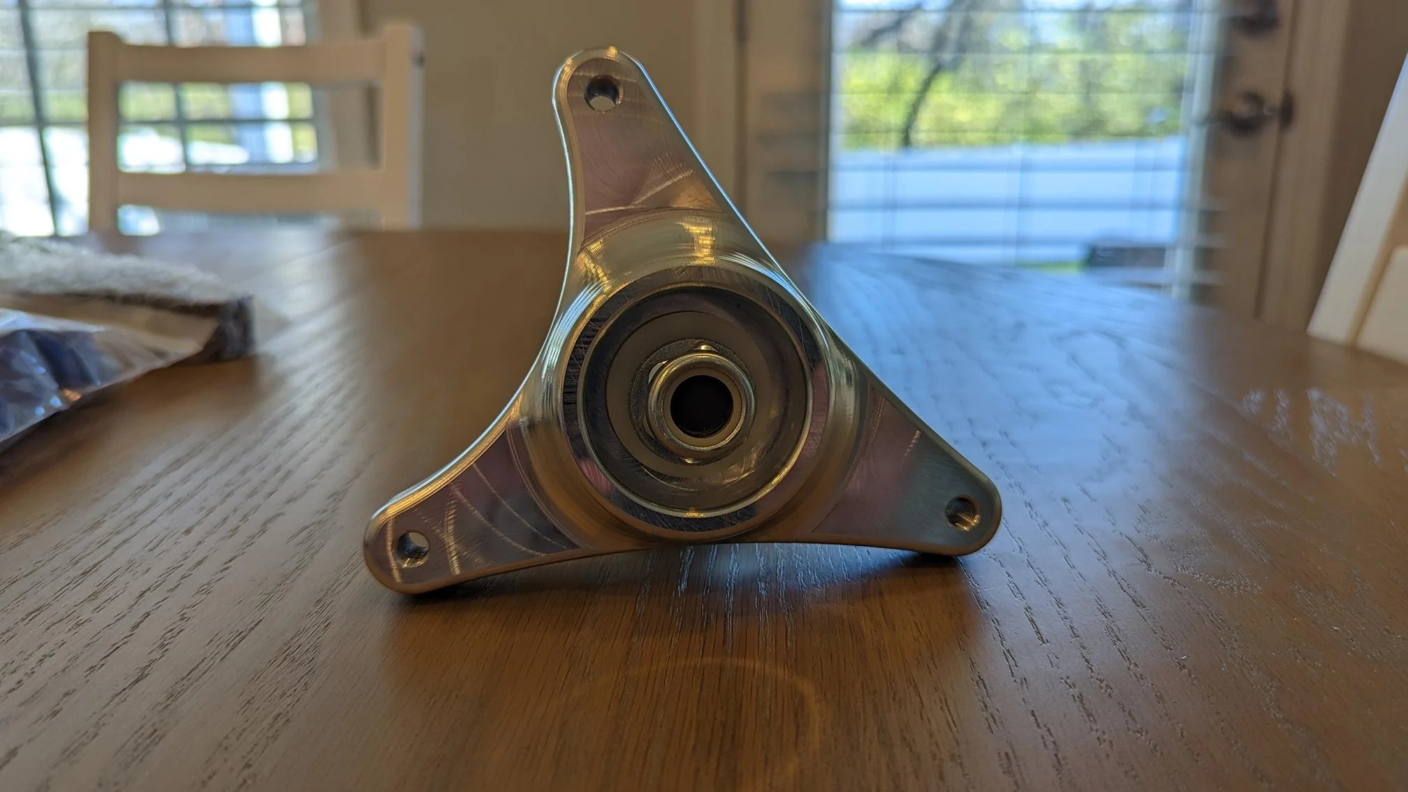

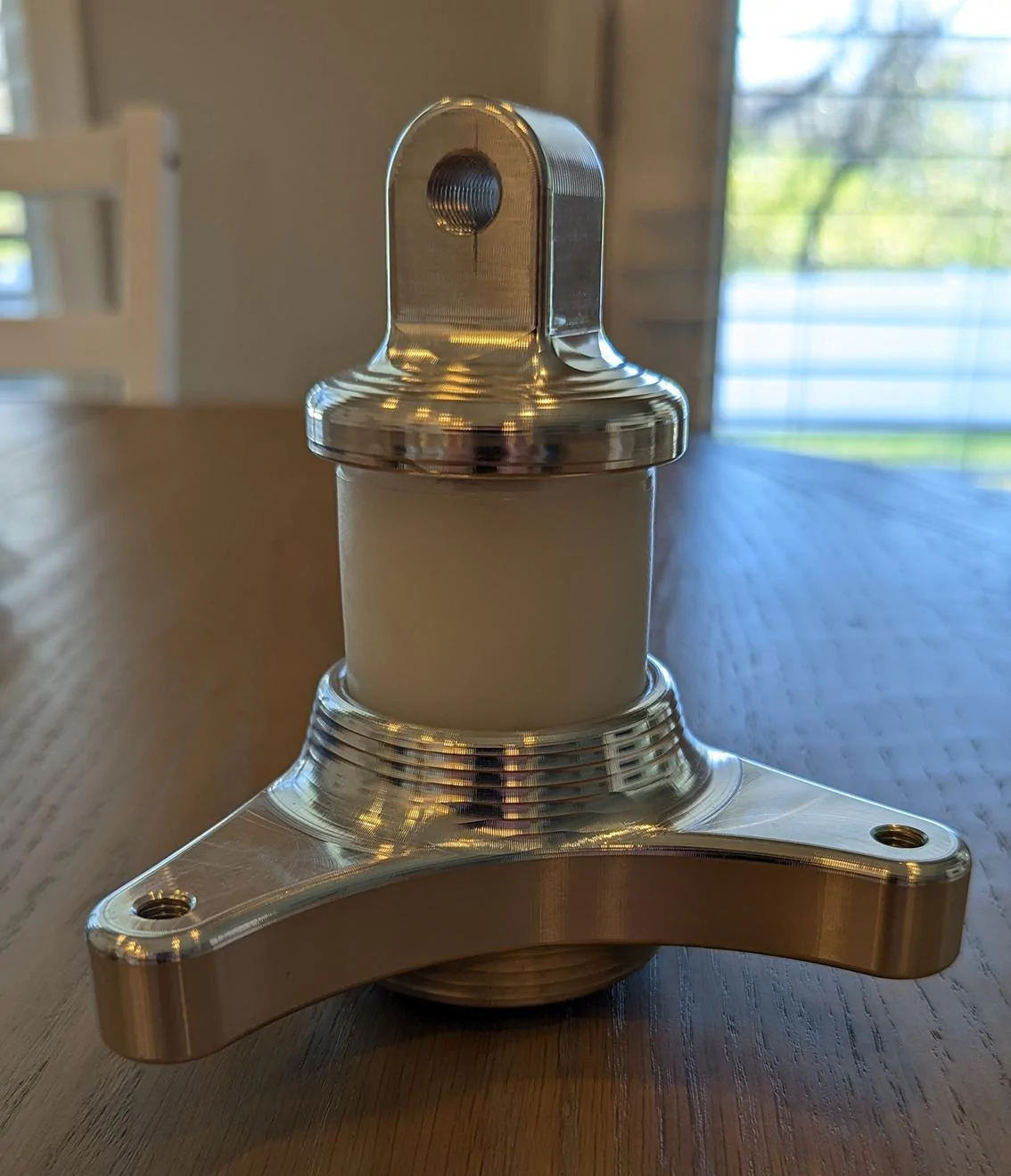

Pretty much all of the links on their website are broken. Rich (the owner) is, however, very responsive to email inquiries submitted through the website and extremely helpful and pleasant, I let him know I wanted to buy these after a short discussion by email and he sent me an invoice to pay online. They offer a race version (pictured below) and a street version. The only different between the two are the hardness of the poly used in the product, with the race version being a 65D hardness.
Both products use a different philosophy in their design, and each of the designs have merit. I've made the decision to install the Verus Engineering product with the 90A hardness bushings, as I believe they are better designed to address lateral movement of the motor as it shifts. Both products are beautifully designed and produced. The billet aluminum Doteki motor mounts are almost too pretty to install, and I will gladly put them on a shelf in my office as a conversation piece until I (most likely) sell them. I welcome any and all input and calling me on my bullshit.

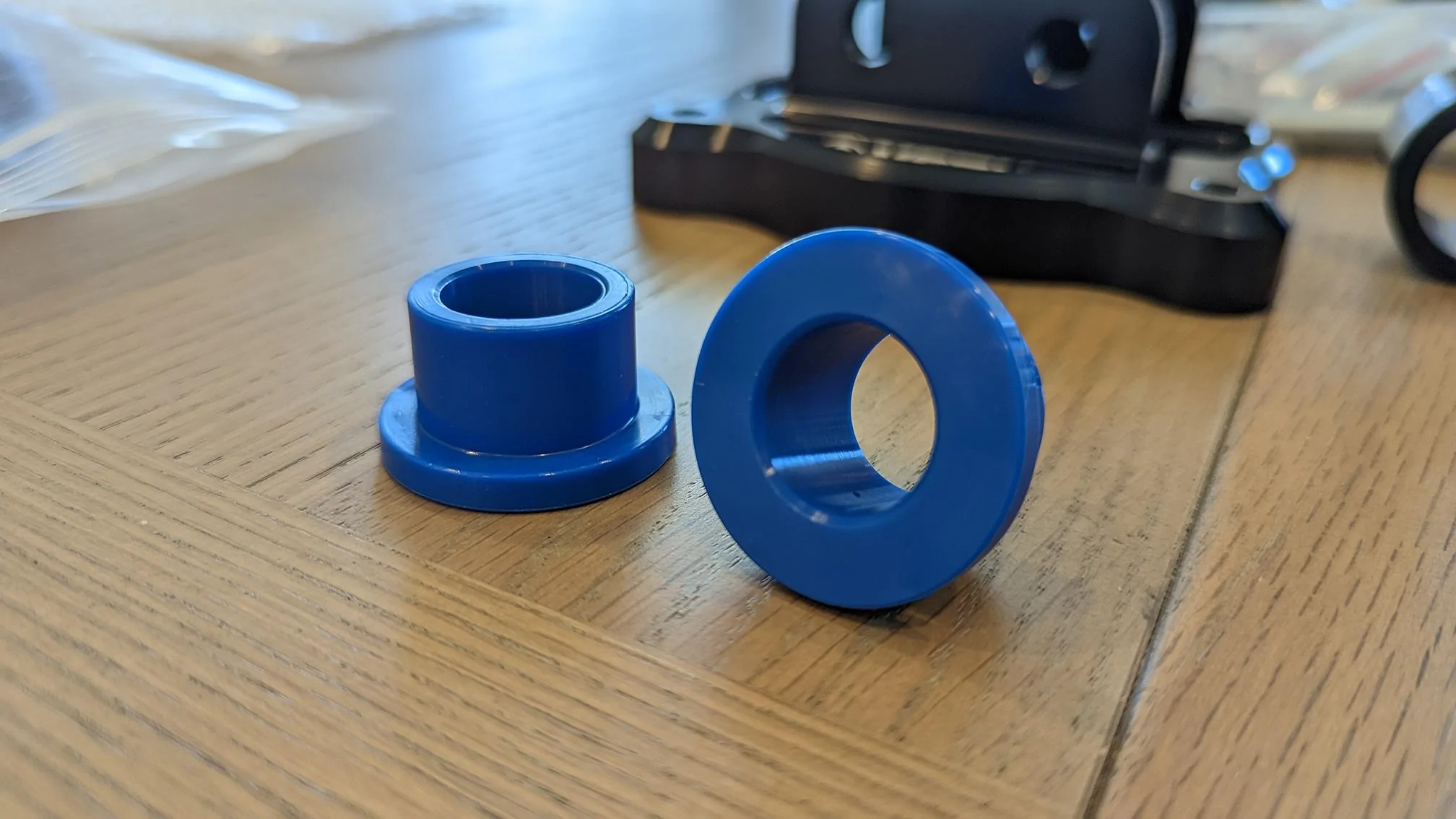

Ok! Got the chassis code cleared up and put in some seat time today. As I've noted briefly elsewhere, it's a stiff motor mount (90A insert). Additional NVH at idle. Plastic-to-plastic surfaces now buzz against each other. It's difficult to see anything in the rear view mirror at WOT because of the vibration... though some of that has to be from the catless downpipe that went on at the same time, which is so f'ing loud. It's tough to tell. I noticed this on one other car I put stiff mounts on, but there's additional and different feeling NVH through slow sweeping turns now that would have normally been soaked up by the stock oil-filled mount. All that said, the motor doesn't torque around under the hood any longer when hitting the throttle, which feels more direct during launches and when rolling on it at-speed. Shifts feel more direct, too. Just feels better overall from a driving dynamics perspective.

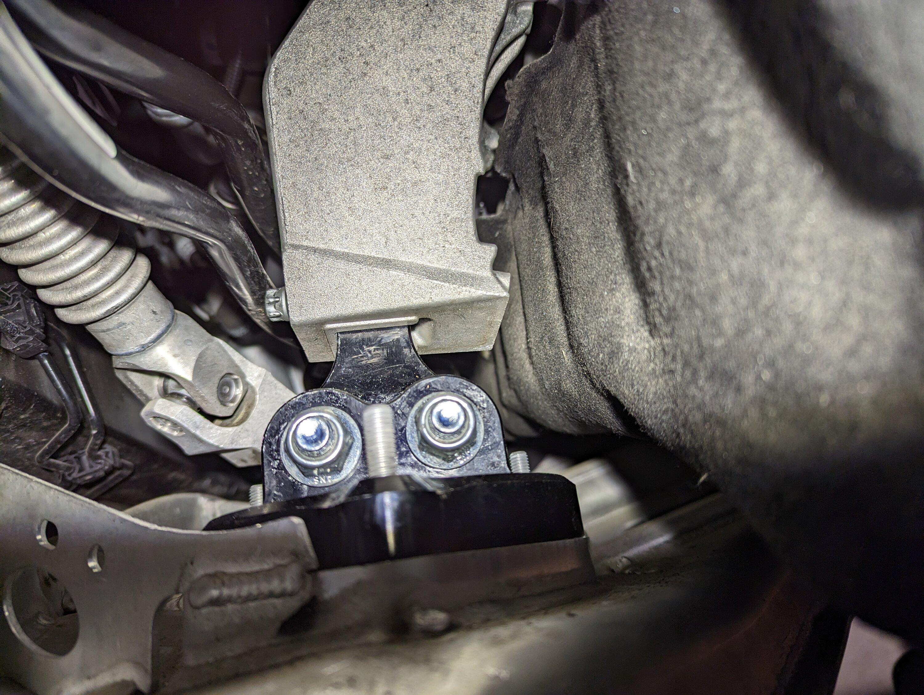

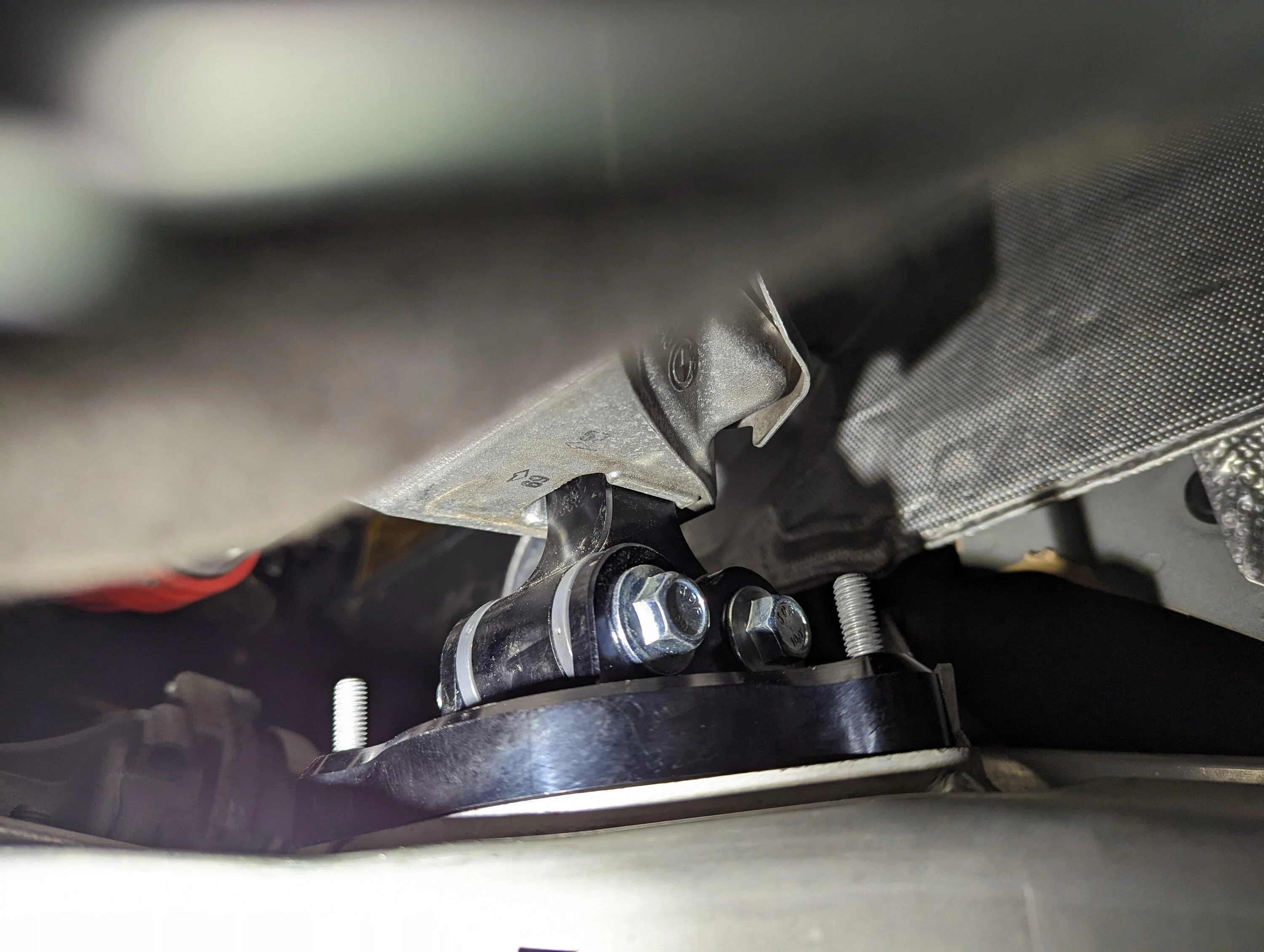

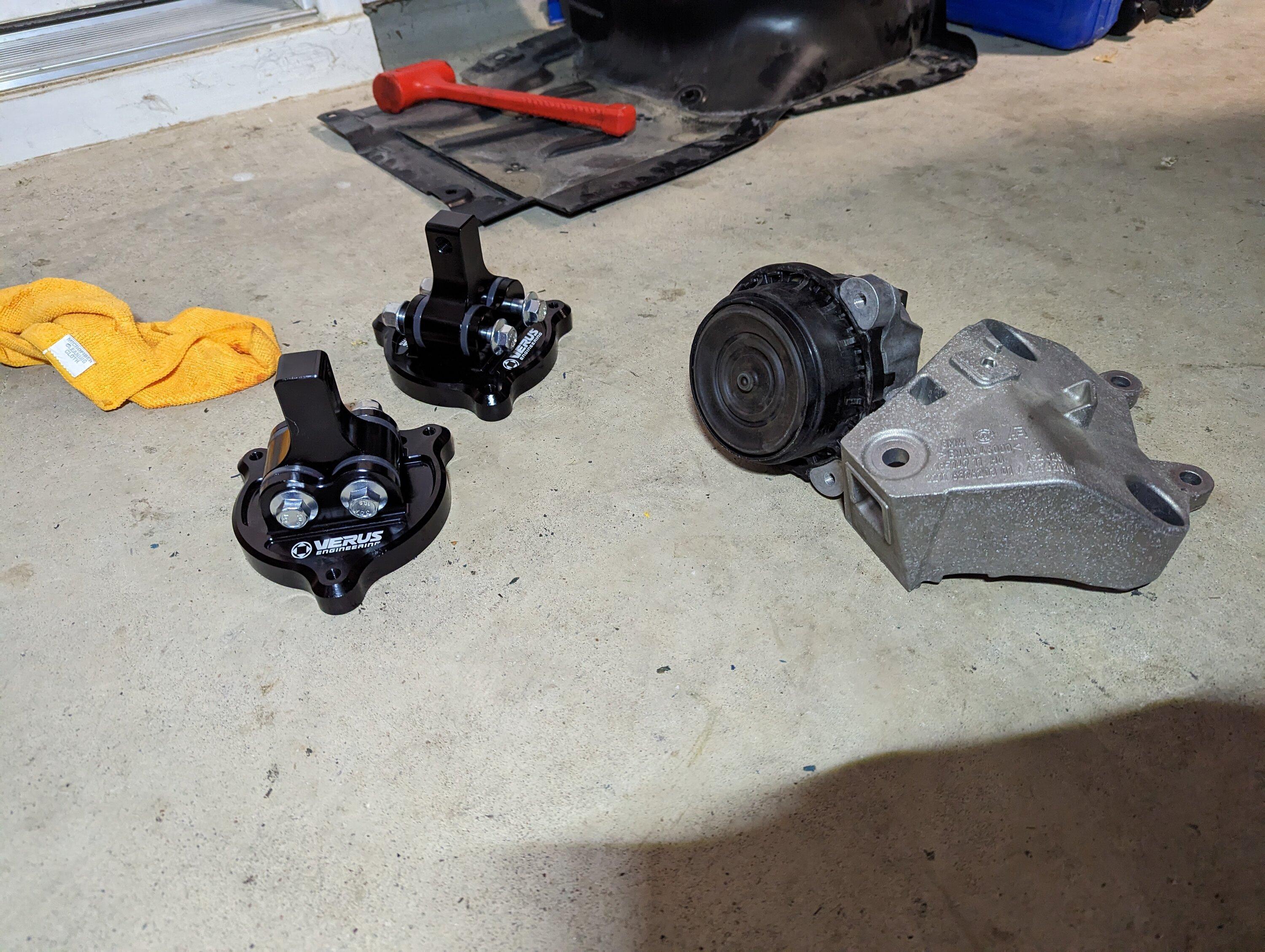

I'm mid-install right now. Almost have the driver side mount out. Saving this spot for an update.
Got the driver side out so I'm basically home free!

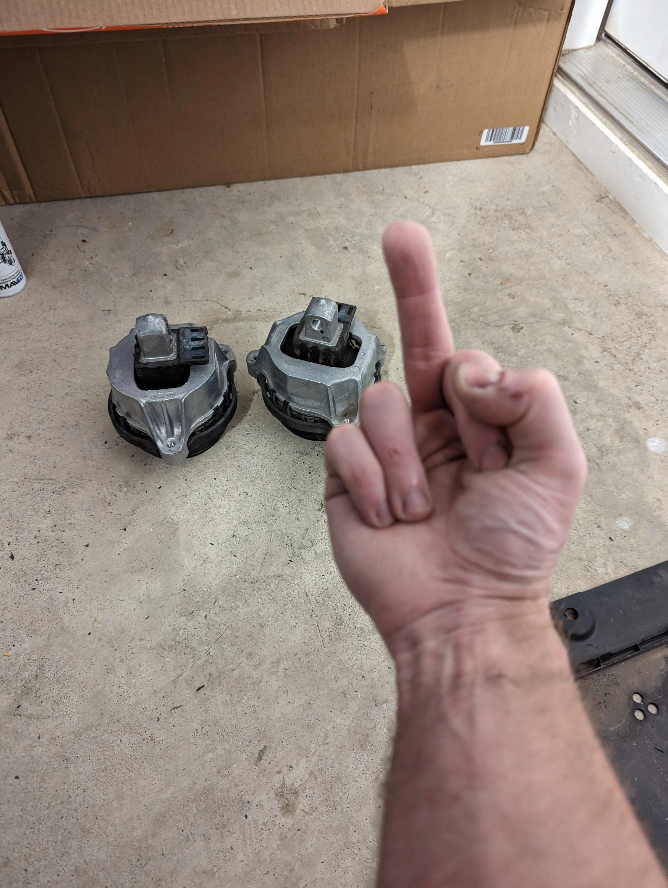

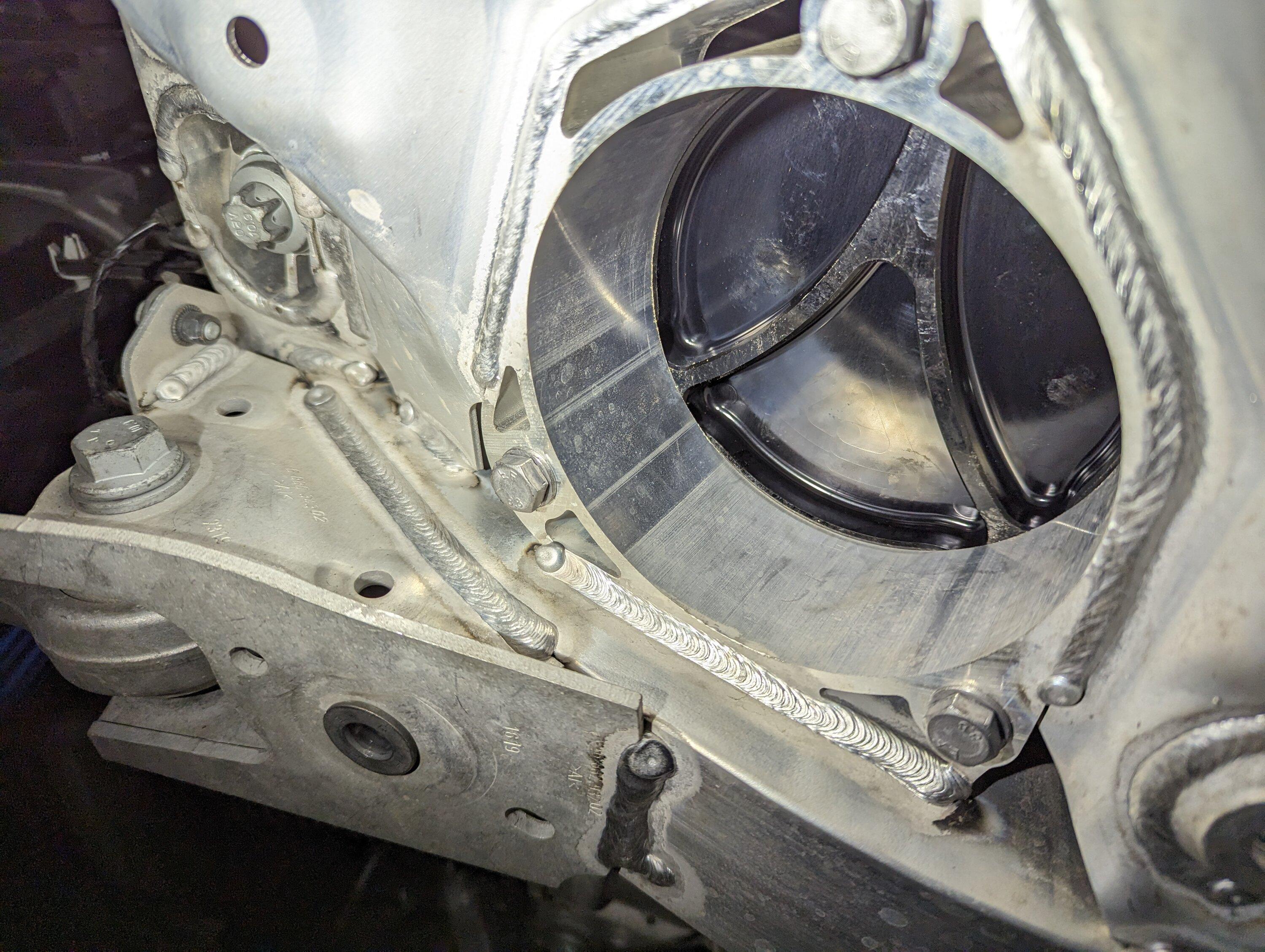

The underside of the Verus mount after OEM removed:
The driver side Verus mount installed:
The passenger side Verus mount installed:

I installed an MST intake recently and the clearances between the bolt that goes through the airbox mounting gasket and the end of the air filter was tight. So I asked the wife to sit in the car and rev it a bunch of times while I stuck my fingers in there to see if the motor torquing would cause it to rub. With the blue (stiffest) motor mount inserts, there was essentially zero movement. Granted, the car was in neutral so there was no resistance, but it was pretty dang impressive.
