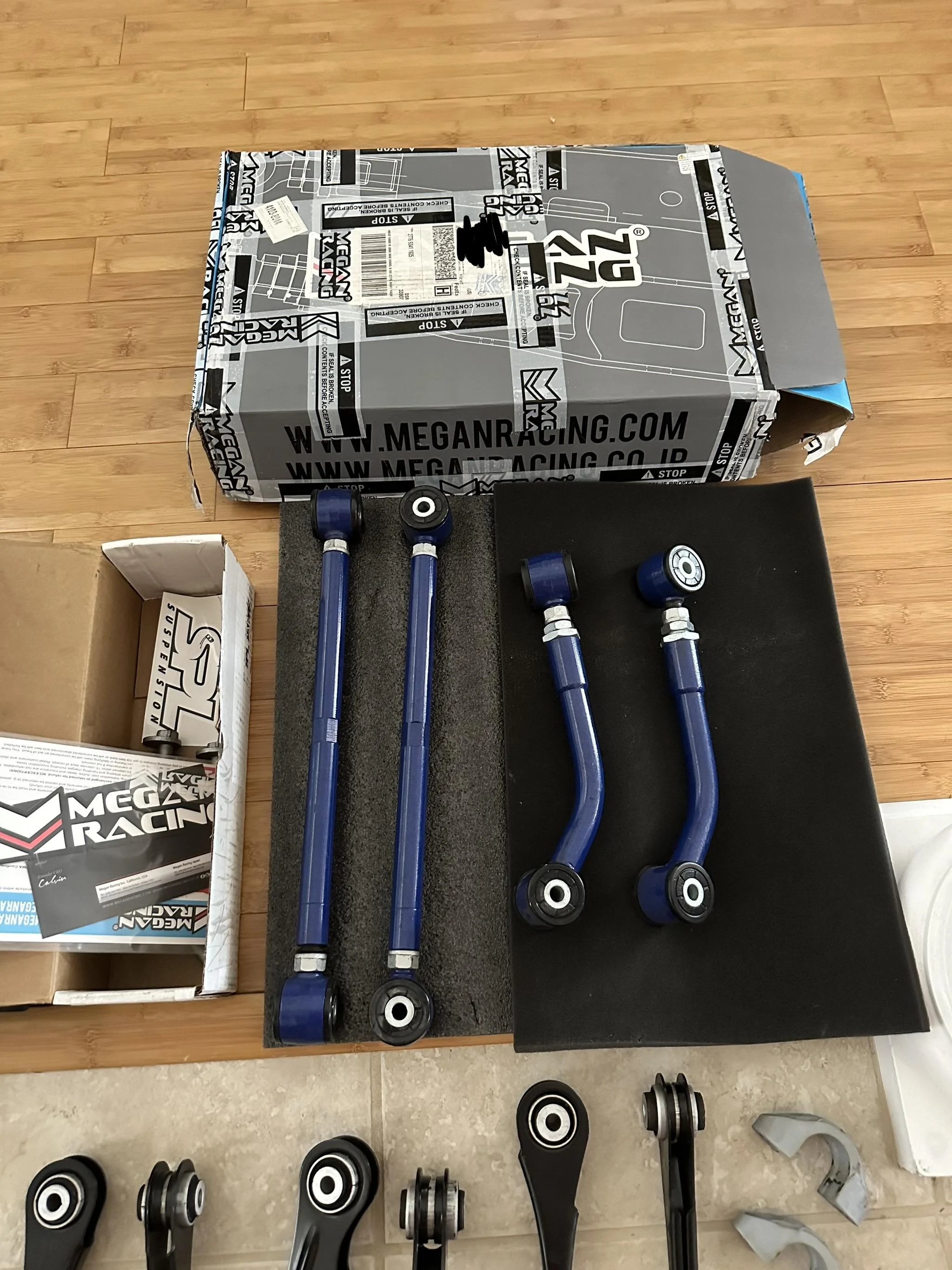

Megan Racing Rear Toe Arms (Rear Lower) and Megan Racing Rear Camber Arms (Rear Upper). Nothing wrong just wanted to have all matching SPL parts. On the car for approximately 300 miles.
OEM parts available too, if interested.

How much? How are they compared to the spls?
I paid $392. So, $200 should be good. They're definitely more robust than the OEM parts. I just wanted to keep all my upgraded parts the same :).

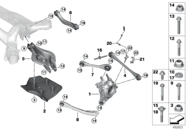

Do you need to drop the rear subframe to install these rear toe and camber arms he is selling?
suicidaleggroll
Adam
Mar 29, 2021
1,021
1,755
Colorado
If I understand correctly which arms he's selling, no. There are 4 replaceable arms in the rear:
1) lower traction link - can be replaced easily
2) toe arm - can be replaced easily
3) upper camber arm - can be replaced relatively easily
4) upper traction link - need to drop the subframe to pull one of the bolts
I believe he's selling #2 and #3

No. Only the forward rear upper bar needs the subframe dropped to get the bolt out. #7 in this diagram.
What he is selling is #6 and #4
