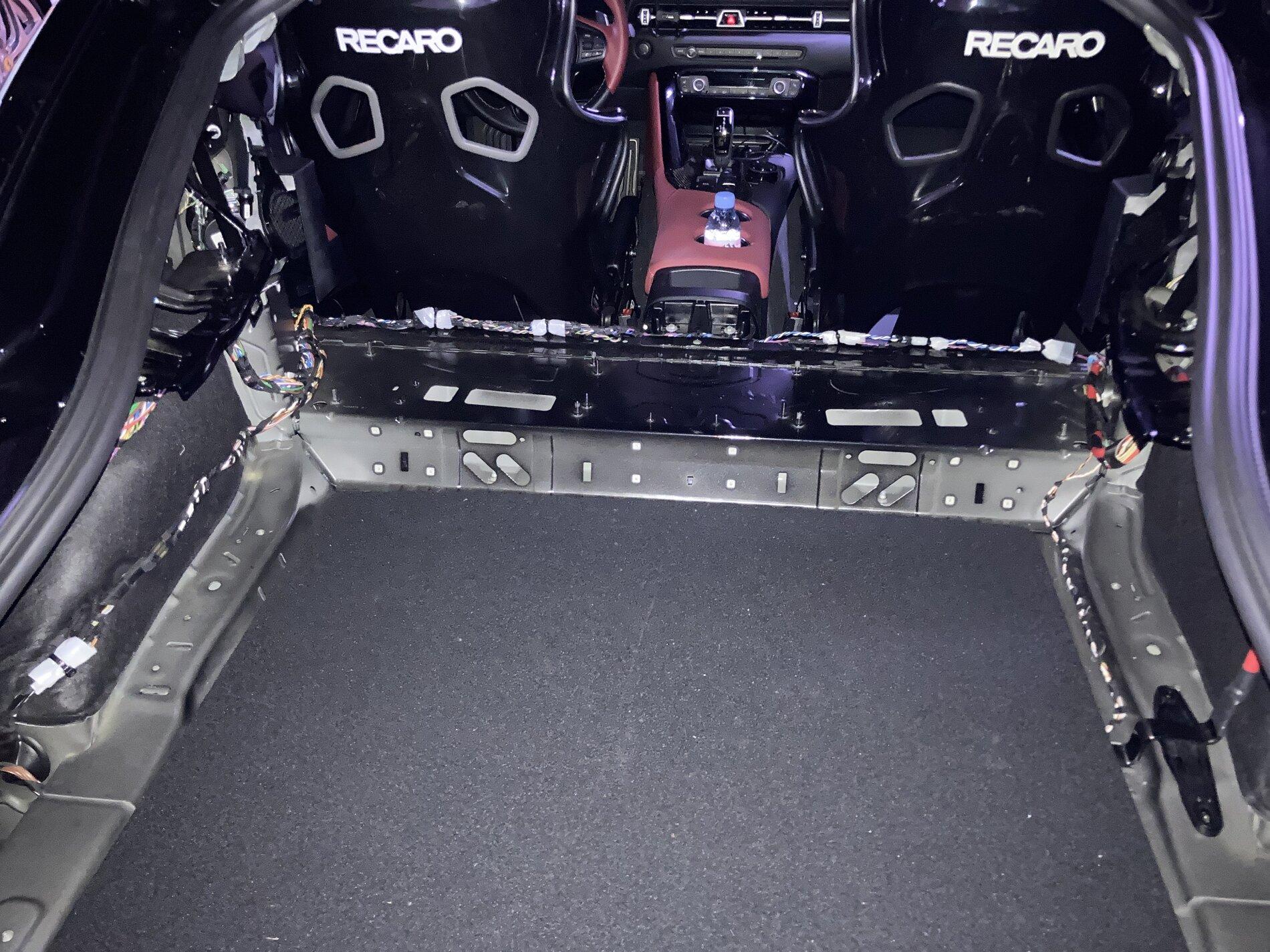

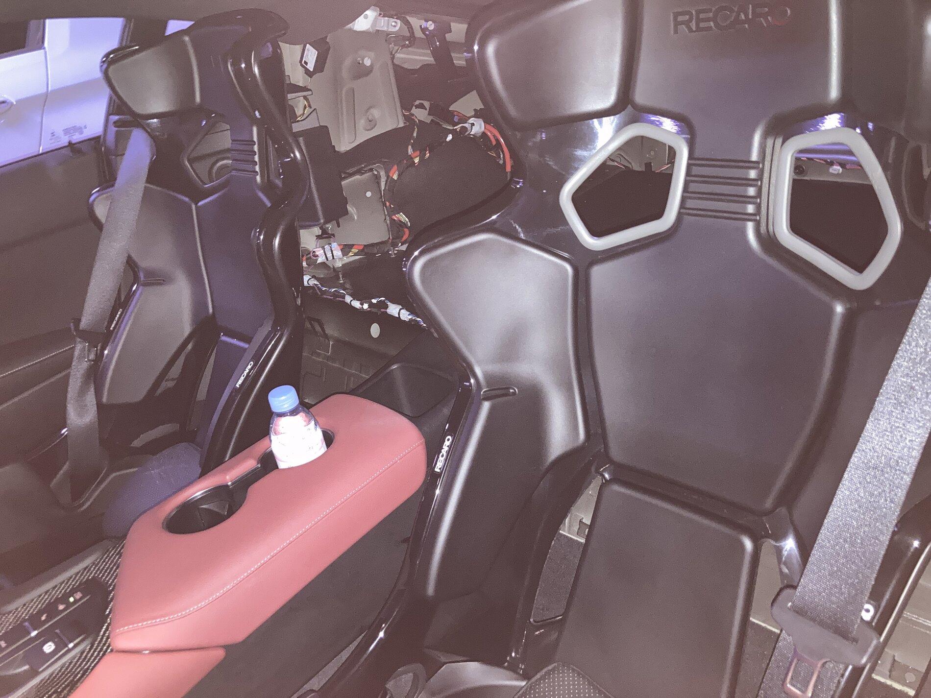

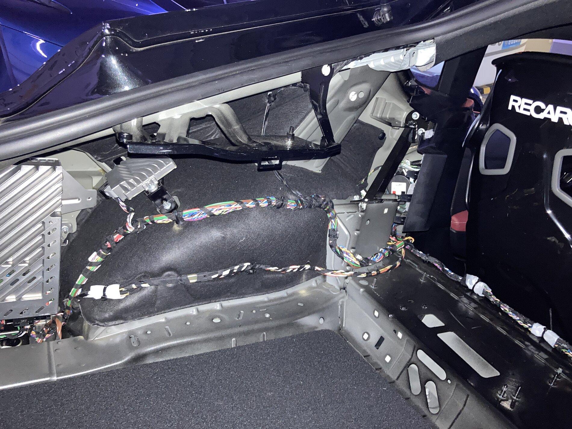

The noise is comming from the rear whenever car gets over uneven surfaces or bump.
I thought rear interior has something loose. I teared apart the whole rear section removed speaker and everything and still not found the source yet. Anyone can help me??

You on lowering springs? If so I would check to make sure it is installed correctly. Also make sure the rubbers are on it. If you are not on springs you can check the battery compartment area or surrounding area to see if anything is loose.

Are you using the tonneau cover in the rear hatch? I had a similar issue and after removing this, it went away.
Everything is removed from the back and sound is still there. Sadly...

Rear crossbar? Mine makes a metallic sound when I corner. Sounds like it's coming from the mounting point on the driver side under the plastic. Just hasn't bothered me enough to dig into it in the 115 degree heat.

Mine also made sound over the wheel arch driver side and I suspected cross bar too but now everything is gone, sound worsened and it is more likely from the frame rather any attached parts.... will see and report how it goes if I can pinpoint the source
