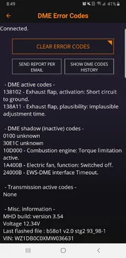

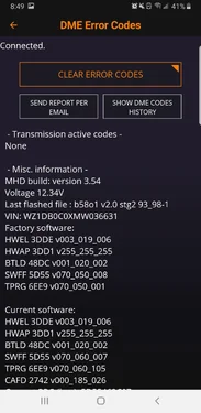

Not the op...but I got a chassis error...
NOT a drivetrain error...
When I pulled codes it same something about torque limited?

chassis error, is almost always not associated with DME. do you have suspension mods? those DME code, shoot MHD an email and they can let you know whats up and take care of you. but the torque limitation code on the DME can be a result of whatever the Chassis issue is.
If you have Bimmergeeks Protool, you can use that to read every module in the car and see what you're getting a chassis error. Usually its a leveling sensor, but not isolated to that.

I have lowering springs but they've been installed for a while now..I checked the rear sensor n it looked fine. My headlights self adjust so I'm going to assume that sensor is fine. I have not looked at the front one though.
Just strange I got the error after flashing stage 2.
I'll reach out to MHD if I get the error message again.
