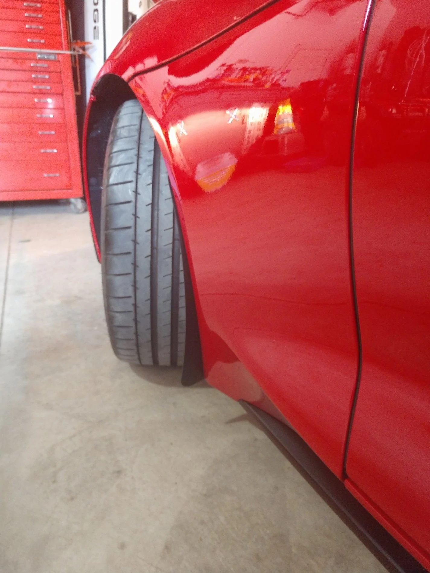

Wow, I literally last night just had the same problem. My kitten carried off the little bag with the replacement plastic rivets, and we can't find it anywhere. We hit up Autozone, and found they carry a large selection of 1/4" (hole size) plastic rivets. The existing holes in the fender are just a tiny bit smaller than 1/4". I used a sharp 1/4" drill and widened the holes every-so-slightly, then the 1/4" rivets fit great. The one's we bought were about twice as long as the stock rivets. No big deal, there's plenty of open space behind these.
Here's a pic.

Great. Thanks! Ill check those out. When I called the dealership to see if they had just the OEM ones they said they didnt have any and had to order them.

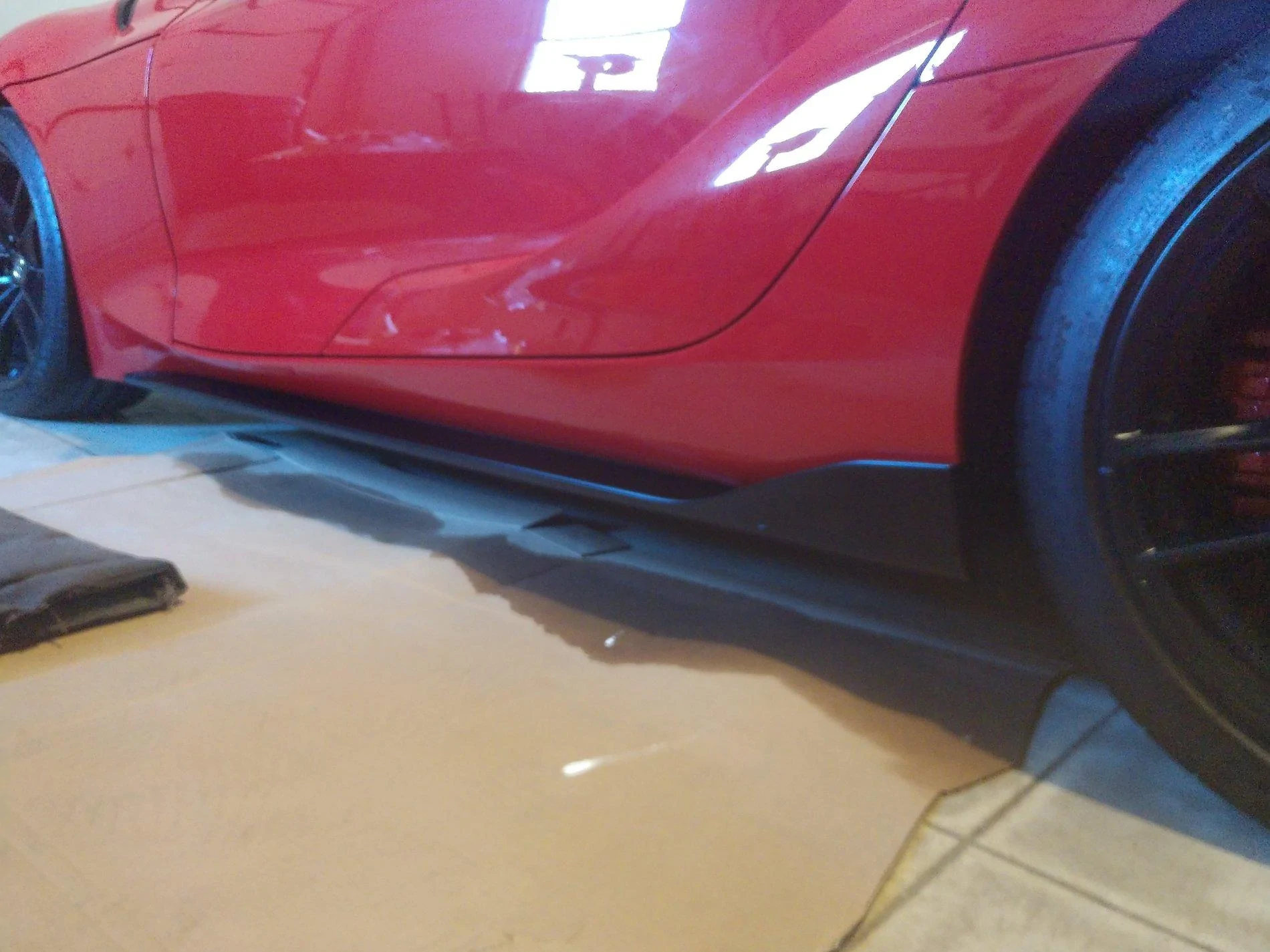

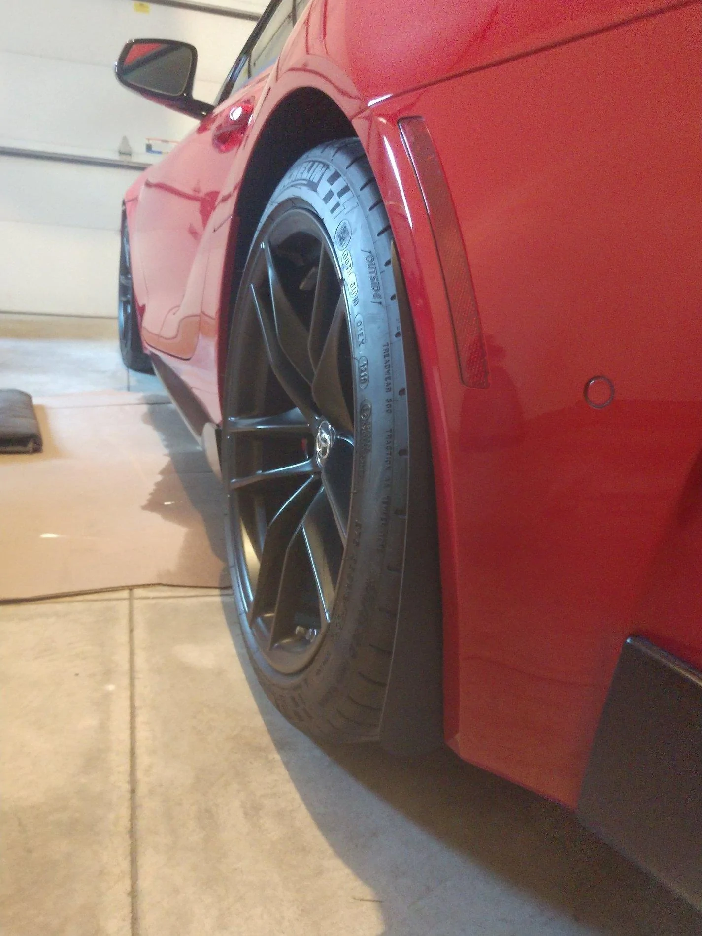

Did these on mine as well. I actually like the look of them. Install was pretty easy, Didn't have to remove the rear tires. I was able to put a screw driver bit in some locking pliers and secure it in.
