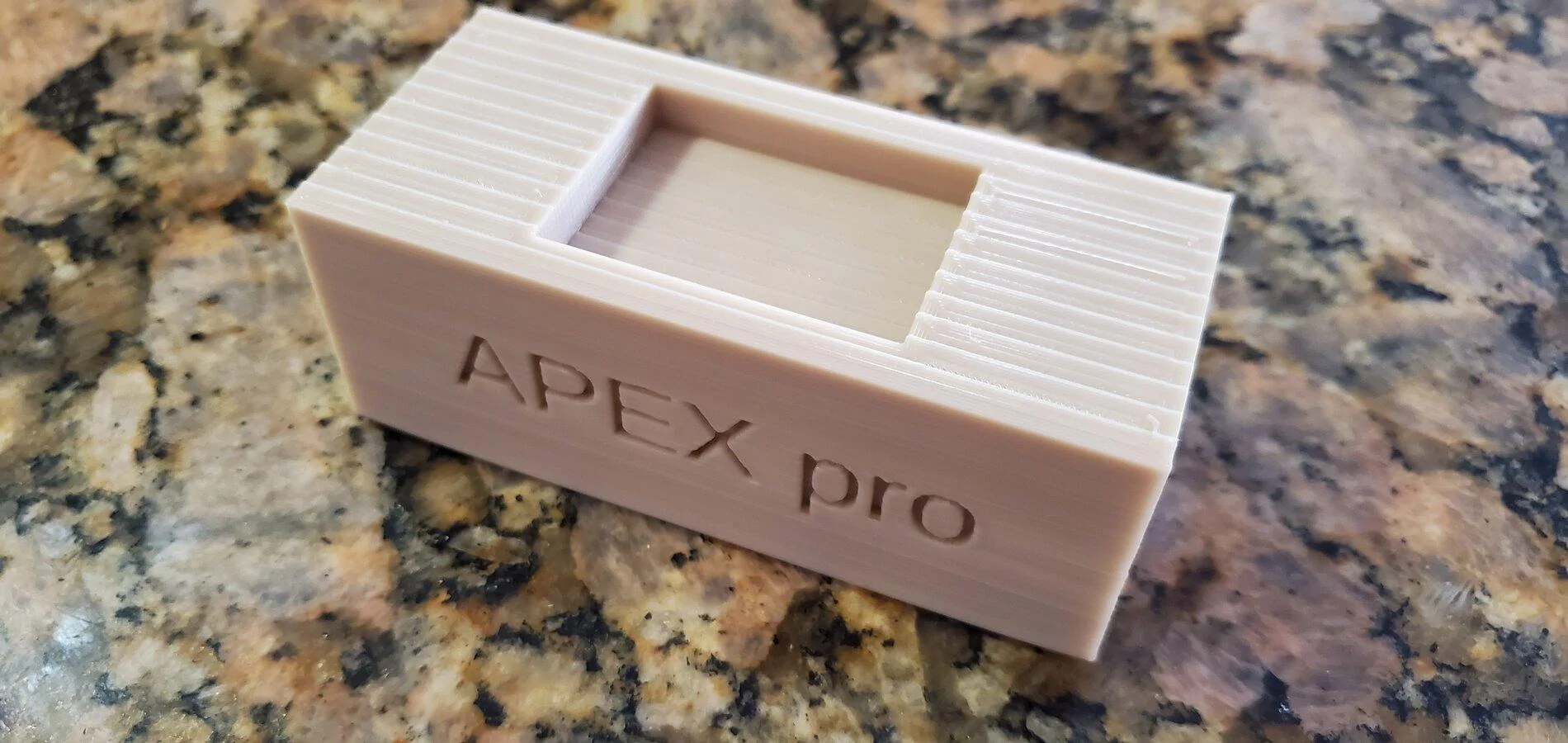

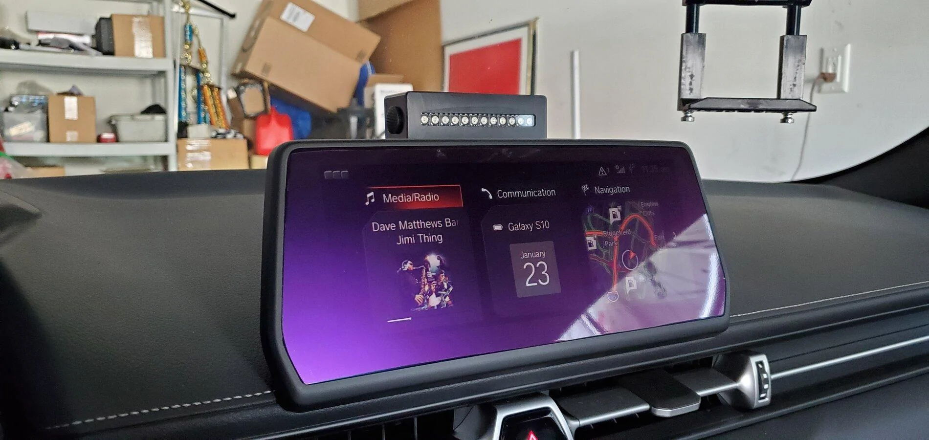

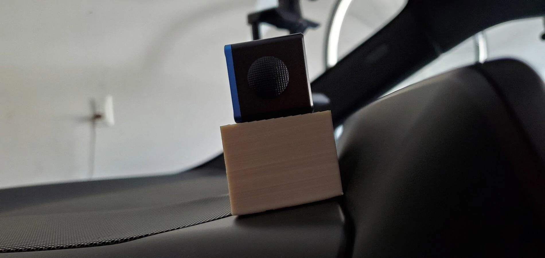

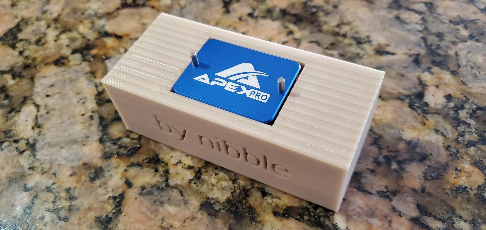

Mounting APEX pro.
APEX pro is data acquisition device to indicate if a driver is using full traction on the track. However, mounting it in Supra /w my requirements wasn't trivial. So I had to make my own contraption.
Started /w design on pen & paper then moved onto CAD to make this. And 3D printer spat out this.
/w mounting bracket.
mounting test.
Although I can see the display ok, I think I will redesign to make it a bit more parallel to dash board.

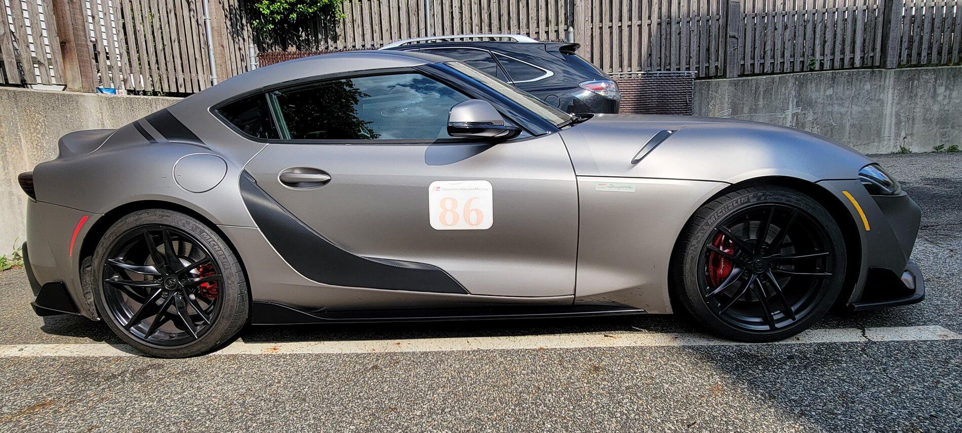

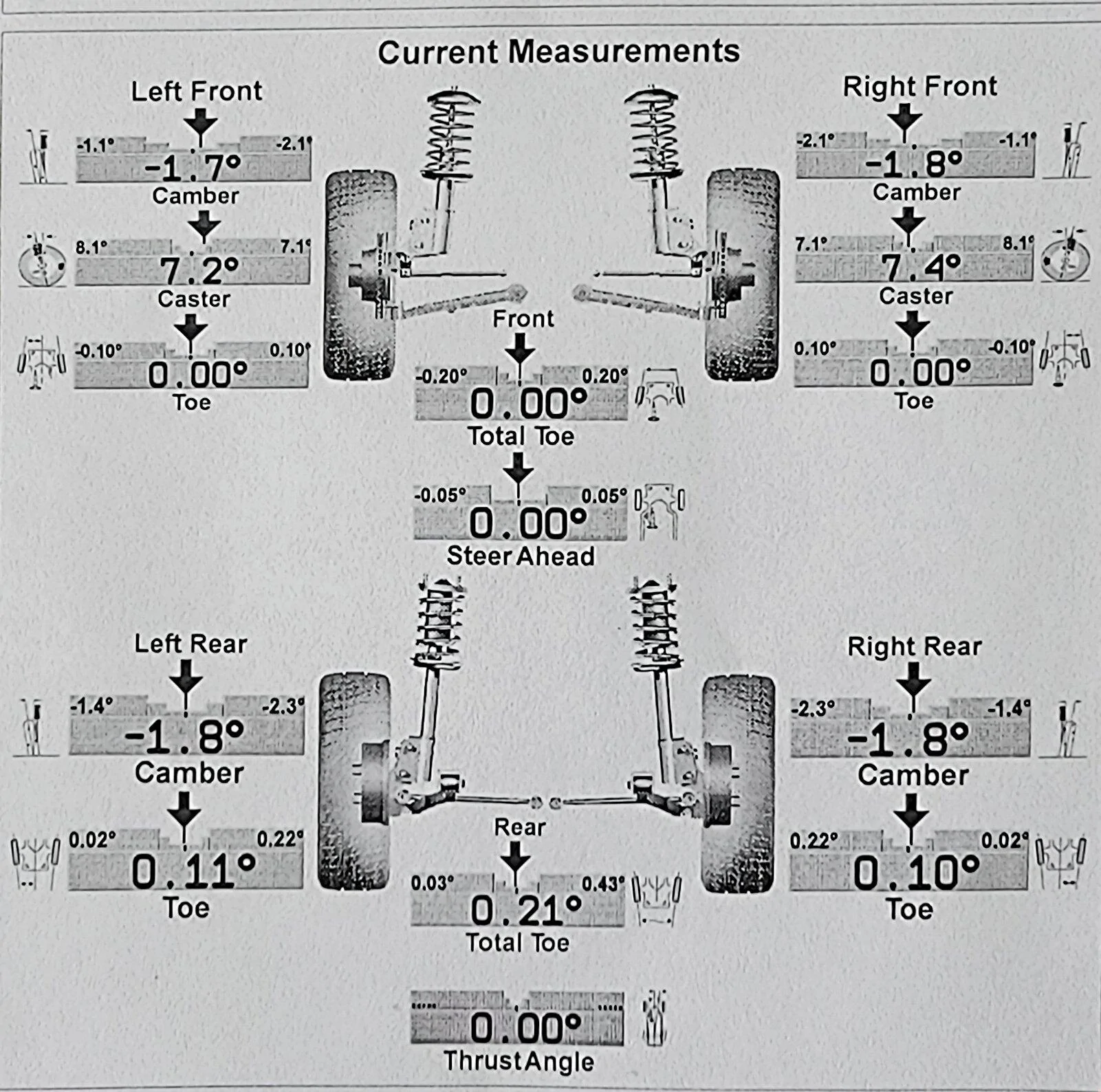

New setup was tested in NYST for the first time. I am still getting used to at the setup but I noticed this setup promoted slight over steer than previous setup. It felt almost as if car wanted to rotate rather than turn around. Quite impressive but I know I need to get used to at this setup better.
as for 285 square setup, it was very comfortable driving 3 hours to the track and come back. Pirelli P zeros are expensive but very quiet. with 5mm spacer in front, concern was weather this will rub fender liner/hood but there were no indication that it touched any of it throughout the day. It's at stock height.
So far, I'm happy /w setup, kudos to AZP Installs, APEX performance & tirerack. more testing to be done in future.
btw, with the tire size, 285 35 18... on the way to NYST, speedometer constantly displayed 4 mph higher than GPS (waze on samsung galaxy S21) at speed limit of the road, but on the way back, only 1 mph higher than GPS. I will have to see if it changes back but it was something I thought it was interesting.

I'm glad this setup worked well for you on track and that there wasn't any rubbing up front under suspension compression! Thanks for the order and enjoy the wheels!
