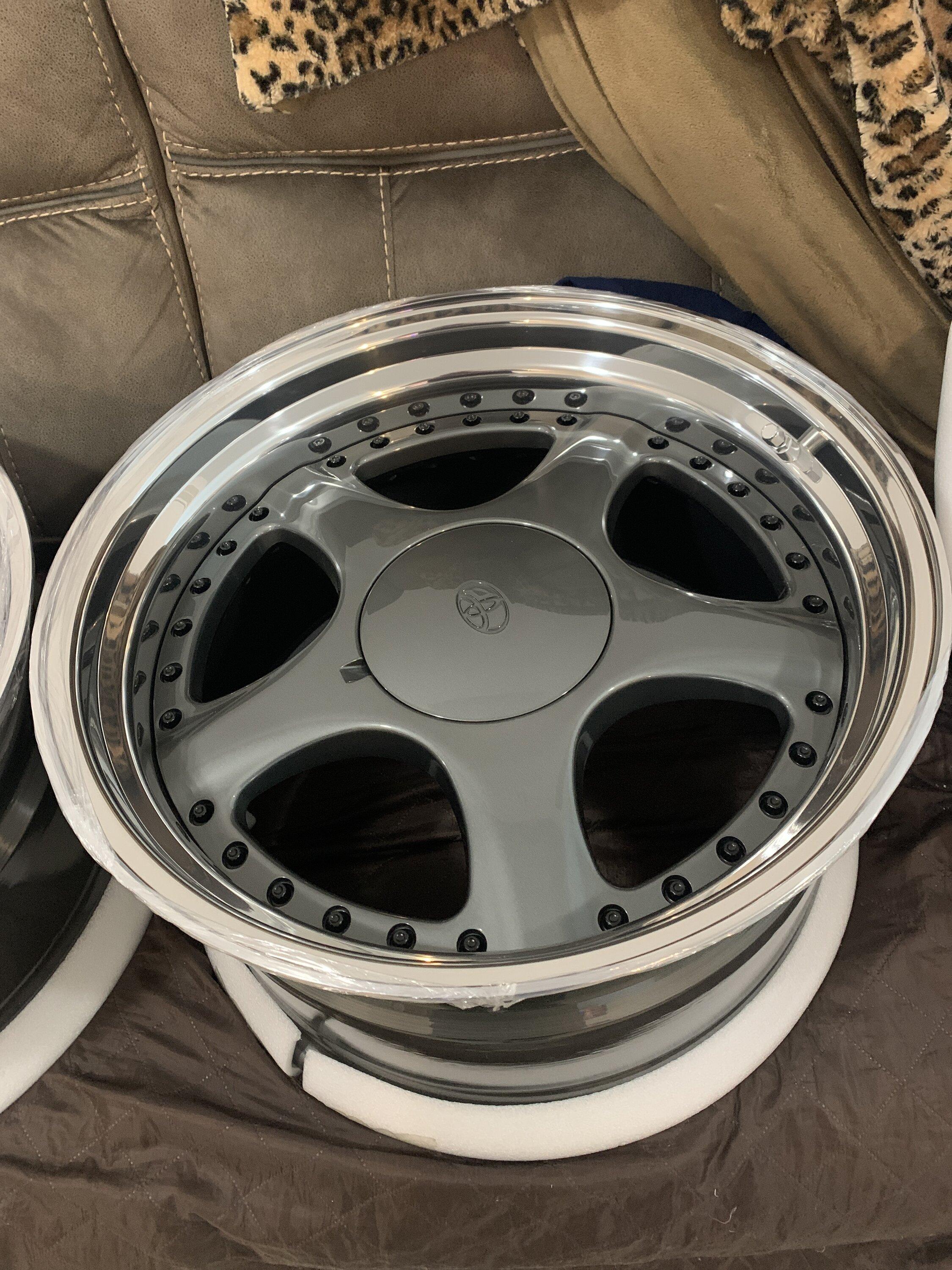

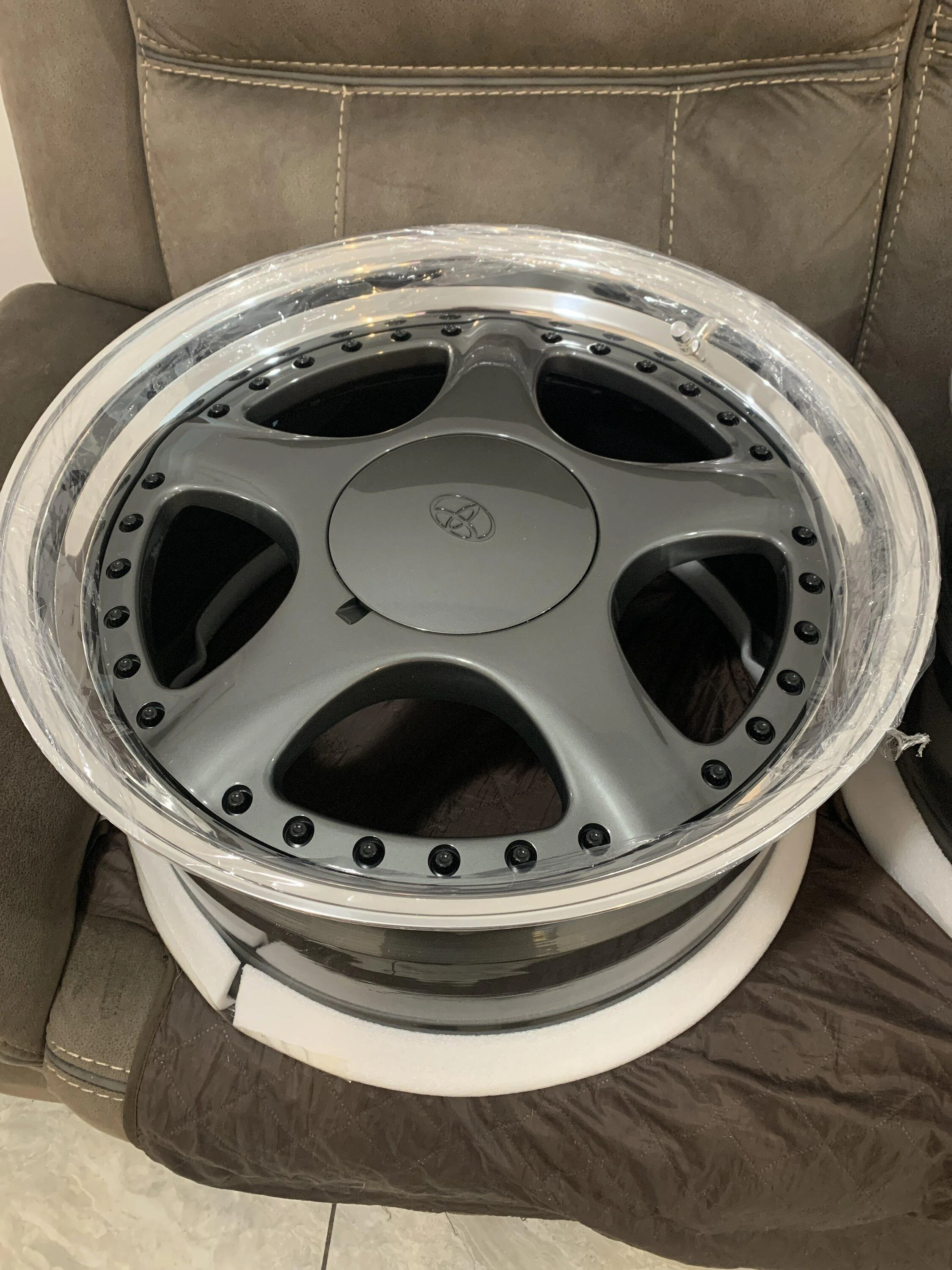

I'm trying to do 19x10 front and 19x11 rear but don't know what offset to do on a 3 piece wheel so I can get the biggest lip on the wheels.. If anyone has done this please help.

Thank you guys for giving me info, I think I'm going to go 19X10 22 offset front and 19x11 35 offset rear
