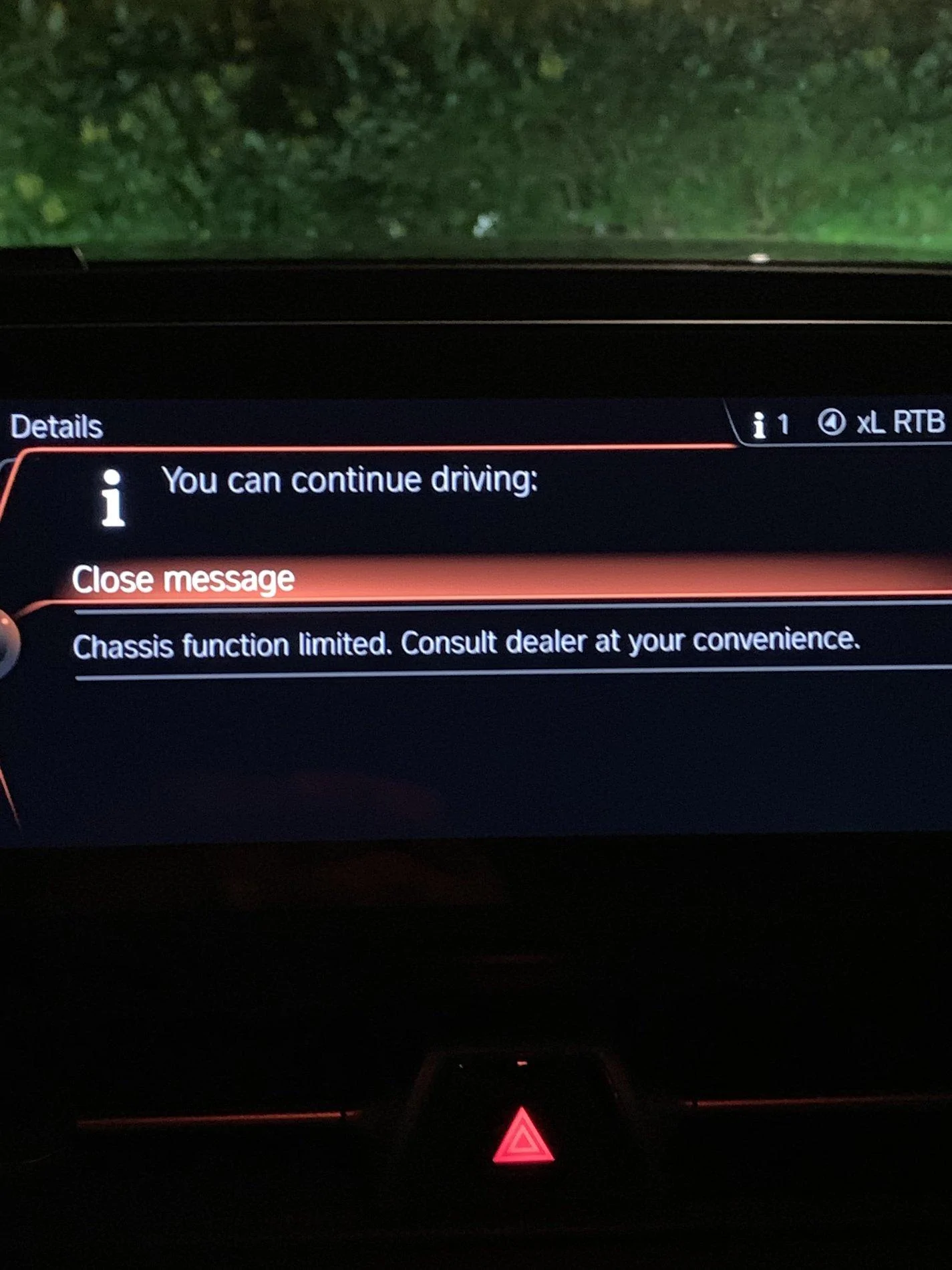

Hey everyone, first post on the forum, but been following for a while... not sure if this has been discussed, but when installing 20” wheels/tires and lowering springs, the A90 pops up tire size and chassis messages. I’m sure the guys at Titan and Induction have seen it. Is this some we can clear/set ourselves? Any input is very appreciated!

How about a photo of the messages? This is surely something we've dealt with on the BMW side before.

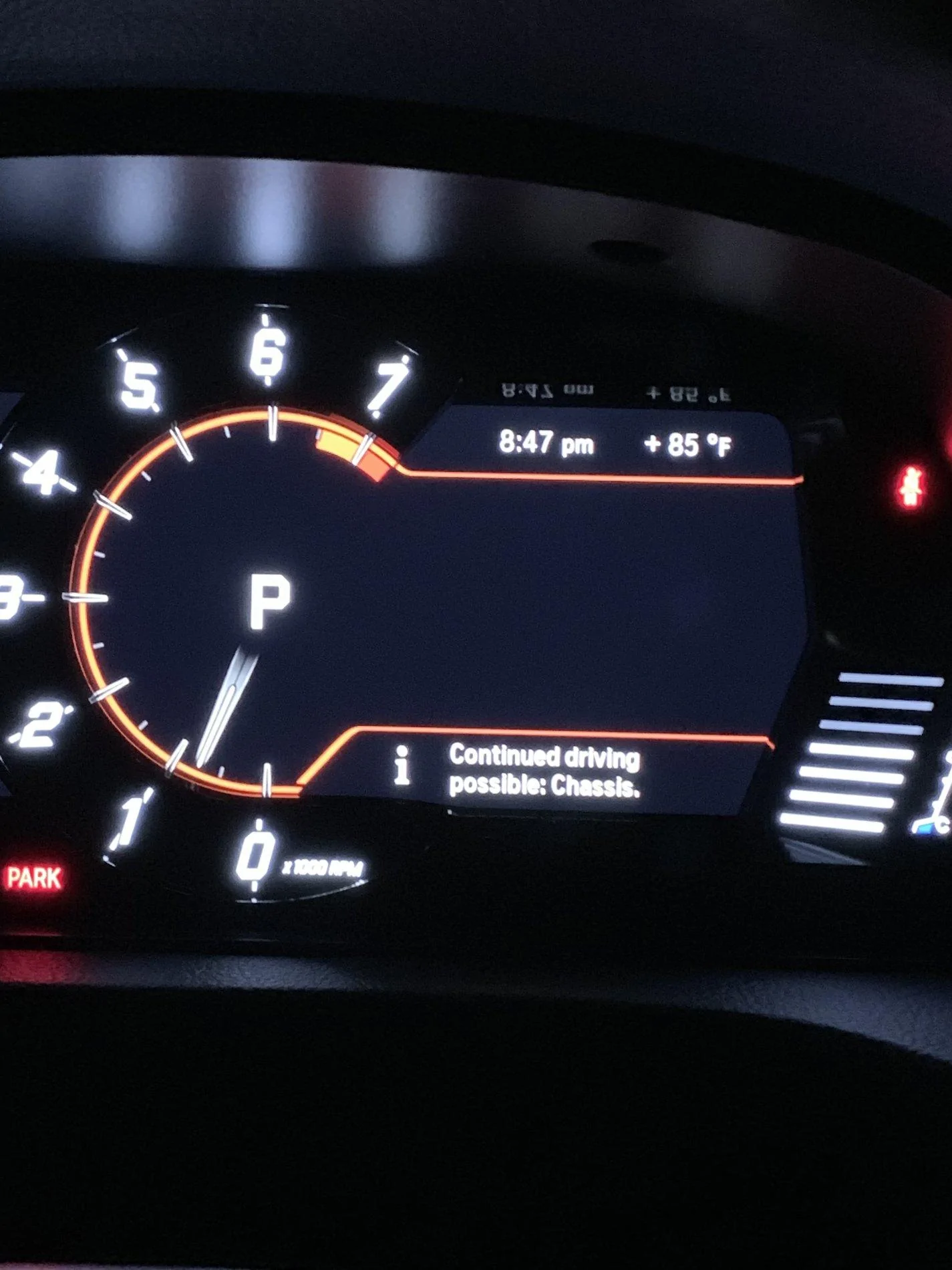

thanks for the quick reply!
the message is “continued driving possible: chassis". i’m pretty sure due to the H&Rs...
for the tire settings, i left it at custom 19”/275 and the tpms synced up. that message went away. i’ll upload a pic in a few
here you go...

So the TPMS message is usually related to the iDrive display where it shows you the recommended pressure next to the actual pressure. To do this it has to know what tire setup is on the car, and it usually gives stock options, as well as an option to "train" the system to a reference cold pressure if you don't have one of the stock tire combos. This is purely about that iDrive display and won't affect any functionality at all. The TPMS system learns new sensors by a different process.
Regarding the chassis warning, you might want to carefully examine the shocks/struts on all corners to make sure the wiring for the adaptive suspension wasn't disconnected or damaged. This controls the damper rate when you select driving mode. I have heard of cases where the wire gets disconnected or damaged when doing suspension work and it triggers a chassis message. Can't say if it's the same one, but it's a likely guess if you just were in there installing lowering springs. I assume you kept the stock shocks and struts, correct?
very much appreciated! you’re correct, I kept the stock shocks and struts, only installed the springs. i was afraid that damage to the wire/sensor could’ve been it... hopefully it’s just disconnected.
