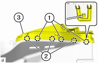

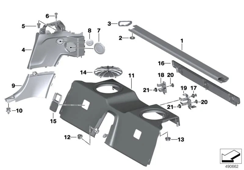

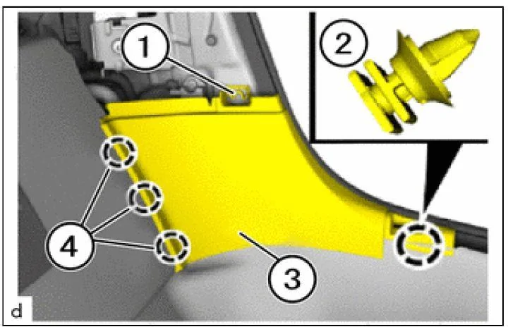

JasonO
Jason
Oct 30, 2019
453
559
Lake Charles, LA
Supra LE
Which panel is bolted? I'm planning to tear mine apart in the next couple of days and don't want to pull on it and crack it. Thanks.
Panel 4 in Tadda’s post above. Removal of that panel is not necessary for the bar removal. I just know it is necessary for sound stuff and was in the area he was working, so I went over it just in case.
