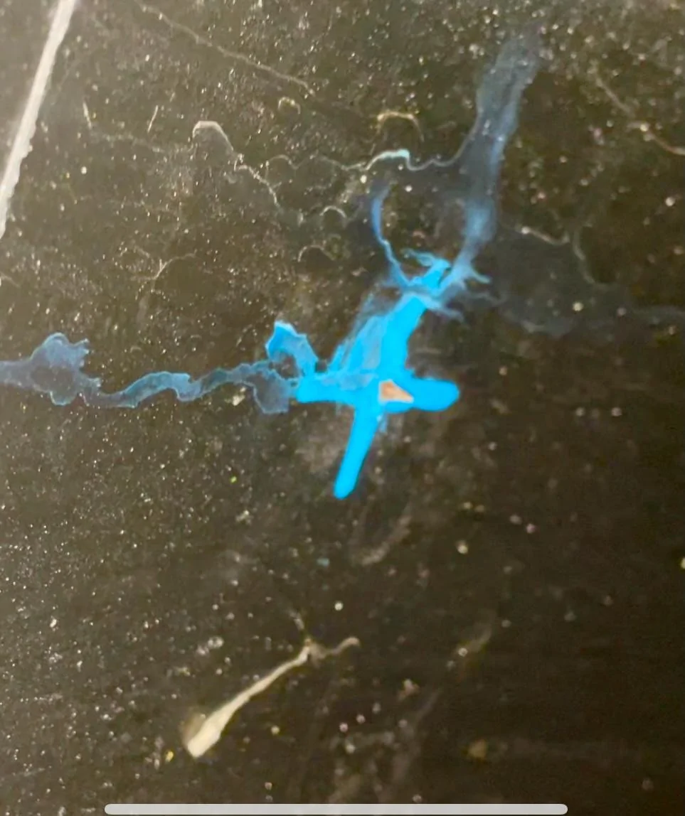

The Michelin PSS tires are so soft that they hide puncture marks. I had the same problem and didn’t figure it out until I had the tire dismounted for wheel powder coating.
I ran over a wood screw and snapped the head off below the tread line. This was visible on the inside of the tire. The outside had no signs of damage.
