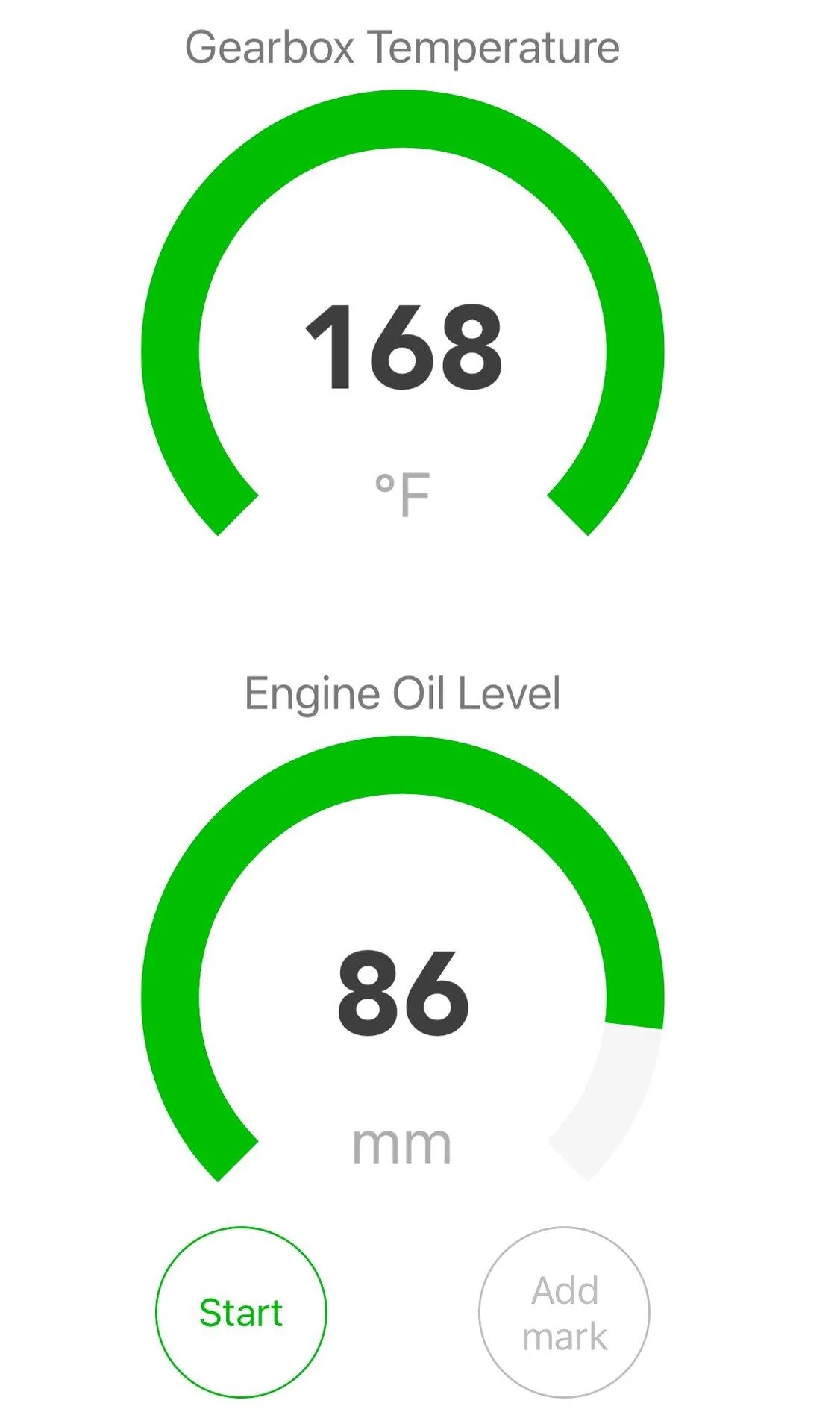

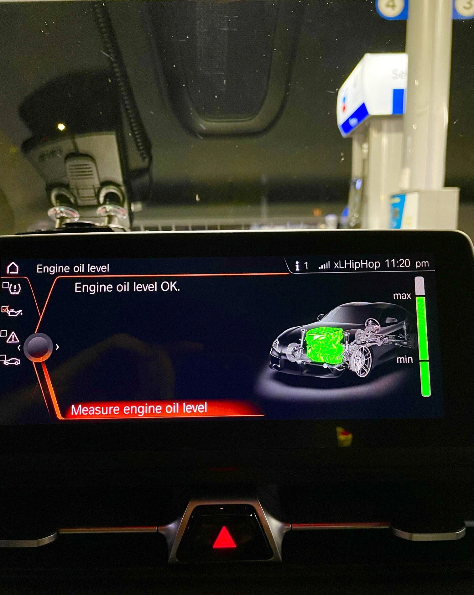

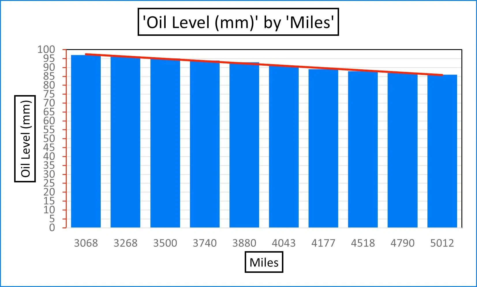

To keep gathering data with oil level concerns I’ve decided to conduct a study using my EcuTek system.
The app has the ability to take oil level measurements down to the millimeter. I’m trying to determine how much oil is consumed before the iDrive detects it.
I took measurements at every fill up so the measurement variables were consistent. As you can see my car consumed roughly 1mm per 200miles and 11mm total.
I drained the oil to see how much 11mm equaled by volume. The catch pan had 6 liters and the filter 200 mL. The total oil consumed was 300 mL per 2000 miles.
What’s wild is that the iDrive still indicated oil was at max level. I’m wondering if you need to consume at least 500 mL before it detects a lower level.
If anyone has taken readings on a secondary app when the iDrive showed it was low can you please respond here.
-RJM

Did you replace your oil sensor? Or are you just getting finer data using the ECUTek to pull from CANbus?
Loco38SUP
Loco38SUP
Feb 17, 2021
43
1,821
2,721
Its the stock sensor. I’m using the EcuTek to pull from the CAN bus. The sensor has the resolution to give more detailed readings. But iDrive software only shows a max and min scale.
-RJM

I have another update based on data shared by @Branflakes123 and compared to my own findings.
The iDrive system based on oil level is as follows:
- 100% (6.6 liters) = 97mm
- 100% (iDrive max) = 97-85mm
- 75% = 84mm
- 50% = 82mm
- 25% = 81mm
- 0% (iDrive min) = 78mm (add 1 quart)
The engine has 6.6 liters at an oil change. This equals 97mm on OBD apps. From 97mm to 78mm is roughly 1.5 quarts.
When the system hits 78mm it will tell you to add a quart of oil. Once added the oil level will increase to 89mm and read 100% on the iDrive.
I imagine this is a factory failsafe to keep people from overfilling the engine oil. Though you will not return to 6.6 liters you’re still within an aceptable level to run the engine.
This information should help people that have a broken iDrive and can’t run a normal oil measurement.
-RJM
