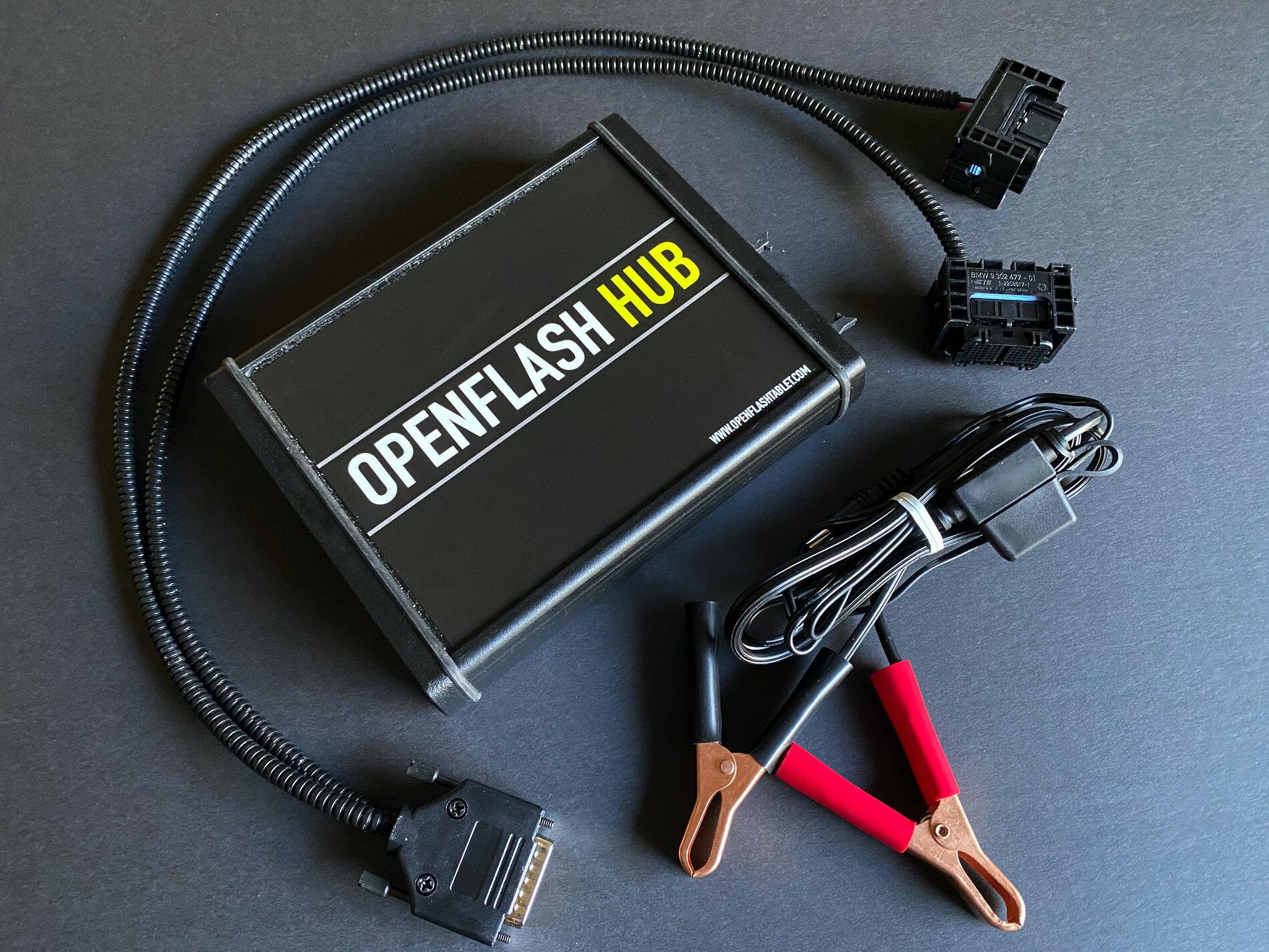

OpenFlash Hub for Toyota Supra (2020-2021*)
Finally, a truly revolutionary multiple-vehicle ECU tuning tool for your Toyota Supra! Unlike other tuning options that require ECU unlocks after every software update by the dealer, the OpenFlash Hub never requires ECU unlocking of any type. Also, whereas other products flash the ECU through the OBD2 diagnostic port (leaving an impossible-to-hide footprint), the OpenFlash Hub bypasses the diagnostic port altogether and connects to the ECU plugs using its very own plug-and-play harness. Not funneling all communications through the diagnostic port allows for not only a compete back-up of the ECU (both mapping and EEPROM data) but also a complete 100% back-to-stock ECU restoration. Due to the direct-to-ECU connection, write times are under 3 minutes.

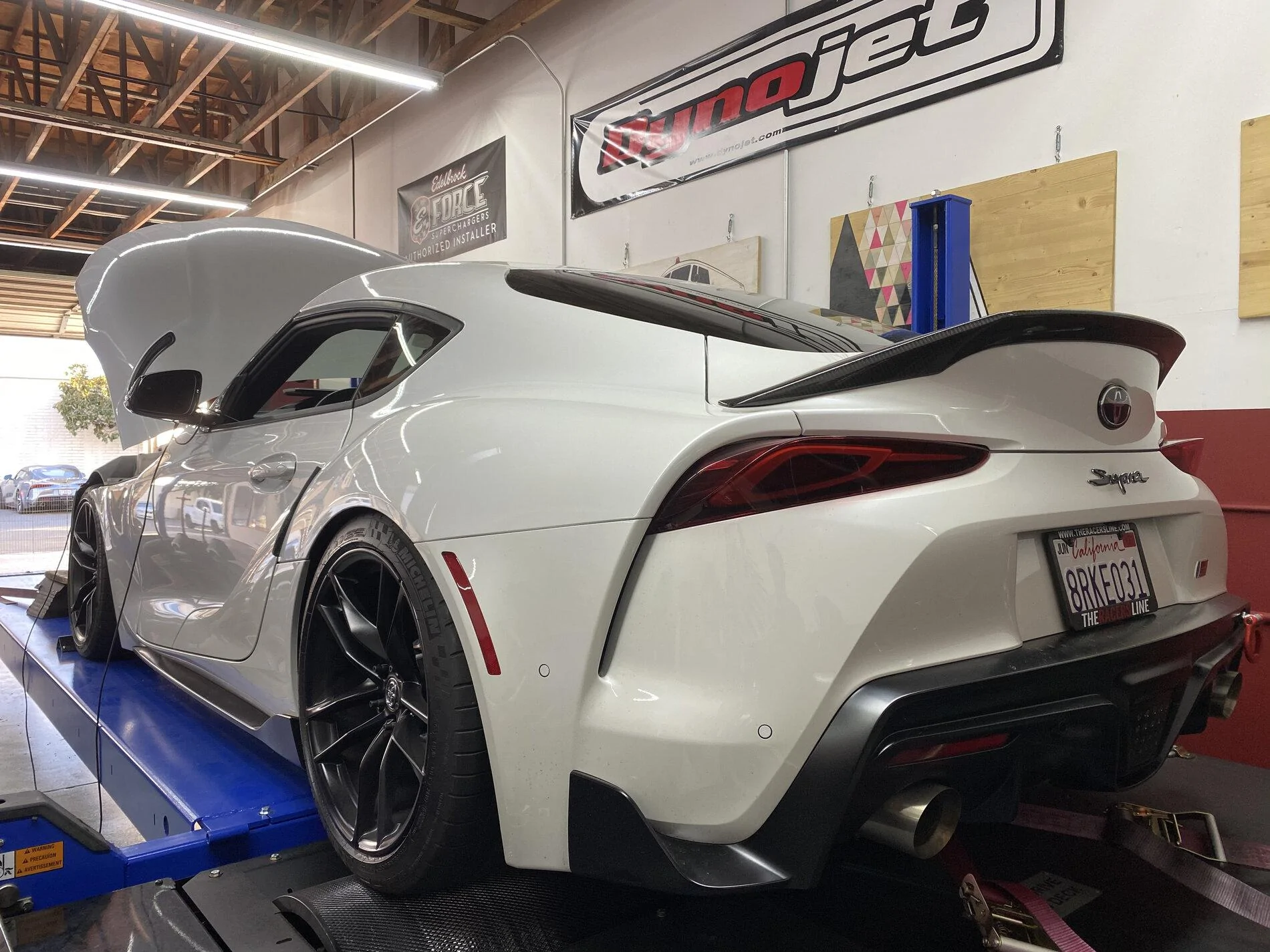

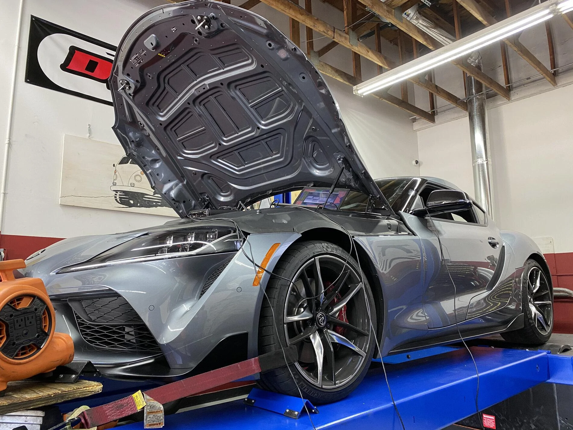

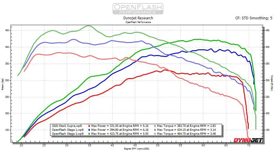

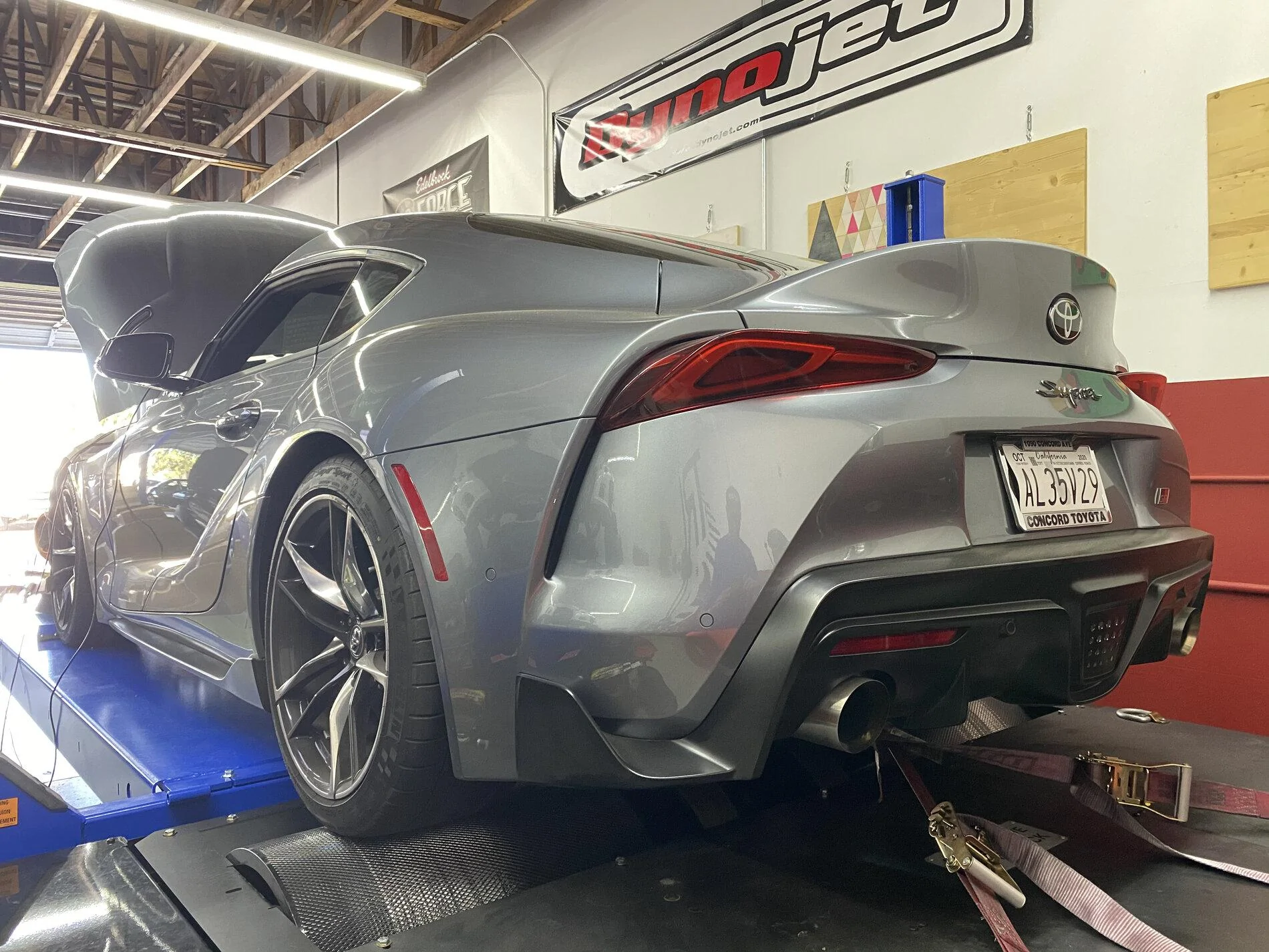

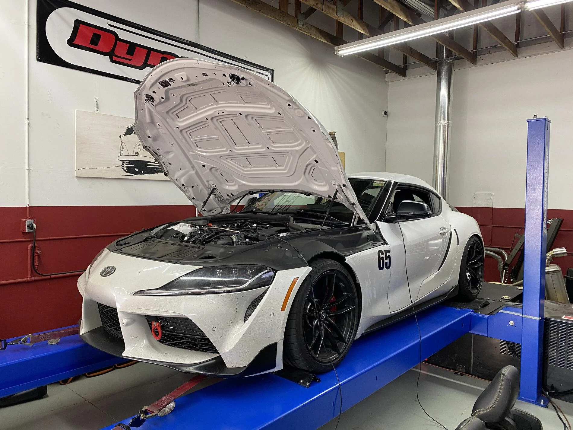

Dyno graphs below show:
Stock 2020 Supra
with Stage 1 flash
with Stage 2 flash and downpipes (Competition use only)
91oct fuel

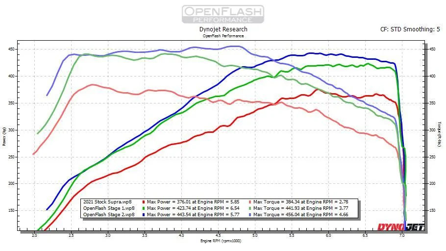

Stock 2021 Supra
with Stage 1 flash
91oct fuel

The tuning process is very simple:
- Locate the ECU just next to the driverās side shock tower. Remove plastic cover to expose the ECU connectors. With the ignition power OFF, disconnect all six ECU connectors.
- Connect the OpenFlash Hub plug-and-play harness to the ECU.
- Connect the supplied power cables to the 12v and ground terminals near the passenger side shock tower and plug the other side into the OpenFlash Hub.
- Connect the OpenFlash Hub to your PC laptop using the supplied USB cable. Launch the OpenFlash User software.
- Read the ECU and save a complete back-up file. Submit the back-up file through our websiteās OTS (Off-The-Shelf) Tune File Request link along with details of your car. Within 24hrs, a compatible tune file will be emailed back to you. During this time, if needed, your car can still be driven once the original ECU connectors plugged back in.
- Write the supplied ECU tune to the ECU using the OpenFlash Tuning Hub. Disconnect OpenFlash Hub cables from the vehicle and reconnect original ECU plugs.
- Thatās it! Go for a drive and enjoy our new found power gains.
