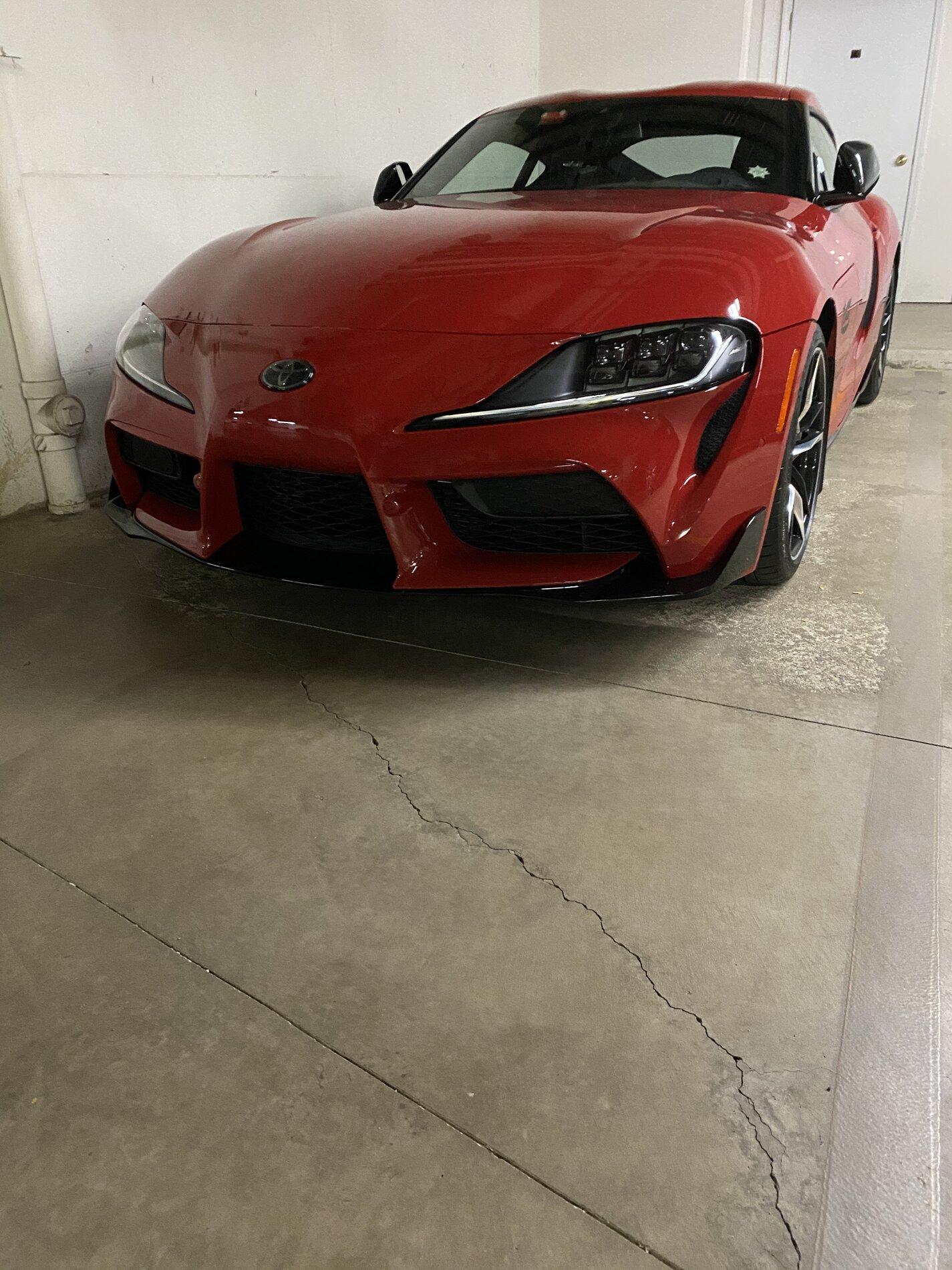

Have been turned down by the only two reputable PFP shops here in the area due to the complicated lines of the 2020 Supra. Finally found an independent installer who came highly recommended by a friend who has had this independent installer do several of his high line vehicles that would do the install.
Ordered film from a highly rated online company to cut and send me XPEL film. The company just called and strongly recommended I cancel the order (give them credit for doing so) as even they are not doing installs on Supras.
Has anyone else had this issues?

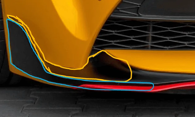

I've done the front bumper myself with the pre-cut XPEL. Had to stretch some areas, which is common. Wasn't the easiest, but wasn't too difficult either.
If I had a roll, would have made some things easier as I probably wouldn't have to stretch as much.
Also, I, for sure wouldn't have cut the ppf like that for the lips. Made it way too difficult to meet and align the edges.
Honestly, I'm not 100% satisfied with my install, thus will order a roll and do it myself when weather improves a bit.
Don't mind my horrible sketch (not my car). The way it's cut you have to align the blue and orange lines right where it's most visible to anyone.

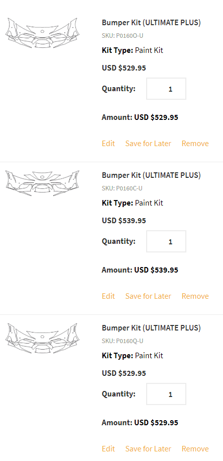

FYI, since my purchase, they came up with 2 more front bumper cuts, don't know all the differences.One thing is the whole front portion and the logo area came in 2 pieces, now they made it 1 piece, making the install slightly more difficult, but now you won't have lines if you sucked at aligning them..

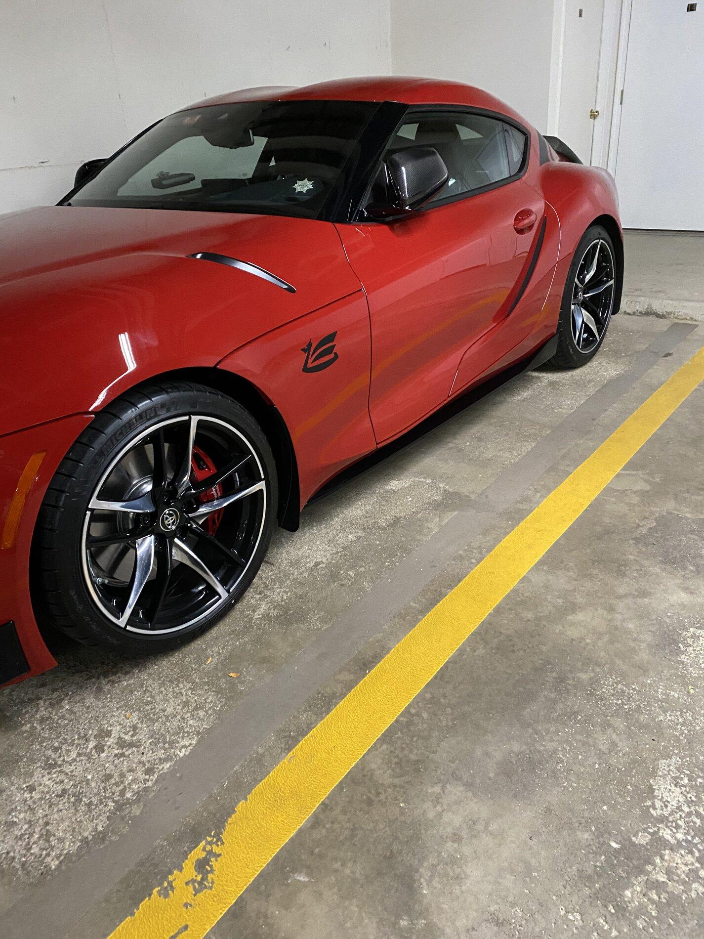

Just got mine back today from Xpel PPF install on front bumper and rockers. Looks great. Flawless. Took him 2 days, one of the most difficult car fronts to work on. Another Xpel vendor wouldnā€™t even touch it. Gotta give 5 star props to Chris at Unlimited Auto Style! https://unlimitedautostyle.com/
