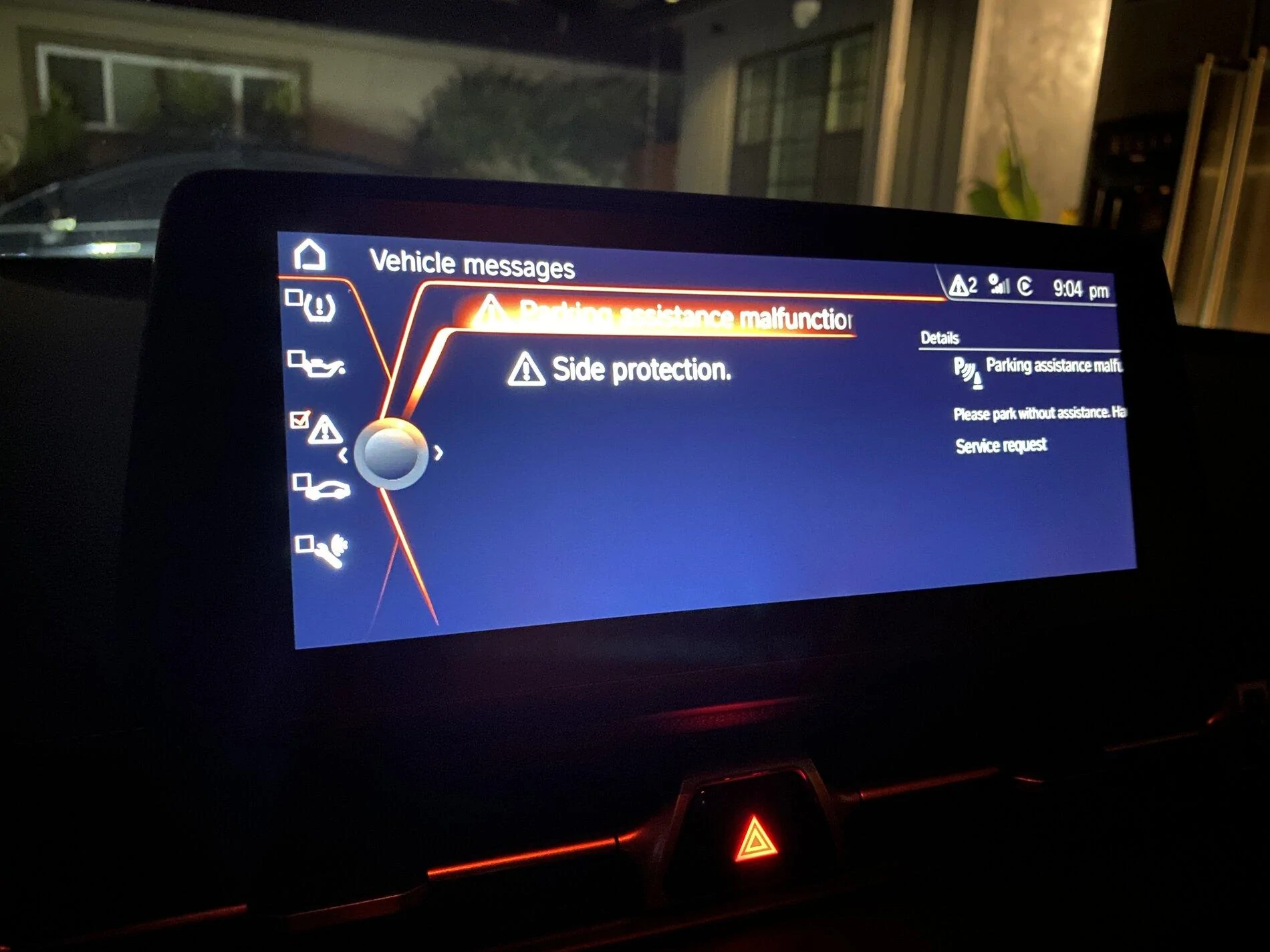

Anyone else get this before and know how to fix it? I have never detached any sensors or body parts and the error popped up after installing my CF steering wheel.
I had disconnected the battery before the steering wheel removal and only reconnected after everything was re-installed.
The error kicks when I go from park to reverse or drive.
EDIT - Unplugged the negative terminal for 30 min and it seems that it cured the issue. Hoping it is just a mild case of the BMW bugs...

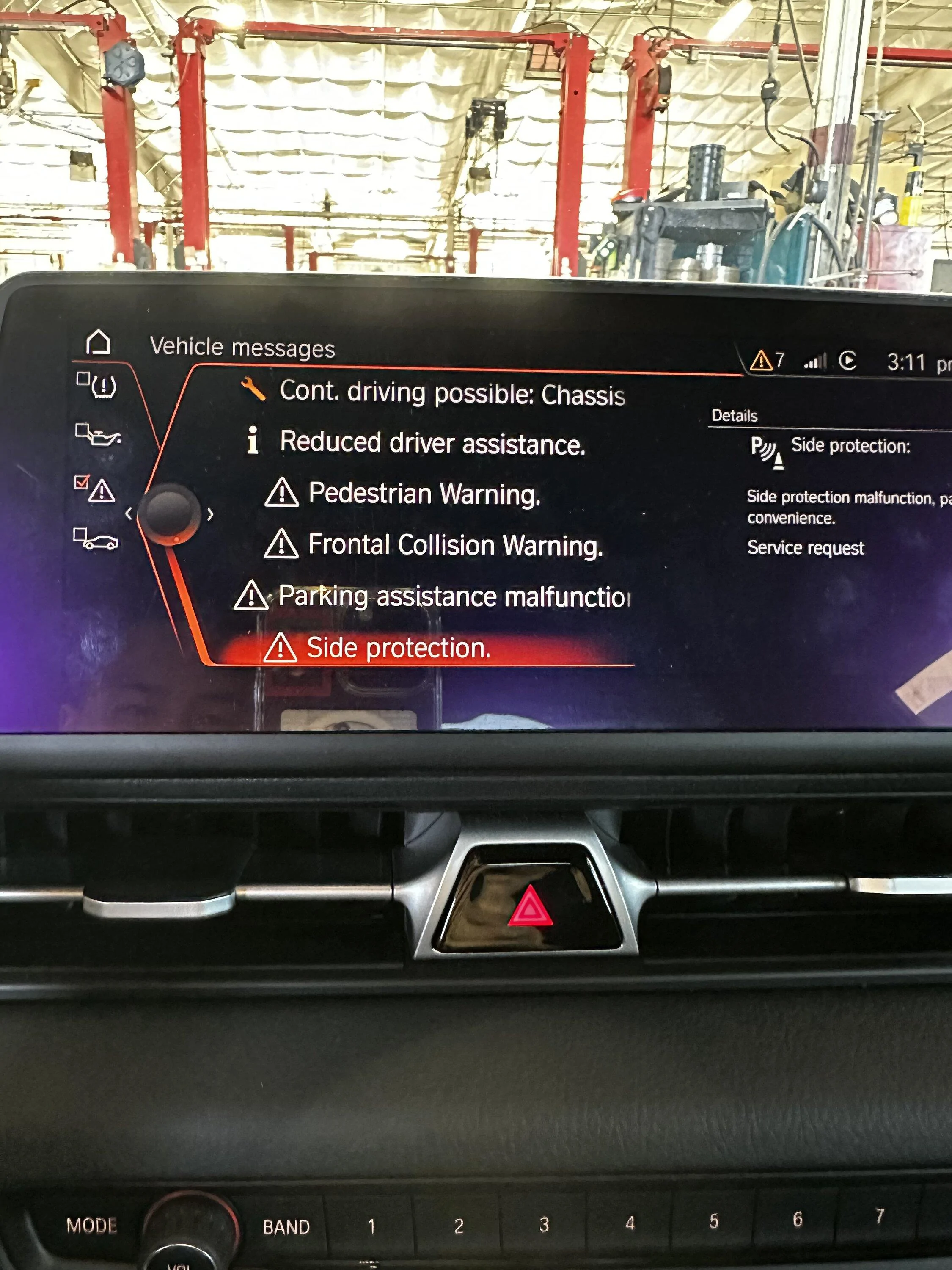

I have the exact same issue, however mine started when I got an alignment. Has been to Toyota dealership x 4 weeks and they blame it on my tune although my tune had been on for nearly 5000 miles before this happened. Still no fix. Please let me know if you find a fix.

Yes I have. In fact I even had a full update done, that locked my ECU (lost my tune, had to have ECU bench unlocked) and the errors remain. Dealership had it for over 60 days without a solution. So took it home.

Had this issue too and Toyota tried to blame it on my CF steering wheel. Took it to a different dealership that knew wtf theyā€™re doing and had the steering angle recalibrated and fixed.
