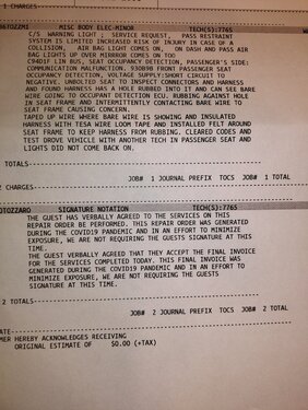

Since purchasing my Supra I have intermittently received the error message "passenger restraint system malfunction" on my infotainment display.
I have not been able to find anything online regarding the error message and so far Toyota can't figure out what the issue is.
It only happens when I have a passenger in the vehicle, but not every time. The error will remain on the screen until you turn the vehicle off. Once the vehicle is off any trace of the error is completely gone. It is not being recorded by the car's ECU and the service technicians can't seem to reproduce it.
The message is the same as the one linked here.
Has anyone else run into this or know what is causing it?
