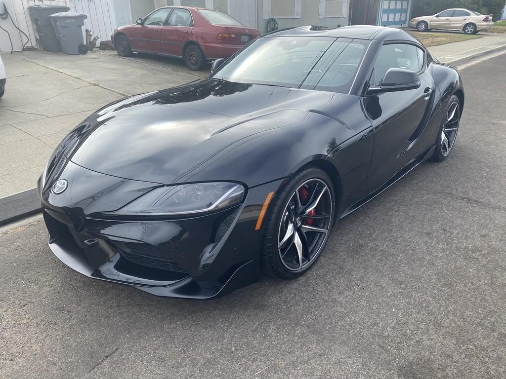

Hi guys. Just picked up a 2021 Supra on Wednesday.
Haven't had too much time to drive her around yet but in the short time I've driven it, it's been really nice.
Anyways... A little bit about me.... I haven't been messing with cars that long (probably since about ~ 2016 ish?). Since then, I've been fortunate to be involved in several platforms that include the GTR, S2k, M2, Nsx (both NA1 and NC1), CTR and now the Supra.
What has been even more awesome than building these cars is the opportunity to meet the people involved with them. Sharing knowledge, builds, and ideas in the community has always been a huge part to the ownership process for me.
So with that said, I look forward to meeting more owners.
In the mean time, please continue to check in as I will be logging my build here. The car will be built mainly for HPDE days on the track.
oops... Almost forgot... Pictures!

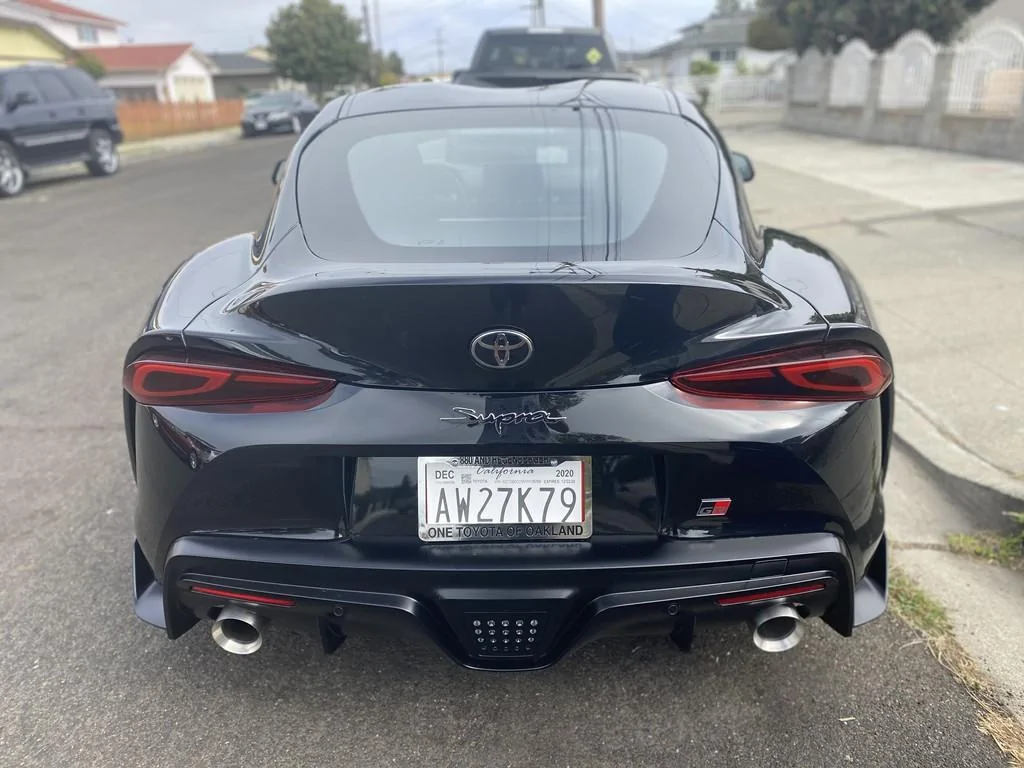

Build Update 7/30/2021:
Caught a bad case of the flu so I'm stuck at home. Figured I'd update my build thread a long with a complete mod list thus far.

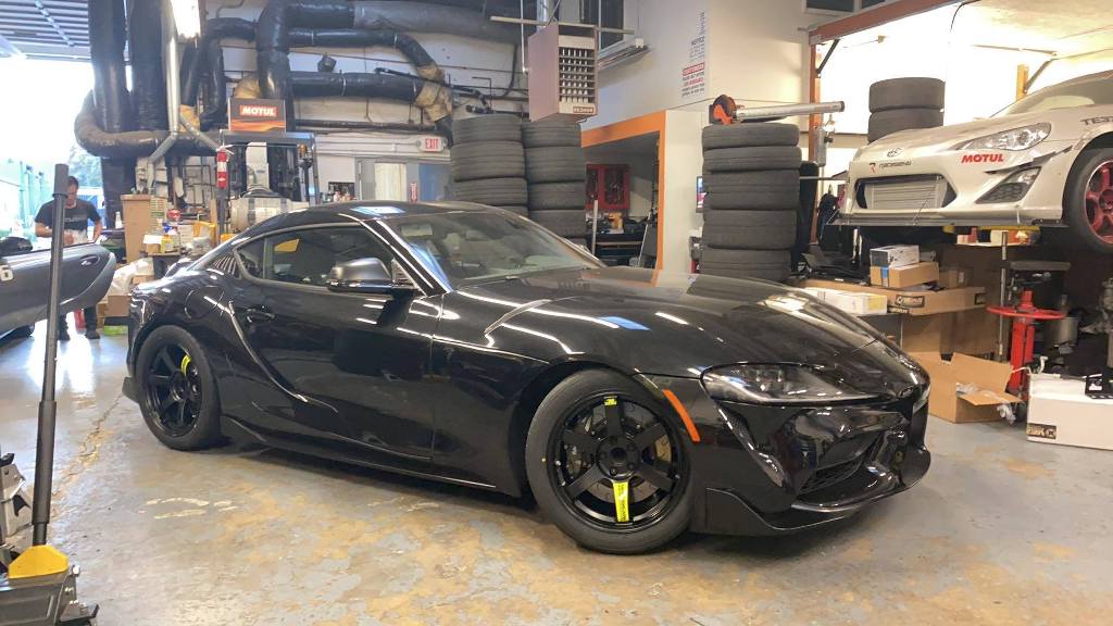

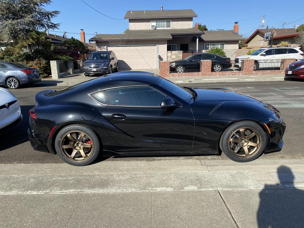

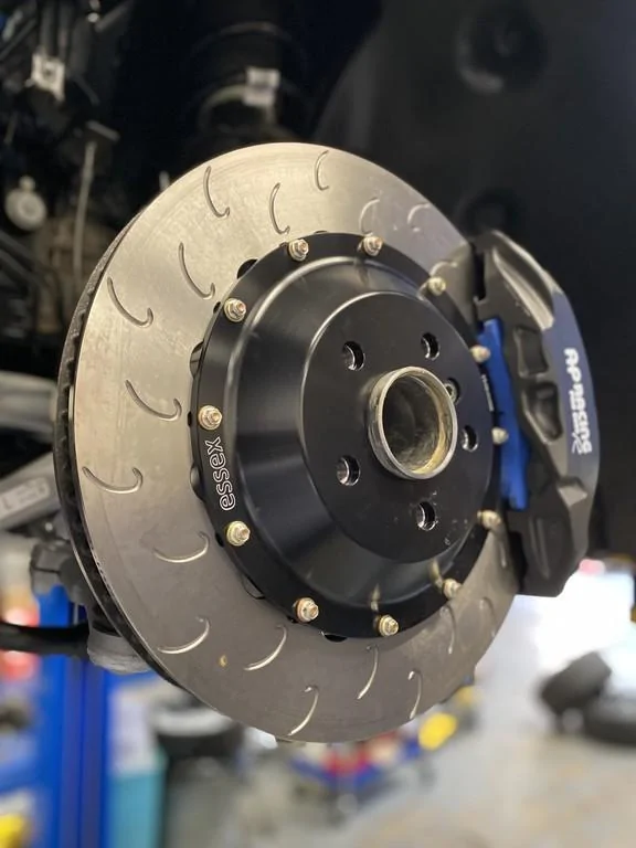

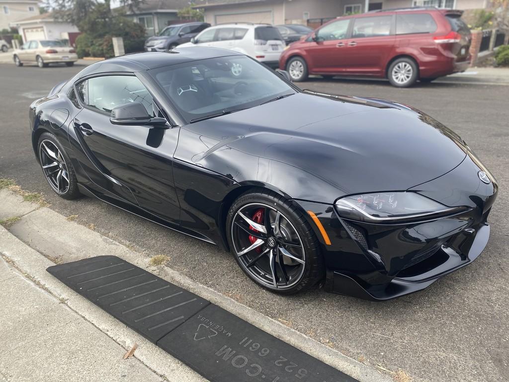

Sonoma Track day Prep:
We had a track day scheduled for 9/28/2020 so before we went, I wanted to address some of the shortcomings of the car. Not saying that this isn't a perfectly trackable platform in stock form but I've had some things fail on me on track and... it wasn't a great experience. So yeah... we weren't taking any chances.

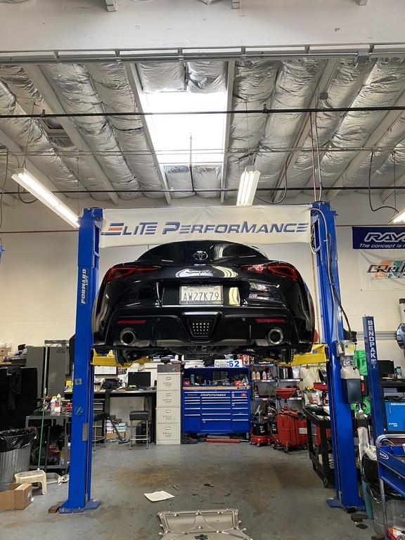

First off, AP BBK. We went with the AP Racing 9660 kit as this was the same kit that I used on my CTRs. Seeing that I had two extra sets of brake pads for this car and I enjoyed the system from my previous ride. Why not.

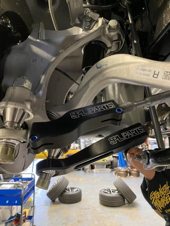

Next up we wanted to install some SPL components. This was done so that it would allow for a bit more adjustability. While installing these components, we realized that it was a especially good call seeing as to how some of the OEM components weren't that 'beefy'.

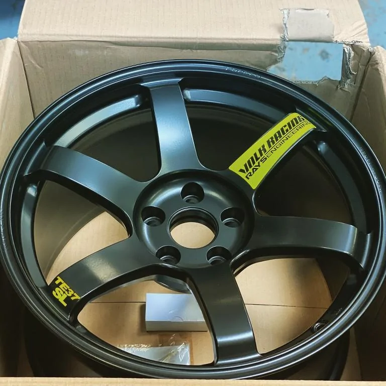

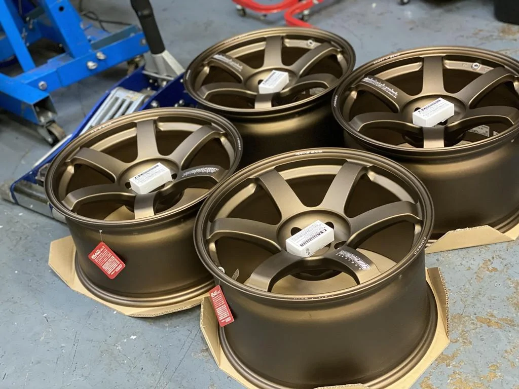

Last but not least, I installed some TE37's and wrapped them in Yokohama A052's.
The wheels are 18x9.5 +20 and 18x10.5 +30. A staggered set up. I think the car could use a squared set up but I went staggered because I wanted to increase the amount of understeer it had. I was coming from a Civic Fk8 Type R and honestly, I was scared of the habits I had picked up while driving that car. Plus Sonoma has a ton of walls so... staggered set up it was!

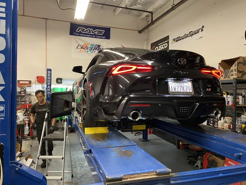

Can't leave without getting a proper alignment done!
Final product.
It's a bit high but it'll have to do until we get the coilovers in.

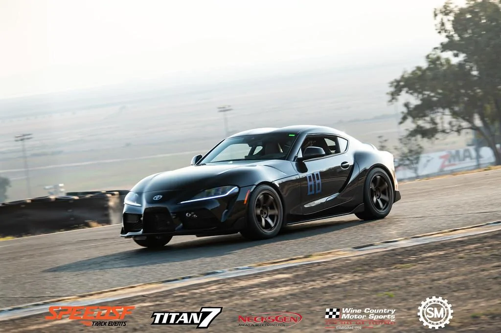

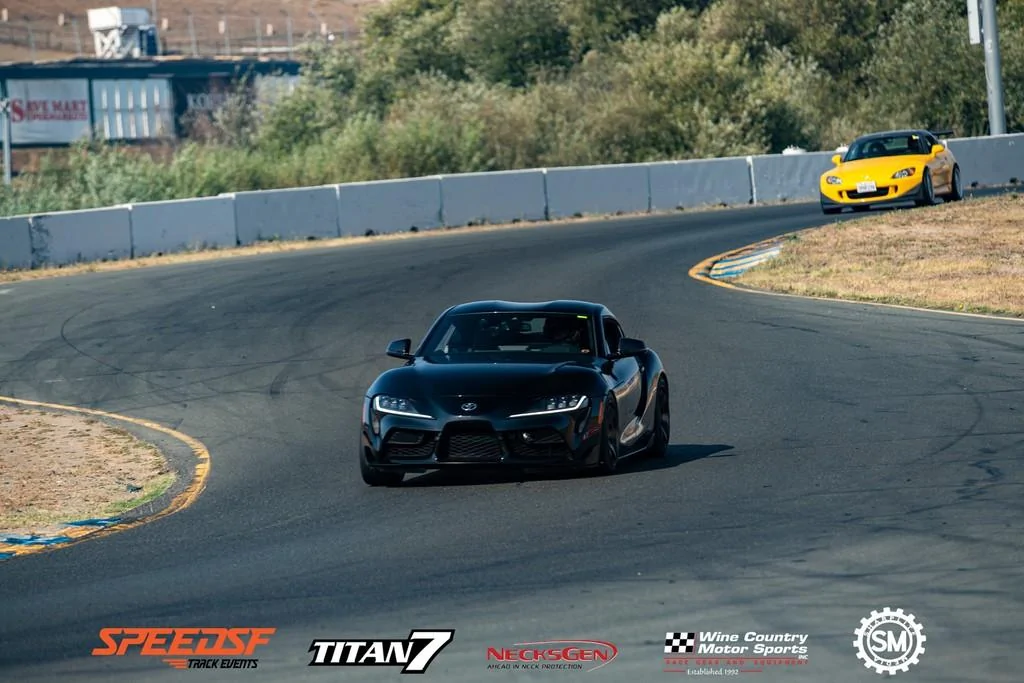

Sonoma Track day - 9/28/2020
Been tracking a Civic Type R for the past two years so coming back onto track with a RWD felt super sketchy to me. The Supra felt so much harder to drive than the Civic. So in other words, the heat was irrelevant here as I had a ton of habits to work out of my system. haha.
Thoughts on the car so far... let's see...
The car in it's current form with brakes and wheels understeers. I think this problem could be remedied via a set of squared wheels but I'd like to run a staggered set up until I feel comfortable driving RWD again.
Another issue / complaint that I have about the car is the fact that the suspension is way too soft. During quick transitions, the car just ... bounces around. We're hoping that a set of coilovers could fix this issue.
These two things aside, the car is a lot of fun and has a ton of potential. Even in stock form, the car is extremely capable as I was able to duke it out with far more modified cars. My hope is that over time, as we get more and more used to the platform, we can transform this thing into a very capable track weapon.

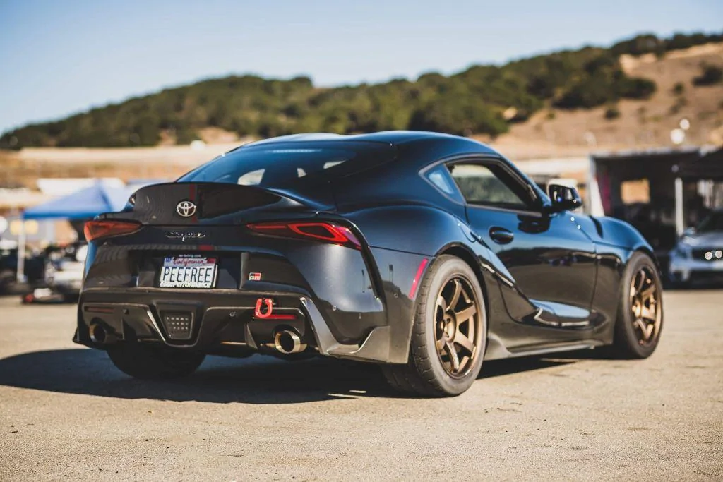

Raceseng tow hooks. This stuff was expensive but I guess they look nice. lol.
At this stage, we're just waiting on parts to come in....
Car will be going to Laguna this weekend on 10/11 with my buddy piloting her (I've got some prior obligations). So if you're around the area and see the car....come and say hi to my buddy. haha.

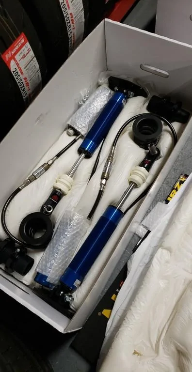

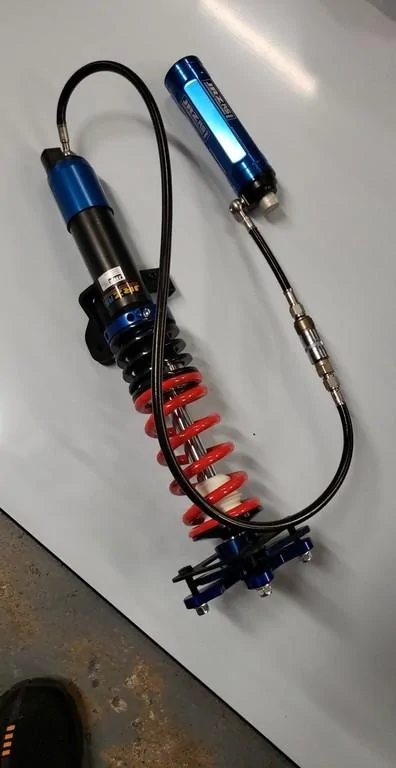

JRZ RS-PRO's. I used to use ohlins all the time and i think they're solid but the JRZ's is what I've been rocking lately.

Just giving a little update but we've been trying to prepare the car for Sonoma on 11/7.
Since our last post we've installed the following:
- JRZ RS-Pro
- TE37 Squared set up - 10x10.5 +35
- A052s 295/35/18s
- AFE Power Front Sway Bar
- Verus Master Brake Cylinder Brace
- Cusco Rear Power Brace
- Cusco Front Brace

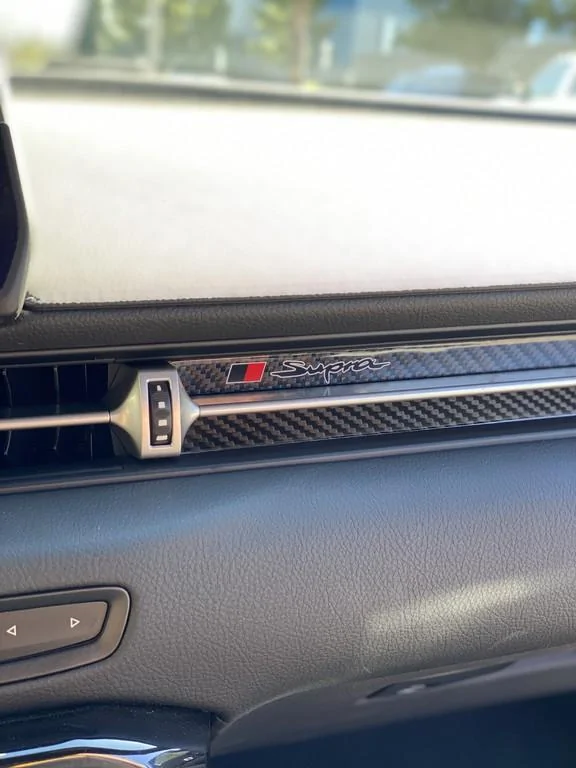

We also started sprucing up the interior via some aftermarket bits:
- Rexspeed Passenger side carbon interior badge
- IND A90 Red start / stop button
- Magic Mount Pro
- Weathertech Floor mats / Trunk liner

Any pictures of the jrz setup? Also did you do any of the spl bits in the rear?
ipeefreely
ipeefreely
Will
Mar 5, 2019
216
301
Alameda, CA
2021 Toyota Supra, 2021 Toyota Sienna
Not too many pictures of the JRZ set up.
We have the entire SPL catalogue ordered but I think we're waiting for SPL to revise some parts before we throw everything in.
