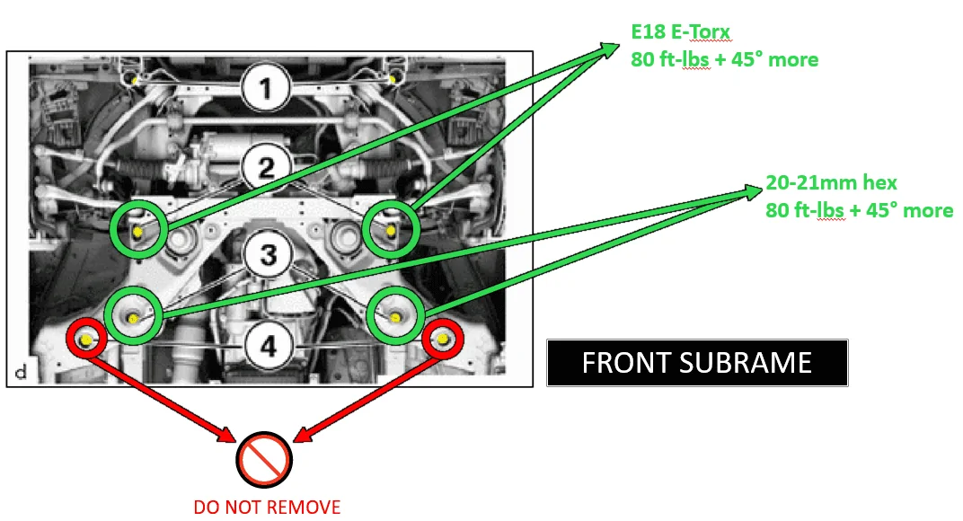

1) As a starter, you will need (or should have, to make life easier) the following tools:
  • A torque wrench capable of 90 ft-lbs, preferably 1/2" drive for ease of tightening
  • Long-handle 3/8" drive ratchet to break the nut, and an electric ratchet to speed removal -- these bolts are very long
  • Extenders in 6" and 12"
  • The following sockets:
    • 8mm hex for screws securing the plastic splash guards

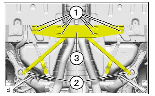

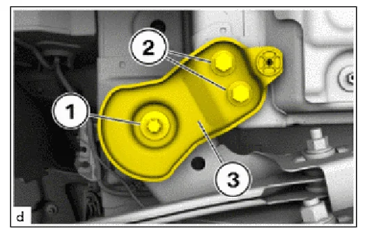

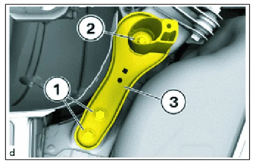

    • 16mm hex for metal skid plate under the oil pan, plus rear subframe chassis ties (forward tie bolts marked #1, rear tie bolts marked #2)
    • 20mm (maybe 21mm?) hex for two bolts on the front subframe
    • E14 E-Torx to remove two bolts from the rear floor panel brace (#2 marked bolts)
    • E18 E-Torx for 4 of 4 rear subframe bolts, and 2 of 4 front subframe bolts

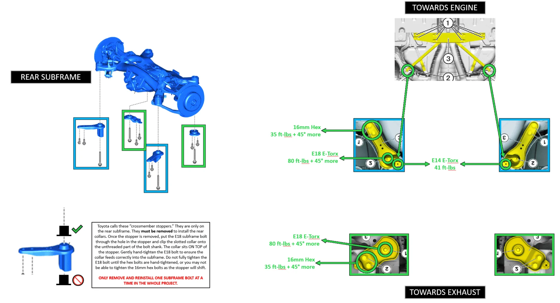

2) The provided instructions are very poor. Grainy black and white copier printout with no specs, and the bolts you're looking for are hidden by splash guards in their diagram. There's no step-by-step guidance for anyone unfamiliar with this kind of project. In fact, the provided instructions only say "return to factory torque spec" and explain roughly why the collars are numbered. So, disappointed, I dug into what those were and assembled these diagrams for the front and rear.
3) Each bolt has one appropriate collar. The collars are numbered. The provided instructions will show you which collar goes with each bolt. Cross-reference with the below diagrams.
4) The rear subframe bolts are hidden by plastic splash guards (8mm hex). The front subframe bolts are hidden by the metal skid plate under the oil pan (16mm hex) and plastic splash guard (8mm hex).
5) It's very important that you hand tighten all of these bolts to gently feed the collar into the subframe holes. Some of them will be snug, so be prepared to partially install and remove each bolt several times to inspect the collar, ensuring it's not being marred or distorted. Once you are confident the collar is not being damaged, proceed with full installation. My front driver side subframe collar (E18 bolt) was especially tight, and I legitimately checked this bolt 7-8 times with only a few revolutions of hand-tightening before bringing it up to torque. I also test-fit each collar in the bolt hole in the subframe by inserting the collar by hand, before even putting a bolt in the hole.
6) ONLY REMOVE ONE SUBFRAME BOLT AT A TIME. Do one corner at a time, and fully reassemble it to torque prior to moving to the next bolt.
