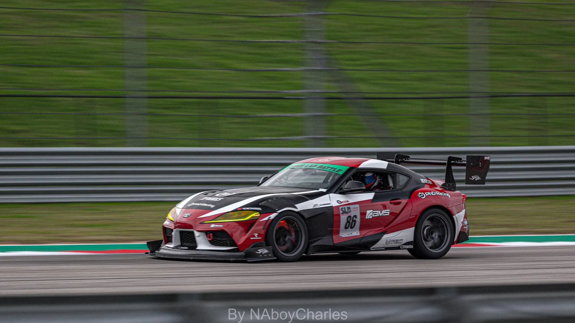

Second competition for our new Time Attack Supra A90, and up against some super fast locals and well-built Subaru's, we made up the traction deficit with high speed cornering and low end torque and acceleration. Took home first place in Street class by over 1 second, as well as setting a new Street RWD and Street Overall record. Lap time: 2:22.508 around Circuit of the Americas.

That shot with the glowing front rotors is cool. You still running stock rotors? How are they holding up?
Also, this was on our new Neo Motorsport BBK, so it was not stock rotors. That said, the stock rotors lasted very well for me at Buttonwillow with just pads and fluids upgrade.
Did you ever have the cracking issue with stock rotors on the S2K? When I was tracking my '08 CR, some guys were getting hairline heat cracking on their S2Ks...it would be welcomed to hear the Supra rotors were more stout, under the same driver...
Plenty of S2K stock rotor issues. I think I cracked a pair without too much effort. The Supra rotors are very beefy and I doubt you could get them to crack. I wasn't too impressed with the stock brake pad (even though they were okay for track use), but the rotors were pretty solid I think.
