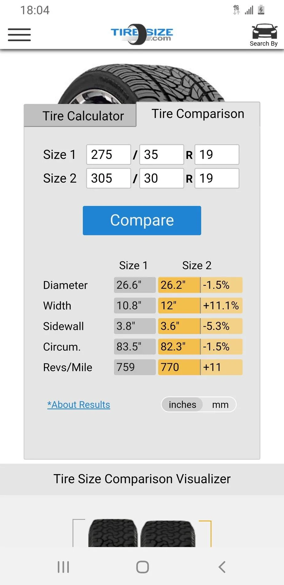

The sidewall on a 275/35 and a 305/30 are just about the same thickness.
Sidewall height is a percentage of the width, not a height in mm or inches.

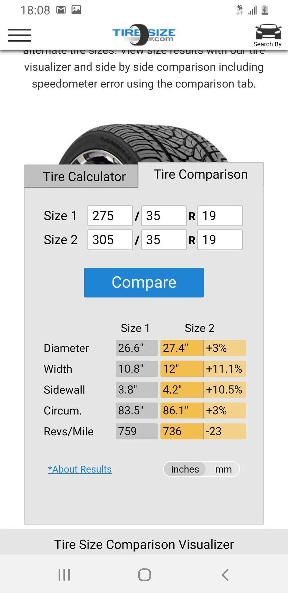

See the difference in diameter? A 305/35 is way taller than a 275/35. If you're lowered you have a bigger probability of rubbing and you're changing the gearing of the car slightly. Slowing acceleration and throwing off your speedo. The 305/30 is off too but by a much smaller margin.

I’ve worked with multiple 3 piece wheel companies and have sold a lot of wheels and seen a lot of tires mounted, well aware of the differences. However, I would never run a tire that is shorter on the rear than the front. It’s a pet peeve of mine and it’s the first thing I notice on a car with a 35 up front and 30 on the rear. Front looks bubbly and rear is square. With anything over 255/35 with most brands, the front is taller than 305/30. Now, I do agree that 305/35 is taller than what I would see ideal, but I still think it’s a better option than a 30 series, especially for a street car that may see rough roads.
@EastCoastSupra is running nitto nt05 305/35 on the rear and has confirmed no rubbing.
I personally see no reason for me to run a 305 on the rear of this car and opted for 265/35 and 295/35 and think this is the ideal fit. (On Te37)
P.S. the speedo in this car is already thrown off mine is off by a few mph on stock sizing.
