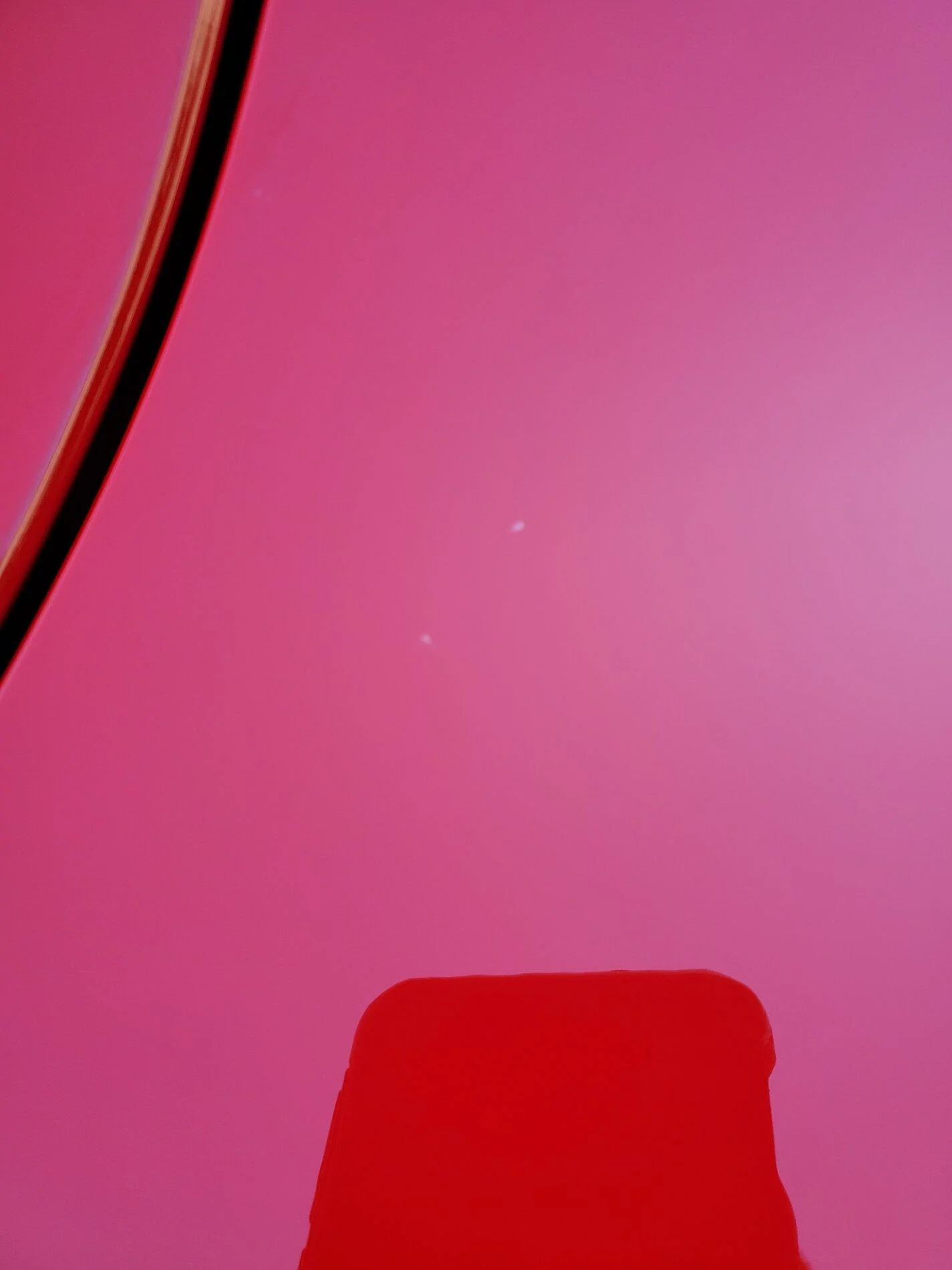

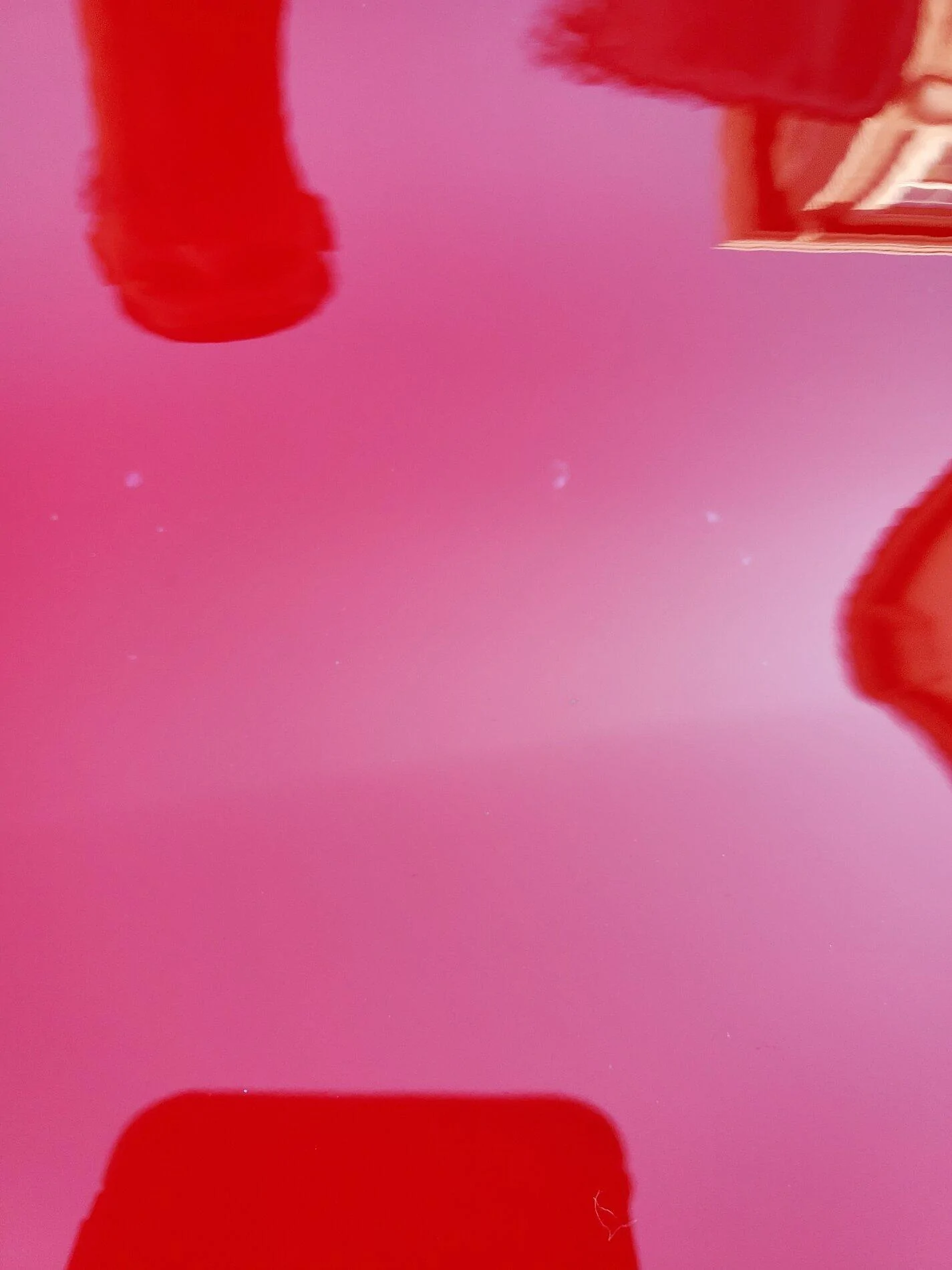

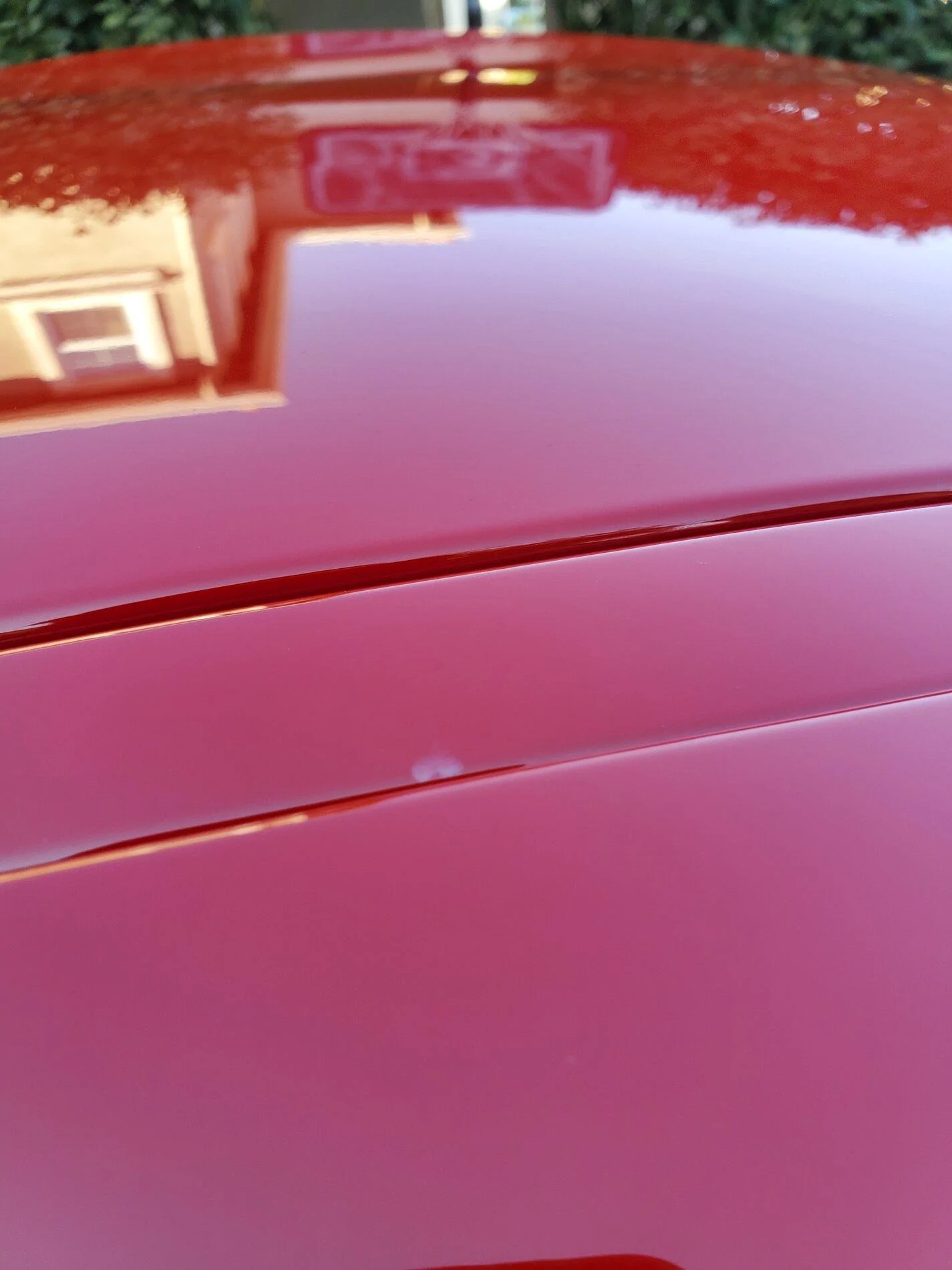

Just washed my car and noticed these blemishes on different parts of the car. Any input on this?

Wax is for protection and wont do anything for that.
You can try a cleaner wax. It has a slight abrasive and may be enough to work.
Otherwise, use polish or compound but keep in mind, compound is more abrassive.
If compound is necessary, follow up with polish to get rid of compound haze. Wax when done.
Think of these products as liquid sandpaper with varying degree of abrasiveness.

I know the dealer said they put Cilajet jet on the car not sure what kind of protection that is and if thats what im seeing.

I saw something about this, probably elsewhere on the forum, but maybe youtube.
You're supposed to use heat, like a hair dryer, to correct them.
Edit: Found the video, you have the same problem. He's on this forum, but I forget the user name, sorry!

Looks like bird crap etching. I would try some clay, but probably go straight to fine polish like ScratchX on a foam pad to see if that comes out. GL

I'm not sure it's a paint issue but maybe hard water stains or anything that could have sat on the paint.
