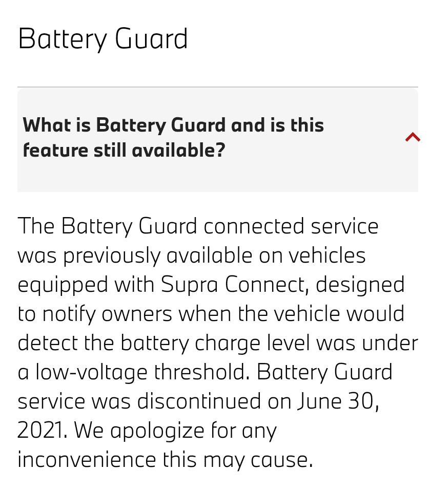

Ah. Only had the car a few days so haven't got it yet. What's Battery Guard?
