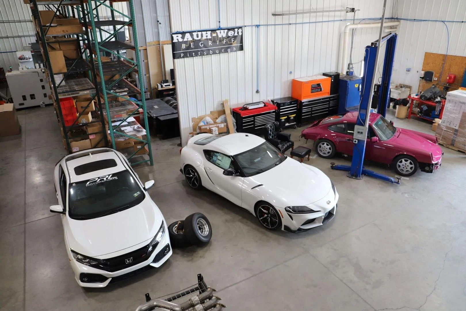

Say hello to the newest addition to our PRL Motorsports family! Our A90 MKV Toyota Supra is finally here after being jerked around by two different local dealerships over the past few weeks. We want to give thanks to Spitzer Toyota of Monroeville for the great price on this Absolute Zero White 2020 GR Supra 3.0 Premium and for always being a pleasure to deal with.
First Impressions:
This car is extremely quick and feels solid right out of the box. The A90 Supra seems to be built/engineered rather well with quality components. We feel that the exhaust tone sounds extremely nice from the factory, offering an aggressive grumble and crackle, especially in sport mode, without being too unbearable. We had no problems breaking the tires loose upon aggressive takeoff, which left us with a smile on our faces.
At a Glance:
The tight engine bay and arguably overly-engineered Supra looks to leave performance part manufacturers like ourselves with a bit of a struggle to design and fit upgrades. But hey, we like a challenge. ;)

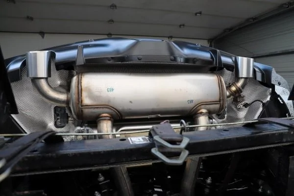

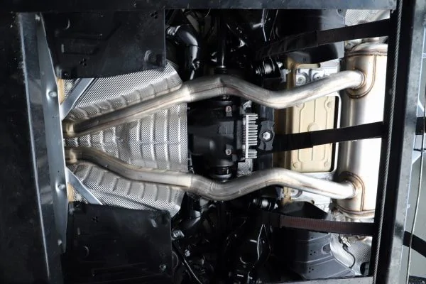

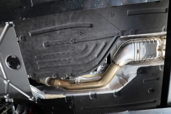

The factory exhaust tubing measures 80mm to dual 70mm, which allows for quite a bit of exhaust flow. We don't expect to see much, if any, gains to be had from an aftermarket catback exhaust system. However, we do anticipate gains from a downpipe upgrade by the removal of the factory catalytic converter and replacing it with a high flow unit and/or Race version without.

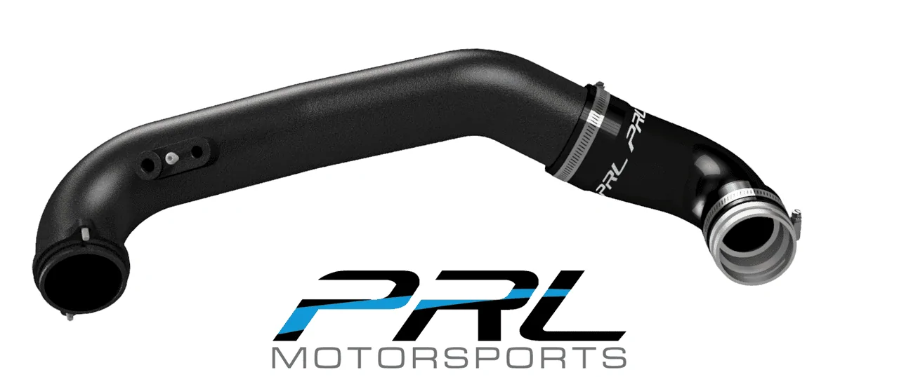

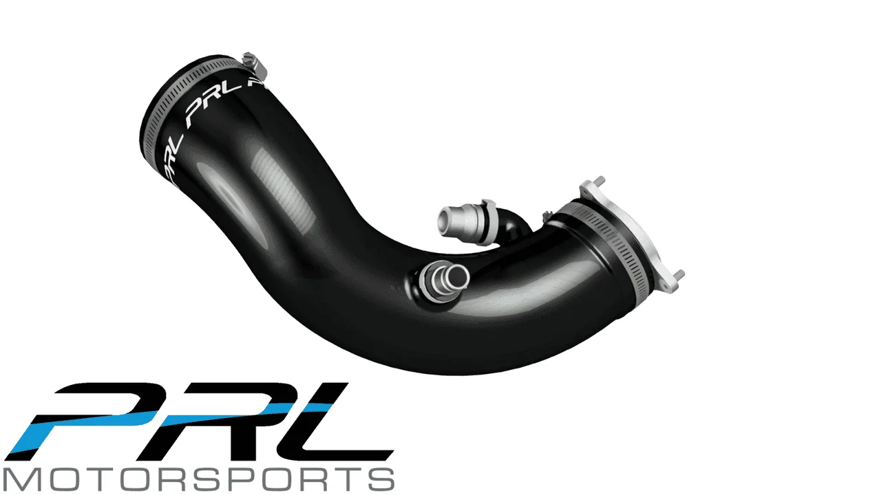

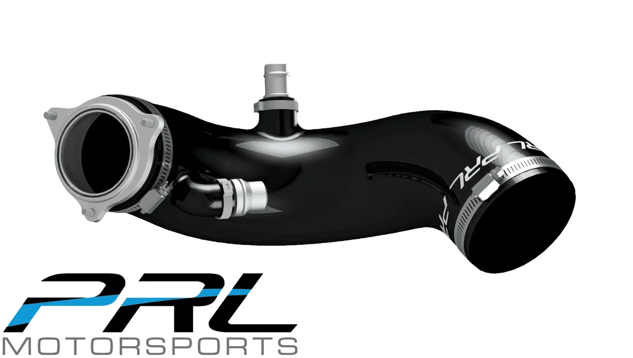

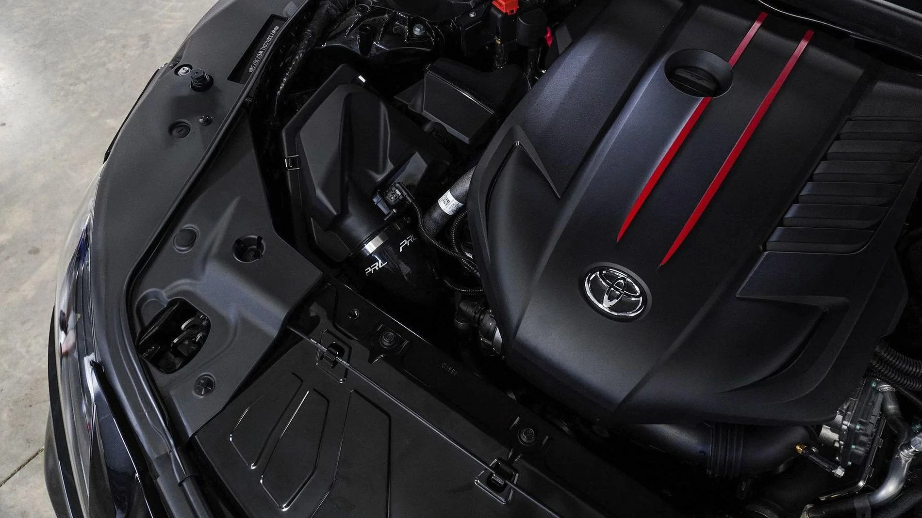

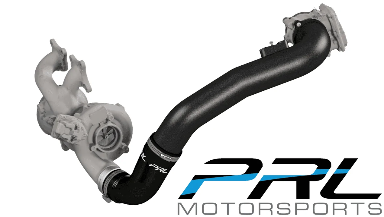

A90 MKV Toyota Supra Product Development – Intake & Charge Pipe Upgrade
We have been working on a few goodies for the MKV A90 Supra over the past few months. Here’s a sneak peak of the intake system and charge pipe kit we’ve designed!
Passenger%20Head%20Light%20Angle%20Intake%20and%20Charge%20Pipe%20Assembly%20LOGO_zpsvvtdkotv.png

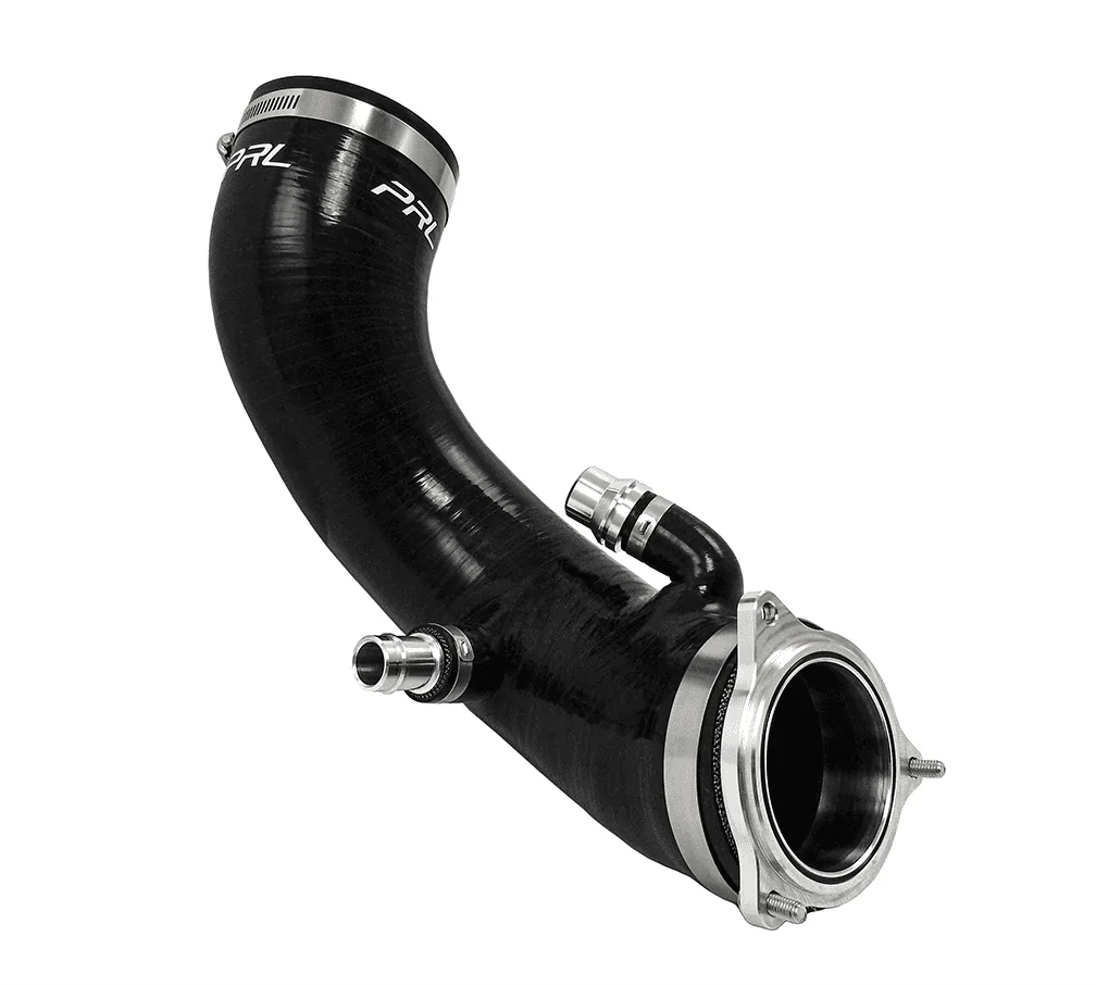

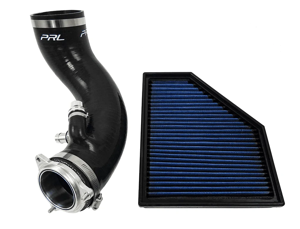

Our Silicone Inlet Hose Upgrade Kit is designed to replace the restrictive corrugated factory hose with a stronger, larger diameter, smoother flower 4-ply silicone hose. We increased the compressor inlet diameter by 30% and maintained a long, smooth transition to 87mm at the outlet of the air box. This kit utilizes a 62mm compressor inlet flange to allow maximum airflow to the stock turbocharger and any drop-in turbocharger upgrade. (For reference, a 35R-sized turbocharger utilizes a 62mm inlet.) The inlet flange smoothly transitions from 74mm to 62mm over a 32mm length to reduce turbulence. Also, our kit removes factory air dampeners/silencers, so customers can expect to hear more audible intake noise.
Please note that this kit does eliminate the integrated CCV valve, so a tune is required.
Silicone Inlet Hose Upgrade Kit can be purchased separately or paired with our Drop-In Panel Filter Upgrade for optimal performance, this combination with constitute our Stage 1 Intake System.
Intake Inlet ID
  • OEM 84mm
  • PRL 87mm
Intake Outlet ID
  • OEM 51mm
  • PRL 62mm
Over the years BMW’s plastic charge tubing have become known for failure due to age and excessive heat. Our Charge Pipe Upgrade Kit is designed to replace the problematic factory unit with our direct bolt-on, 1-piece upgrade. This kit utilizes 3.00” OD .065” wall aluminum tubing, a billet compressor outlet flange and a 4-ply silicone hose connector for optimal airflow and strength. The inlet flange transitions from the factory 48 mm compressor outlet to 56 mm over a 10 mm span, which reduces a step, then smoothly tapers the 73 mm ID of the 3.00” tubing. Kits will come standard with an integrated methanol injection bung and sleek sensor billet flange location.
No tune required!
Charge Pipe Inlet ID
  • OEM 52mm
  • PRL 56mm
Charge Pipe Outlet ID
  • OEM 65mm
  • PRL 73mm

PRL Motorsports Stage 1 Intake System for the 2020+ Toyota Supra B58 6 Cylinder is almost ready for pre-order!
This kit is designed with a few goals in mind:
  • Affordable Option
  • Providing power gains and increased airflow over the factory piece it replaces
  • Easy Installation with hand tools (No alteration to the vehicles integrity)
  • Ability to be returned to stock configuration easily
  • Retention of stock fuel trims
THIS KIT WILL REQUIRE A TUNE - CCV Valve Is Removed
Intake Inlet ID
  • OEM 84mm
  • PRL 87mm
Intake Outlet ID
  • OEM 51mm
  • PRL 62mm
We will be releasing more information in regards to power gains in the next few weeks with multiple third party testers.
The Silicone Inlet Hose Upgrade Kit will retail at $234.99 and includes the silicone hose, all adapters, and hardware.
https://prlmotorsports.com/2020ToyotaSupraInletHoseKit.aspx
The Stage 1 Intake System will retail at $274.99 and includes the silicone hose, all adapters, hardware, and drop-in filter.
https://prlmotorsports.com/2020ToyotaSupraStage1Intake.aspx

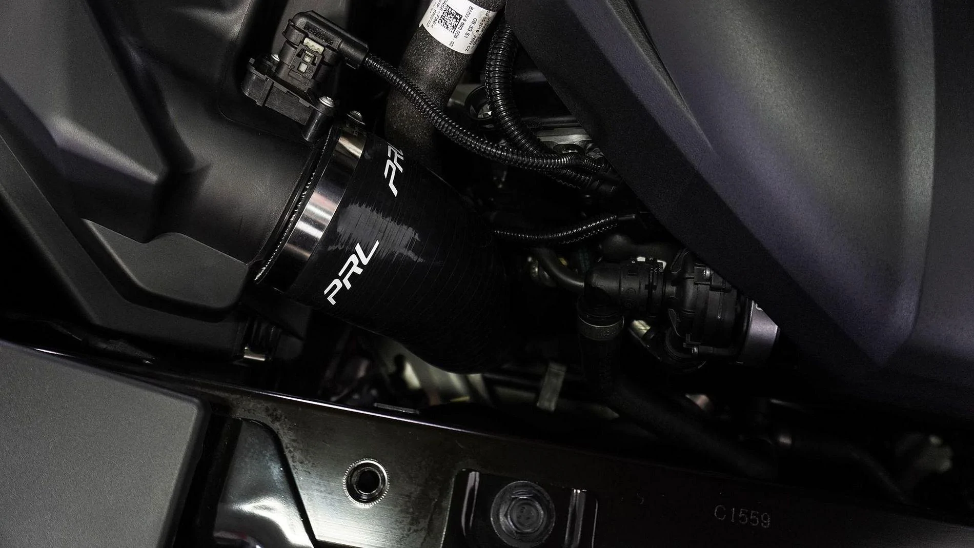

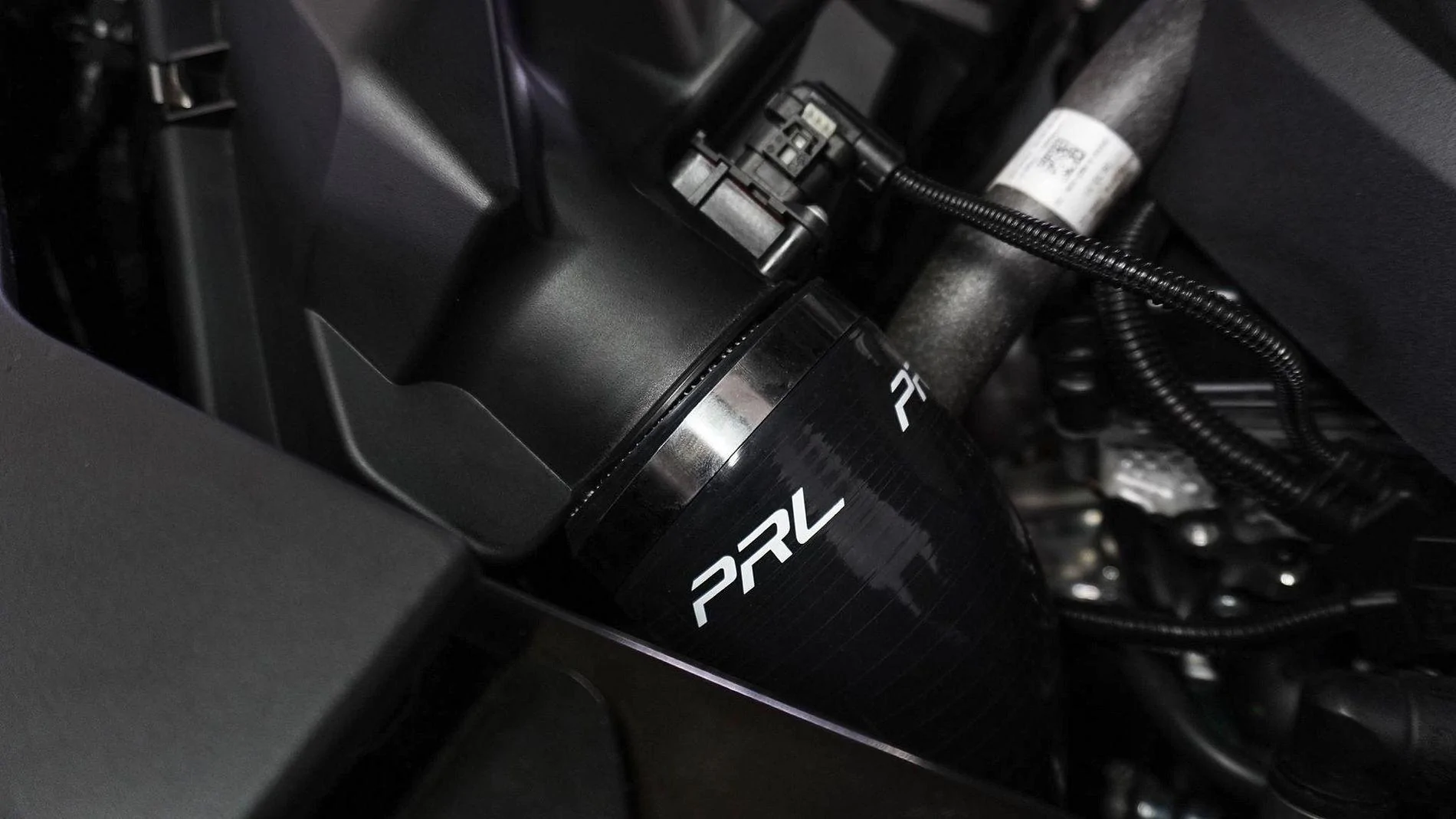

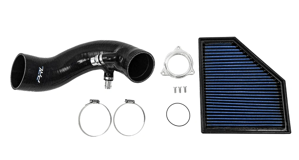

Stage 1 Intake System for the 2020+ Toyota Supra A90 is now available on our website and authorized vendors!
Retail Price: $274.99 + Shipping
Please note that a TUNE IS REQUIRED (CCV Valve is Removed)
Replace your factory corrugated hose with a 30% larger diameter, stronger, smooth flowing 4-ply silicone hose. All while maintaining stock fuel trims and the ability to return to stock easily if needed. This kit also removes factory air dampeners/silencers so users can expect to hear more audible intake noise, especially under wide open throttle conditions.
Intake Inlet ID
  • OEM 84mm
  • PRL 87mm
Intake Outlet ID
  • OEM 51mm
  • PRL 62mm
Kit Includes:
  • (1) Replacement Panel Air Filter Upgrade
  • (1) Silicone Inlet Hose Upgrade Kit

"CCV Valve is Removed"
Are you talking about the port on the stock intake pipe that has the two wire plug going to it? If so, its not a valve. Its a PCV heater. Thats if you're talking about what i think you're talking about.
