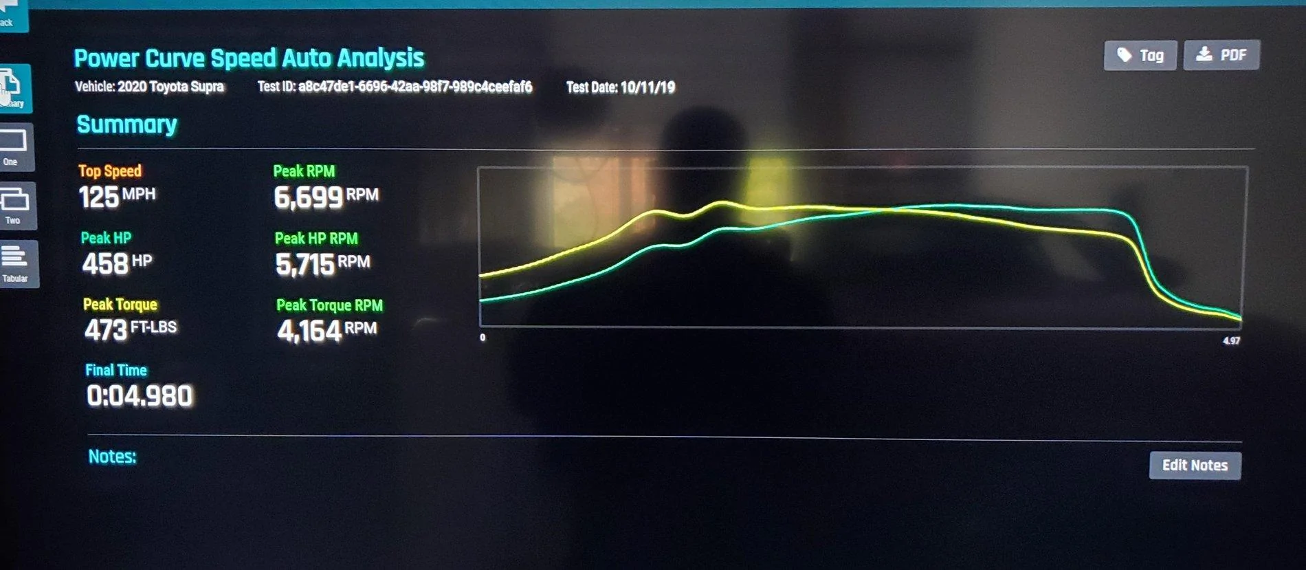

Saw some people asking about 93oct pump numbers on the Pure Turbo upgrade.
Ran ours dry tossed in a couple gallons of 93oct on our bone stock other than Pure Turbo.
458whp on our Mustang dyno. Should equate to 500+whp on the dynojet

This is on stock downpipe also?
Yes. Car is bone stock other than the pure turbo right now. We havent put our parts on the car yet
what's the bump around peak torque?
Boost spike. This was just a quick map swap as well from our MS109 map just to toss up a 93oct pull. Just lowered load target and timing to 93oct levels and ran it. Had a bit too much wgdc at spool from our higher boost map for ms109. One or two revs, that little boost anomaly would be gone that you see there.
