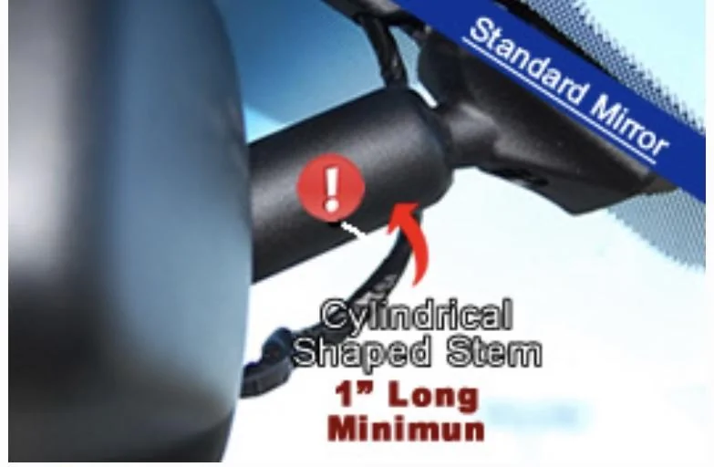

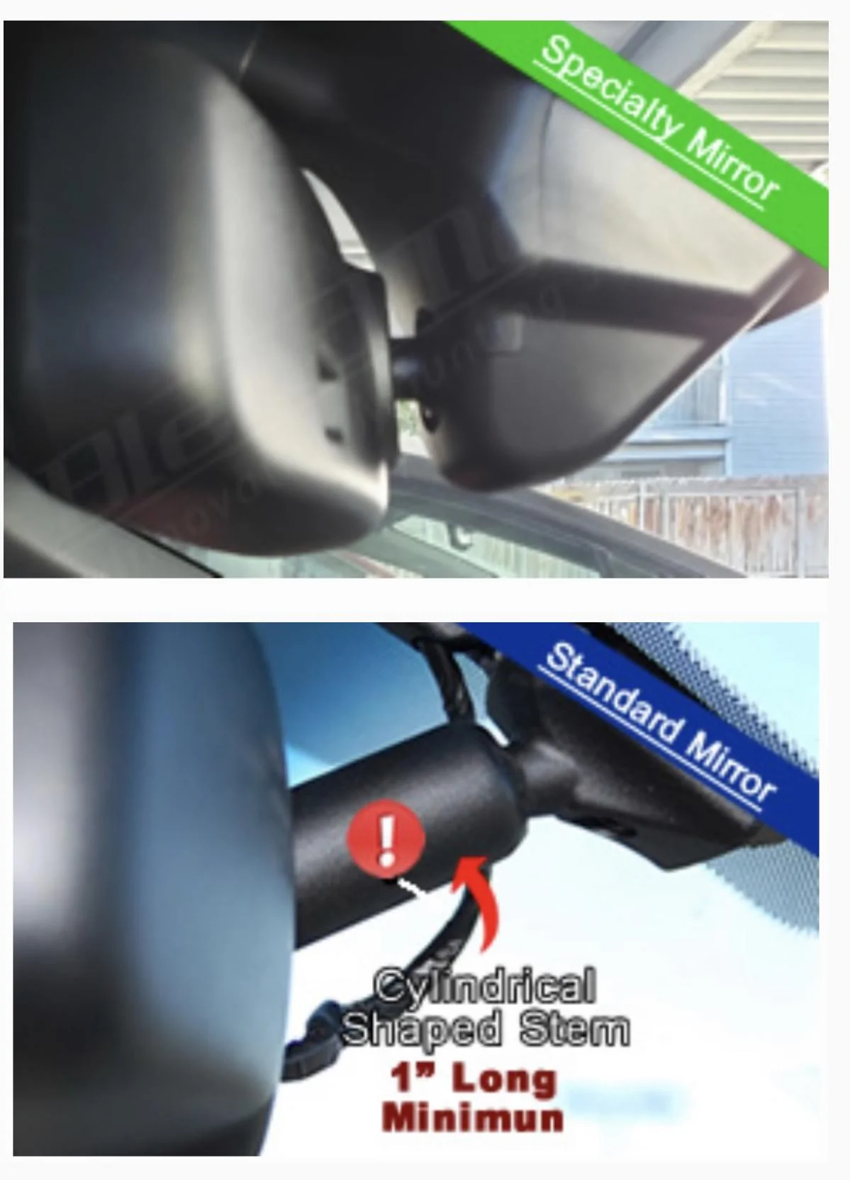

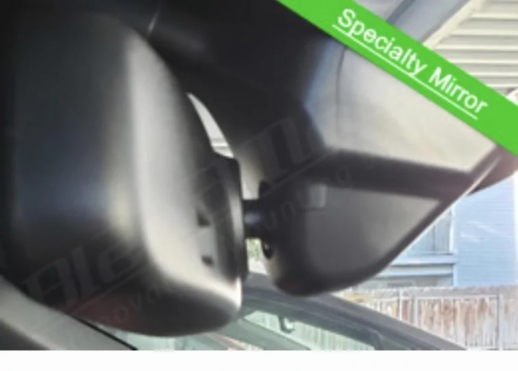

Messed around with the Blendmount setup, which I ordered for the “speciality mirror,” as that is what the mirror setup on the Supra looks like....
However, turns out the diameter on the mount is to small to fit around the diameter of the mirror stalk.
Returned to Blendmount, ordered the “non-speciality” version off of Amazon, hopefully that one works...
