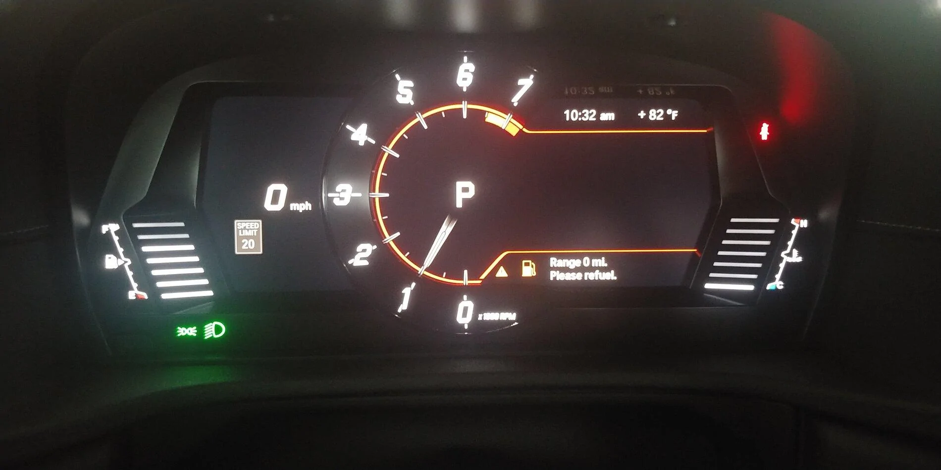

Just turned it on this morning and gave me this message. (It does have more than half a tank)
Anyone had this before?

Yes it starts up also got this notification. (I only have 1160 miles)

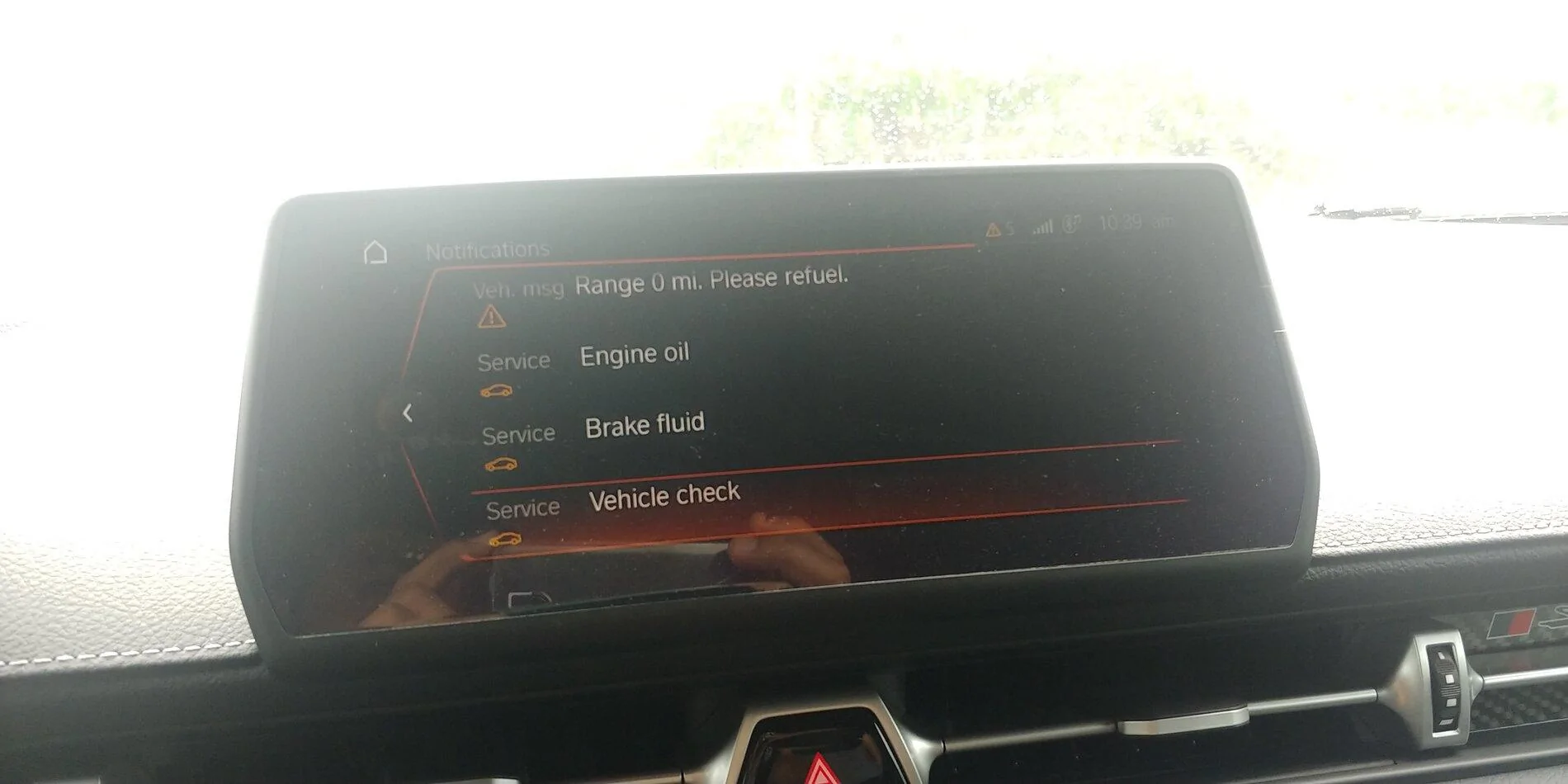

I had the service warnings go off also when this first happened to me. I realized the clock glitched and the time changed. Along with the year. I unchecked and rechecked the time sync and the service warnings went away. It was just saying I was overdue for service because the date and time had magically changed in its own. The fuel range never went away though.

Yeah for the range, I just disconnected the battery and reconnected a few mins later and it corrected itself. The range showed 0 again a few weeks later. I gave it a week to see if it would magically heal, and it didn't, so I just did the battery disconnect again and it went back to normal. Its been fine ever since. I caulked it up as a quirk of the car lol.

I had this happen shortly after I got my car. Just went to the dealer and they fixed it with Ista. Some “weird” value got stored in that parameter some how, they said. Been over 12000 miles never had the issue come back.
