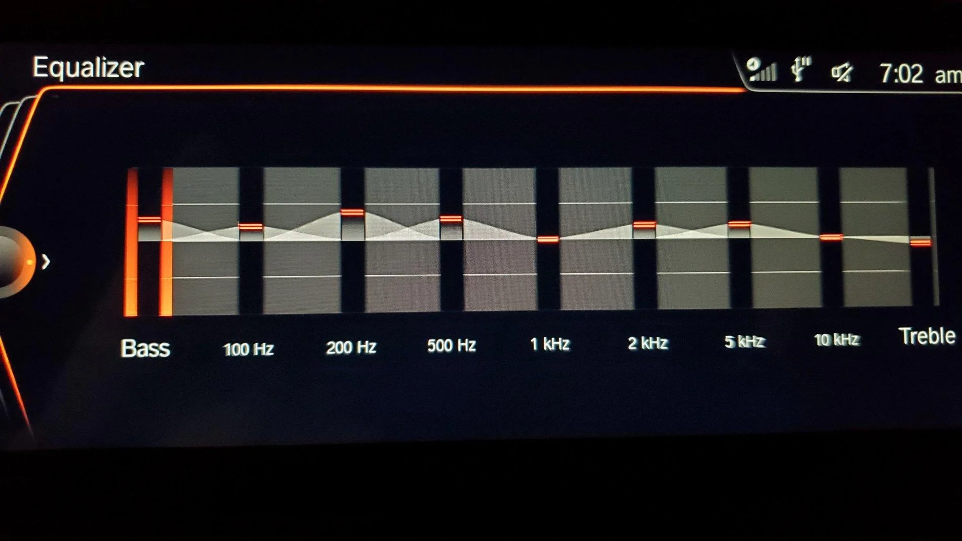

Here are my new equalizer settings after removing much of bass vibrations coming from the large rear speaker cover...I can now turn volume up to nearly 3/4 of max and no vibrations and low bass is fairly decent now...note 100 hz is still somewhat attenuated relative to 200hz...This is due to the response limitations of the speaker itself...
That said, I'm still eager to replace all the speakers to improve the quality and clarity of sound...

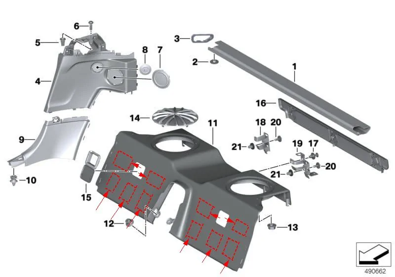

Like others mentioned eliminating the faux engine noise (which is injected into the audio system) using Bimmercode and massaging the sound response through the equalizer settings, the system sounds fairly decent....
That said, your still left with bass vibration noise which comes from the rear bass cover itself....
I was able to nearly eliminate most of the subwoofer vibration noise by applying cut up adhesive backed carpet tiles and adhesive back felt strips in the following places shown below...The only items I had to remove was the narrow rear cover (#16) and grill covers (#14)...
First area was behind drivers seat where I inserted folded strips of adhesive backed low pile carpet tile (arrows show direction of insertion)...
Below is where adhesive back felt strips were applied under rear panel...
Adhesive back felt applied between plastic mount tab and metal mounting bracket....
Adhesive backed felt applied between outer grill cover and mesh grill insert....
Thanks for posting this! I was just searching for this information! I plan to add some dynamat to the subwoofer area and also add some polyfill to help with the Q-Factor of the subwoofer boxes which look like To-Go containers from last nights dinner! I'll report back on how it turns out.
