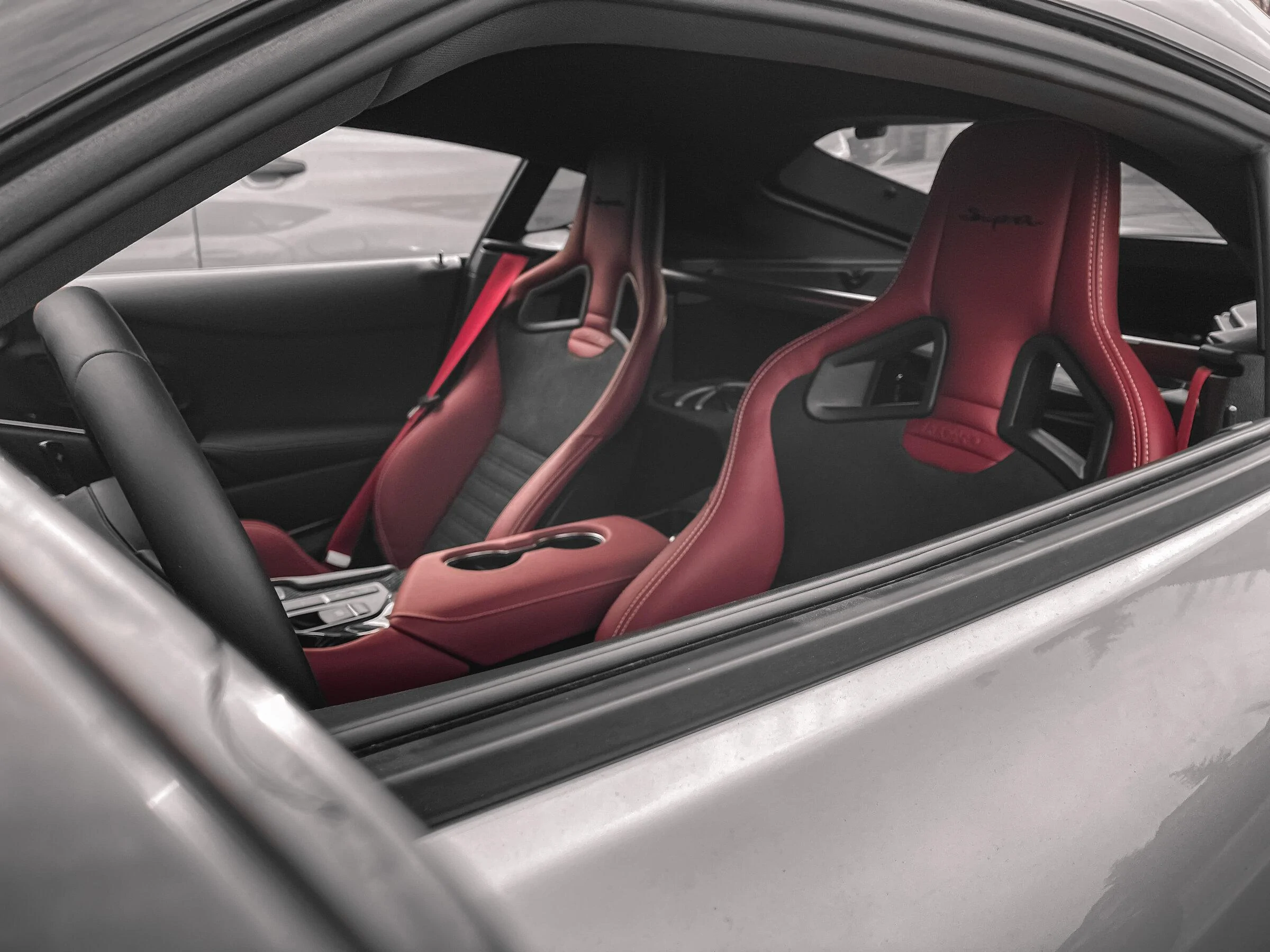

Anyone have recaro CS seats fitted in their supra?

What’s the seating position like? Are you lower than the stock seats?

Did you get the airbags working (if you got that option) and did you get it to work with OEM heat?

Seating position is just a little lower but for me it's all about the added support over the stocks.
These have the option for heated leather with airbags that work like OEM but wasn't interested.

Curious who you use to code out the airbag lights?

What seat rails/mounts/sliders did you use?
I tried what Bflood was running, which is Titan brackets + recaro sliders but it requires some custom/fabricated adapter plates as the titan brackets are not as wide as the sliders/recaro seat base.
Currently using Bride Type RO's but they sit a lil high.

Looks like your harness bar is too high for the seat harness holes now. Should be 20* or less.
That said, the seats do look like full gangsta lean in that photo so if they where more upright in an actual usable scenario it might be okay.
