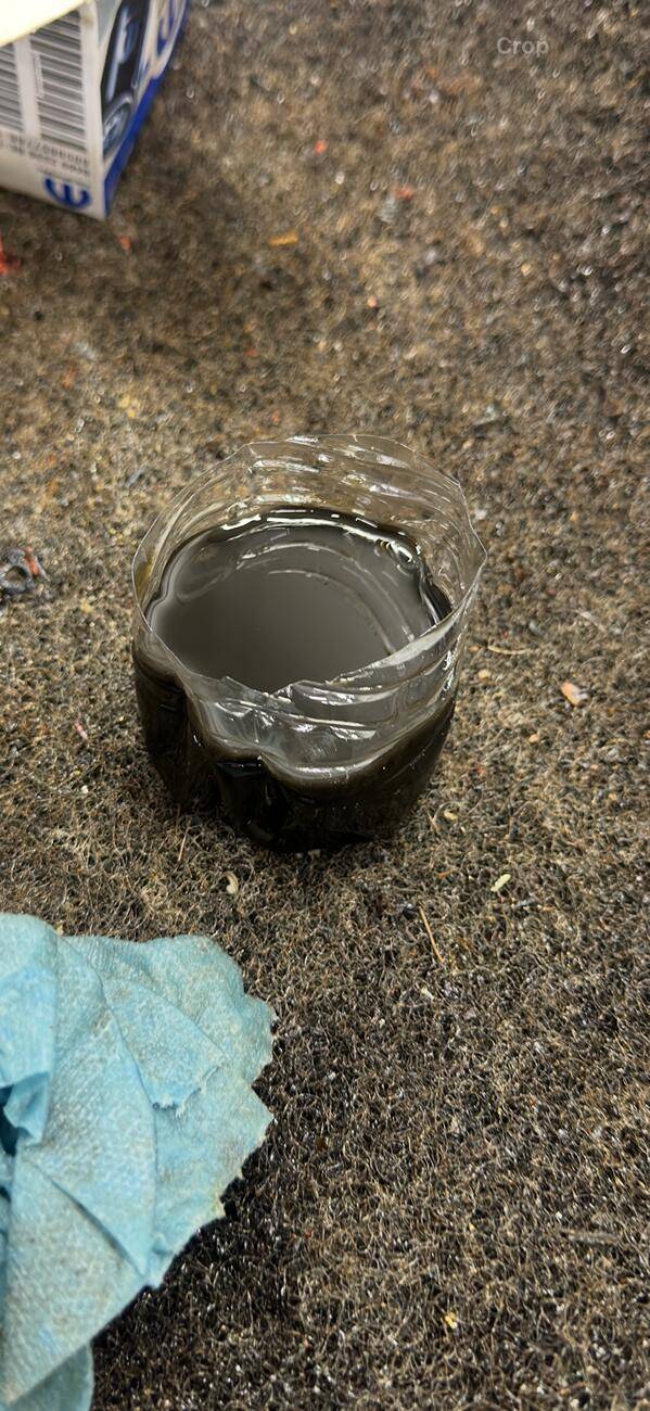

Gad, I'll never forget the first time I changed diff oil. That is the nastiest stuff on the planet.
The extreme-pressure additives are what gives it that distinctive sulphur smell
