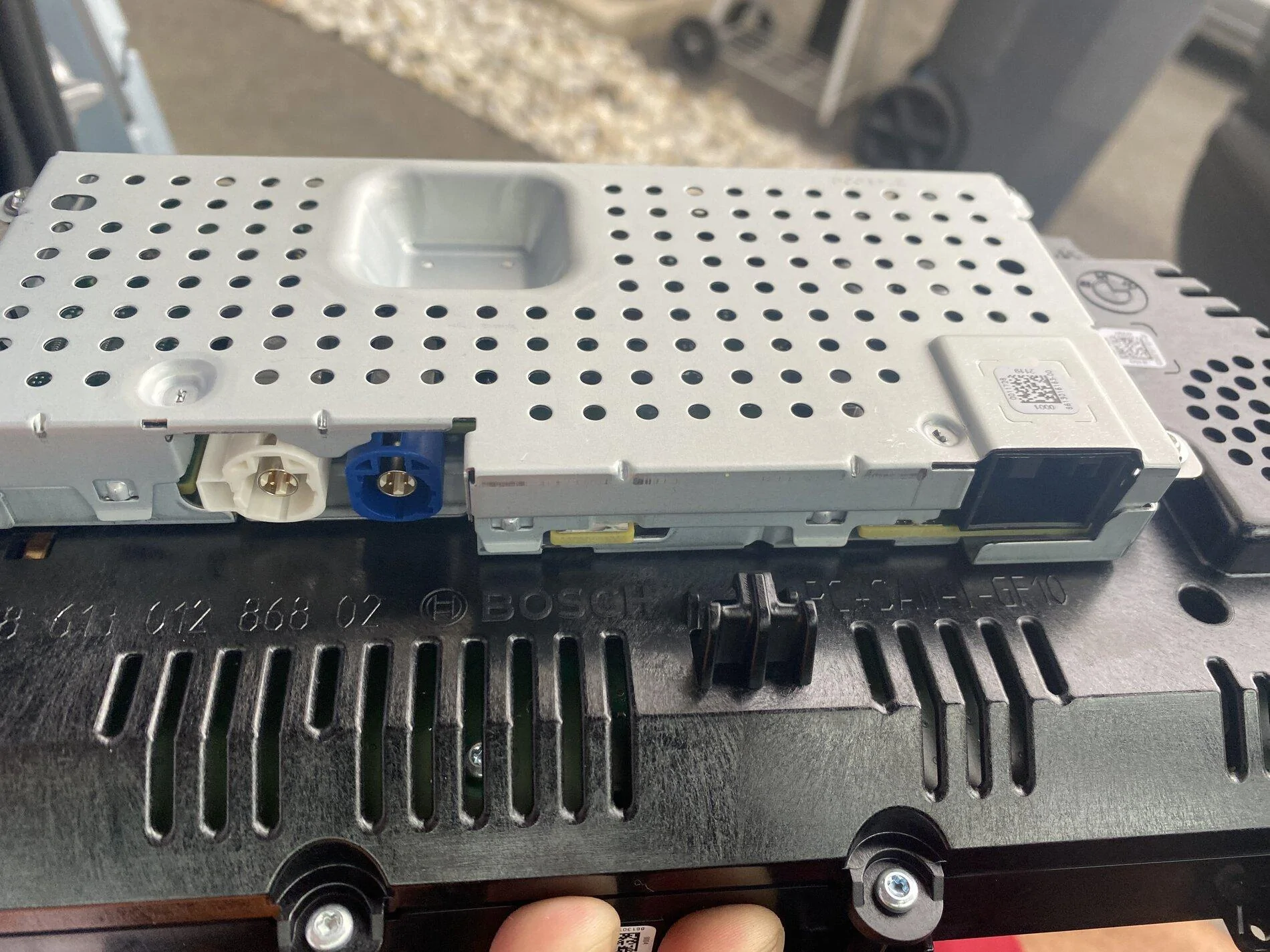

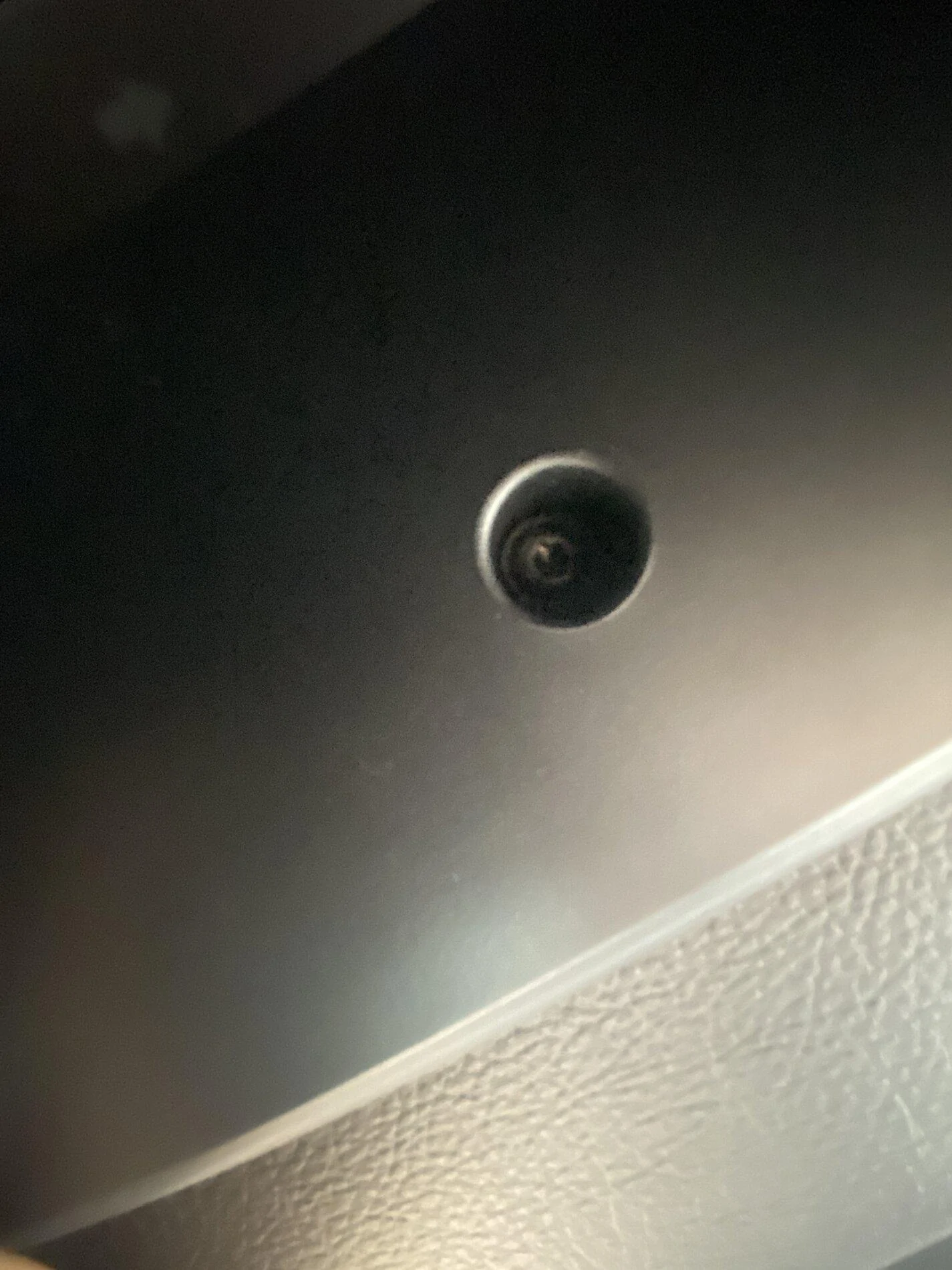

Is it as simple as removed two screws at the top?
pull forward and disconnect the 3 connections in back?

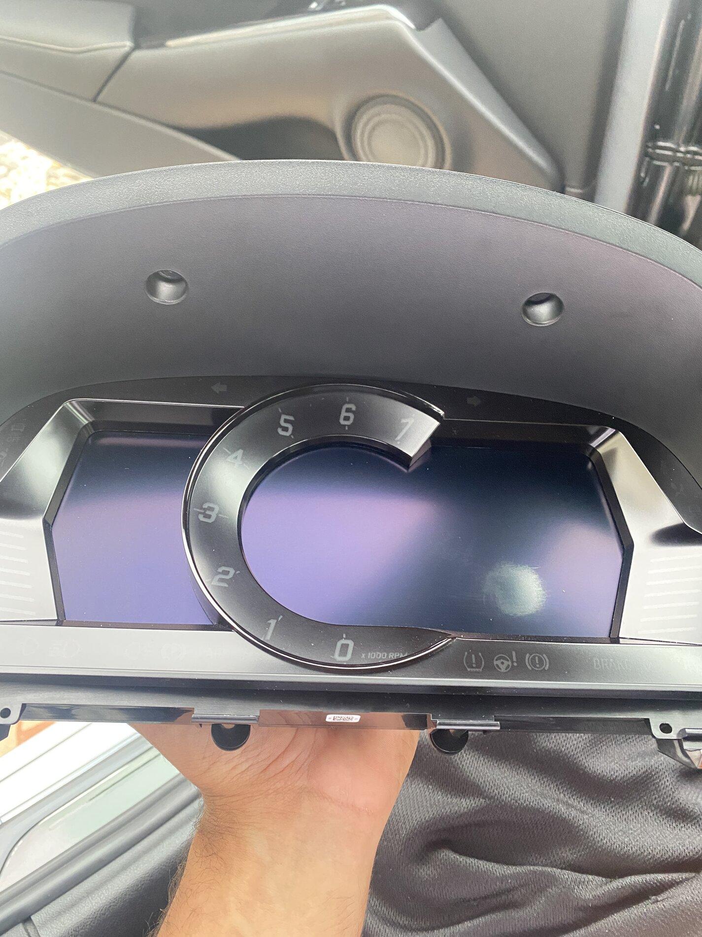

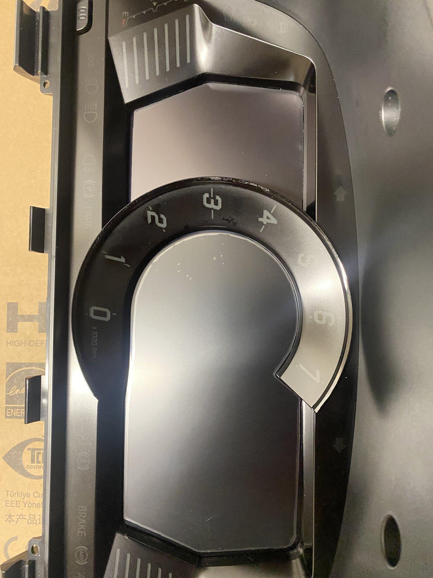

Here is the film i installed. Now i can wipe it without scratching it!

One question did you have to remove the steering wheel to get the cluster out as I have a similar scratch to yours.
1slow_mk5
JC
Dec 25, 2020
101
62
DMV
A90 Supra. S2000. 328i
Nope. Theres plenty of room. Very easy to remove.

Hey when you reinstalled it, did you have any issues with guages showing data?
I’m having mine replaced and they’re in the waiting phase to hear back from their tech rep / manufacturer to inform them what to do.
They got it back in fine but they said “The cluster lights up, but nothing on the gauges works at this time.”
RAWSupra
Richard
Dec 5, 2021
127
98
UK
MKV Supra
nope , all was ok ... but i did disconnect battery before and during cluster removal..
