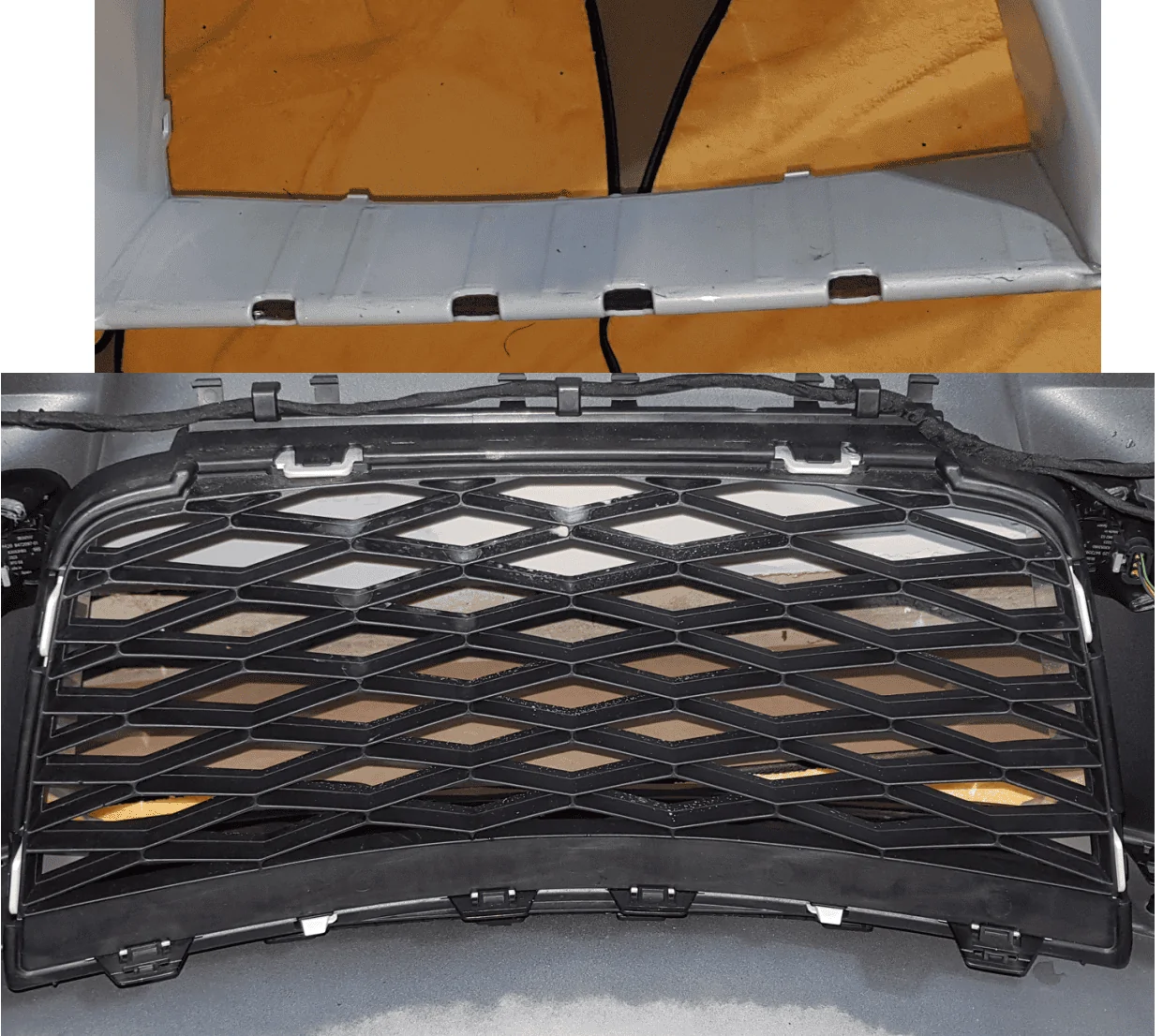

yep removed it. side pieces should come of easily. The mid piece is held by the tabs, hope this helps.
FYI, it's really easy to take off the bumper. I'd rather remove it than f up the tabs...
Putting the bumper back on takes a few practice, but still not difficult..
FYI, sorry these pictures show when it was removed. Seems I didn't take a picture during..

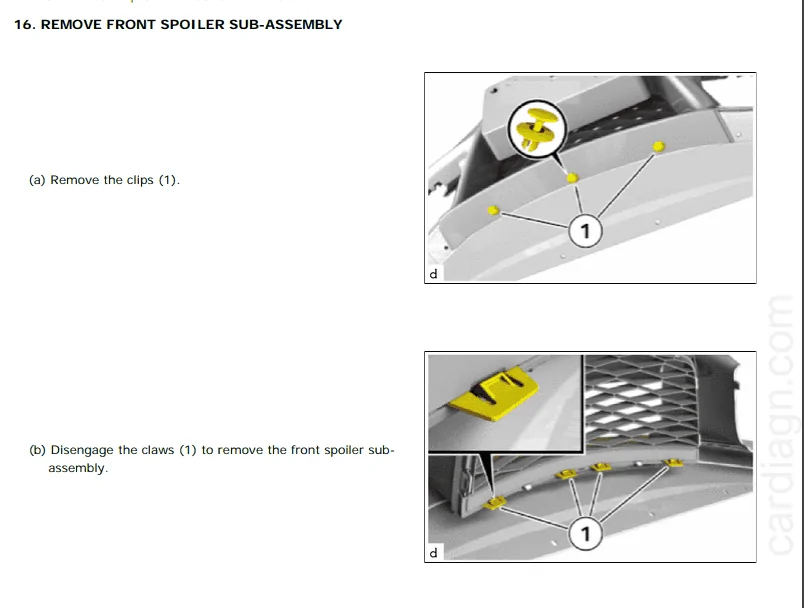

@XtremeMaC I'm trying to get a better understanding of the clips in the middle. The bottom pic above is the view from behind the bumper, right? The clips there at the bottom are what's holding the lip in? or are the clips actually on the front lip piece? Do you have a pic of the front lip piece off the car? I can't quite figure out what the top pic is?

Looks like if I can get something in there and press down on each tab I might be able to get it out without removing the bumper.
