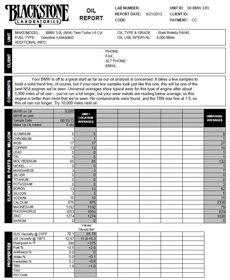

yeah it contains a higher zinc content than most gas engine oils which is better for bearing wear in the long run. prob should have mentioned that it will be in 5k change intervals also Rotella carries a API-SJ rating which is approved for gas engines. also they do make a 0w-40 for the T6 also perhaps that would be a better fit than the 5w? just did some light googling on people running in bmw engines and came across a thread where a guy posted up his Blackstone sample report...the comments from their tech is interesting. not sure how different the N54 motor is from the B58 in the supra also i believe the b58 motor has a diesel variant (which i believe shares the same bottom end) and i thought that i heard that mentioned in the video where that guy stripped the 2020 supra motor down to be built

I wouldn't necessarily worry about the 5w versus 0w depending on the climate, but to go from nominal 20 weight to 40 weight is a big jump and I wouldn't be comfortable with that. It will affect a lot of things in the engine. If the engine is designed for 20 weight, then running 40 weight will decrease flow rate through oil passages and increase frictional drag of the fluid itself. Whether or not it provides better film lubrication will be debatable since there are two aspects of that, the viscosity and the ability of the oil to flow in between parts, and they are counter to each other.
Between my boat (gas), tractor (diesel), generator (diesel), UTV (diesel), outdoor power equipment (gas), truck (gas), and three cars (gas), I don't think I have a single common oil across any of them. I just deal with it. I'd rather give each engine its specified oil than worry about inventory management of my oil. And even though I am a mechanical engineer, I don't feel qualified to second guess the guys who designed and spec'd my engines. They know about stuff that's not even on my radar.
Lubrication in engines is part science and part experience/testing. BMW likely specified the thinner oil to improve efficiency and emissions, but whether or not they optimized the lubrication system for that thinner oil is unknown to me. It's one thing to go with a thinner oil because it improves efficiency and it tested OK for wear, but it's another to design the lubrication system around the thinner oil to get additional benefits. Knowing the Germans, I expect they went all-in on the thinner oil, so unless I hear otherwise, I think it's safe to assume that the pump, passages, filtration, etc, were optimized for the thinner oil.
