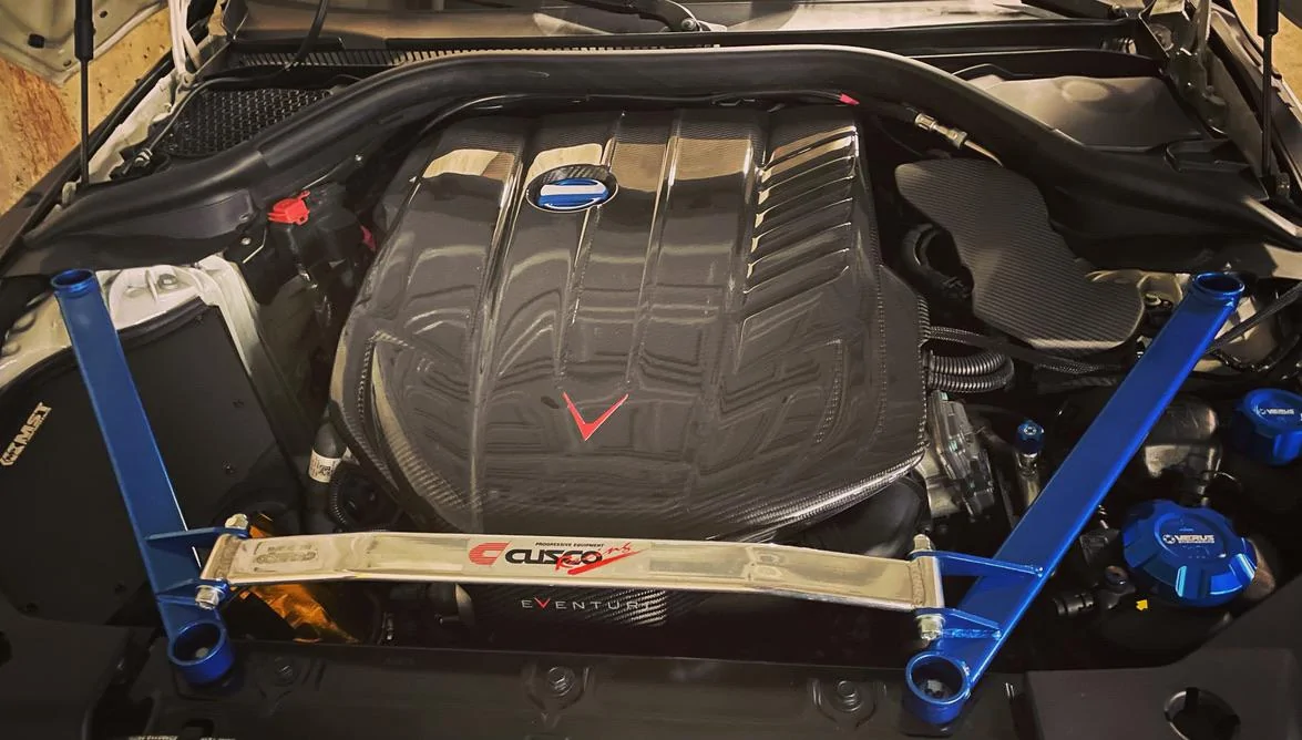

Installed parts/mods (no particular order):
  • PPF
  • Ceramic coat
  • JB4
  • AA catted DP
  • Verus turbo heat shield
  • MST intake V2 with clear lid
  • Cusco strut brace
  • Verus windshield, gas, oil, and coolant caps in blue
  • Eventuri CF engine cover
  • Titanium engine dress up kit
  • Rexpeed gloss CF coolant cover
  • CF ECU cover
  • Rexpeed V2 lip spoiler
  • RK Titanium ECU cover plate
  • Raceseng tow hook w/ GoPro mount
  • A91 vinyls
  • Blacked-out vinyls to cover the reflectors
  • OEM wheels powdercoated gloss black, and calipers powdercoated red (added Brembo vinyls on them)

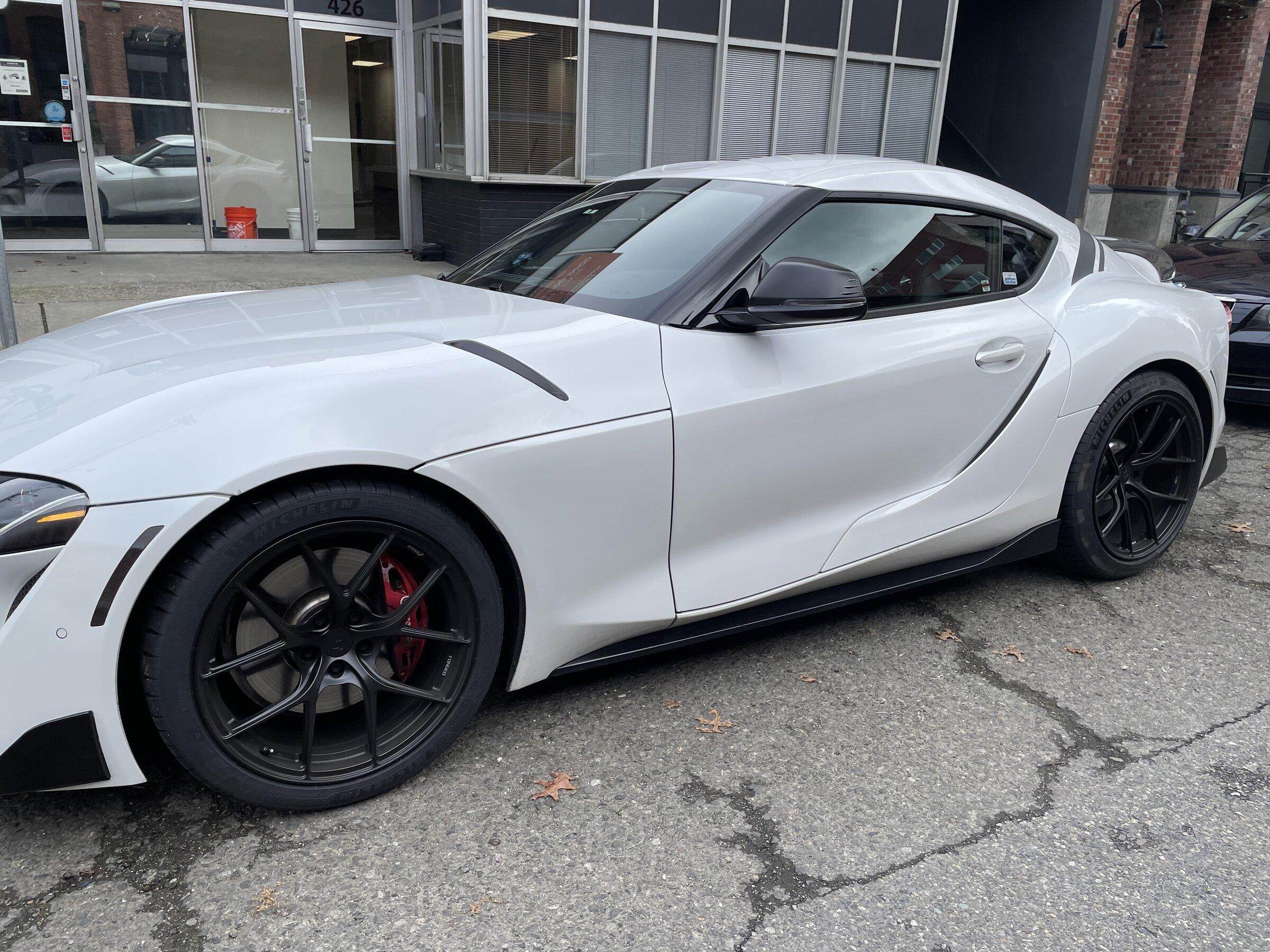

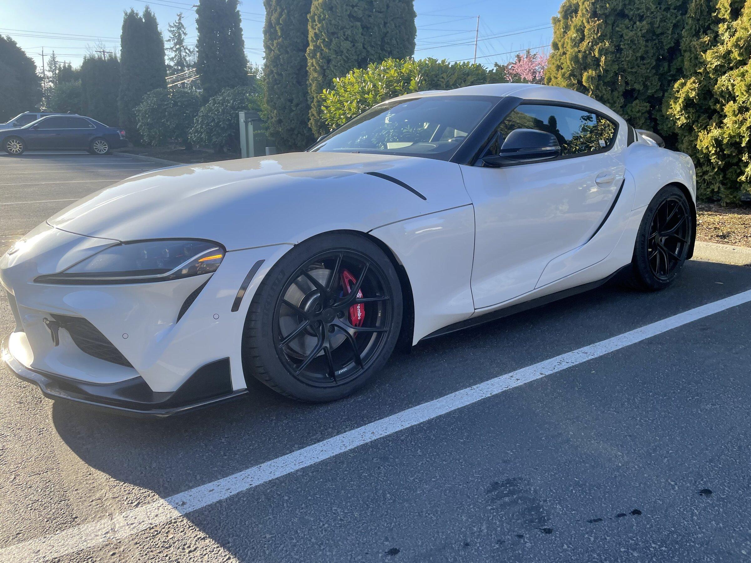

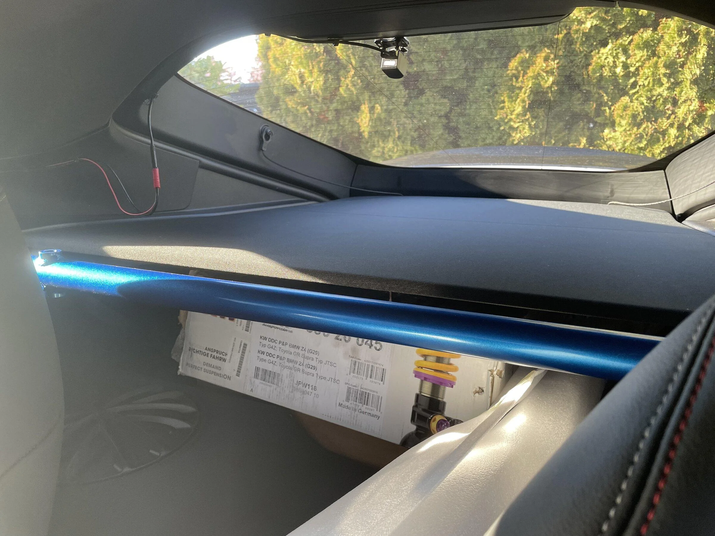

The TS-5s got installed, finally. They're sitting on some PS4Ses -- 265/35/19 up front and 295/35/19 in the rear.
I also replaced the A91 vinyls with a carbon fiber vinyl set from ftspeed. The fitment is far better. Also blacked out the reflectors, also with vinyls from ftspeed.
The car is going in this week to get a lot of goodies installed. I'll update the thread with that list once it's done.

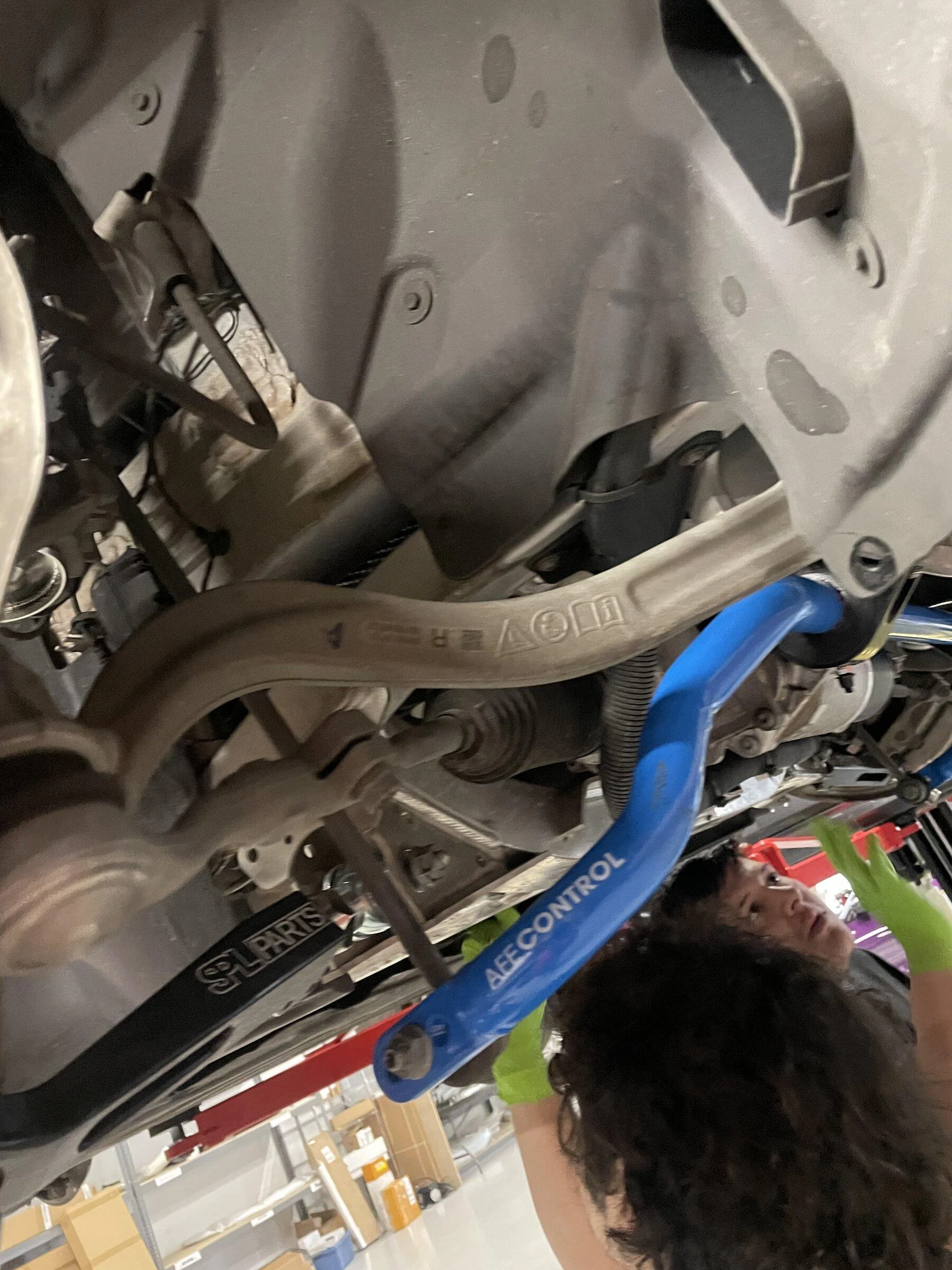

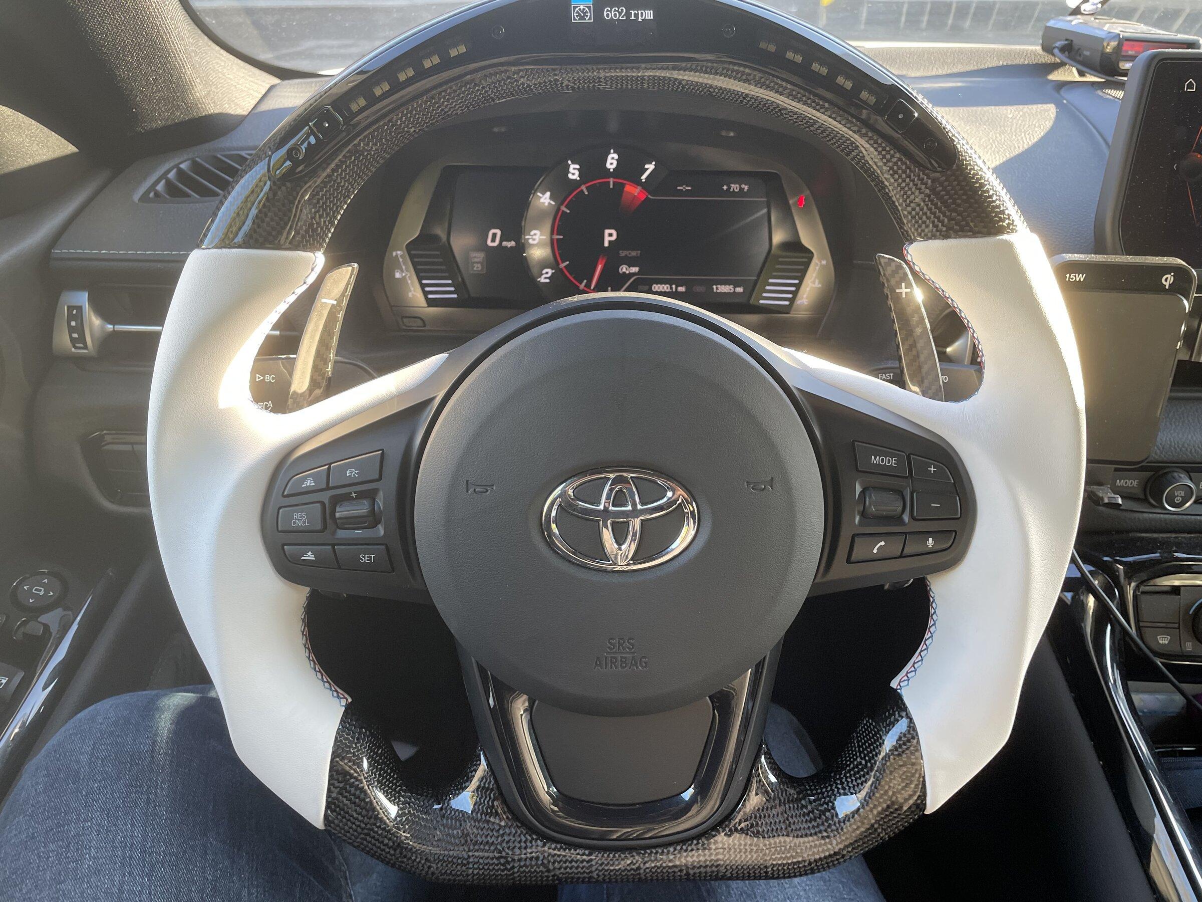

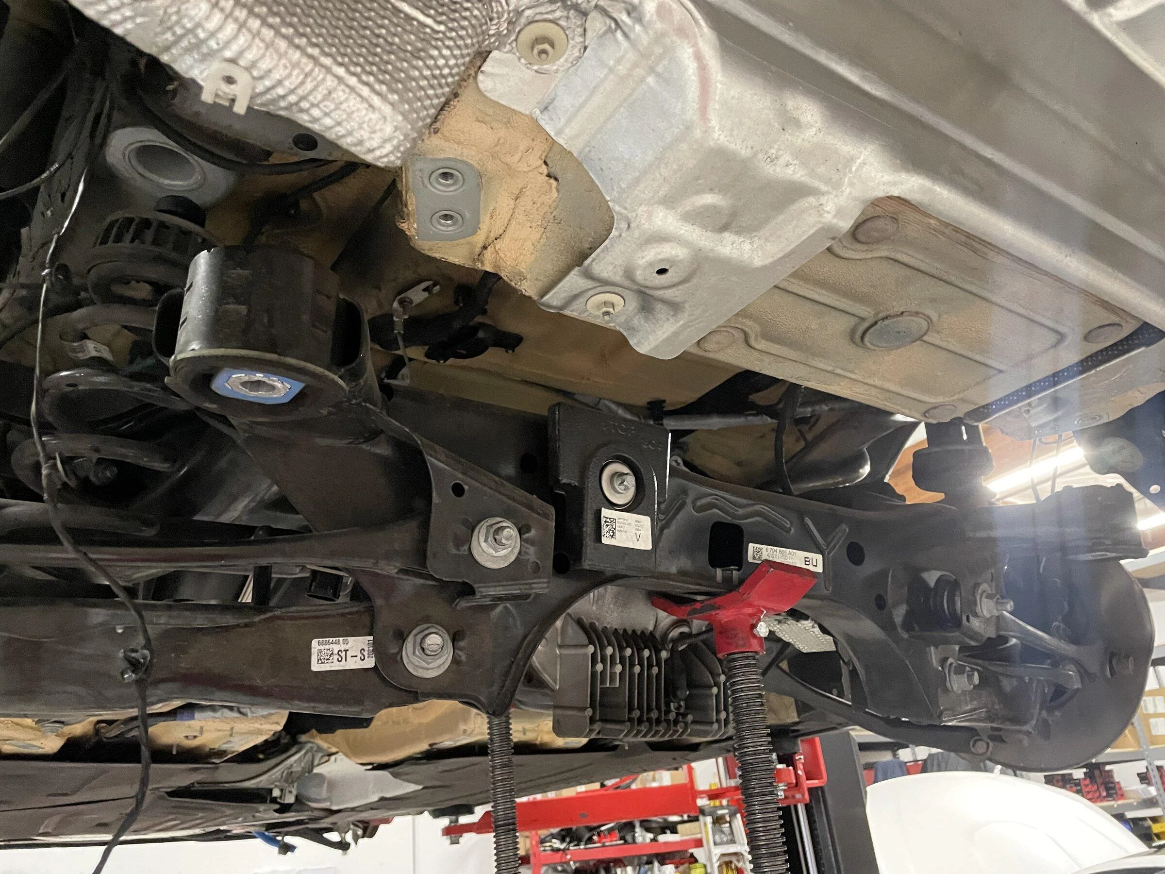

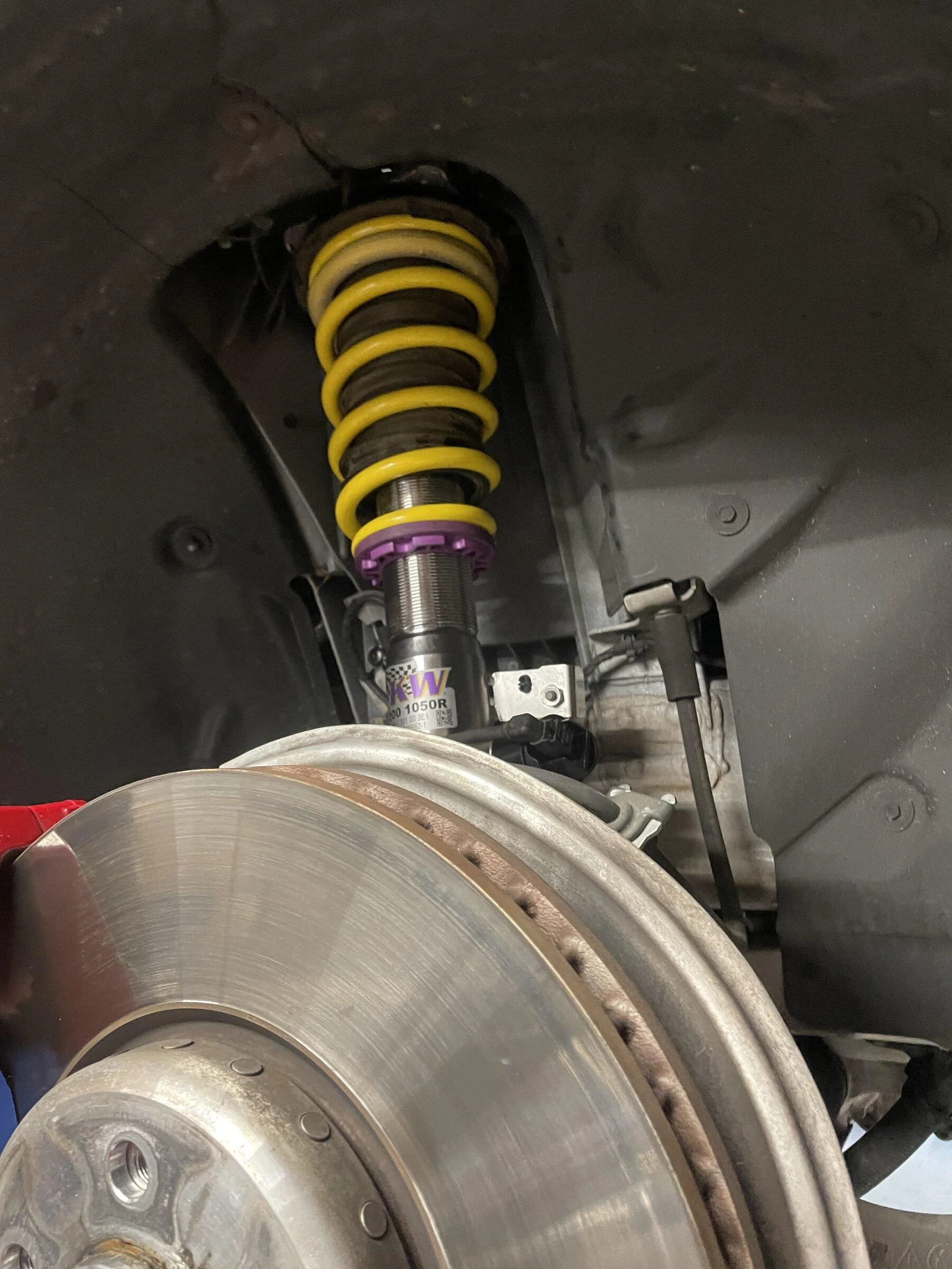

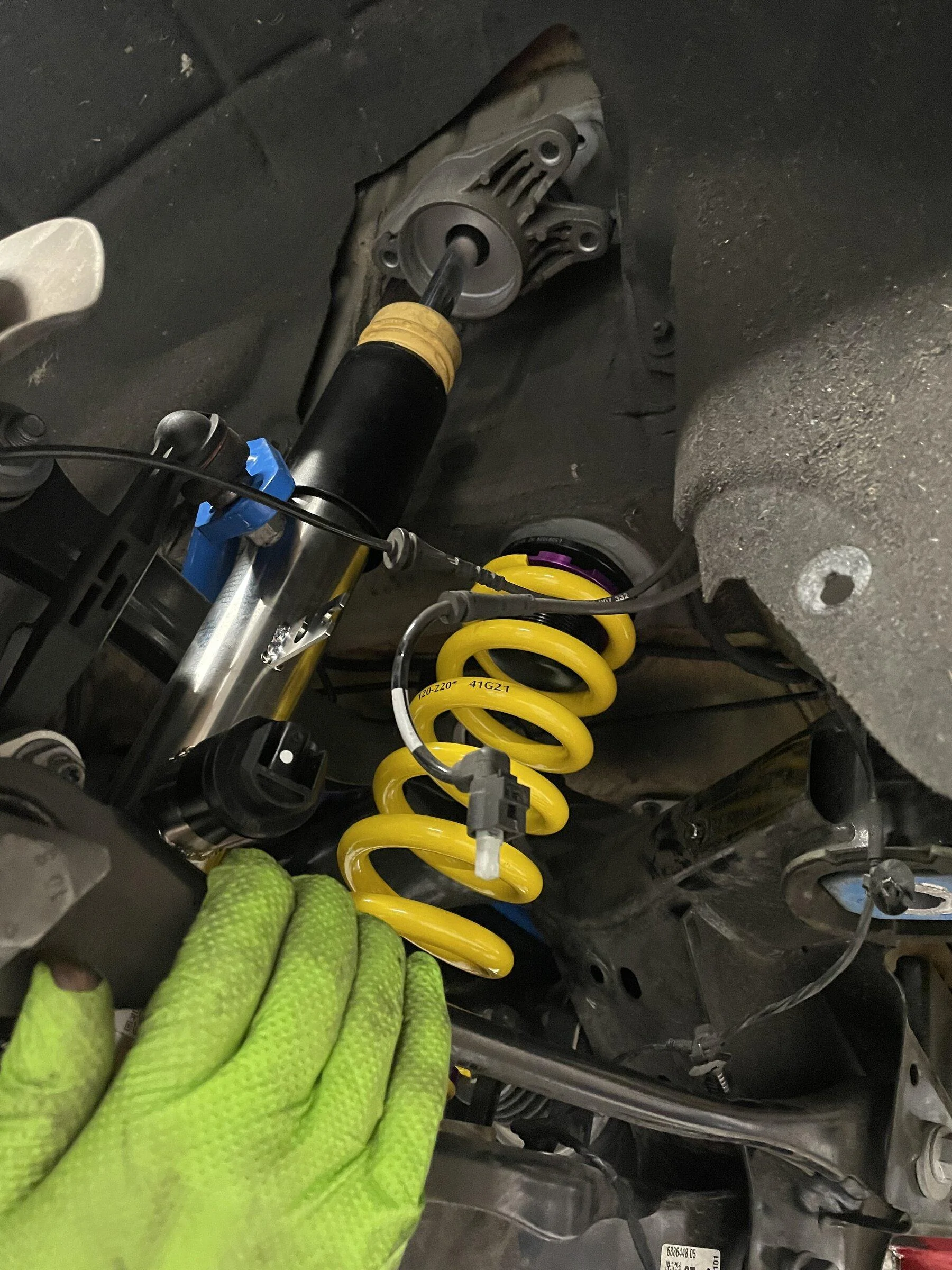

Huge shoutout to Ivan and the crew at Bimtech PNW for doing a great job with the installation of everything, can't recommend them enough!
Massive list of parts installed:
  • KW DDC coilovers with 0.8" drop on all corners (alignment to be done Thursday)
  • SPL front LCAs
  • Dynaperformance CF LED steering wheel with white leather and M tricolor stitching
  • aFe front and rear sway bars
  • Endless RF 650 brake fluid
  • Endless MX72 front pads (the rears that I got from the store were for a 3.0 premium which are too big for the 3.0 base -- the store is willing to do a 1:1 swap)
  • Cusco trunk bar
  • Maxton V2 front lip
  • OLM 4th brake light

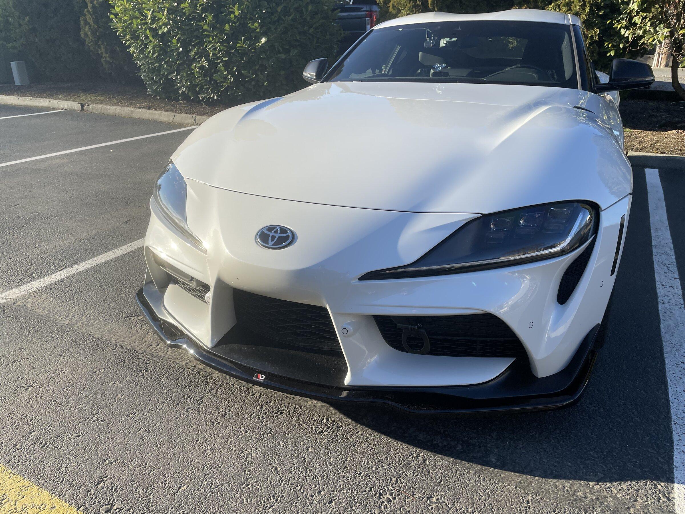

Car looks amazing. Could you do me a huge favor please? Could you take some really good up close pictures of how and where you mounted the corners of the front lip to the bumper? I used the pre-existing screw holes everywhere you could but around the outer edges I didn't know exactly where to screw so I used 3M tape around the outer edges. Yours looks better and I would love to see exactly where and how you did the screws. Thanks in advance!

'22 Supra
Very bold of you to go with a white leather steering wheel. My OCD would not allow that lol. I feel like i'd need to clean it after every drive.
No drilling actually, just lots of 3M tape

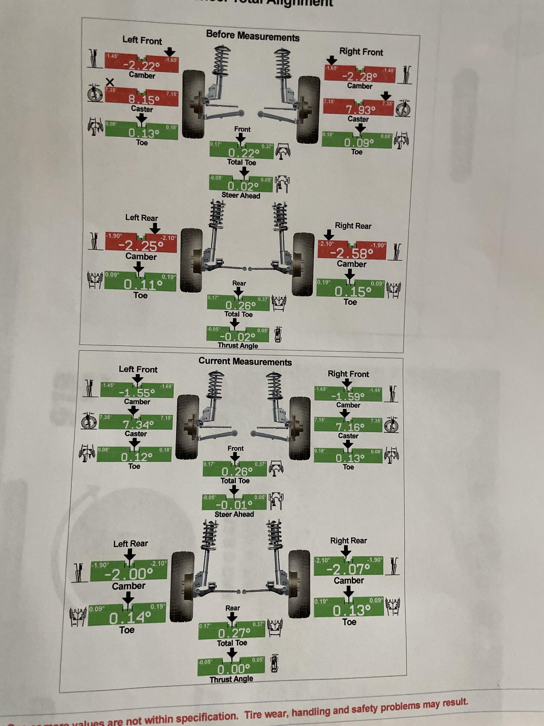

Alignment specs. I also had the car corner balanced ahead of track work this year.

Your moms bedsheets
You now have more negative camber in the rear than the front?
Your before alignment camber numbers were better ?
Most of its miles are on the street and it was horribly jumpy before -- can't have it go full racecar until I have a separate car as for regular usage. It does dial down the oversteer a bit. Honestly, with how bad WA roads are, I prefer the much more neutral alignment since there's a lot of unpredictability from the roads themselves with dips and bumps.
Also worth noting that it hooks up much better on a hard launch.
I do some occasional track days (less than before because of part time grad school commitments), so I'll see if this majorly compromises track performance when I'm out there next month.
